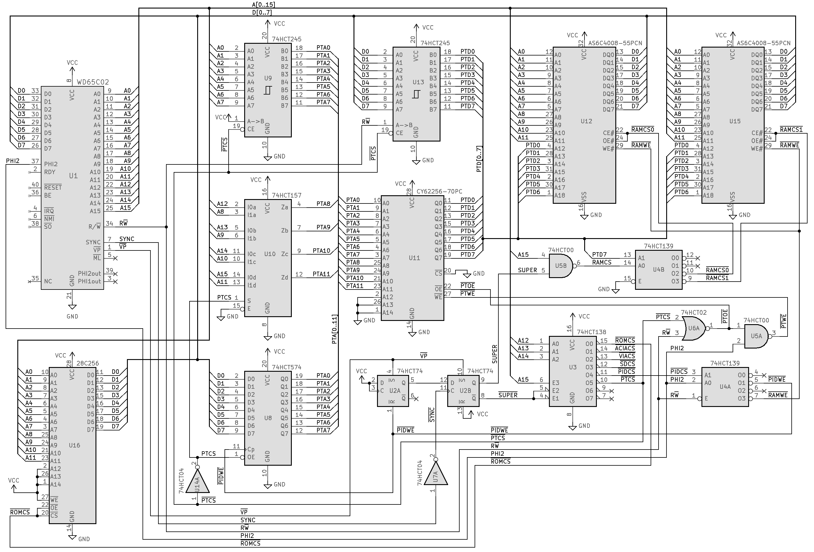

Finally, here's the schematic I have so far. I'm not sure I have the patience to build a breadboard prototype this time as there are just so many buses to wire up, that gets quite tedious - so after giving it some time to settle, I might go straight to PCB layout this time.
File comment: Multitasking 6502 computer schematic
In the schematic we have:
  • Left side - 6502 (U1), ROM (U16)
  • Central columns - pagetable management - pagetable (U11), PID register (U8), pagetable address multiplexing (U9, U10), pagetable data interface (U13)
  • Top right - main RAM (U12, U15) and RAM selection logic (U5B, U4B)
  • Bottom centre - supervisor flag (U2A, U2B)
  • Bottom right - ROM and I/O address decoding (U3, U4A, U5A, U6A)
Interesting signals in the schematic:
  • D[0..7], A[0..15] - CPU buses
  • PTD[0..7], PTA[0..11] - Pagetable buses
  • PTCS, PTOE, PTWE - read/write the pagetable
  • PIDCS, PIDWE - write to the process ID register
  • SUPER - supervisor mode flag
  • ROMCS, ACIACS, VIACS, SDCS - ROM and I/O selection signals
Some points of note:
  • The address mapping going into the PTA bus - there are two mappings, if we're reading/writing the pagetable then we pass A[0..11], otherwise we pass PID[0..7] and A[12..15]. U10 selects between the top four bits, while U8 or U9 provides the bottom 8 bits.
  • The pagetable's OE signal needs to be asserted at all times other than pagetable write operations (U6A)
  • The RAM is selected when not in SUPER mode, and also when accessing the bottom half of the address space (U5B)
  • U2A and U2B (super mode flags) are both set on VPB. U2A is cleared when the PID register is written. U2B copies this state at the end of the next instruction fetch cycle (using SYNC).
  • The inverters can probably be implemented using spare gates from elsewhere.
  • The mechanism to drive NMI isn't shown, it will just be a countdown timer, probably reset while in supervisor mode to prevent NMIs in that mode.
  • RESET, IRQ, and PHI2 need to be driven in the usual ways - I'm not anticipating any clock stretching here as the large RAM modules are only 55ns, so can't go above about 10MHz anyway.
  • U13 is the wrong way around, it need its A and B pins swapped - oops!
I think compared to similar systems, my understanding is that Andre has also implemented a system like this using normal RAM as the pagetable, but I think I've only seen schematics for his older system using a more specialized IC for the pagetable (I think it was dual port?). I also read BDD's thoughts on this sort of thing in his POC thread, but I think I need a different approach here as for the 6502 it doesn't make as much sense to try to mesh with features of the CPU itself, as it doesn't internally have things like banking at all.
As always, any questions or corrections are much appreciated, as well as other pointers to similar systems!

Honestly i'm kinda shocked how little actual logic logic this design seems to require.
damn you people, for making me want to design something like this myself seeing how all of this should easily fit in a CPLD and some faster Memory ICs! :lol:
anyways, looking at the schematic only thing i've really noticed that U9 is a '245 but set to permanently output to the same side, at that point wouldn't function the same as a '244 or similar uni-directional tri-state buffer?
also when you make the PCB, i can recommend Freerouting in case you feel dread when thinking about routing this design manually.

I find it takes quite a lot of effort and compromises to reduce the logic so much. For a long time I was trying to keep 32K of ROM in the supervisor memory map, which made decoding RAM accesses much harder. I had to remember my previous goal of simple decoding rather than efficient use of address space, and even then I resisted quite a bit.
The use of one '139 to generate RAMWE and PIDWE was maybe a bit too much corner-cutting, and will probably need to change if I implement read only pages.

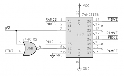

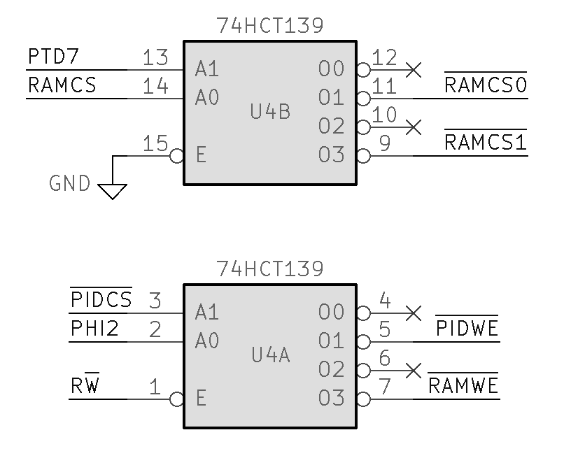

I thought about some amendments based on the discussion and bugs in the old circuit. I think I can fix the following fairly easily:
  • Make activating super mode depend on reading PID rather than writing it
  • Make the top bit of the pagetable control writability, so that shared pages can be read-only
  • Add missing NMI-driving circuit
Using the top bit of the pagetable for writability means there are only seven bits left, enough for 128 physical pages; and as each process requires at least one page, that means the effective number of processes is reduced compared to the previous design. The only way around that would be to have a wider pagetable. I seem to remember that Andre's MMU, for example, had 12 bits of storage, which was handy for this (he had more permission bits, things like non-execute pages). It also means we can only address 512K of RAM now, unless other things in the system are changed (larger pages).
The old logic to drive the two RAMCS signals, the RAMWE signal, and the PIDWE signal, was as follows:
I can replace that entire IC with a 138 and do it like this instead - sacrificing the two banks, and using the PTD7 signal (high bit of pagetable) to disable writes to pages that are mapped read-only:
Note that RAMCS is active high.
In this scheme, if PTD7 is low then the page is read-only - in that case the '138 is disabled and nothing is selected for read or write. This is only intended to be applied to the paged RAM, but will also affect the PID register as a side effect - so I will need to ensure that PTD7 is set correctly on the logical page that the PID register falls in. That's irritating but not hard to initialise on system startup.
I've had to add a RAMOE signal there that wasn't in the original schematic - this is so that, when writes are inhibited, the RAM does not fall back to driving the data bus, conflicting with the CPU that's trying to execute its write operation.
The new PIDOE signal can now be used to trigger the exit from supervisor mode, with a delay until the next SYNC, just like I did before using PIDWE. The exit code will now look something like this:

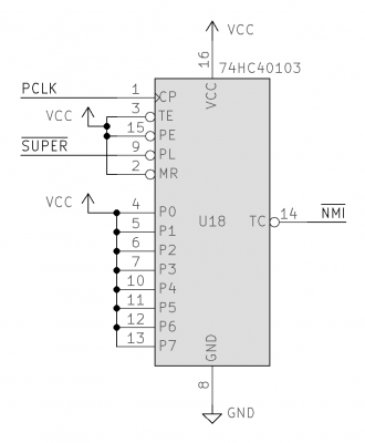

I've also thought a bit about the watchdog-style timer for enforcing premptive multitasking - I think it can be this simple:
This will count down from a chosen value and trigger NMI. Entry into supervisor mode will hold the counter at its preset value, preventing NMIs while in supervisor mode. The clock source could be PHI2, but that might interrupt processes too often. It could be SYNC instead, or I could just use an independent clock source like a horizontal or vertical sync pulse, or a slow crystal oscillator.
I was concerned about what would happen if the count expired during an interrupt sequence, before the SUPER flag is set. There's an interesting thread about that here from over a decade ago, with a visual6502 test case that I've adapted here. This in particular executes a BRK instruction, and arranges NMI to briefly go low at a certain point so we can check the effect. NMI is only recognized if it goes low in the second half of the cycle (PHI2 high) - according to the 6502 datasheet I believe it is being sampled at the falling edge of PHI2. So for our purposes here we need to set odd values for "nmi0=" in the URL and the next even value up for "nmi1=" to turn it off again.
The point I've set it in the link above triggers NMI at the latest point where it will redirect the BRK into being an NMI (changing the fetched vector). Any later and the NMI is ignored completely, unless it occurs at the end of the second vector fetch, in which case it is recognized and triggers on the next instruction instead. I don't want this to happen in my case, but that's OK because as soon as the vector fetch begins, the SUPER flag gets set, and the 40103 downcounter will be reset, so the NMI won't occur that late.
There is a problem here though because if the NMI takes over the BRK instruction, the BRK is not executed at all - I believe this is a well-known NMOS bug. This is because the BRK incremented the program counter during its first two cycles. I believe this is fixed in the 65C02, but it highlights that this investigation in visual6502 might not be the same with the newer CPU, so it probably needs some practical testing with hardware in controlled circumstances. I'd love to hear if anybody has already done this.

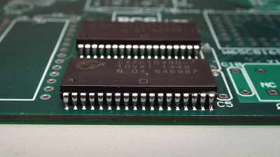

then for the large SRAM you could go with the IS61C5128AL, 512kB with a 10ns access time. downside is that it's SMT, using the SOJ package. but honestly it's not that bad to solder if you have one of those cheap manual desoldering pumps.
PostPosted: Tue Dec 05, 2023 4:51 am
Posts: 8504
Before vision in my left eye went south, I had no trouble manually soldering SOIC and SOJ packages.  Garth has a technique that is similar to what I was using, which produces professional-looking joints.  Here’s a closeup of Garth’s handiwork on an SOJ36 package.
