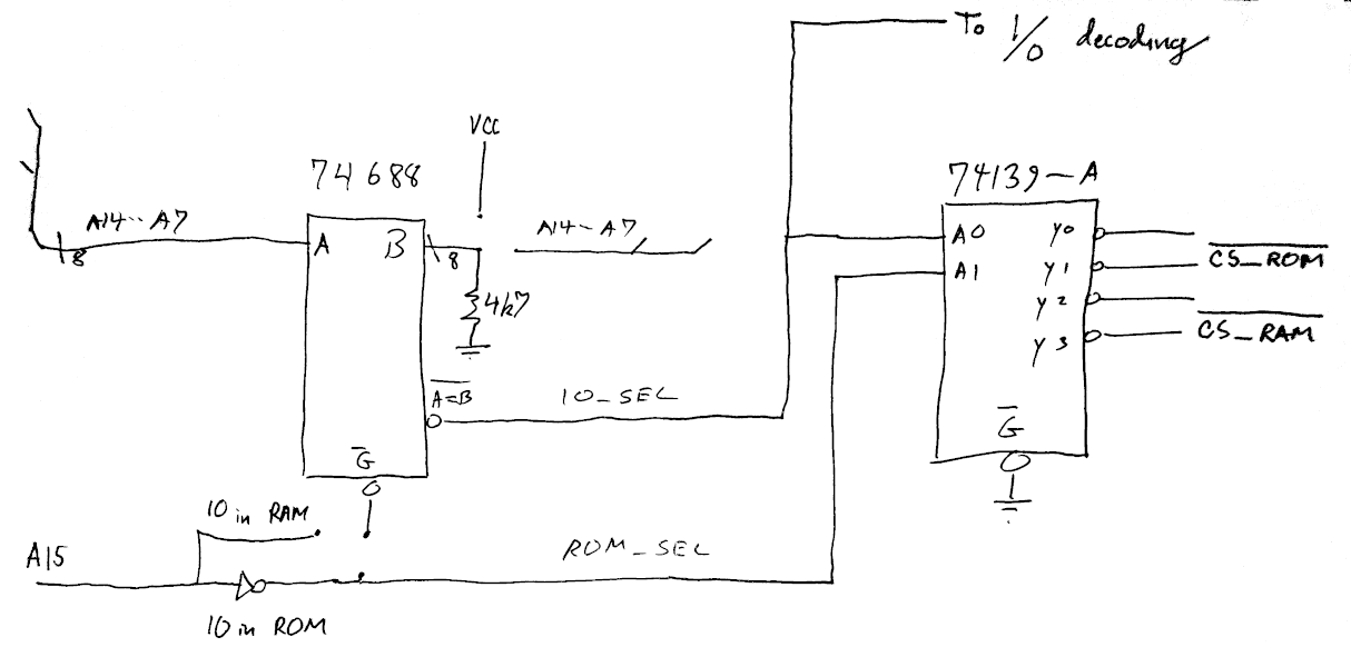

This is Peanutbutter-1's address decoding, more or less:
I am thinking that an easy way to do what I want is to gate the ROM_SEL\ signal by OR-ing it with a RAM/ROM\ bank select signal. When RAM/ROM\ is low, access to the upper 32k of address space will go to ROM. when RAM/ROM\ is high, access to the upper 32k of address space will go to RAM.
My next question is, how to ensure that RAM/ROM\ is low after power-on? Is there a way to do this with a 6522, or will I need to add a hardware register driven by RESET\?
Proxy
Posts: 746
Joined: 03 Aug 2018
Re: Not too complicated but "Period appropriate" RAM/ROM ban
Post by Proxy »
IIRC all 65c22 IO pins have a default state after reset.
Though I don't remember if it was as input or as output driving logic low.
Either case you should be able to simply use a pull down resistor.

Post by fachat »
65xx IO typically defaults to input after reset

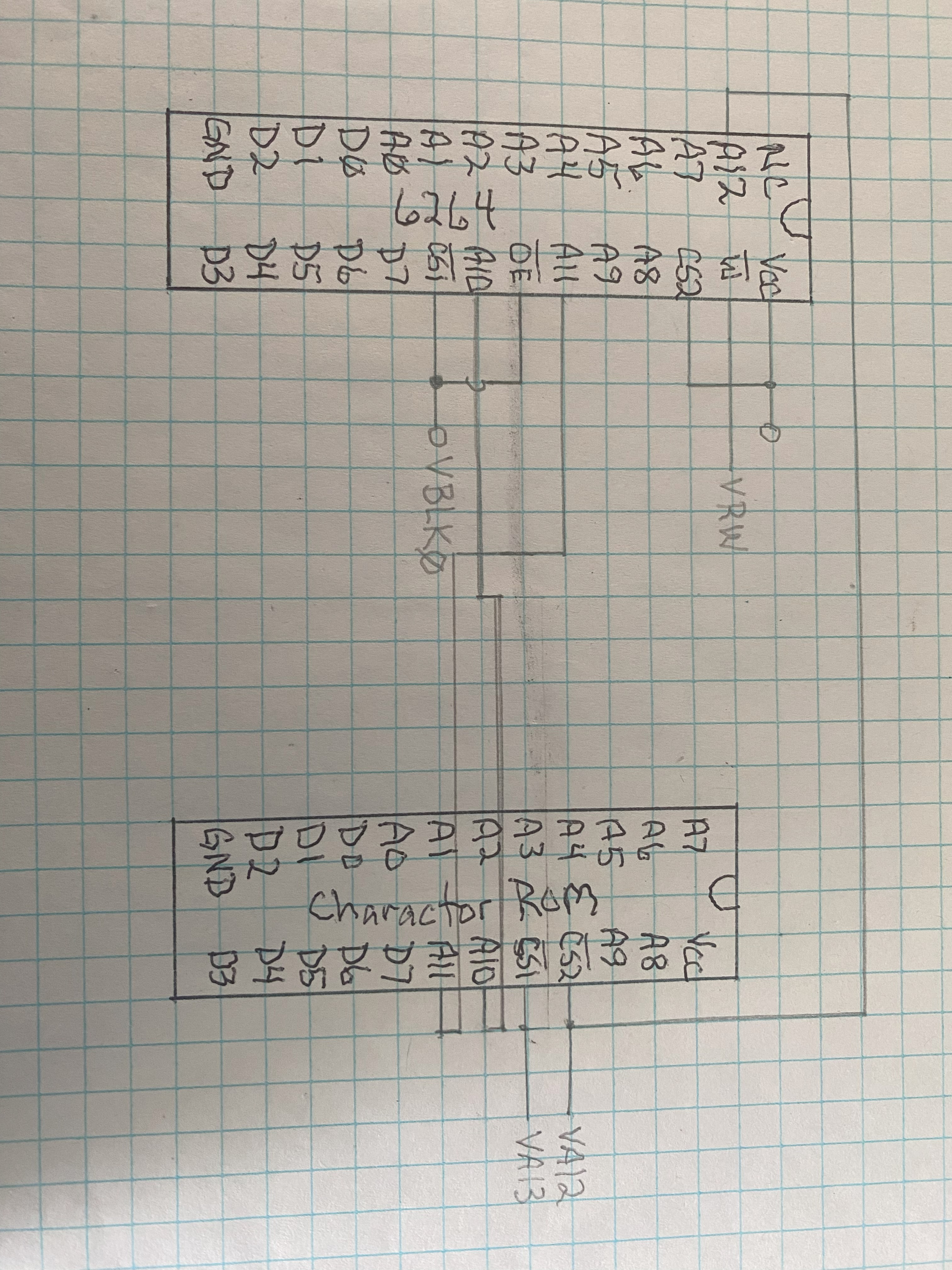

A0CBM
Posts: 51
Joined: 04 Nov 2015
Post by A0CBM »
This is a basic hookup of the internal 8K ram to the character rom. VICBNK0 would drive the first 8K SRAM. Add another 8K to this board and you can use the RAM under the character ROM.

Michael wrote:
I think your decoding/banking method is clever and elegant.
Thank you, Michael! I first learned the "relocatable I/O window" concept from your posts in this thread: Address decoding upgrade with 74HC139. I really enjoy your schematics. Not only do they always have cool ideas, but they're really fun to look at.

Paganini wrote:
... I'm a bit of an Arduinophobe.
I understand. Some of our most esteemed members dis Arduinos while admitting they've never used one. I'm guessing many newcomers and electronic enthusiasts may come here looking for more economical alternatives to Ben Eater's $200+ kit package and may be less biased and perhaps already familiar with or using Arduinos (or other microcontrollers).
As I said, your method is simple, clever, and elegant and a variation might use half of the 74HC139 to provide clock qualified read and write strobes instead of RAM and ROM selects and the other half of the '139 might be used to provide I/O strobes.
Good luck and have fun...
Well, maybe "phobe" was an overstatement on my part. I don't have a particular beef with Arduinos; in fact, I have a cheap one that came with my first electronics kit, and I've used it to run Ben Eater's 6502 bus monitor. It just seems like an approach to hobby electronics that is somewhat removed from the sort of "period practice" retrocomputing that's captured my attention.
...a variation might use half of the 74HC139 to provide clock qualified read and write strobes instead of clock qualified RAM and ROM selects and the other half of the '139 might be used to provide I/O strobes.
That is slickety-doo-dah. I love it!
