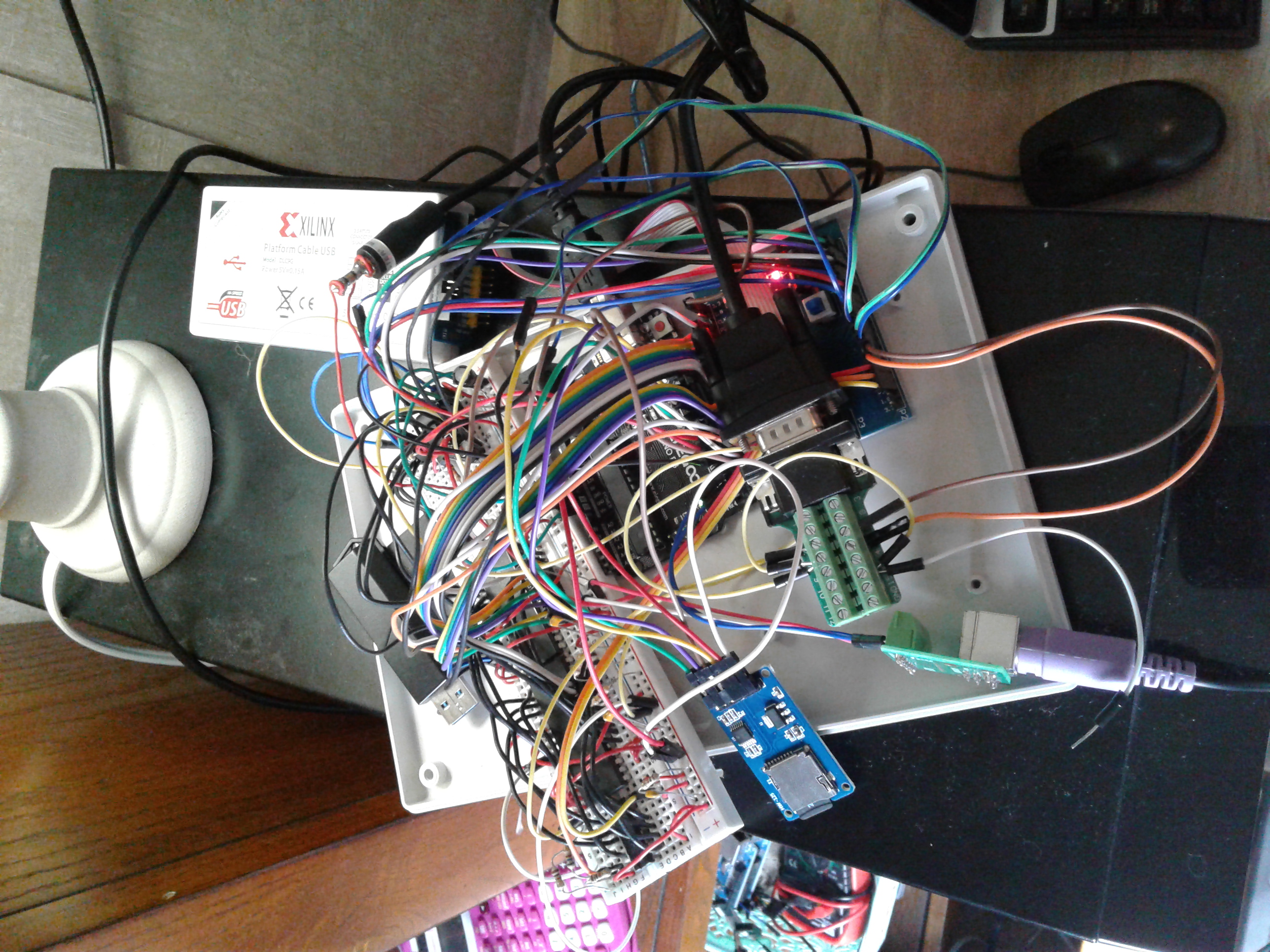

Hello everyone!
I've been working on my new Xilinx CPLD project, but wanting to go a different route than normal. Introducing the mess o' wires that somehow is running 6502 assembly code on an Arduino!
First, the memory map is:
$0000-$03FF = 1K of direct access RAM on Arduino, duplicated from $0000-$7FFF
and
$F000-$F7FF = 2K of display RAM for text characters through VGA
$F800-$FFFF = 2K of code RAM loaded from the SD Card, both of these are duplicated from $8000-$FFFF

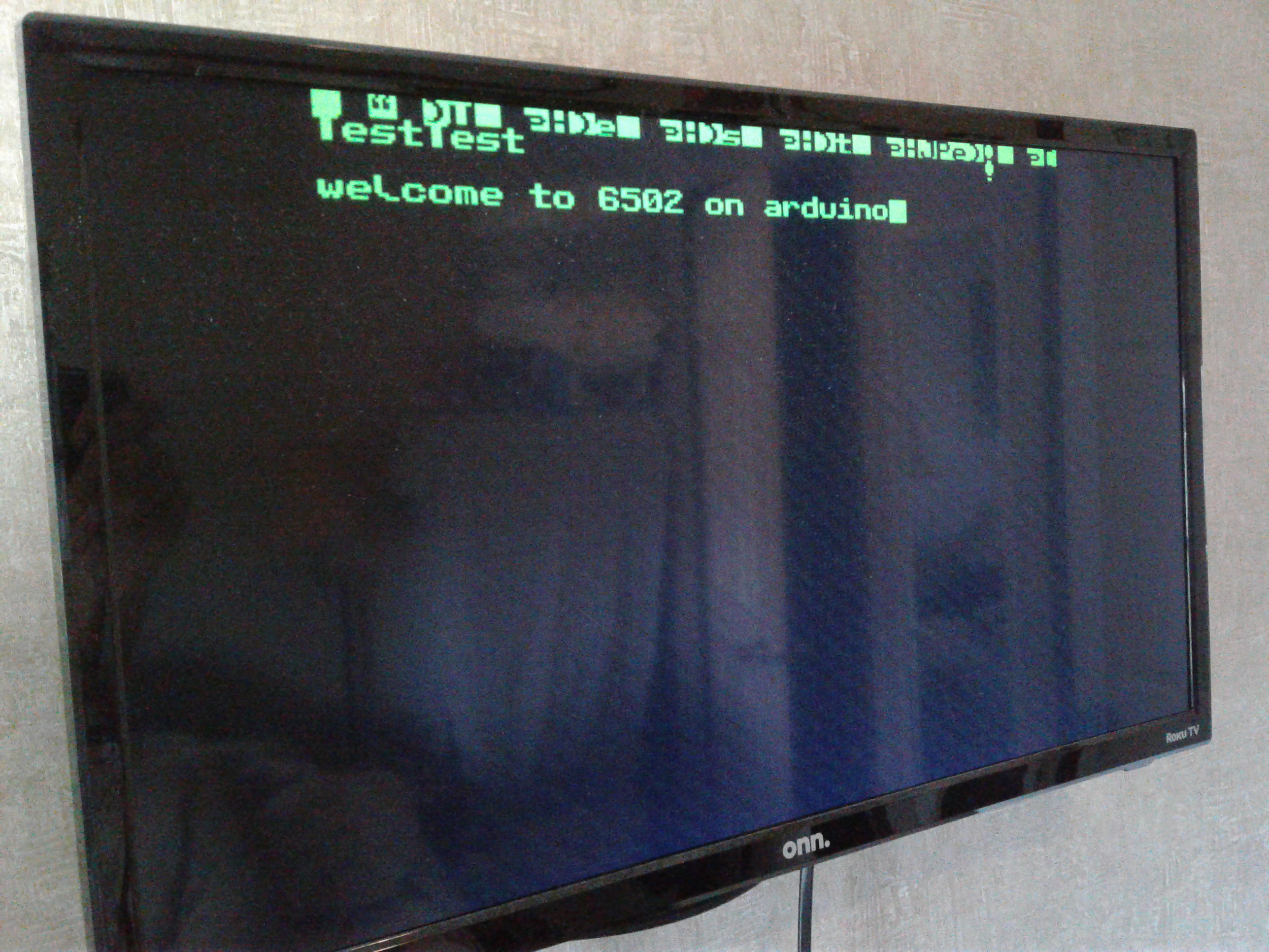

The Arduino loads the first 2K from the SD Card, puts it in $F800. It assumes this is 6502 assembly code, and (currently) runs it immediately. My testing code is small:
   .65C02
   .ORG $F800
   LDY #$00
   LDX #$02
loop
   LDA #'T'
   STA $F000,Y
   INY
   LDA #'e'
   STA $F000,Y
   INY
   LDA #'s'
   STA $F000,Y
   INY
   LDA #'t'
   STA $F000,Y
   INY
   DEX
   BNE loop
   LDA #'!'
   STA $F020
   STP
   .ORG $FFFC
   .BYTE $00,$F8
   .BYTE $00,$F8
After that, it goes into "scratchpad" mode, where I can just type whatever I want from the PS/2 keyboard onto the screen. I plan to creating a little menu where it will run the assembly code on command, instead of simply being a bootloader only.
I completely despise using this breadboard, it has failed me multiple times and has been more of a problem than a solution. Yet, it works *right now* and that's good enough. I plan on making an SMT style board for this very soon.
More updates when I have them. Thanks everyone!
Chad

Here is the schematic.
Sorry for the confusion. The idea is that I am using an Arduino to run 6502 assembly code. I've seen others do this, but what's different here is that it is also more "stand alone", using VGA display and PS/2 Keyboard. I could use the serial connection with the Arduino but am choosing not to.
The code on the Arduino has all of the inner workings of the 6502 processor. Well, it has all of the instructions except for zero-page, which I haven't gotten to yet. The 6502 code is stored on the SD card. On boot, the Arduino loads the 6502 assembly code (in binary form) into RAM, and then executes it, acting just like a 6502 processor. So, I guess that counts as simulation/emulation.
The memory map is very strange, because the Arduino's direct access RAM is very small, and the extra RAM I put on it is mainly for video display. Thus, the only effective places in memory available are $0000-$03FF for quick RAM, $F000-$F7FF for slow display RAM, and $F800-$FFFF for slow general RAM. Still 2KB of 6502 code can go a long way. A game or a system monitor program would be some options.
The reason I put it in the "hardware" section on the forum is because it's very much in the hardware phase. As you can see, the breadboard mess is still a work in progress. But, as of now, it seems to work 99% of the time, which is all I can ask for at this point :)
I don't know how fast it's effectively running the 6502 simulation/emulation, I haven't benchmarked it yet. Though the Arduino is at 16 MHz this will be FAR SLOWER due to slow RAM access and other internal workings.
I hope that clarifies. Thank you!
Chad

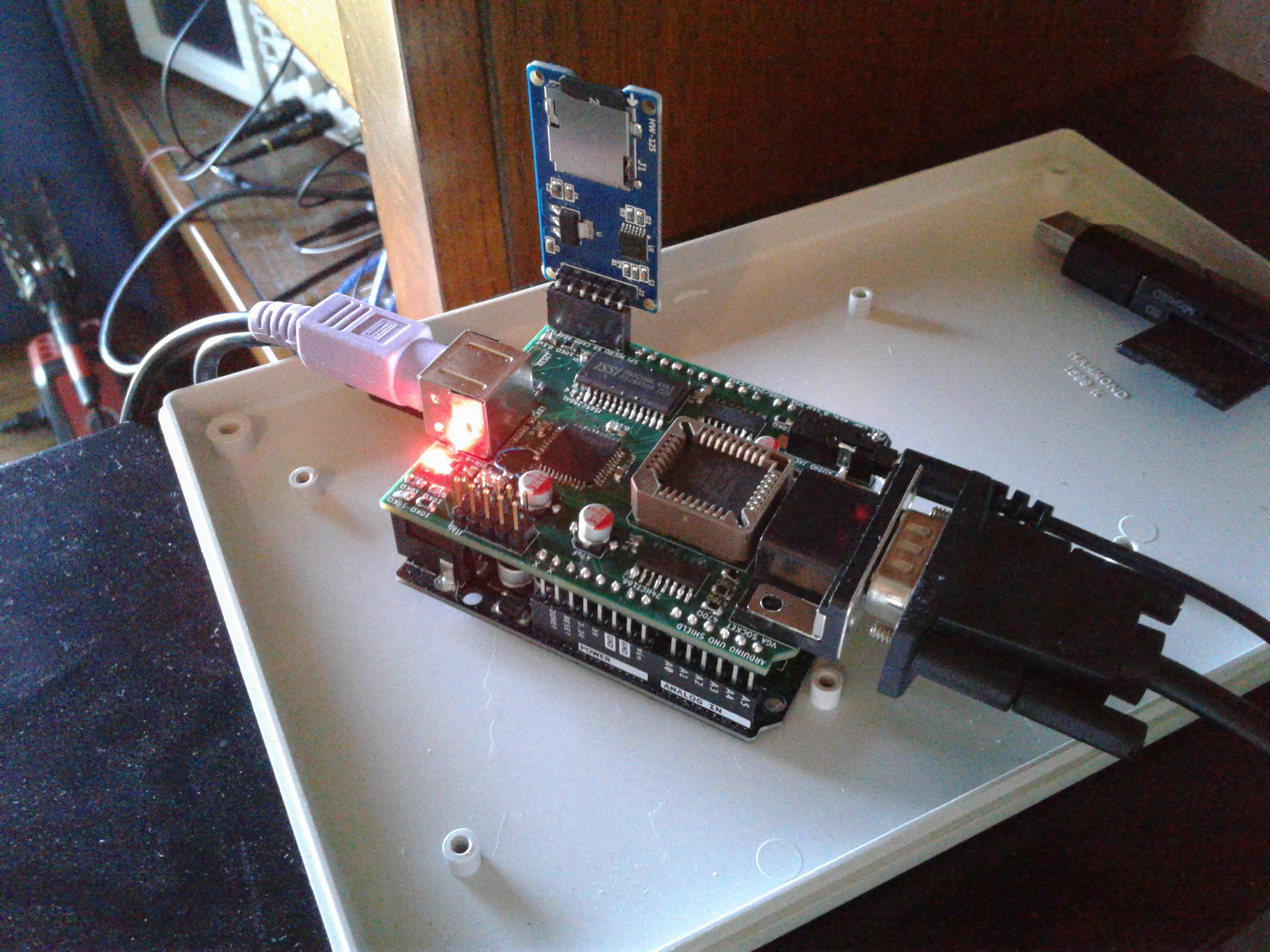

Coming from my SMD soldering topic, here:
viewtopic.php?f=1&t=7629&start=30#p101467
It works! And the first time! :)
I've done some modifying to the code and structure since the last posts, so here is a refresher/update:

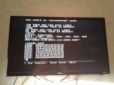

This is an Arduino "shield" that displays characters through VGA, has access to a PS/2 Keyboard, and uses an SD card module for storage. I have a fully populated W65C02 assembly code emulator/simulator inside of the Arduino's ROM (well, minus the RMB, BBR, TSB, and TRB codes). I also put a line editor in there, so that I can eventually run BASIC or some such on it.
Right now it has a flavor of Wozmon inside the line editor. That means you can type out, modify, run, save, and reload a number of monitor commands. Or you can directly access the monitor commands with the $ symbol.
The memory map has changed a bit. $0000-$01FF (duplicated to $0FFF) uses the Arduino's internal RAM which is very fast. $1000-$1FFF (duplicated to $FFFF) uses the display RAM which is very very very slow in comparison since I'm accessing it serially. The 512 bytes on the Arduino's RAM can be saved and reloaded from it's own internal EEPROM, while the rest of the memory gets sent to the SD card for storage.
This module can also be used as a 'dumb terminal', connected serially to a different 6502 unit, or even the PC. You type on the PS/2 keyboard and it sends ASCII commands. You send it ASCII commands, and it displays the results on the screen. The vertical scrolling is software based, but because it also uses the internal RAM, it is quite fast and responsive.
I plan on adding BASIC to this, as well as Tetris.
And that's it for now! Thanks everyone!
