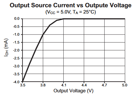

Take a look at section 11 of ATF1508B. You’ll see the output voltage can reach 4.1V with no load or 3.8V with 1mA load. I think the output can swing very wide and generate significant noise along the way. A source termination resistor of 75-100ohm may be helpful.

Bill, you are right:
There is a Voh diagram on page 18 of the ATF16V8B datasheet,
and I have missed it.
Source termination resistor is worth a try.
Yes, but... :D
The high end of that curve will be relatively slow-rising as parasitic capacitance is charged, and will likely violate WDC’s requirement that Ø2 have a max rise time of 5ns.
My opinion is a PLD should not be used as a clock source for any WDC product. A 74AC device will produce the most robust clock. 74HC or 74AHC may not have a fast enough edge to meet WDC specs.

Since I do drive clock with CPLD, all the time, I probably should analyze the timing rather than just saying "but it works".
So rise time is the transition time from VIL to VIH which is 0.3VCC to 0.7VCC or 1.5V to 3.5V for W65C02. 2V in 5nS is 0.4V/nS slew rate. According to the chart above provided by ttlworks, at 3.5V the output can source 4mA into W65C02 clock input which has max capacitance of 5pF plus maybe 5pF of PCB trace for total of 10pF load capacitance. 4mA into 10pF happens to be 0.4V/nS slew rate so even at the weakest point of the output driver, it still can satisfy the 5nS rise time requirement.
