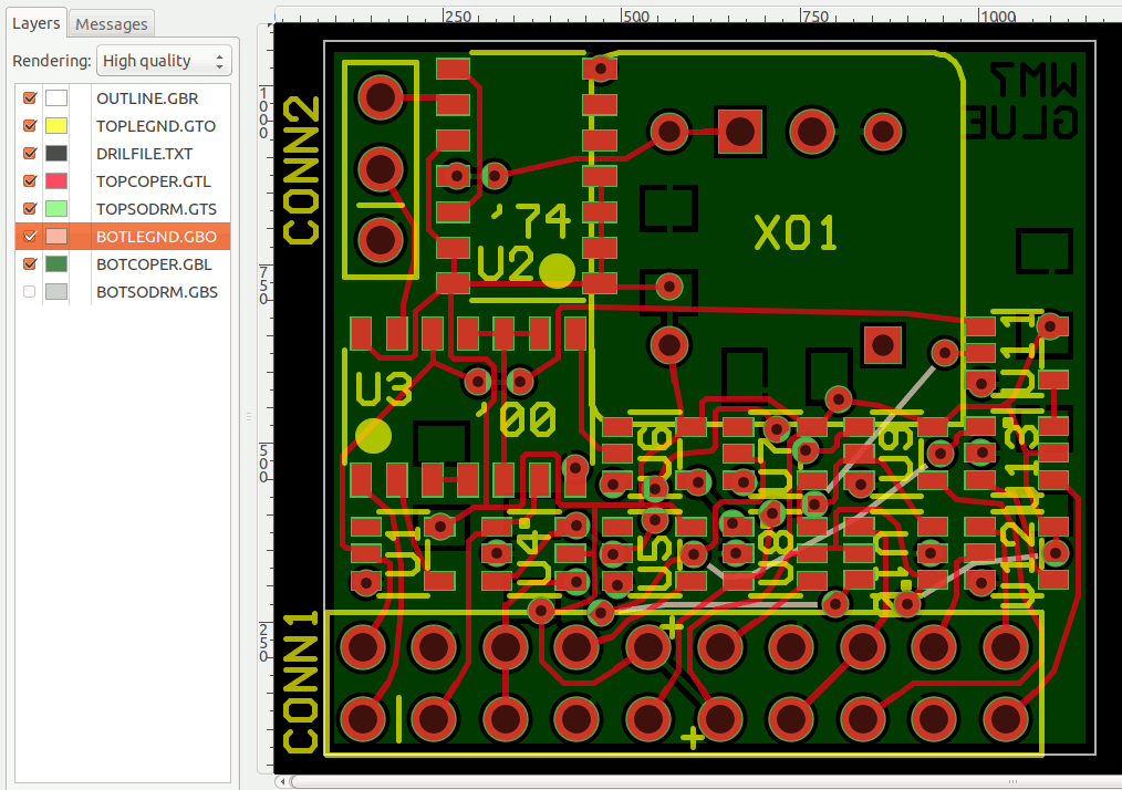

I got a board made that's very close to what you're talking about, for my '816 project which got put on hold because of work (which goes in waves) and other projects.  It's about the size of a postage stamp, and has a 2x10 pin header to plug into the motherboard, a half-can oscillator, and 13 tiny ICs, including 11  LVC1G ones.  The oscillator can will be socketed, and the edge of the can will go above the edges of some of the ICs, like eves of a roof.  I used the largest packages the LVC1G's come in, and yet I wonder if I'll be able to assemble them by hand!  I have a bag of them here.
I particularly like the approach because it "feels" like a single-chip option without needing a GAL programmer.
That was exactly my idea in doing it.  With LVC1G's running at 5V, it will also be faster than most programmable logic.

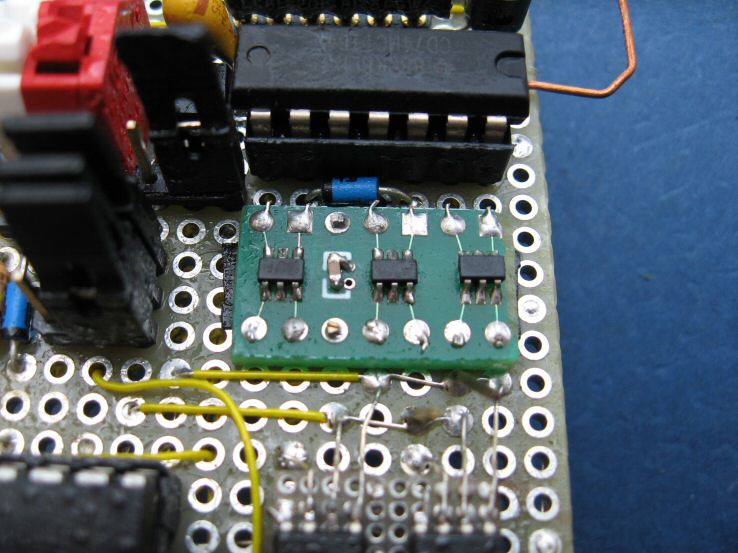

FWIW, I find the 1G Series fairly easy to solder (mainly because there are only 5 or 6 pins, and 4 of them are located on the corner where they're easy to get at). So, for me, soldering is not a problem I'm trying to solve. But rather than using a PCB I often build using point-to-point or wire wrap, and it's somewhat bothersome (though still doable) to mount 1G gates directly on a .1" protoboard. So, I created a custom breakout board specifically for 1G gates. This is an approach I created for my own needs, and I'm certainly not posing it as the best solution for everyone, but it's broadly in the same category as what you're trying to achieve. And the KISS principle applies... I ended up addressing only a very short list of problems.
ps- more about 1G gates and the breakout board here
Very nice! That's exactly the sort of thing I'm picturing, just in a more DIP-ish format. And indeed, a half-can oscillator is a pretty compact device. It does seem like I could get even more compact with a crystal and SMD caps/resistors, but the half-can is certainly easy.
Your board looks very nicely laid out. Do you have a schematic for it? I'm interested to see what of the LVC1G family you're using. Especially since I have been playing with an '816.

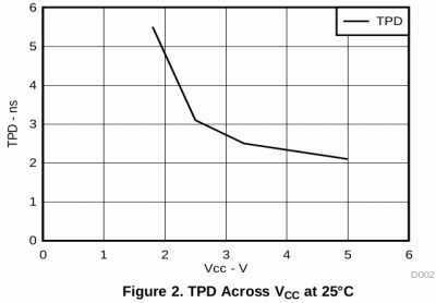

You don't need that.  Most 74LVC1G__ gates can run on 5V.  They're not just 5V-tolerant; they can actually run on a 5V power supply and put out 5V for a logic-high.
Awesome! All the 74LVC_ data sheets I've looked at -- the soic ones, not Tiny Logic -- state max Vcc= 6.5V. But the propagation delays listed only include Min and Max up to 3.3V. Would those times be shorter at 5V? Based on the trend from 1.8V to 3.3V, it would seem Max would be shorter at 5V.
PostPosted: Thu May 25, 2023 6:54 pm
Awesome! All the 74LVC_ data sheets I've looked at -- the SOIC ones, not Tiny Logic -- state max Vcc= 6.5V. But the propagation delays listed only include Min and Max up to 3.3V. Would those times be shorter at 5V? Based on the trend from 1.8V to 3.3V, it would seem Max would be shorter at 5V.
The data sheets for the many that I've looked at all have propagation delays for 5V.  There's also a graph showing how Vcc affects propagation delay, like this one from the '02 data sheet:
