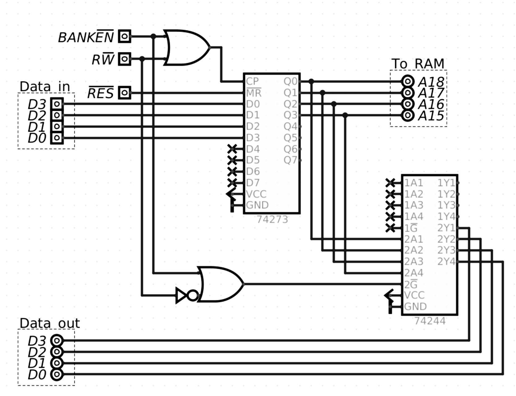

In my memory map, $0000-$7FFF is mapped to RAM (A15=0), and I want to implement banking of a segment in range $1000-$7FFF.
Since I'm using AS6C4008 SRAM, I can have 16x 32-KB banks. (I can throw in more SRAMs for more banks though!)
I want to do this with discrete components only: it would be trivial to do this with 6522, but I don't want to waste entire port of 6522 just for this job.
My kernel uses first 4K of RAM ($0000-$0FFF) for its own purposes (zeropage, stack, video memory, etc), so I want to switch banks only for $1000-$7FFF (when A14 | A13 | A12 == 1) - this is where loadable programs will live, and each of them will get its own bank. And yes, I'll be wasting first 4KB of each bank just to make addressing easier.
Here's what I came up with so far:
The plan is:
- $0000-$0FFF is always in the same bank (A15-A18 pulled high).
- $1000-$7FFF is banked with the help of A15-A18 that's latched by '574.
- $8000-$FFFF does not activate RAM at all (A15=1), so I don't care about the value of A15 that comes from CPU.
Here's how I expect it to work:
- Bank selection is initiated when CPU writes to a memory location where the '574 is mapped (/EN is asserted). I think of putting this in my IO segment and activating it with one of '138-s outputs.
- The data line is then latched by '574 at the end of the cycle (once Ф2 goes low).
- '574 stays transparent (A15-A18 pulled high) for all writes to $0000-$0FFF.
- Once CPU attempts to write to $1000-$7FFF, '574 is activated (/ACCESS is asserted), and so the specific bank is activated.
I'd like some feedback on this approach, and also several questions:
- Is it OK to have A15-A18 pulled high? I need this for non-banked RAM segment to work ($0000-$0FFF). Should I use small resistor ratings for higher throughput? (I heard high-rating resistors increase capacitance and thus slow down maximum switching speed. I want to run this thing @ 8 MHz.)
- My concept is write-only. However, it would be nice to be able to READ current bank number as well! The only solution I can think of is to have another transparent latch in reverse direction which would be activated when R/W is high, so that I can "read" the byte from the '574.
- Are there any potential caveats with my approach?
Thanks in advance! Any thoughts are welcome.

Re: RAM banking
I have [A8:15] pulled high via 10K resistors. The boards run at 16Mhz. I don't have the test kit to tell me it shouldn't work or why it's just fine, but it's been very reliable since the days it was running on stripboard. (Years now).
The reason I do it is so I can implement a mutually exclusive shared memory region ($FFxx) between the 65xx and the board host MCU (ATmega) with 8 address lines from the ATmega to A[0:7]. That way when I stall the 65xx and pull BE low on the 65xx I can read/write that top 256 bytes of RAM.
(In the '816 version, A16:20 are driven low when BE is low so the ATmega still sees 256 bytes at $00.FFxx)

Keep in mind that the '816 can initially be used as a 6502 with just more instructions and addressing modes available, even in '02-emulation mode, and you can dip your toes into the water slowly as you're ready for each new thing. This way, it doesn't have to be overwhelming or intimidating. I have an article about that at http://wilsonminesco.com/816myths/ .
The higher resistances do not increase the capacitance, but will make it take longer to charge up whatever capacitance there is on the line. The time constant is the amount of time it will take to charge it to 1-1/e of the final voltage excursion, about 63%; so if you really started from 0V, and the resistors pull up to 5V, that's 3.16V, more than high enough to be considered a valid '1' in TTL levels, but not high enough to be a solid '1' for a CMOS device that wants 70% of VDD. The time constant is the capacitance times the resistance. The concept is illustrated in Figure 2 of my 6502 interrupts primer. The link gets you to the right section of the page; then scroll down to the first diagram below the cartoon of the drug-store photo counter. Suppose you had 15pF on the line, which includes the input capacitance of the SRAM's address line, the capacitance of the 574's output when it's turned off, the traces, and maybe sockets; then suppose you have 10K pull-ups. 15pF x 10K = 150ns, probably too long. 3.3K, and if you can get down to even 10pF, gives you 33ns.

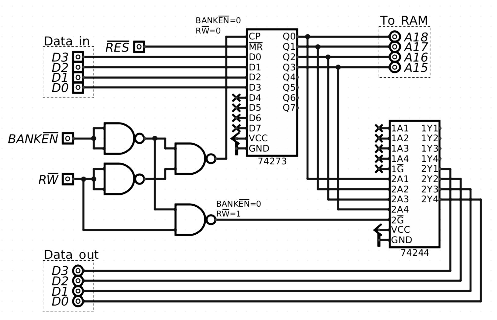

If you need to drive the address lines, rather than using pull ups, you could add a 74xx157.
If you feed A15-A18 to both input banks of the with select pin tied off high or low. With *access feeding the enable pin, the 157 will output all lows when the enable is high and the fixed 4k is in use, and will pass the address lines from your bank register the rest of the time.
If it's important to have the A15-A18 drive high rather than just fixing on one bank, then he a similar result can be achieved with enable tied low, and A15-A18 to the I0 bank and the I1 bank tied high. *access connected to the select input will then switch between all high and the bank register.
Also, how about using a 3 input NOR instead of the chain of 2 input devices to produce your *access signal. That would give you a 1 for the fixed 4k area and a 0 elsewhere with only one gate delay instead of 3.

A thing to bear in mind with the 574 is that if you want to be able to set bits independently, you either need to maintain a RAM copy of the current state to OR/AND against, or you need to arrange a way to read the current output.
If you're just writing a byte then there's no issue, of course.

Re: RAM banking
Thanks for all the replies!
This explains a lot! Clearly, I had wrong understanding of how this works.
Today I learned! Every time I have a challenge, there's always a 74' chip that I've missed which solves the problem in an elegant fashion.
Hey - I read a lot of your articles @ 6502.org, so I'd like to say huge THANKS for your work! My entire banking & context switching thing was inspired by your work.
Actually, I was planning to use only software stack in my loadable programs (since almost all of them are written in C), so entire zeropage would be used by kernel only.
However, now that you've asked this, I think there's a big flaw in my design... Namely, sp/tmp*/ptr*/regbank stuff that's used by software stack resides in zeropage, so there will be conflicts between stacks of different programs...
I might need to re-think my entire design.

I decided to return to this idea and try implementing simple preemptive multitasking by having paged RAM.
It would be very easy to do with a VIA (and I'm still planning to use VIA's timer for context switching), but I want to have a separate 8-bit "register" to hold active bank, and also to be able to read its value. I'm going to use AS6C4008, so I'll get 16x 32KB banks.
Here's what I came up with as a "cheap" read-write register:
I couldn't think of a way to do this with less than 2 chips (+ logic gates), but I may be wrong. Maybe there is a better way. Finally, I'm not sure if the above contraption is going to work (although it seems to when simulated). Any thoughts are welcome.
EDIT: Okay, turns out all chip selects can be handled by a single NAND.
So now I'm down to 3 chips total - '273, '244, and '00.
