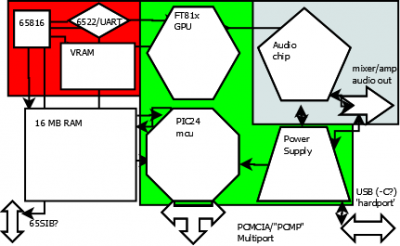

CPU Logic Unit
16-Bit 65816 @12/4 Mhz (or 8/4? tbd)
this is the frontal cortex of the system, the steering and driving chip that is most directly programmed by the user or developer.
in e mode, the system will be intentionally constrained at the appropriate OSI layer, as a specification point, it is intended here that the X, Y registers be in 8-bit modes when not directly being used for 16-bit tasks, being returned to 8-bit modes afterwards. (this probably needs clarity). A low clock for the 6502 emulation mode and low speed communications may be provided by an additional clock or a clock divider circuit.
Math Co-Processor Micromega u-FPU v2 or v3, PIC33 DSP or similar
Local I/O Unit 6522 VIA chip? (or alternative micro UART chip such as MAX3100 series)
the local I/O chip is basically optional, the PIC is going to offer an order of magnitude more connectivity and utility out of the gate, it's what it was designed to do. However, in early startup, low runlevels, recovery, debugging etc; it is desirable to examine and interact with every piece of hardware, every bit. Further, having direct access to the possible 65SI Bus/65SIB connector from this UART/support I/O chip to the CPU in the CPU core section of the board with some dedicated RAM and recovery ROM does offer a 'backup and recovery system' to unbrick the device and interface with other machines. It may be possible to not include this chip or unit, and it may create a complicated layout or OS routine to support such low level redundant I/O with a PIC24 acting as a full RIOT-esque chip. However, it does offer an extra channel or two of communication, bypasses the PIC and should support the 65SIB connector, and may allow terminal type access to the CPU, the onboard ROM and allow system recovery and updates, especially if the PIC requires updates or repair.
System Busses and Support Components
High Speed Video Bus 60 Mhz, GPU, Flash Memory i/o, the GPU has a 12.000 Mhz internal or external clock and a multiplier/divider
Mid Speed Common Bus 12 Mhz, PIC24 can run at up to 16 or 60depending on model, it at 60, it will bus to the GPU. The 65816 will also run at 12. Mhz in this case if the current GPU, a Bridgetek FT816 is used, to better sync up to its clocks and minimize oscillators.
RAM is being considered in full SRAM, dual port VRAM and traditional DRAM options. The system will have 16 MB of RAM, and may have additional RAM via a switch or RAM banking, allowing for 64MB of available RAM or More. the Integrity OS specification will further determine this. A major consideration is using high speed battery backed SRAM in 64K for the 6502 e mode to use as a dedicated 'fast page' or similar configurations regarding core functions of the 65c02/65816 in e mode.
RAM banking, fast ram for local pages banks, extended ram and rom chip options are being explored. The 6505/65816 have MMIO addresses for dedicated video access and control, mapping this to shared vram or FIFO buffers etc may be desireable to achieve GPU control without going through the PIC/board controller or even the 6522.
North Bridge Multimedia Controller Bridgetek EVE 24/32-Bit LCD Controller @60Mhz (or lower?)
offers LCD driver, GPU, mono sound engine, touch screen and flash rom access
South Bridge Board Controller PIC 24E series 16-bit MCU @60 MHz (or 12?)
UART, Timers, Interrupts, SPI, I2C, ALU, and USB services
Sound Generator Savage Innovations SSG01 Soundgin (or Yamaha FM-Synth or Similar, a PSG chip)
Mixer, Stereo, Amplifier, Headphone Out, On-board Speaker or speakers.
Stylus ERM stylus reporting on a resistive touch channel to North Bridge
Multiport external bus adapter (PC-Card type I or ISA Pin-compartible), USB-OtG
we are directly competing with EOMA, a well meaning but physically incompatible use of PCMCIA.
we are extending/forking the legacy PCMCIA standard, itself descended from the venerable ISA standard, into what we are calling:
PC-Card Multi-Port, or PCMP and it is pretty much PCMCIA as of revision 2.1 or later, possibly to include the entire 32-bit CardBus with DMA, though type i 8/16-bit cards are enough for now.

Posts: 11464
Re: 65816 Project "Integrity"
Welcome!
What stage are you at? Do you have any diagrams, or sketches, for example? Or perhaps you have some detailed ideas for circuit design?
Perhaps more important: what's your next step?

lots of data sheets.
not at PCB design just yet. some function block stuff. I recovered a draft of a flash deck.
at one point I had many pages full of notes, and they were lost to a move
at another point, I had been on the phone with LCD makers for the screen unit, years ago
atm, Im gearing up to prototype in the next year or so.
I am working on a BIOS demo on the emulator when I get time here and there.
my next step?
I call people next week and talk to sales reps or tech support at different places.
I need clarity on some clock speed concerns and interfacing with other chips.
finding an FM synthesizer

so, looking over the PIC and the 65816, they both use 16MB of RAM, and similar 24-bit addressing, the Bridgetek chip use 24-bit SPI, over a dedicated 4MB control space for each of it's media functions
the bridgetek also has an internal, or is driven by a 12 Mhz oscillator, so thats probably going to drive the board
I am looking at alternatives to the Bridgetek, however, it does seem well suited to my purposes.
What I want, is a ROM BIOS that loads up in 6502 'e' mode and has as direct of control as possible over the hardware directly. so its going to set its MLB(?) pin and lock the memory to itself first. (I think) and it is going to load a very simple 'pre-boot environment' or 'micro-shell', like a runlevel 1 or something
and at this point, its a 6502 and a screen and some RAM and a few buttons.
this would be a diagnostic type mode, you would have a simple rudimentary shell with a few commands, maybe a Hex-editor or such, and it would POST here. you would basically be able to hit a button or two, and go into a 'fullmode' or select a mode here. this could be set to automatically skip this screen, or bypass this mode unless in 'recovery set' mode
so just, like, the MS-DOS on a floppy, MS-DOS.SYS, COMMAND.COM and like AUTOEXEC.BAT basically
something that fits in a tiny ROM you can unbrick the device from
uh, BIOS+, 1MB-OS type deal
so once POST is done, the device (the 65816) turns over everything to the PIC and the GPU starts doing it's thing. so prior to this, if possible, the LCD may be driven directly by the 65816 (or rather an SPI controller or if required, the GPU in a low level mode, B&W, etc) some of this is ideally customized by the user and all
so, Im not certain a 65816 can run the LCD on it's own, though if it can it should, and it should 'run' everything on the system at first and start up all of the other chips, for instance, the GPU needs a command set of what to draw, and so the 65816, the Logic chip, will load into it's 4MB space (I guess this means its using 4MB of shared memory, or better, it gets some VRAM of it's own. It has a killer PC-speaker type mono sound driver, several nice color modes, a touch screen driver I think I can get to work with a pressure sensitive stylus instead of being a touch screen. like a wacom. the PIC has a DMA controller, and some 65186 have MLB(?) pins to lock out RAM, I still wonder about maybe a dedicated bus, spi, dma controller for the 65816 instead of using the PIC's
anyway, once the system is loaded, the PIC 'runs everything', it does USB, it does SPI, it does DMA, it does ADC, it does some basic Multiplication and Division.
while the PIC has 16 registers, it works very differently to the 65816, it seems more like, idk Ladder Logic maybe, than a general purpose chip?
I do not know, Id have to read more on both, however, they seem to compliment each other well and share many characteristics.
I want to have system software that runs on the PIC, and program logic that runs on the 65816, and uses the Bridgetek LCD controller as a GPU, which I think it can do.
this is going to be in the ~$250 price range I think
because of the screen. Maybe $300. If I can get the device and a peripheral or two to $400, like a docking station and a case, or extra battery and some I/O ports, that might be ok
the chips and RAM are not much, nor will the assembly and case if done in volume, so far, I can get everything from US, Japan, Taiwan India and Korea, even the LCD, Tianma

Well, I'm curious...
It sounds very interesting, but also somewhat odd at the same time ...
The sort of project that requires you to "talk to people" for components are the ones that are expected to ship in the 1000s or more. Often much more in these enlightened days where we go to Mouser, Digikey, etc. for even 100s or components...
So what is it?
Sounds like some sort of hand-held multi-media/PDA/data acquisition/tricorder "clamshell" type thing (in which case there are far better CPUs for it) or some sort of retro equivalent?
Using "smart" graphics controller chips - well I'm guilty of that to a degree - the other side is that even a 16Mhz '816 will struggle to manage a memory mapped 800x480 pixel display at any reasonable speed although 8bits per pixel may be feasible, even then it's 375KB or just under 6 banks of 64KB which makes even something as simple as clearing the screen an issue. if you can get a high speed SPI interface to the '816 then it could do it though - providing the commands are of the form "plot a point", "draw a line", "put up a menu with these icons, these input areas, and load these images from the on-board SD card"... (I've used 4D system smart displays in the past like that).
Not sure about your speeds - why run it slower in emulation mode? My system runs at 16Mhz in native or emulation mode. Native mode is technically harder to run faster as you have to sample and latch the upper 8 bits of the address bus at the right time...
Then the biggest crux of them all - software.
Your talk of booting - a BIOS - needing 1MB of 6502 code... Are you aware the 6502 can only normally address 64KB? Systems "of the time" typically had 2KB of "monitor" then maybe 8-12KB of BASIC then maybe up to 32KB of RAM... The BBC Micro was 12KB of Operating system and 16KB of BASIC with 32KB of RAM. This sounds like a system more complex than either the Communicator or the //gs was at the time - and that's before going into native '816 mode...
In native mode I suspect you'll eventually need an operating system to handle that. I know of 3; First is the Acorn Communicator - a sort of 65816 version of the BBC Micro. They are rare, but the ROMs are online. 2nd is the the Apple //gs where there are Pascal and C compilers for, the other is my own Ruby BCPL OS. Great if you like coding in BCPL, I guess, but while it's faster than BASIC, it's still slow.
My own thing has an ATmega as the board host controller - that runs at 16MHz with the '816. For me, it took a lot of the "heavy lifting" of IO, serial, SD card (and originally video) off the '816. And I could write all that code in C rather than 6502/816 assembler.
Anyway, please do keep us informed about progress - I don't think we've had anything really tangible in the '816 world for some time.

Posts: 3526
Welcome, wayfarer. :) It would be good if you can share the function block stuff. Most especially, it would be good to see an overall block diagram of the entire system. Ideally that'd show the various buses between blocks.

wayfarer
Posts: 191
Joined: 19 Mar 2023
Post by wayfarer »
Function Draft 1.png (9.98 KiB) Viewed 3655 times
just the start of one, Im starting high level and I am going to dive into each section further.
Right now, I want to get that Red section in the first post. figured out, thats the main logic unit of the system, and should be able to mostly operate on its own, with the rest of the hardware halted or powered down, that also leaves the PSU power unit, and I am not certain the 65SIB is going to get its 12v, though it might be possible to use when plugged in on the "high voltage service buss", atm, a 12v buss to flash eeproms with maybe. Ill have a better block diagram in a few days.
