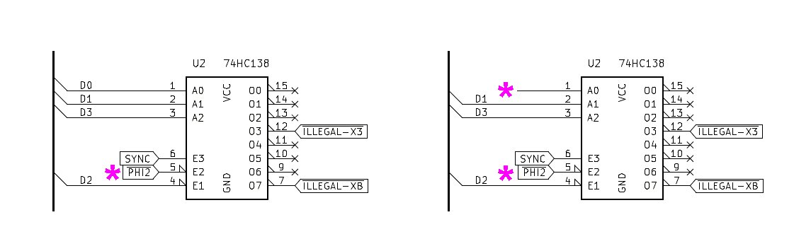

Just a quick question. Do you really want SO to the CPU to be asserted whenever either SPI_MISO is low or you execute a _B opcode? That could result in the overflow flag being randomly set thus rendering it unusable for its usual purpose. It would seem more useful to assert SO if SPI_MISO is low AND a certain _B opcode is executed - this would allow the CPU to sample the SPI_MISO signal into the V flag but leave it alone otherwise. Also, note that SO is sampled on the rising edge of PHI2, which might complicate things since _B opcode detection happens when PHI2=1.
The idea with the AND gate is that I didn't have any others to spare. It works though, as far as I can tell:
MISO is normally pulled up, as is the /ILLEGAL-XB pin. If MISO stays high during a read, I will CLV, toggle the /ILLEGAL-XB pin, and it will set the V flag. If MISO stays low during a read, I will CLV, toggle /ILLEGAL-XB, and nothing changes.
The illegal opcode circuit for the '138 and '259 came directly from Dr Jefyl's own circuits, so I'm kind of relying on that here. I intend on putting some NOP's after each of these $_3 and $_B just for safety.
Thank you, good question!

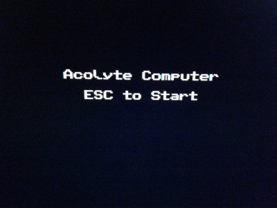

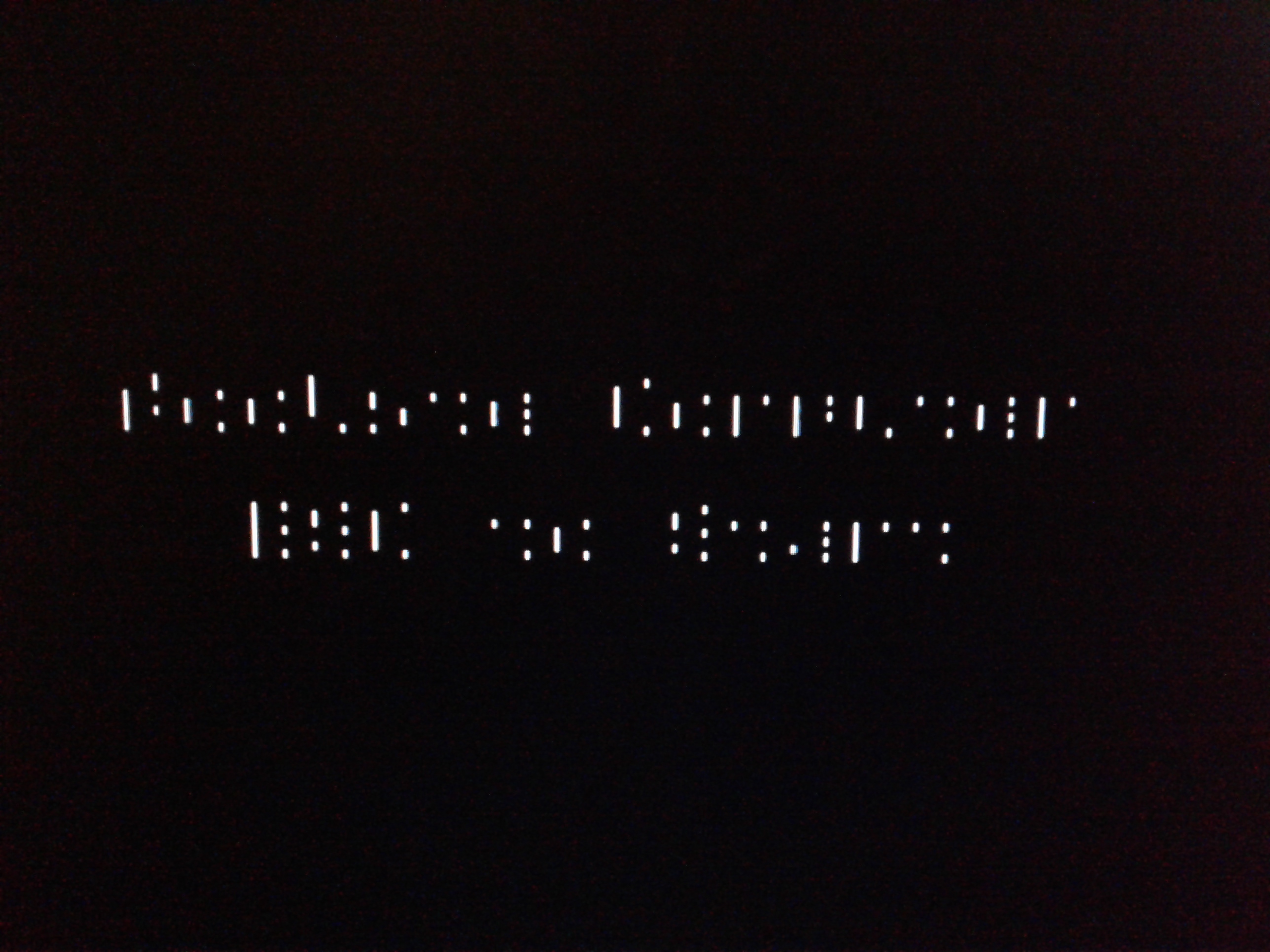

Re: Acolyte Revision - Schematics and Documents

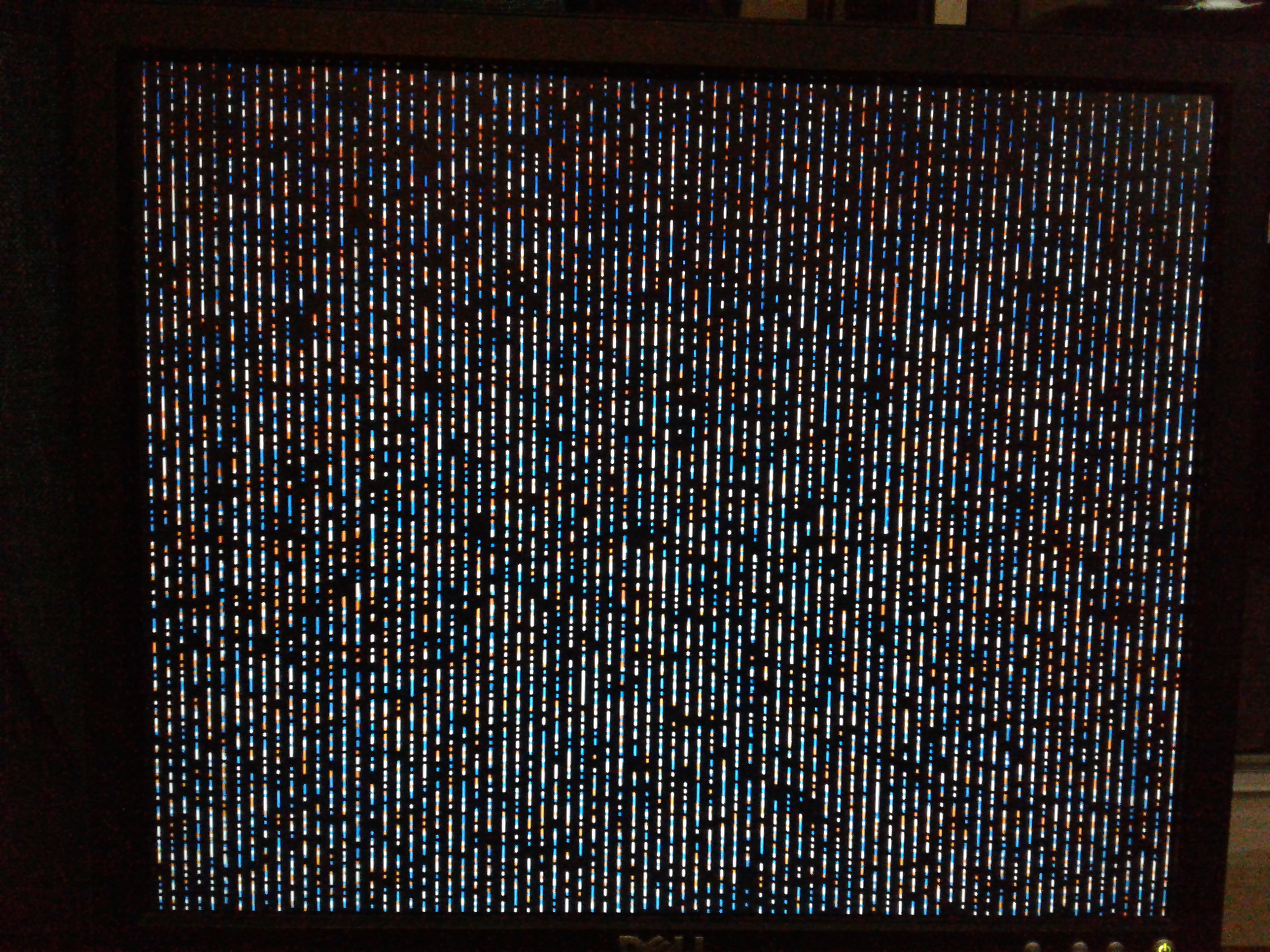

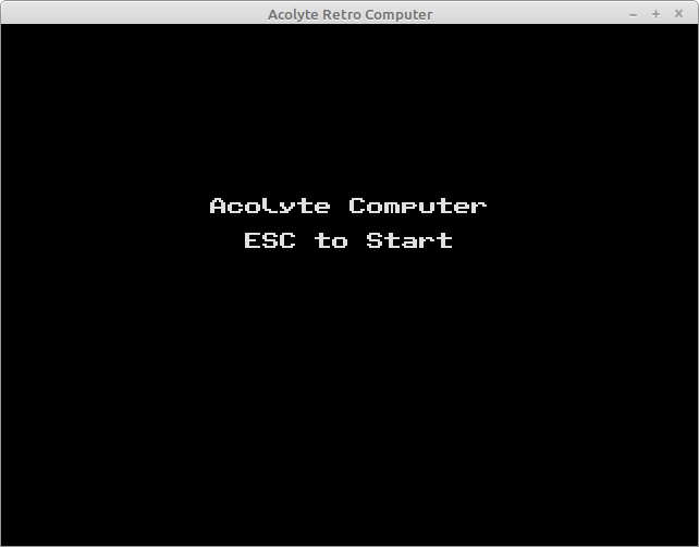

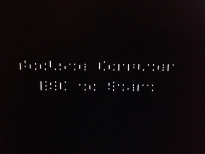

Hey everyone!
It... kind of works! Very kind of. Attached are some pictures.
The color pictures are from when I take the CPU out. The tiny white pixels is from when I put the CPU back in. The simulator screenshot is what is expected with the CPU put in. Also attached are schematics.

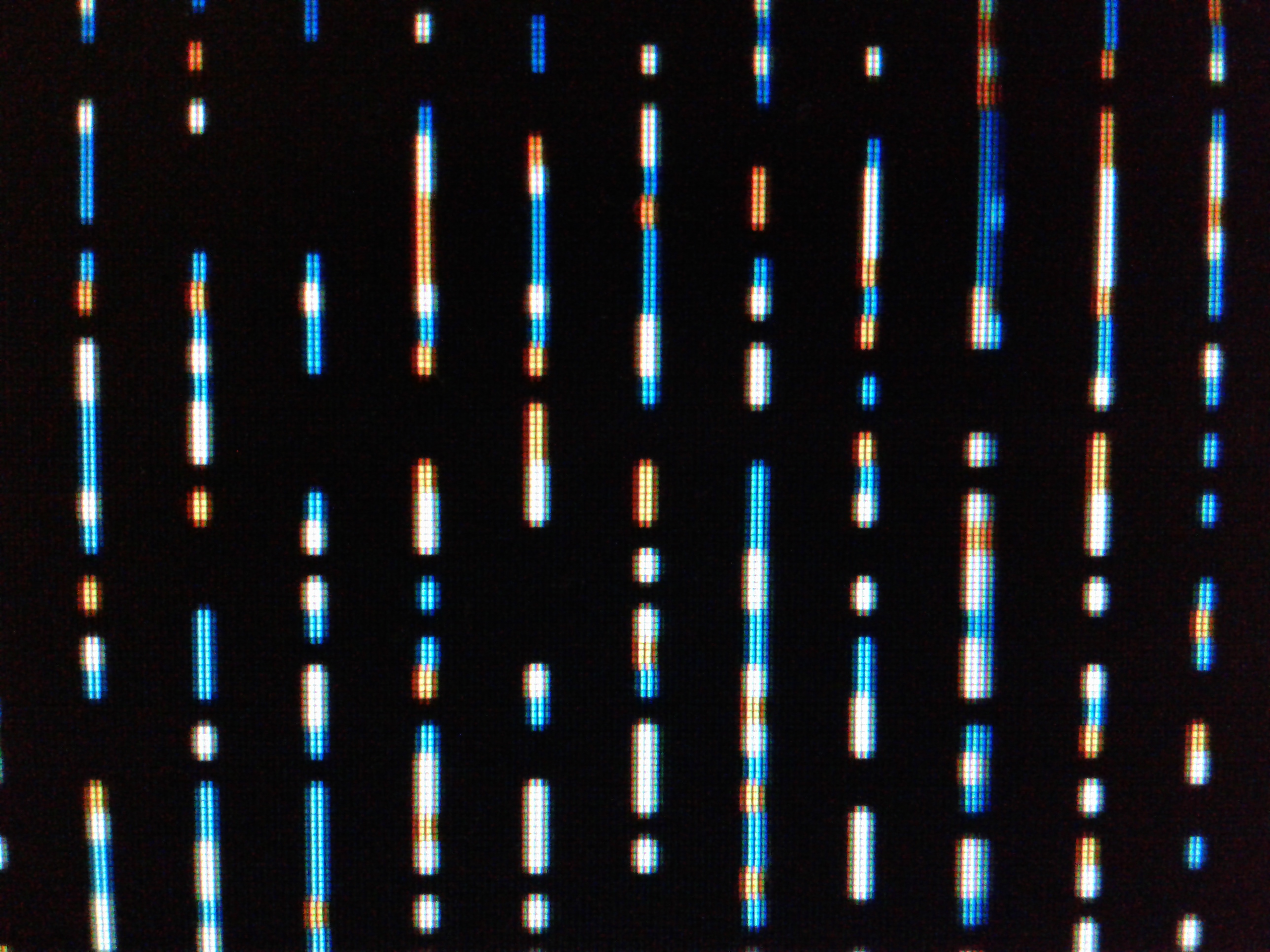

So, what is going on? Only the very first bit from the 74HC166 shift registers is latching. Or the others are getting cleared immediately afterwards. Or I have just entered looney-land. This seems to be a video-side only issue, because you can see that the CPU is actually DOING what it should be doing. But when it needs to be displayed, it just doesn't quite make it. Thing is, the video circuit in question is identical to ALL other boards I have used in the past, I did not change ANYTHING on that side of things.
I've probed the heck out of this thing, so here are some findings:
1) The Video sync signals from the 74HC377 seem perfect. The monitor says 60 Hz, I checked horizontal and vertical timing and they are incredibly accurate. The signals seem like square waves, I don't see any unexpected dips or weirdness. I replaced that chip as well one time and it worked the same.
2) The VISIBLE pin from the '377 is likewise working as expected. It turns off the color when it's overscanning the screen. That pin is a constant high while latching these data bits and when displaying. I have found no issues with it at all. Likewise, the speed at which the VISIBLE pin is latched onto the '377 would mean eight pixels would be on or off, not just a signal pixel.
3) The /LATCH signal timing is right on. Obviously the '377 is being latched at the same time as the '166s, and it is doing great. I once changed the logic of it's /BE pin to /PHI2 and it did exactly the same thing.
4) When I probe the /LATCH line *twice* the shift registers just stop working entirely. Yet the '377 keeps going. When I tap on the /LATCH line with *one* probe, the vertical lines just ever so slightly change. I traded out a '166 with another one from a working board and there was no change. I've taken out one shift register so only one is on at a time and no change. I'm guessing that two probes cause more capacitance or something? The probes would both show that signal, and it's strong and identical, but the shift registers don't like it at all.
5) I tried putting a small resistor in-line between the /LATCH signal and the '166s pin 15, and it only got worse though still similar. I also tried to bypass my transistors but there was still no change. The output signal from the '166 is just one pixel wide and then goes to ground every time.
6) I checked /CLK and it seems fine and opposite of CLK.
7) Again, I see the 6502 has cleared video memory and put in it's own memory. To display text characters means basically everything there is working fine: reset, stack, RAM, ROM, addressing, etc. And the right signals are reaching the '166 as well, all of the data pins show activity while /LATCH goes low, nothing is floating. And the '377 with the exact same /LATCH and /CLK signals is working fine. So, what am I missing?
8.) All chips are in the right sockets. I even tried to replace the 74HC10 and the 74HC161 and it does the same thing as well.
9) EDIT: I also have connected random datalines and clock signals and /LATCH directly to the VGA output, and I get color bars as expected. So the monitor is also working as expected.
Summary:
Both '166s are acting identical, and replacement chips do the same thing. There is no occasional noise in between the bars, it's just black. CPU is not acting strangely. The only other chip using the same /LATCH and /CLK signals is a '377 and it is working very much as expected.
Because the lack of noise, I figure it is a logic issue. But I have checked again and again and cannot find the issue! I have checked the board for any loose connections or soldering mistakes, but I cannot find any. It is just such a consistent error!
ANY suggestions are welcome. The board works, except for the video circuit.
Thank you for you time.
Chad
What happens if you tie the '166 serial input to VCC instead of ground? That might help narrow down the problem.
I actually broke off the leg for the /MR pin on one of them just now, oops! But it still outputs, hm.

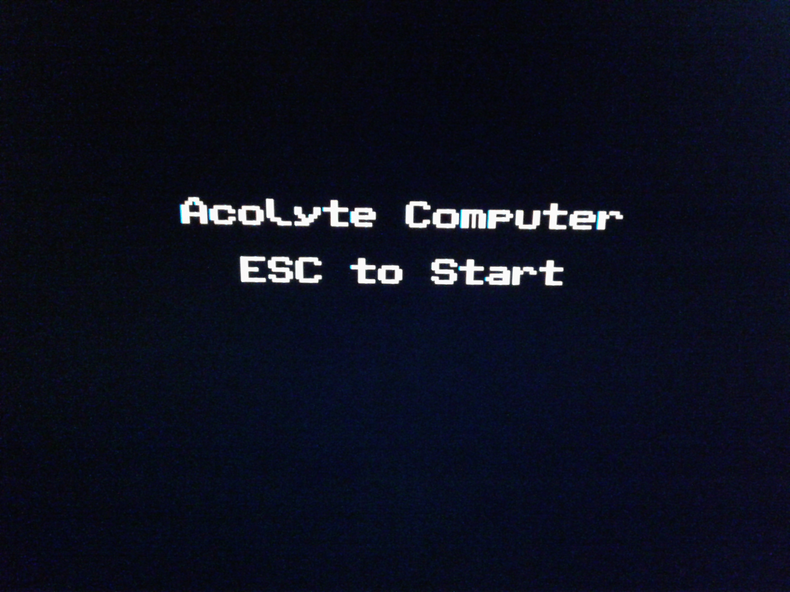

I got my keyboard working with the funky interrupt stuff. I'll clean that up later but I'm glad that works.
So! I technically have this computer working, yay! Except I just don't understand why I need to use CLK instead of /CLK.
Regardless, I'll be making patches of this soon, and then giving a full update with code and all that eventually.
Thank you.
Chad
I was thinking you could send a whole screen of spaces, with the serial input tied high, and see if you get any "1"s. If you did, that would mean it was shifting, but the parallel load was off somehow. Also you could try sending a whole screen of "blocks" (0xFF bytes). If you saw any spaces it would show you where the control signals were off. And so on. The "nice" thing about video circuits is that when something goes wrong you can see it going wrong over and over again!
Seem like you are making great progress. So it is working now with shift reg ('166) clock at CLK instead of /CLK? Seems to me there are long prop delay from clocking of '590 to valid address outputs to RAM putting out valid data to be latched by '166, so changing phase of CLK may catch the data "in flight" better.
Raise the voltage makes parts run faster; raise temperature makes TTL run faster but slow down CMOS; probing with a steel needle slow down signal with your body capacitance; so use combination of these facts to find the critical path.
Thank you both. Yes, a black screen showing a color tick would indicate that something is not right! I will have to check that later.
Bill, I will probably try to use the soldering iron and the freezer to check if things change. I don't have any other fancy tools
Good ideas though.
So, I was thinking, if you remember:
viewtopic.php?f=4&t=7154
With my last revision I had a flicker problem, but it would go away if I heated up the '161 clock divider. Then I swapped the '161 out with another and it seemed to work. A small update on that: Since winter is/was here, the board got cold and sure enough, the flicker came back ever so slightly. Hm! So that first '161 (the canary, as it was called) just had different margins I guess. It was either faster or slower, ever so much, that it caused the flicker. And then this newer one didn't flicker AS MUCH, but it still did in the end.
What if the timing on those shift registers was the real problem the whole time?! What if I had my /CLK hooked up to them and I should have had CLK instead? Then that original '161 might not have flickered at all! It was never the '161s fault, it was the shift register's fault. Just a hypothesis. Basically: Maybe my logic on using /CLK was wrong for the past 6 revisions, but it wasn't showing up much until I tightened my glue logic a lot. Hm.
I'll have to test that sometime, it wouldn't be hard to just bend a pin on the old computer and check.
Another thing I remember seeing last night when I was probing this board: My '377 still ran smoothly with /CLK, but when it was first getting those signals online, it had a weird semi-dip around the 2.5V range, just for a few nanoseconds. Not as clean a square wave as I wanted, but it was working so I ignored it. Perhaps that was an indicator as well, that I should have been using CLK and not /CLK the entire time. More hm.
Anyways, will do more testing later. Thank you all.
Chad
Chad
