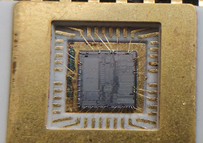

Hello, I've been going through some things left to me by a family member, and found these. As I understand it, 6501s are pretty rare, what with Motorola suing MOS back in the day. I have no real use for these, so I was hoping to ask the experts here what they though I should do with them? If you're aware of any computing museums that would be interested, or if there's a market for them, I would appreciate any input.

I would have gotten a better picture of the die, but I don't have a microscope handy at the moment. I have two of these ones with the hole where the lid should be, I've not found anything on those in my internet searches.

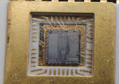

Re: Inherited microprocessors
Quick addendum: oddly, the chip in the delidded package doesn't look much at all like a 6502 to me, even a revision A 6502. This has me very confused! A microscope photo would be a big help here.
I've taken the liberty of attaching a thumbnail of your photo.
delidded chip found in a collection of 6501 chips
That said, it does have the general layout of this kind of microprocessor design. But to me it doesn't look like a 6502, 6800 or even 6809.
(The history as I understand it is that MOS set out to produce both the 6501 and 6502, but they have very minor differences on the inside and are essentially the same design with different options. I would very much have expected a 6501 to look very like a 6502 in broad terms.)

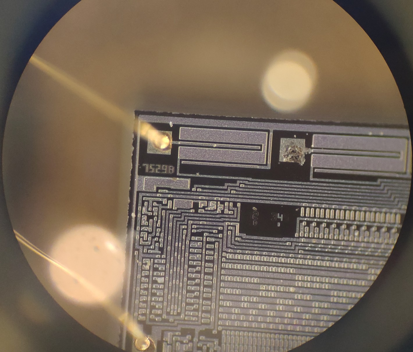

Thanks guys for your input! I've gone and found a microscope to take better pictures of the die. It should be noted that, because I don't have the right size objective to fit the whole die in one shot, this is a very crude (it's not even square) composition of ~9 or so photographs, taken with my phone shoved up against the eyepiece. Just thought y'all may find it interesting. I can't say for certain that these delidded ones are indeed 6501s, I just assumed they were, because they were in a padded envelope with the others, marked "antique 6501 chips".
https://files.catbox.moe/p2gjvc.jpg (2740x2690)
Certainly interesting! I wonder if it's a calculator chip? It has a ROM.
https://commons.wikimedia.org/wiki/File ... d_1974.jpg
Edit: but the advert shows 28pin chips not 40pin.
Edit: can you tell just by looking that all the delidded chips are the same design?
Oh hang on, at top left is that a part number?

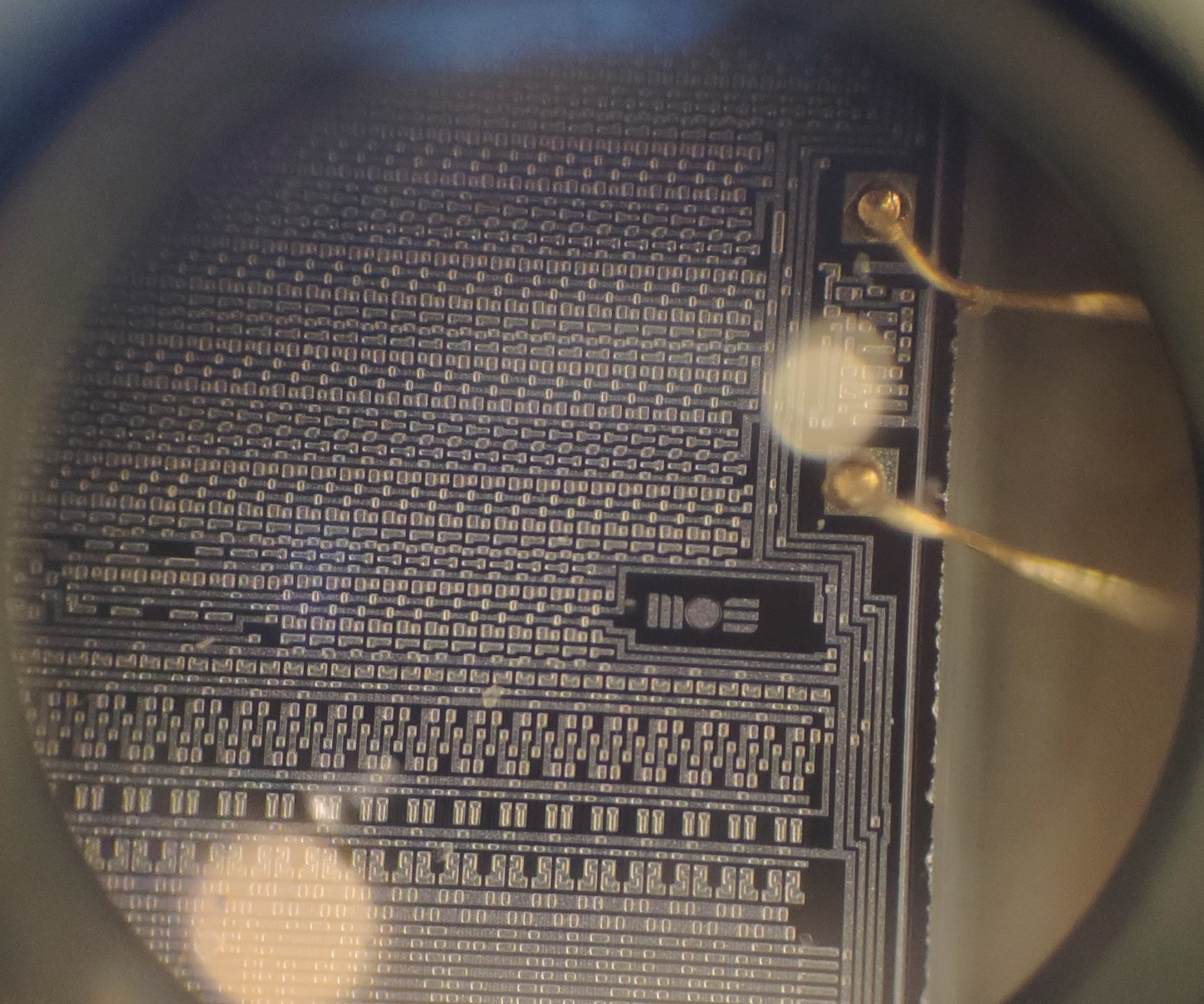

Cranked up the zoom to check and yep, it does appear to be a part number, or batch number. Both delidded chips have the same number (75298). Also present is an MOS logo. Not sure what the "2 34" below and to the right of the P/N is. Maybe batch/panel?
MOS logo
MOS logo
Oh, great - it is indeed a calculator chip, the 7529, in this case revision B. Only thing is, usually seen in a 28 pin package.
COMMODORE: SR7919 (version-2)
Main Components: MOS TECHNOLOGY: MCS7529,
https://www.richis-lab.de/MCS7529.htm
https://www.petervis.com/Calculators/Pr ... ipset.html
https://www.thecommodorecollector.com/c ... i-computer
(The 234 you see are the mask IDs - there are 6 or 7 masks, and each has its own number. But on the silicon only some of the layers will be visible to the eye.)
