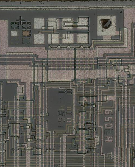

BTW Antoine Bercovici (@siliconinsid) posted a hi-res photomicrograph of a white-package 6502 rev A a few months ago on https://siliconpr0n.org/archive/doku.ph ... :mos:6502a (interactive viewer at https://siliconpr0n.org/map/mos/6502a/mz/, twitter announcement: https://twitter.com/siliconinsid/status ... 6901727236)
excerpt:
Re: Process geometry information of original 1975 MOS 6502
Oh, very nice indeed! If we knew the exact die size we could work out the approximate gate length (aka poly width)

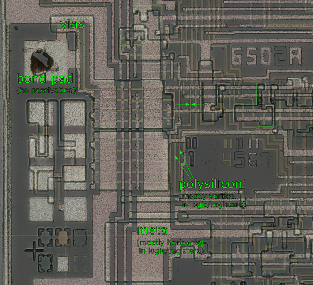

Just so I get the photomicrograph interpretation right, here's an annotated image of that area (rotated the "right way" with decode ROM PLA at top, control logic in middle, registers at bottom, text right side up)
  • the funny submarine-with-periscope shape (outlined in green) is an example of a region with diffusion layer
  • metal layer is pinkish speckled, except where it's exposed as contacts (not covered with a passivation layer) as in the bond pads, in which case it's grayish speckled; metal is mostly horizontal in the control logic/register sections
  • polysilicon layer is brownish lines mostly vertical in the control logic/register sections
  • vias are the little oval dots that are sometimes visible
  • the green arrows pointing toward a polysilicon track would be the place to measure gate length = poly width

Sounds about right to me. Just one terminological thing: I've always seen contacts down to poly or diffusion described as contacts or contact cuts. Vias, in my world, are cuts between one metal layer and another, and of course there are none in a single-metal process like this. (Sometimes vias are not just a cut, but a conductive pillar through the oxide.)
About the green arrows: yes and no. The tracks in that area look a bit thin. This might be an optical effect, or a real one. The thing to measure would be the poly as it crosses diffusion, which makes a transistor - see the three of those going north to south over the "submarine" - they look a bit wider to me.
(Also to note, sometimes you will see diffusion labelled as active area - same thing, different terminology.)
Oh, another thing, the cuts in the passivation layer, that's mask 7, I wouldn't call that a contact. Sometimes passivation will be called overglass, in another variation of terminology.)
Oh, also, probably better to call the 7 numbered things masks, rather than layers.

I tried measuring in 6 places and got the following poly widths (through my crude eyeballing method), where "nm" is whatever scaling factor is applied on the image. The whole die is about 39550 x 43840 "nm" (39550 = east-to-west aligned with text, which is up-down in the existing image)
# https://siliconpr0n.org/map/mos/6502a/m ... =14809&z=8
# 61nm
# https://siliconpr0n.org/map/mos/6502a/m ... =15352&z=8
# 62nm
# https://siliconpr0n.org/map/mos/6502a/m ... =14789&z=8
# 59nm
# https://siliconpr0n.org/map/mos/6502a/m ... y=8144&z=8
# 67nm
# https://siliconpr0n.org/map/mos/6502a/m ... y=8171&z=8
# 71nm
# https://siliconpr0n.org/map/mos/6502a/m ... y=6184&z=8
# 65nm
Throwing away the high and low, I get an average of 64nm = approx 0.162% of full die width.
For a real die of 168 x 183 mils (=4.27mm x 4.65 mm) (quoting EDN article) this would mean a poly width of 6.9um.
For a real die of 153 x 168 mils (=3.89mm x 4.27mm), this would mean a poly width of 6.3um.
Not sure what to make of that; I'll see what @Siliconinsid comes back with, for the full die size.
