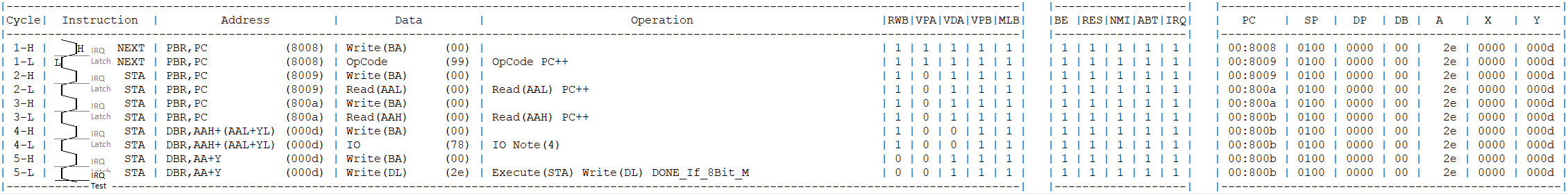

...and here they are: my questions are around the timing of specifically the ABORT and IRQ interrupts because they're level triggered.
If you take a look at the picture below (really just the Instruction column) you'll see I've sketched in the clock with time increasing from top to bottom.
Where is IRQB latched in the 65816? I've made the assumption that it is every falling clock (high-to-low transition). But is that right? Or is it only the very last cycle in the instruction? (In this example would it be only 5H-to-5L?) Again I'm assuming; the point at which the 65816 tests if an IRQ has occurred must be on the final low-to-high clock transition in the instruction? In this example 5L-to-1H before the next op-code fetch.
And when is ABORTB latched? I'm guessing it is also on each falling clock as it must be tested on each rising clock in the instruction?
Each cycle of 65xx starts with phase 2 low, not high. It's low when it is setting up the address, R/W, ML\, VP\, VDA, and VPA. It is high for the second half of the cycle, not the first.
In my tests a few years ago, if I pulled IRQ\ down in the middle of the high (second) half of the operand-fetch cycle of a conditional-branch instruction that was to be taken, it would take the branch, but load and discard the first op code at the new address. I'm sure I have more test results somewhere, which I'm not able to find at the moment, to see if pulling it low during the op-code fetch would keep it from even taking the branch. Same thing below. I'm just looking at scans of the some of the printouts I have in a file somewhere. I know it's pretty incomplete, but hopefully it will still be of some help.
When I pulled ABORT\ low during a TXY op-code fetch, in the middle of the high (second) half of the cycle, it would fetch the next address in its dead cycle (since TXY is a one-byte, two-cycle instruction), then fetch the next instruction again as if it were going to execute it, but would discard it, then have another dead bus cycle, then head into the ABORT\ sequence.

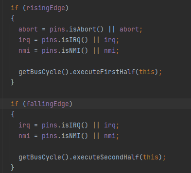

Also it was good to know about IRQ and ABORT, thanks. I'm going to take a 'good enough' approach to emulating them as I hadn't realised how complicated the 65816 really is. I've simplified down to the code below for now.
(In the case where IRQs are disabled but irq is set I clear irq just before the test for it is done. Probably not how things really work but close enough for now)
