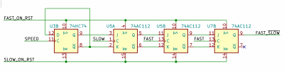

So this is what I came up with after reading the double-flop article this morning. Is this what you had in mind?
If SLOW and FAST have synchronized phases so that U5A is triggered too close to the falling edge of FAST, then the setup time of U5B is not met and it could go metastable. This is fine because it has up to the period of FAST minus the setup time of U7B to settle. Then, the next falling edge of FAST will correctly propagate the value to FAST_~SLOW. This adds one flip flop delay to determining the max frequency this can run at. However, that is fine because the limiting circuit is still PULSE_~RUN, so it does not change my max frequency.
One thing I'm unsure of is what happens if U5B starts changing while still in the hold time of U7B. Thankfully for this specific J-K flip flop the hold time is 0 so it shouldn't be a problem here.

I used a variation of Figure 3 on this page:
https://www.eetimes.com/techniques-to-m ... itch-free/
to do clock switching between a fixed 8MHz clock and a variable 8 to 50MHz clock for a 68000 board. It was implemented in an ATF1504 CPLD.
The circuit relies on both clocks running continuously - single pulses won't go through. If you want to use it for single stepping you will have to generate additional pulses on the SLOW clock when you switch from fast to single step.
If you only want it for single stepping rather than running from two completely different unsynchronized clocks there is probably a simpler way of (1) stopping the main clock and (2) allowing a single clock pulse through before stopping again.

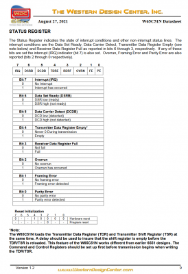

Nice! Your video almost inspired me to use a W65C51 as it feels more period appropriate than the TL16C752D I've got. But it's a bit expensive for what it it does and still has the hardware bug. And that issue is what prompted me to post - I was thinking surely WDC must have fixed the issue by now and browsing the data sheet doesn't mention any issues or errors...
Until I read a little more closely
Seems the data transmit empty register just does nothing now and that's officially the way it is.
I mean I get it from WDC's point of view. It must be a very low volume IC and I doubt it is profitable. There isn't even a LQFP version and I wonder if that means they only did a single run of the buggy versions and haven't sold that stock yet. Just idle wondering.

Yes... the documentation has been changed to call it a feature versus the defect that it is. Sadly, I've got around 10 of each of the new featured parts... DIP and PLCC... and can't really use any of them, as I've no interest in programming around defective hardware.

...I've no interest in programming around defective hardware.
Amen to that! Even without the TxD bug, the 6551 would still be a garbage design.

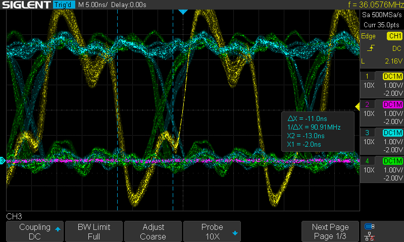

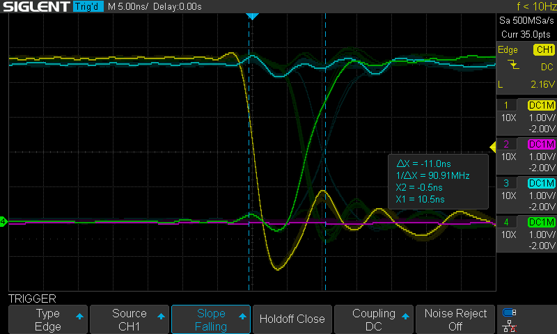

But what BigEd and Proxy have mentioned is important. The clock speed basically doesn't matter* it is the rise, fall and delay time of the signals that you need to think about.
Above is a view of an '816 running at 5Hz (Hertz, not Megahertz) at 5V and even at that very low speed notice that once PHI2 (in yellow) falls the address lines (in green) are already set about 11ns later.
Whereas here the same program on the same '816 is running at 36MHz at 5V and you'll notice that the propagation delay from PHI2 falling to the address line being set is still 11ns. (The RWB signal is in cyan and pink is not connected.)
Interestingly the '816s response time barely changes until under 4.2V
* Well, I mean, obviously the clock speed does matter. Too fast and the '816 is still doing stuff internally when PHI2 rises on the second half of the cycle. And all your logic propagation timings must fit within your chosen clock.
