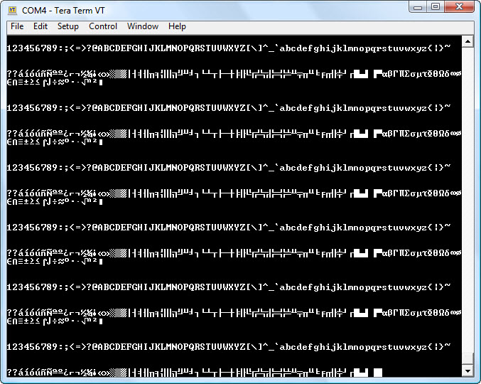

I tried the JMP instruction that wrap around 64K boundary. the W65C02 works at 33MHz but failed to execute correctly at 34.5MHz. Screen capture shows when it is operating properly.
I'm driving the W65C02 directly with the output of the can oscillator. I'll try buffer the oscillator output with the CPLD and drive W65C02 with output of CPLD which has faster rise time.
;ROM space from 0xC000 to 0xFFFF and from 0x0000-0x3FFF
;Actual ROM is 64 bytes, alias every 64 bytes over the ROM space
;serial port space from 0x4000 to 0xBFFF.  data is at even address, status is at odd address
;  Status d0 is receive data ready; status d1 is transmit empty
SerData = $7001   ;Serial transmit register
SerStat = $7000      ;Serial transmit status
   .pc02
   .ORG $FFC2
; ROM based test program
; write data out to serial port, then wait for TxEmpty flag
; JMP instruction wrap around 64K boundary
start:
   STX SerData   ;write to serial port
chkTXE:
   LDA SerStat
   AND #2      ;check transmit empty
   BEQ chkTXE
   INX
   NOP
   NOP
   NOP
   NOP
   JMP $FFFF
   .org $fffc
   .word start
   .byte 0
   JMP start   ;instruction wrap around 64K.
Edit:
By buffering oscillator output with CPLD, I'm able to run W65C02 at 36MHz, but I noticed it will crash when voltage is lowered to 4.6V, so it is nearing the edge at 36MHz. By raising voltage above 5.3V, I can run successfully at 40MHz, but that's definitely outside of the commercial operating voltage. All tests are done at room temperature.

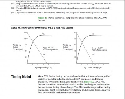

Are you aware that the CPLD's outputs are likely TTL-level, not CMOS? The 65C02 expects to see CMOS levels on Ø2. Try sticking a 74AC04 or similar in there to boost the clock output, with a metal film resistor on the AC04's output to mitigate ringing—100-120 ohms is a good range to start. The 74AC04's output swings rail-to-rail and has a very short transition time, things that the 65C02 wants to see on Ø2.
PostPosted: Sat Jul 31, 2021 5:05 am
Posts: 1076
On paper EPM7000 has TTL level output, but its output drive VI chart shows it drives to 3.75V. Scope measurement shows it drives to 4V, hard, at room temperature. Probably too fast, so 100 ohm serial source terminating resistor is a good idea.
Edit, attached graph is from EPM7000 datasheet
I tried the resistor thing the other day when I was experimenting, as the ACT’s certainly do have apparent ringing, when compared to LS and even HC. But I couldn’t get rid of the ringing at all. The 100 ohm resistor only either pulled up the voltage or pulled it down, depending on connecting to 5V or ground. I connected it right at the output pin, tried it at the other end, and even on both ends at the same time. Just couldn’t reduce the ringing at all.
Oh and it was asked earlier where I’m from. Aussie here! That will account for the time difference. You guys are in the wrong time zone! :lol:
PostPosted: Sat Jul 31, 2021 7:53 am
Posts: 8432
I'm sure BDD meant for you to put it in series with the output. A good layout is best, and if you keep it small enough (ie, so lines can be really short), you shouldn't need any resistors at all. If you do actually make terminations, the Thevenin type would be best, or diode terminations if you can find diodes that are fast enough (with trr below a ns). With the resistor termination, it won't do much good if you don't also control the transmission-line impedance and have somewhat of a match. Getting all of that correct is much harder for a hobbyist than just doing a really compact layout with no signal line more than just a few inches though.
PostPosted: Sat Jul 31, 2021 9:17 am
Posts: 137
Ah, series! That was about the only thing I didn’t try. Thanks for the clarification.
In this case I’m mainly playing around and experimenting, seeing what works best. I will certainly plan on doing a much better layout in the future though.

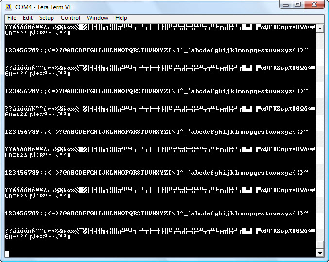

Hmm, so 0.6u W65C816 can run to 40MHz, at least in the emulation mode. Like W65C02, I found it necessary to raise voltage to 5.2V to have reliable operation with my simple test program which means 40MHz is right at the frequency limit.
Now I need to read the manual to figure out how to run it in native mode...
*******Update*****
Never imagine it would be XCE instruction to switch between emulation and native modes! So here is a modified ROMtest program that prints 256 bytes to console in emulation mode including wrapping around 64K memory boundary and then switches mode to native mode and prints 256 bytes to console and then switches back to emulation mode and repeat.
   .p816
   .ORG $FFC0
   .word start   ;this is operand of 'JMP start' instruction
         ;wrapped around 64K memory boundary
start:
chkTXE:
   LDA SerStat
   BEQ chkTXE
   INX
   NOP
   NOP
   NOP
   NOP
   BNE $FFFF
   CLC      ;switch to native mode
   XCE
;execution in native mode
start1:
chkTXE1:
   LDA SerStat
   BEQ chkTXE1
   INX
   NOP
   NOP
   NOP
   NOP
   NOP
   NOP
   NOP
   NOP
   BNE start1   ;do no do instruction wrap around at 64K
   SEC      ;switch to emulation mode
   XCE
   JMP $FFFF
   .org $fffc
   .word start
;   .byte 0
Attached picture is screen capture of the program running at 40MHz @5.3V It appears to run successfully alternating between emulation and native modes. Examine the 'E' output of 65816 I see it toggles between high and low every 22.8mS. Since the serial baud is derived by 40MHz/22 effectively 113600N81 (98.6% of standard baud of 115200), it takes about 22.5mS to transmit 256 bytes, so that's about right.
I think W65C816 CAN run to 40MHz.

Removing W65C02 and replacing it with W65C816 (Mouser W65C816S6TPG-14) and it still work at 40MHz like nothing changed but power consumption is 15mA higher. Verify E pin is high so W65C816 is in emulation mode after reset as it should.
We'd expect to see elevated power consumption at such a high clock rate. 15mA higher really doesn't sound all that bad. Does the 816 get noticeably warm at that speed?
How fast will it run at an even 5 volts? Also, it would be interesting to see how fast the 816 can be run at 3.3 volts.
I wouldn't expect any difference with either mode. It's the same ALU doing the same work.
In passing, note that switching between emulation and native modes on a system that has interrupts running is risky. If your interrupt handler expects the 816 to be in native more and it is in emulation mode when an IRQ hits you're likely going to be reaching for the reset push button.
PostPosted: Tue Oct 12, 2021 1:31 am
Posts: 1076
50 gallons make 250 bottles, just enough for a nice Christmas party. :lol: Many of my cousins are deficient in aldehyde dehydrogenase (ALDH2) so they can have continuous bender all winter long with just one bottle of wine. Apparently I don't have that genetic deficiency.
I'm limited by the oscillators I have on hand, the next lower frequency I have is 36MHz. W65C816 will run down to 4.5V (the trip voltage of reset supervisor) with 36MHz oscillator. The current consumption of oscillator, CPLD, and W65C816 at 5V 36MHz is 214mA. By comparison, the current consumption is 151mA at 5V, 7.37MHz clock. Some of that current difference may be due to different oscillators, however.
