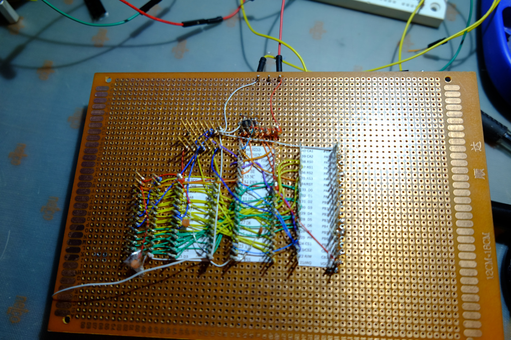

Good news everyone! Another W65C02 is up and running.
After 3D-printing a few wire-wrap sockets (viewtopic.php?f=4&t=2029&p=83239#p83238), I was itching to put them to use. I always wanted to wire-wrap a computer - it seems like relaxing activity much like knitting... And I've never put together a real '02 computer, only FPGA-based, which somehow does not feel real. That's two marks on my bucket list.
The new computer is a subset of Garth's http://wilsonminesco.com/6502primer/pot ... ml#BAS_CPU (misappropriated by Mr. Eater of googletube), and the board was dubbed GARTH-1. Thank you, Garth, for a solid, simple design - and the rest of the primer!
Bottom wire-wrap view of GARTH-1
Since I lose everything I ever write down sooner or later, I am posting some details, as much for my future self as for anyone interested:
Currently on-board:
CPU: W65C02
ROM: ATM28C256
RAM: UM61m256K-15 (skinny 32K RAM)
IO: W65C22N (I could not find an S in my pile - for some reason I bought a bunch of N's a few years back)
There is a resistor array for all the pullups, and a little header with a microscopic MCP100T SOT23-3 reset supervisor. There is a reset button floating in the air near the LED.
The cheap Chinese ZIF socket works like a charm, but unfortunately, instead of pins, has weird flat tabs that run like this:
l l l l
l l l l
They don't fit into sockets. I finally found a female header that took them, so the structure is now 3-stories high. But it works.
Clocking
I don't have a proper clock yet as all my oscillators seem to be in the tens of MHz from my FPGA days. In the meantime I've been using an Daryl's SBC4 to bang out the clock for its little brother (the LED you see is actually the clock, with a little wire to clock GARTH-1). I am running tests at around 500KHz.
Build notes:
Overall, the build took a day and a half (largely due to my disorganized space and time wasted looking for various chips and caps...). Wire-wrapping is not quite like knitting as you really have to pay attention to each individual connection, by the way. But very pleasant, and oh so retro, especially with appropriate period music. I finally got to use the little roll of Kynar wire I bought as a teenager and managed to not get rid of, somehow.
I started with the CPU and a NOP-generator stuck into the RAM socket. After banging on the knobs of my broken Kukusui 20MHz scope (the traces seem to move up and down on their own, and break up into spectacular patterns, not very helpful in debugging) I figured that it probably works. I added a ROM and loaded a simple dead loop at $FF00, which let me check the address bus lines. I then added the RAM, and burned a ROM with a simple test that JSRs into the RAM which promptly RTSs to the stable dead loop at $FF00 for verification.
Finally I added what I thought was the 6522 (but was a 6521!), and wasted half a day debugging every component, removing everything and going back to the NOP generator... Eventually I slapped my forehead and put a real 6522 in, and blinked some LEDs.

The Address Decoder
74HC00 Quad 2-input NAND gate.
         +---+--+---+                 +---+---*---+           __
      1A |1  +--+ 14| VCC             | A | B |/Y |      /Y = AB
      1B |2       13| 4B  A15         +===+===*===+
     /1Y |3       12| 4A  A15         | 0 | 0 | 1 |
ϕ2    2A |4  7400 11| /4Y /ROM        | 0 | 1 | 1 |
/ROM  2B |5       10| 3B  /ROM        | 1 | 0 | 1 |
/RAM /2Y |6        9| 3A   A14        | 1 | 1 | 0 |
     GND |7        8| /3Y  /IO        +---+---*---+
/RAM -> RAM /CS
A14  -> RAM /OE
/ROM -> ROM /CS and /OE
/IO  -> 6522 /CS
A13  -> 6522 CS
RAM: $0000 - $3FFF
IO:  $4000 - $7FFF
ROM: $8000 - $FFFF
6522 is selected with IO and A13, and therefore mapped at $4000 + $2000
The first gate is unused for now, and I should really ground the inputs...

Still can't find any reasonable oscillators in my vast junkpile.
I am still using Daryl Ricter's SBC4 as a clock source. I was thinking the optimum pin-twiddling loop when I remembered that the 6522 can use a timer to twiddle the pin. Fastest I can go, setting the count to 0, PB7 should output 1/4 of the SBC4's clock. I think SBC4 runs at 10MHz (Daryl - am I right? The can on the SBC4 is covered with expansion boards and I can't see it), so I should be getting 2.5MHz.
; 68C816 on SBC4:
  LDA   #%11000000
  STA   ACR
  STZ   T1CL
  STZ   T1CH
And it's outputing a square wave, roughly 4 times faster than before, which makes sense. GARTH-1 is keeping up, flashing the LED much faster. Sanity check: using the delay from the primer:
;; 65C02 on GARTH-1
;; 9*(256*A+Y)+8+12 cycles
delay:
        CPY  #1
        DEY
        SBC  #0
        BCS  delay
        rts
With $FF in A and Y, we should blow 589835 cycles between LED toggles. I don't have a stopwatch handy, but it looks like maybe about 2 blinks (4 delays) per second. That comes out to a bit under 2.5MHz.
Shift Register?
2.13.1 Shift Out - Free Running at T2 Rate (100)
This mode is similar to mode 101 in which the shifting rate is determined by T2. However, in mode
100 the SR Counter does not stop the shifting operation. Since SR7 is re circulated back into SR0,
the eight bits loaded into the SR will be clocked onto the CB2 line repetitively. In this mode, the SR
Counter is disabled and IRQB is never set...
2.13.3 Shift Out - PHI2 Clock Control (110)
In this mode, the shift rate is controlled by the system PHI2 clock.
PHI2 mode unfortunately is destructive... SR will need to be reloaded, which blows. The free running mode cannot go faster than 2 clocks per transition, same as above. Darn.
I have one final trick left: I can grab PHI2 from the SBC4's expansion bus... And it runs at 10MHz!
I figured the ROM would not make it to 10MHz... An I am pulling PHI2 from the SBC across a foot of hookup wire. My scope shows it as a sine wave. I really should get a Rigel. But it's pretty impressive.

Well, it's pretty solid at 10MHz. I am surprised, given the flaky clock connection and the noticeable clock frequency on the powerline. I really need to clock this computer. No reason to downgrade yet.
enso
Posts: 904
Joined: 29 Sep 2012
Re: GARTH-1: a minimal SBC with 3D-printed Wire-Wrap socket
Post by enso »
10MHz is as fast as it can go.
12MHz (24MHz oscillator fed through a flop) is too much.
AT21C256 is the slowest chip in my system. I tried a few different ones, as I mixed up some from Mouser with others from god knows where. I found some slower ROMs: 3 similarly marked ones only work at 8MHz. All three slow chips have the following markings:
AT21C256F
15PI
1612
Curious: I have a few 20PI chips that work at 10MHz.
Well, 10MHz is not too bad. The current decoder uses A15 to /CS and /OE the ROM. At 10MHz we technically have 50ns for the read half-cycle, although if the address bus is set up a little earlier, possibly a tiny bit more. So using 150ns (and even 200ns) devices is pushing it.
enso
Posts: 904
Joined: 29 Sep 2012
Post by enso »
I equipped the board with a full-can oscillator in a 14-pin socket. I probably should've gone with half-can but couldn't resist.
I love the feel of the full-can! In the past decade I've mostly used surface-mount 5x7mm parts which weigh nothing. The full-can oscillator has a definite heft. It feels like the source of real computing power.
