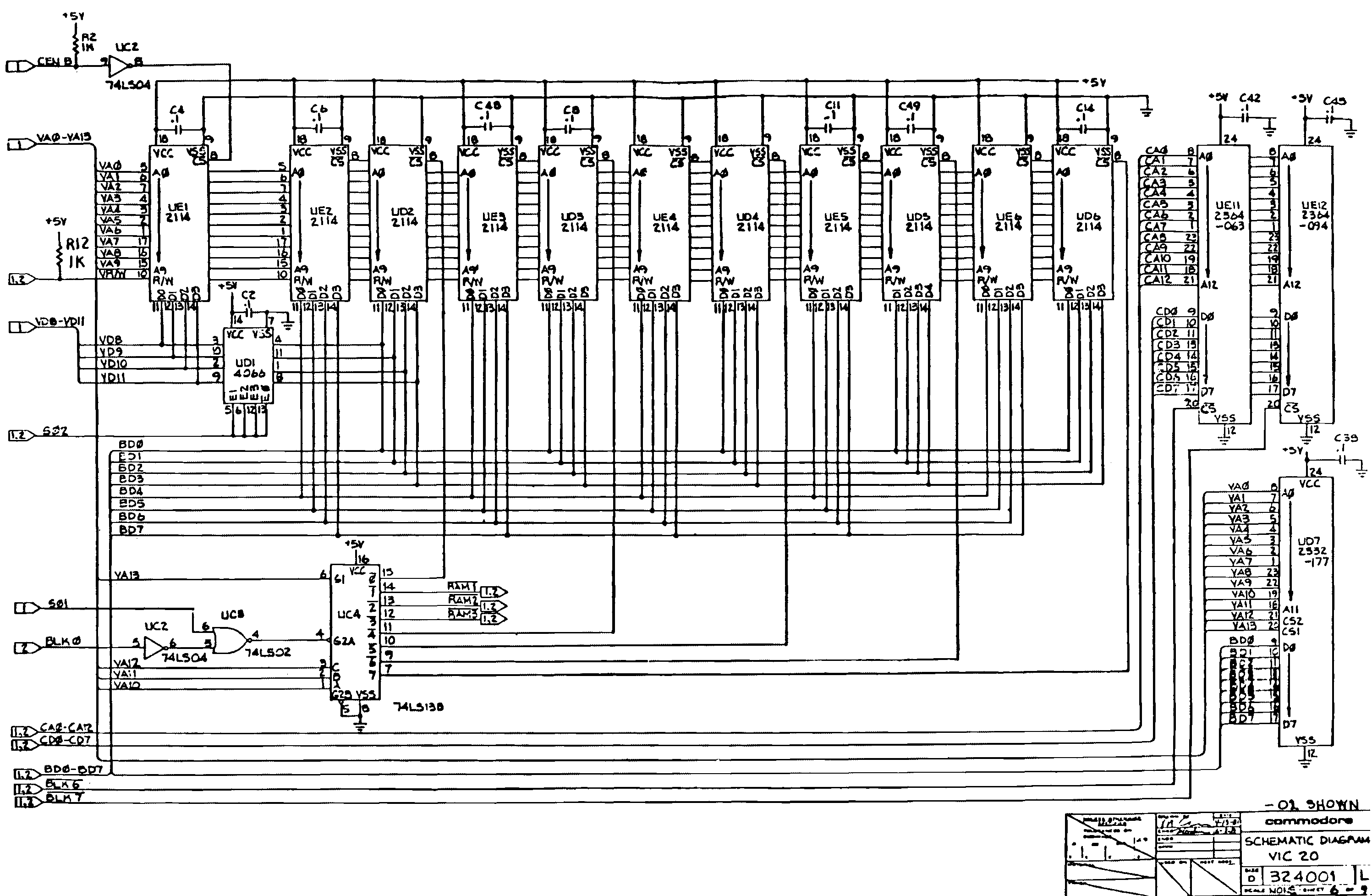

My VIC 20 has a 7402 to produce the clock signal for the system and I tried to replace it with a 74LS132, which didn't work. The Oscilloscope shows a nice signal, but the VIC doesn't work with it. A 74LS02 doesn't work either. Any Ideas?

A 7402 is a quad 2-input NOR gate but a 74LS132 is a quad 2-input NAND gate with a different pinout, so it's no suprise that that didn't work.
As far as the 74LS02, there could be timing issues there, since it has slightly different specs from the 7402.
I found a couple of VIC-20 schematics here for E ("older") and N ("newer") versions of the VIC-20. I assume that yours is the N version, since that seems to be the only one with a 7402 (the E version uses a 74S02), but you'll stand a better chance of getting help if you can point people at schematics you've confirmed are for your system and identify which chip you're talking about.
On the N board a 74LS02 (UC3) is used for the 6502 clock and some other things, yet a 7402 (UB9, which I assume is the chip you're talking about) for the 6560's 4.433618 MHz clock. Given that it would be easier to use the same chip for both, I would assume that there's a good reason they didn't, which may support the timing issue theory.

The board I am referring to is an NTSC with an assembly number of: 324003 and the chip number is UB4. The memory is all 2114's. Could it be solved with pull-up resistors on the outputs feeding the 6560?
 Post subject: Re: VIC 20 Clock circuit
PostPosted: Thu Dec 03, 2020 2:53 pm
Posts: 1385
Per Vic-20 schematics, there are already pull-up resistors on the gate outputs driving the 6560. I've seen 220 ohm used as well as 560 ohm. As per my earlier post, I suggest using either a 7402 or 74F02 and adjust the trimmer capacitor.
