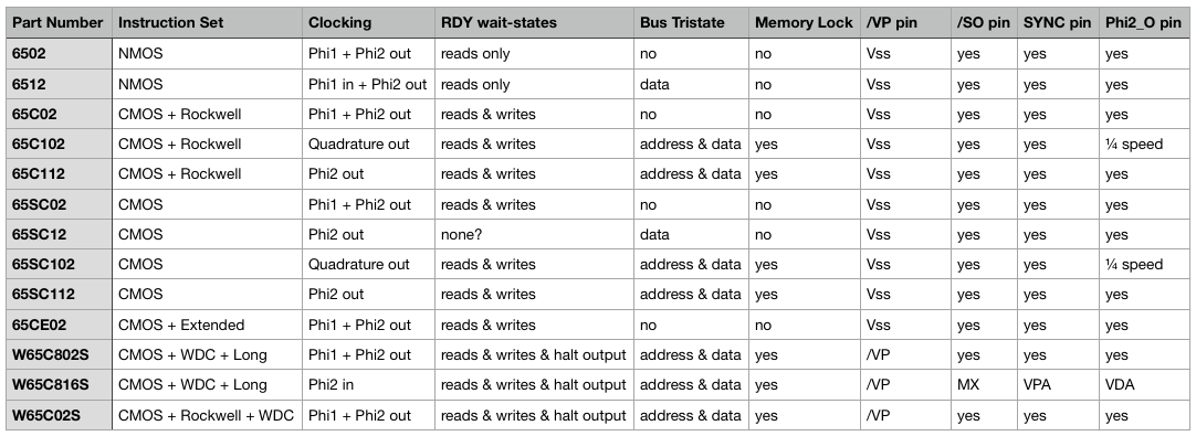

There are a number of different hardware variants in the 6502 family, each with slightly different pinouts and auxiliary functionality - most famously the cut-down 28-pin 6504 and 6507, but also some full-fat 40-pin versions. The modern W65C02S is *mostly* a superset of these, but…

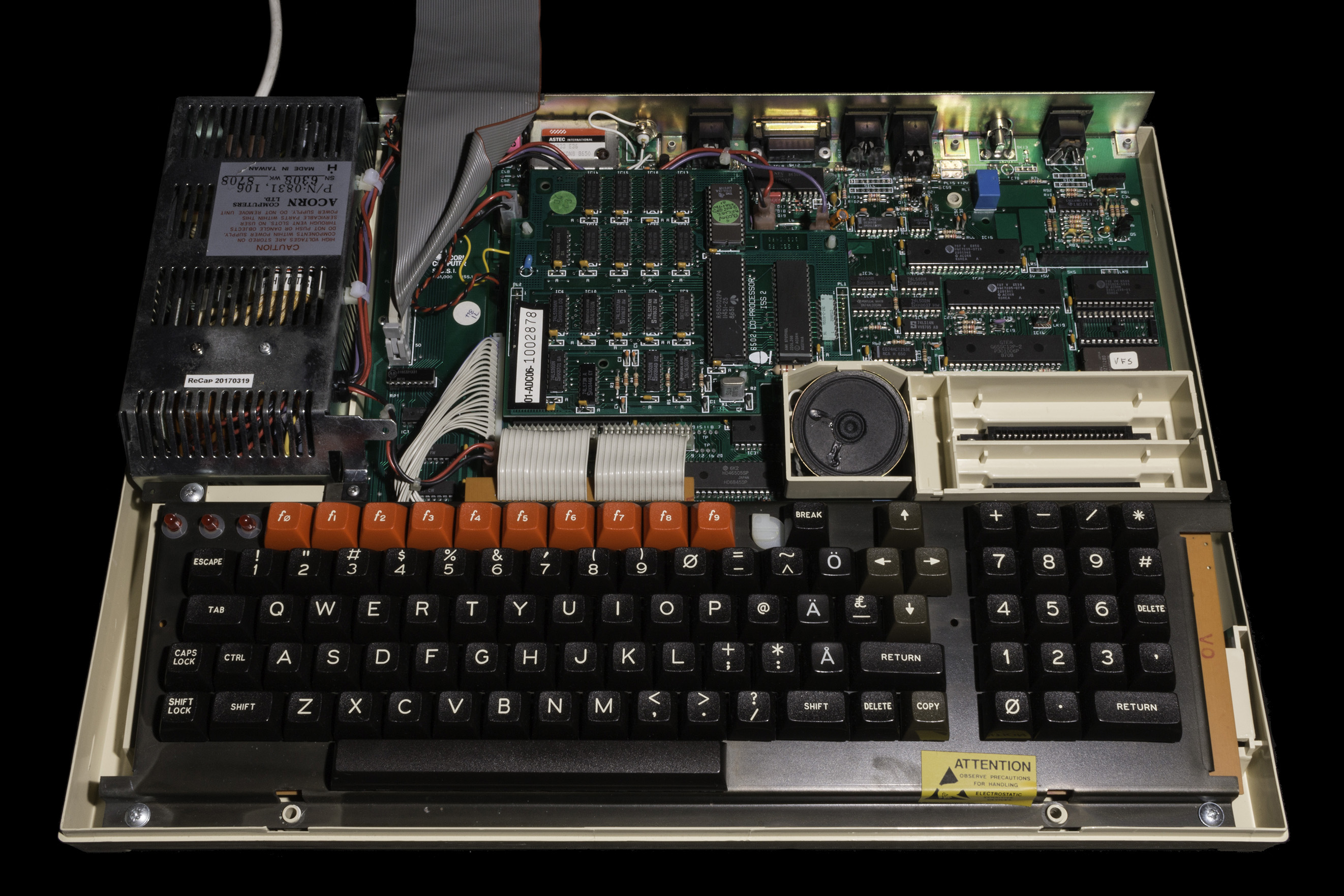

Consider the humble BBC Micro. It uses an NMOS 6502, right? Correct. The later BBC Master uses a 65C02, right? Wrong.
Examining the above photo of an expanded Master Turbo, you should be able to find two CPUs. The one on the actual motherboard belongs to the Master proper - it's a 65SC12, lacking both the Rockwell instructions, a RDY input, and a Phi1 clock output - but unlike a 6502, it does have a Data Bus Enable pin, which might save you an octal transceiver in some applications. And the one on the daughterboard front and centre is a 65C102, which take a quadrupled clock and produces a quadrature clock for you, convenient for high-performance DRAM interfacing, as this 4MHz internal Second Processor card does. As proof, there's a 16MHz crystal visible.
In the NMOS family, there's also the 6512 which requires Phi1 as an input. Normally it's produced as an output (and many SBCs happily ignore it).
For a quick diagnosis, the good old NOP generator might be a good idea. Refer to the WDC datasheet, and make sure all inputs for the WDC part are correctly provided. Your chips should all do something recognisable with that. Then look for signals *not* provided by your SBC but required by the WDC part. Finally, check the cheat sheet below to see if there's a chip that lacks a signal your SBC relies on, or handles so much differently that things may be going very wrong.

Yes, I'd say that's a likely candidate for those symptoms. As well as the WDC parts, my cheat sheet says it's on the '102 and '112 parts; where the "bus tristate" column contains "address & data".

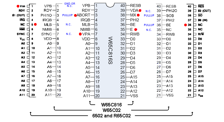

Is it possible to design some "universal" CPU board, which would be able to support any member of 6502 family?
I would like to modify my CPU board design by adding some jumpers of dip switches, to test different processors. Which pins are common for all 6502 CPUs an which differ in function somehow?
Posts: 3524
Re: Identifying what 6502s from Aliexpress really are
The humble Throw-Together Computer is built to accept different 65xx processors. Though not completely "universal" it does support the '816, the WDC version of the 'C02 and the original NMOS 6502 (whose pinout is the same as older C02's such as Rockwell). Perhaps you'll find this diagram from my notes helpful.
A red dot shows where a pin's function varies from that of its counterparts. (In some cases WDC has assigned new names even though the function remains the same.) The notations in blue show what the TTC motherboard attaches to each specific pin.
Although RDY (pin 2) is unused I gave it a pullup, rather than tying it straight to VCC. That's to protect WDC CPU's, which sometimes drive RDY low.
