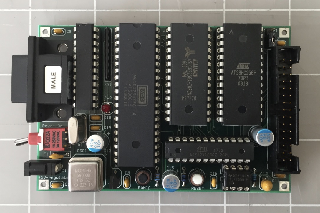

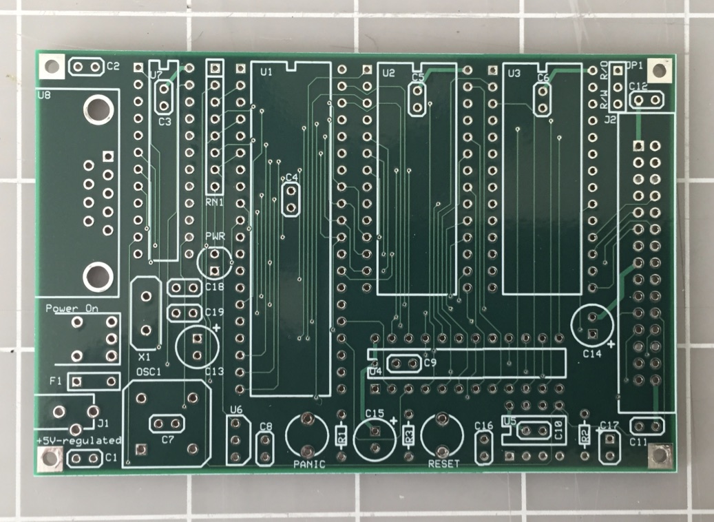

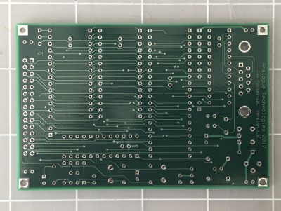

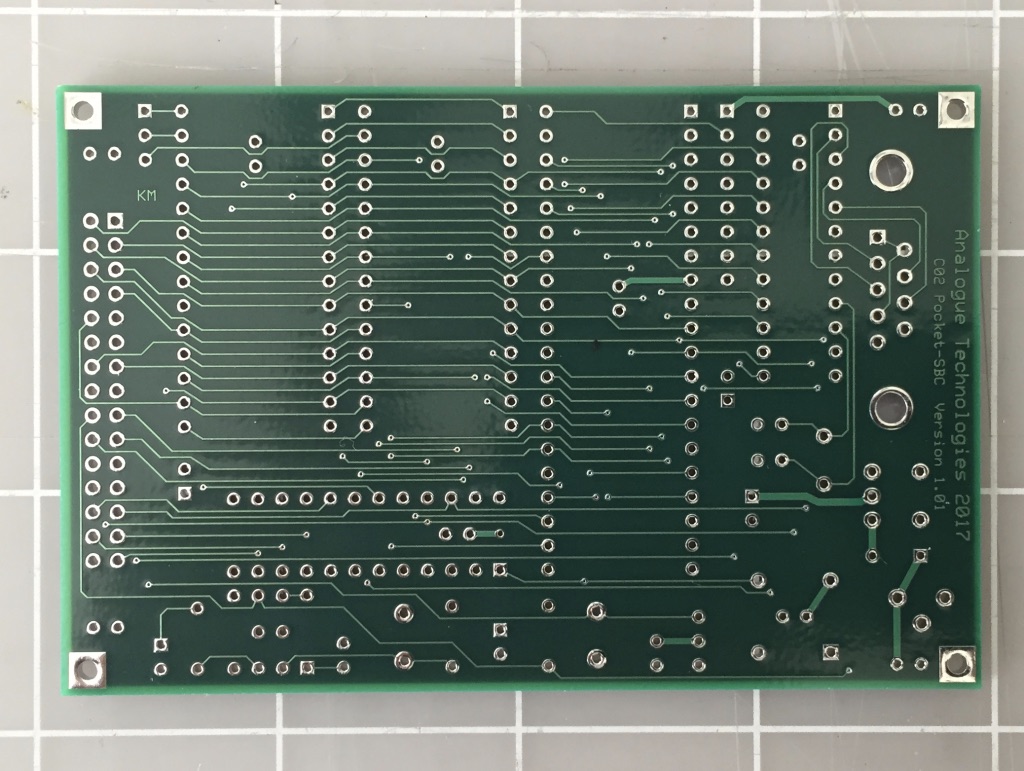

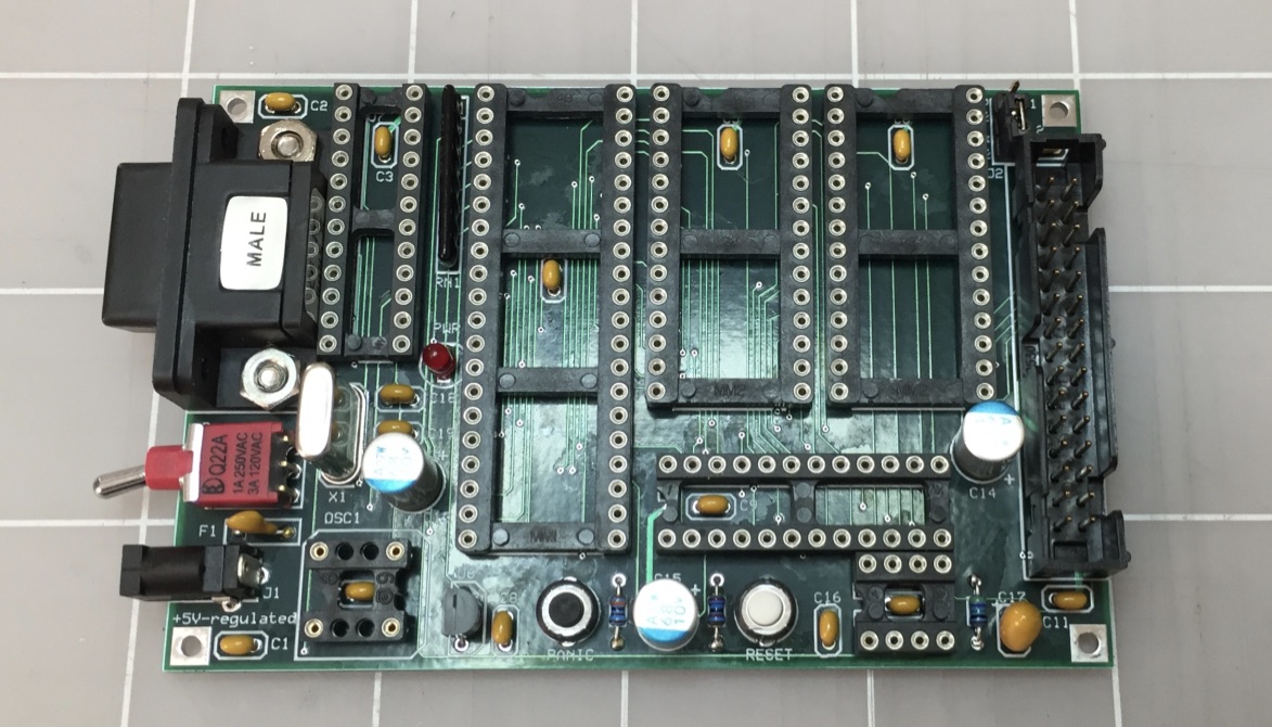

Thank you sir! You have honorable mention in the PDF file in the main directory (including some others) that describes the project in some detail. Also attaching some pics here:
I socketed everything that could be, and hid bypass caps under all of them to keep the layout more compact. However, you can easily remove every chip with a basic chip puller should the need arise.
