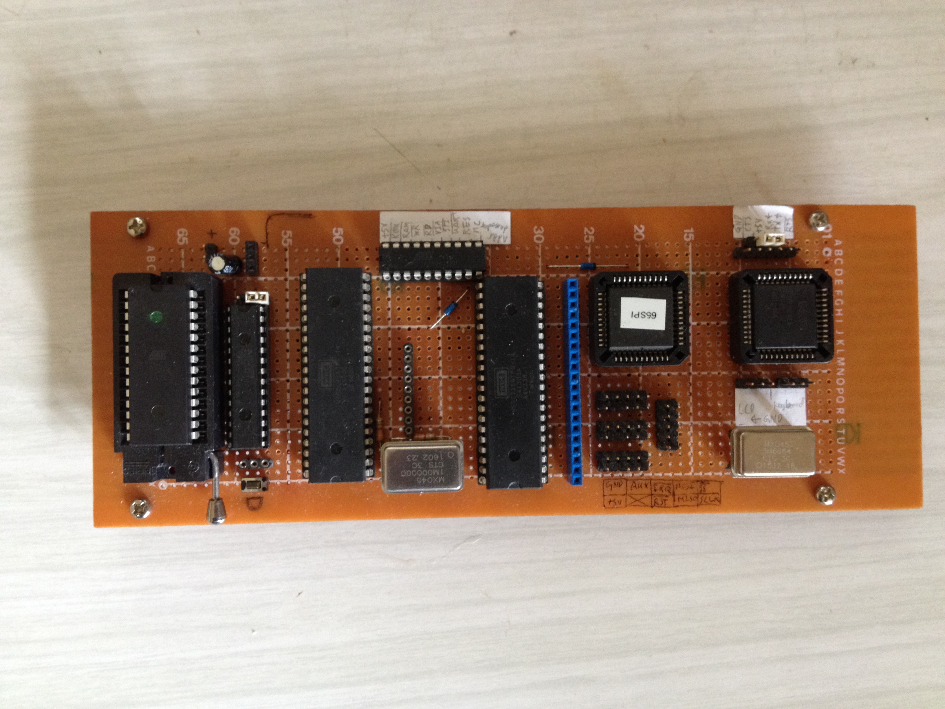

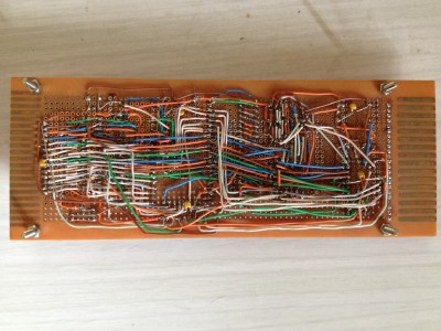

The current prototype is constructed with wires soldered to the underside of a pad-per-hole breadboard. Bit of a mess under there.
I'm using sockets for everything I think I might re-use later, including the reset circuit and 7805 regulator. Basically, all the silicon on the board is in a socket.
I also have the display and keyboard. The display is a SparkFun Serial Graphic LCD, and the keyboard is an RC2014 Universal Micro Keyboard, with the serial option and slightly modified firmware(It gives me backspace, and I think that's it...).
I want to move to a PCB, and I'm currently building a hierarchical schematic in KiCAD for that purpose.

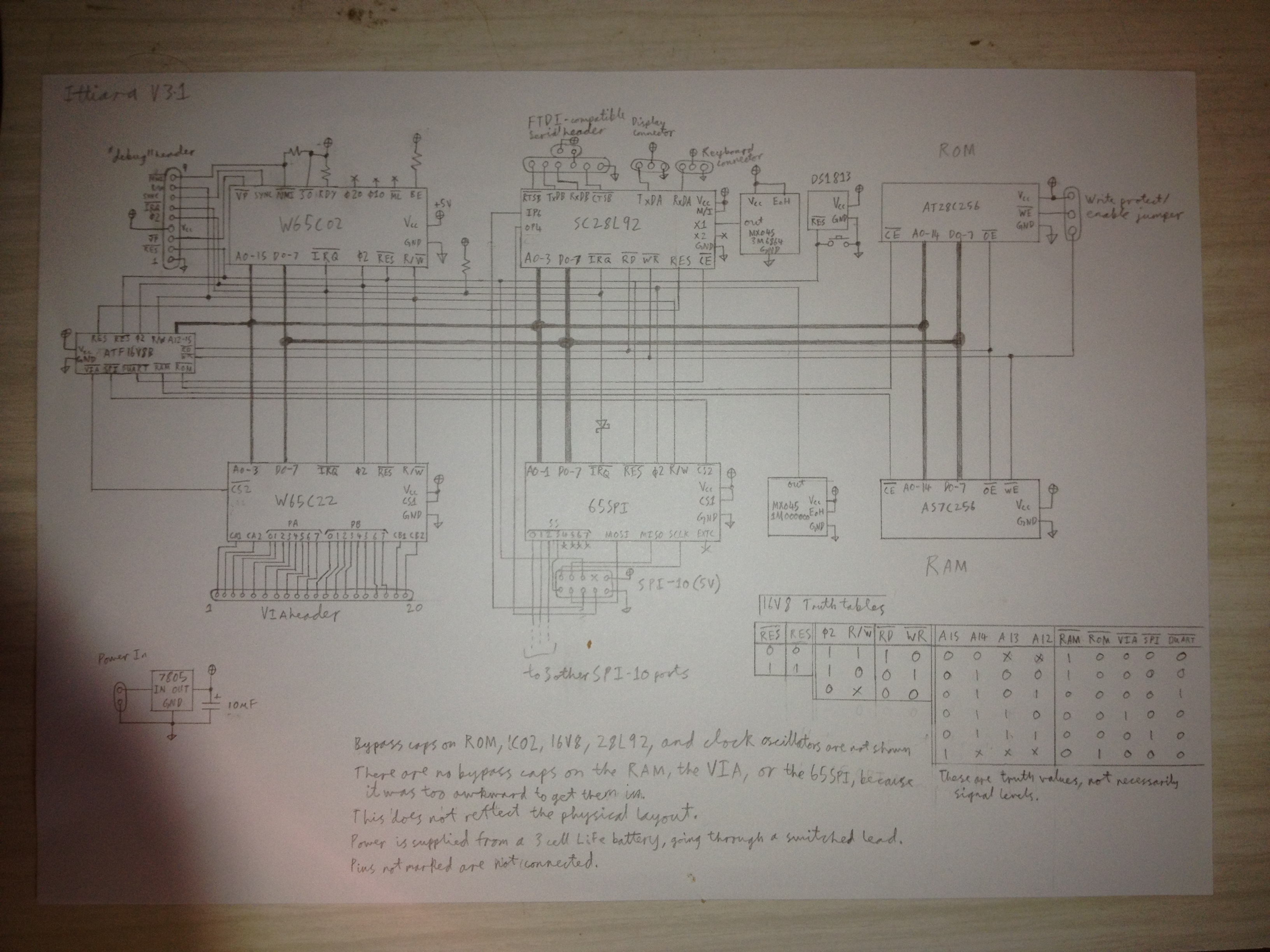

My current problem with it is that while it works perfectly when I use an FTDI cable and a terminal emulator, but when I connect the display, sometimes it doesn't start, or hangs. And sometimes the keyboard seems to send shifted characters when the shift key isn't being held. I suspect that might be power distribution triggering the reset IC, but I'm not sure.
EDIT 14/10/2017: Added current circuit diagram and a few photos.

BTW: that three pin connector at the /WE input of the ROM...
If you would be pulling the jumper with the computer powered on, /WE of the ROM might be floating, sensing LOW by accident.
Maybe it would be better to have a 10kOhm pullup resistor or such between ROM /WE and VCC and to use a two pin jumper instead.

I don't remember having ever pulled the write-protect jumper before... Not that that makes your point any less valid. It probably won't be in the final design, at least, not in that form. I might adapt your idea, and have a two-pin jumper controlling an input to some sort of logic that determines whether or not it gets written to. Then you'd pull it out before you write to the ROM, and put it back after.

I think I've completed most of the PCB layout now, but since this is the first board I've laid out, I'm not sure of my work. I kind of expect what I have to be a bit of a bog's breakfast, and I know that getting PCBs made is not real cheap, so I don't want to mess up.
I hope I'm not asking too much, but could someone more experienced than me take a quick glance at these, and see if I've done a stupid?
