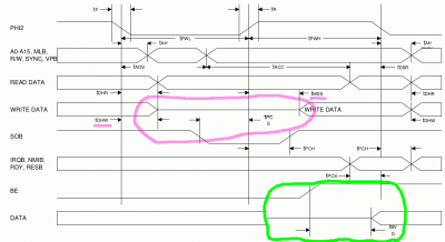

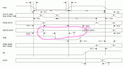

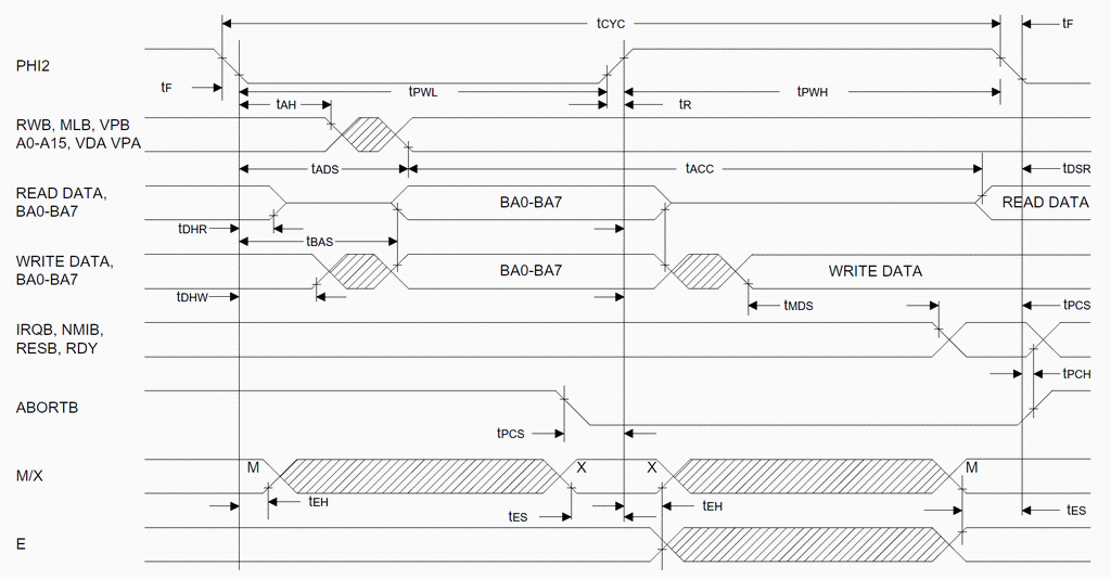

WDC's 65c02 data sheet's timing diagram implies that if you have two write cycles in a row like you would when pushing a return address onto the stack, the processor may continue to assert the data bus through phase 1 but with data that's not guaranteed to be valid between the end of tDHW and tMDS.
 Post subject: Re: 65802 anyone?
PostPosted: Mon Mar 13, 2017 7:49 pm
That's the sort of thing which would have me suspecting the datasheet!
(Could you clip a snapshot and post it?)
PostPosted: Mon Mar 13, 2017 8:18 pm
I suppose that as with so many other things regarding WDC data, you just have to try it if you want to find out.

Thanks for the clip! (If you want to test if a bus is driven or not, you need to sprinkle some resistors around.)
PostPosted: Mon Mar 13, 2017 10:02 pm

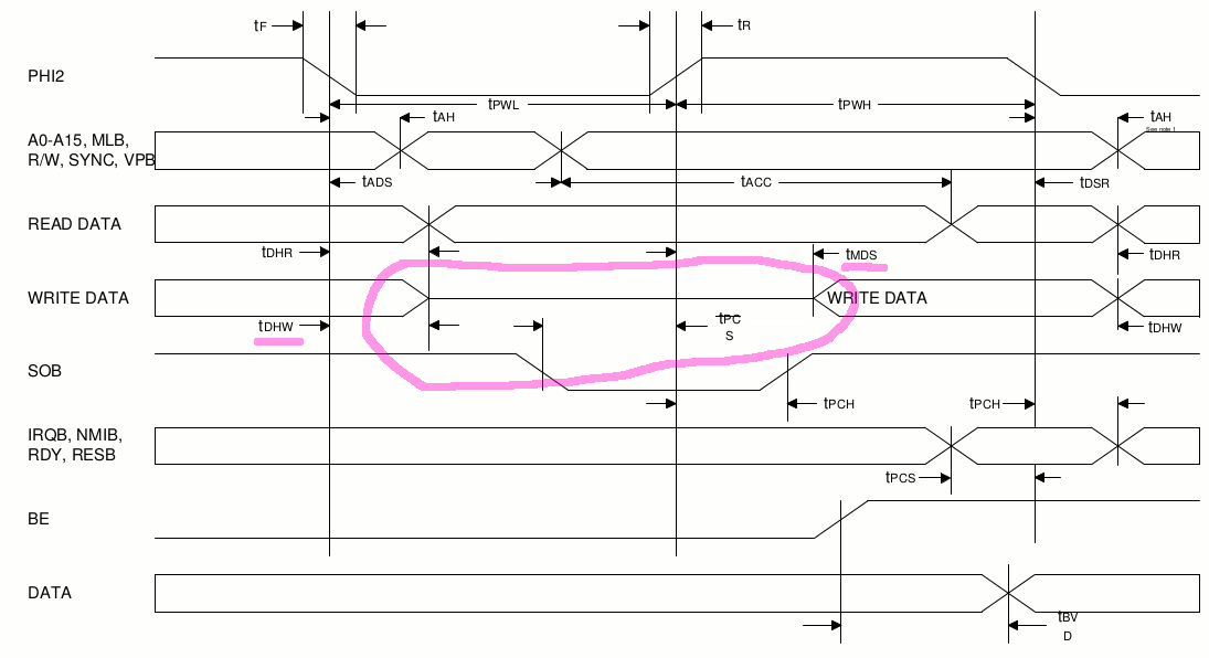

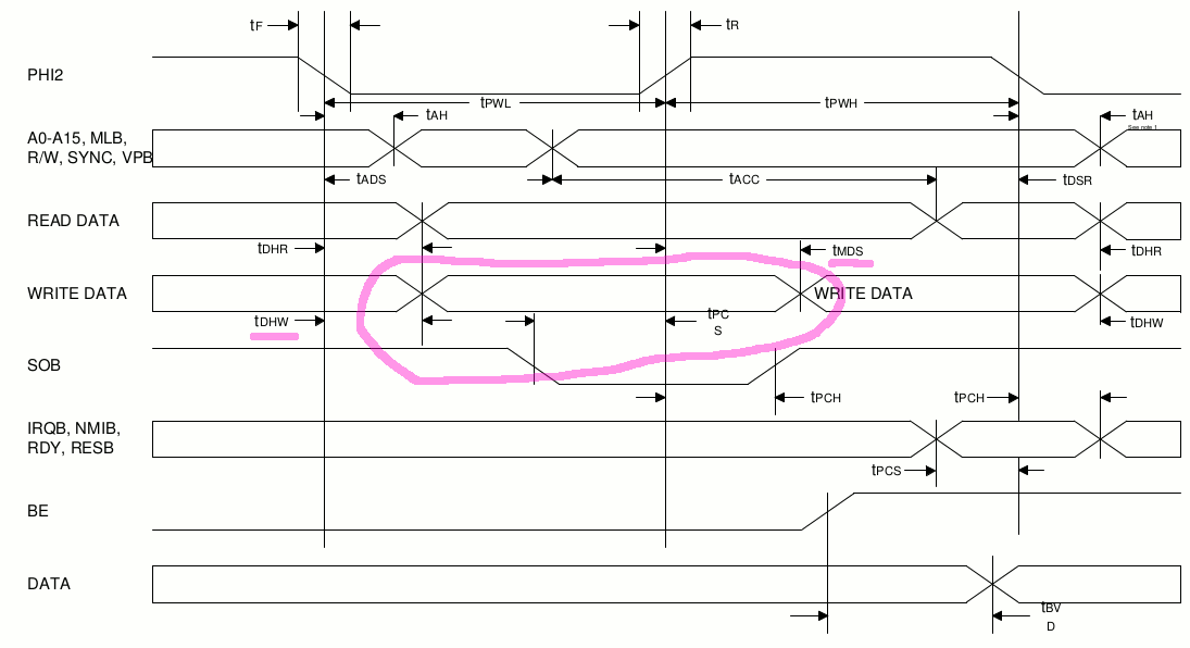

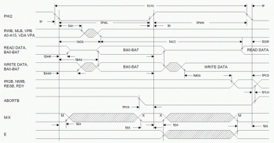

Certainly the diagram above is thought-provoking. The portion Garth circled seems to show the data bus driven to an invalid state. If the bus were invalid because it's floating then you'd expect it to be drawn as show below, using the usual visual vocabulary. So, can we conclude the bus is driven?

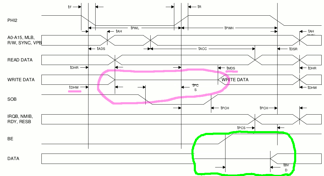

I don't believe so. We know that BE floats the bus. Why isn't its behavior drawn in the expected fashion (below)?
I think maybe the draftsman was a new hire! :P The diagram is flawed, IMO. But if there's other evidence to say a 65c02 (or any 65xx processor other than the '816) can drive the data bus in phase 1 then I'm all ears.

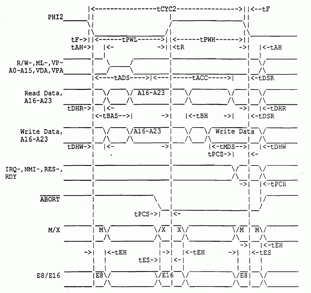

Even more interesting and confusing was the timing diagram from the 65C832 data sheet:
File comment: 65C832 Timing Diagram (c. 1990)
The "dead time" signal state is shown as "flat lined," which I would interpret to mean the 65C832 has floated the relevant outputs.
On the other hand, the 65C816 timing diagram uses yet another "notation" for some of the signals during the clock cycle "dead time":
File comment: 65C816 Timing Diagram
Well, we all know WDC's documentation leaves something to be desired. :D So guess we shouldn't be too surprised over these anomalies.
