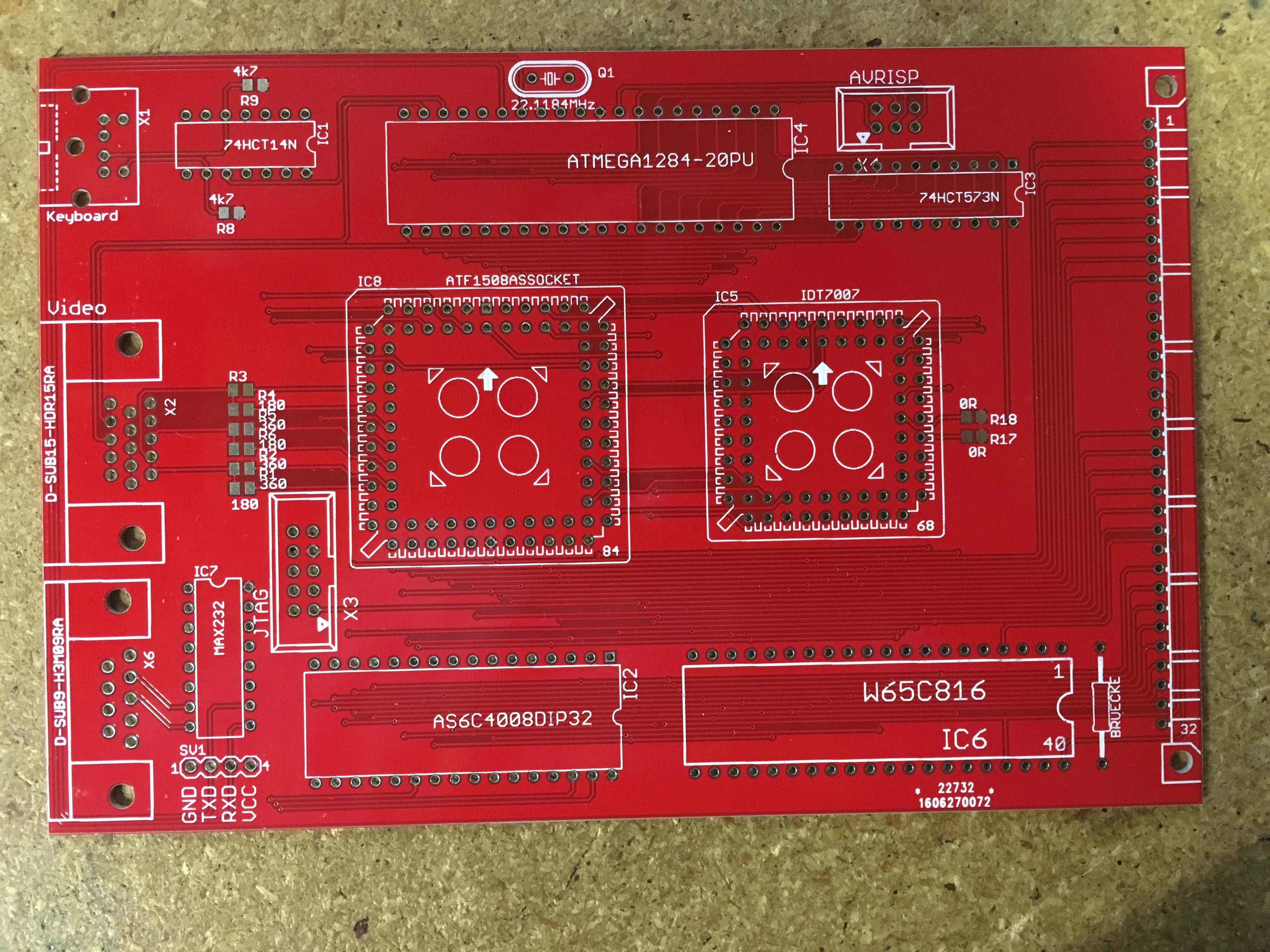

So I finally decided to go the PCB path. After the concepts have been tested with ROMulus the 1st on some breadboards I wanted to build something more durable. ROMulus the 2nd has all the features of the 1st but also has some enhancements. When finished it will (should be) able to emulate an Apple IIe including the double hires mode with 160 x 192 pixels and 16 colors. However due to the design you can convert the system into whatever you want. Everything is "configurable" within limits, that is as long as the CPLD design can be implemented in the CPLD and the given allocation of the PINs fits the design you're save. And as with all the ROMulus there is no ROM, there is only some RAM that emulates ROM, all depends on the CPLD design. It basically features
- A home-brew video controller using a ATmega1284P with 32kbyte dual-port video RAM and VGA output (560x480 pixels, this is due to the fact that I want to use the 7-bit wide original character sets of legacy systems)
- A PS/2 keyboard interface using the ATmega1284P using one of it's USART in synchronous mode
- Initial Machine Load of ROM images through the ATmega (as with the 1st you can have ROM images in flash or download images via XMODEM)
- A ATF1508AS CPLD which holds almost all of the glue logic (a 74HCT14 schmitt-trigger has been added to deglitch the PS/2 signals and a 74HCT573 has been added to support the 32kbyte video RAM via the ATMega1284P, as the CPLD does not provide enough pins)
- 512kbyte RAM
Here is a picture of the PCB
File comment: PCB
as ordered with dirtypcbs.

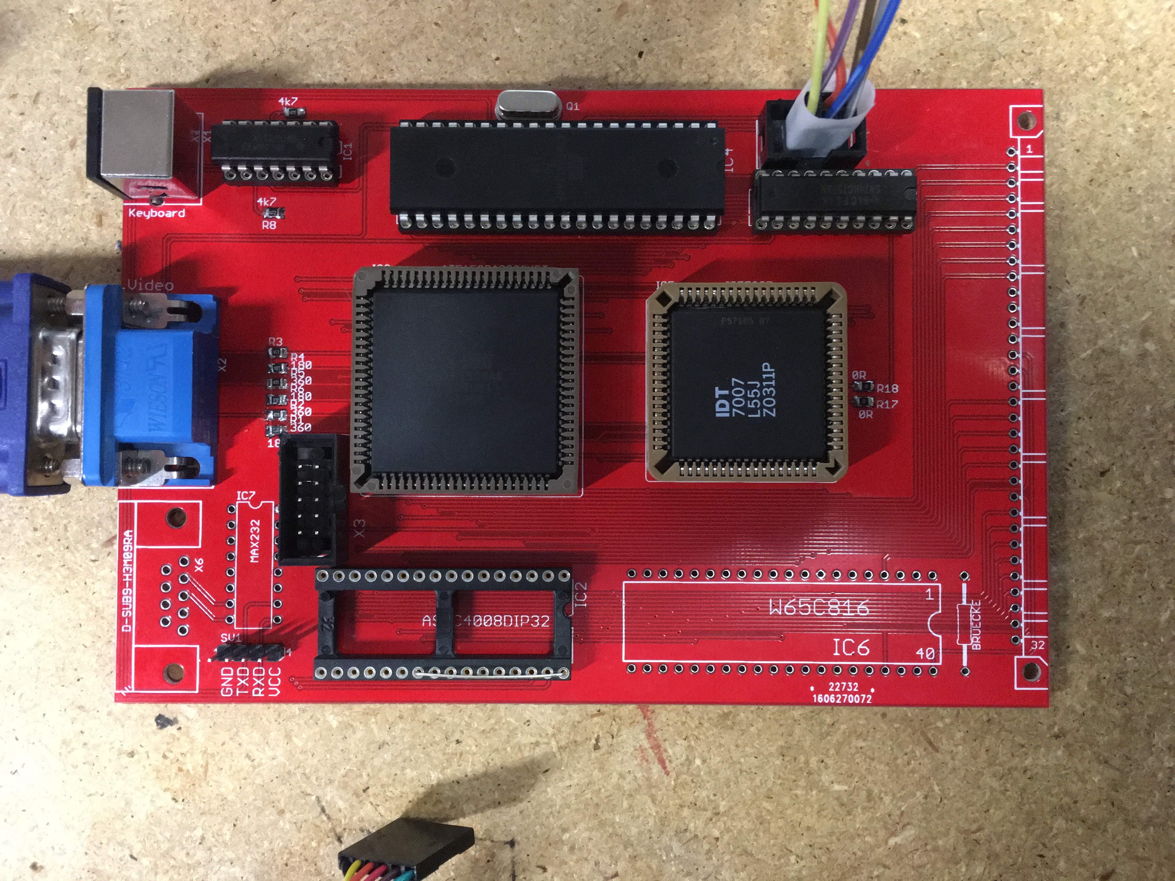

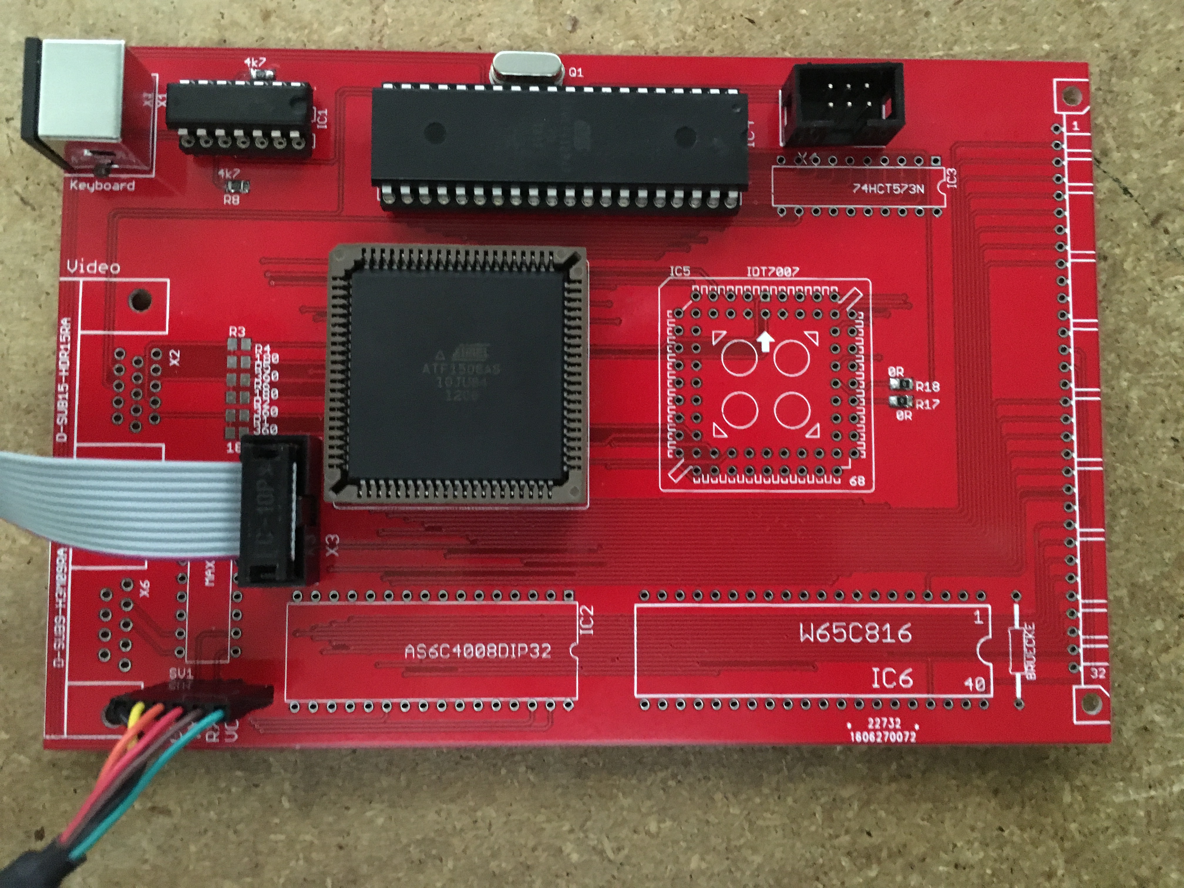

I'm slowly bringing up the system in several stages. The first stage was to check the CPLD Glue logic that emulates the 74HC166 from ROMulus the 1st
File comment: Controller, CPLD and Schmitt Trigger
and also the first color mapping logic which is new in this version of the series. In this stage the internal RAM of the AVR was used as video RAM
Currently I have reached the state where the dual-port RAM and the address latch has been added and a stable VGA signal is created using the dual-port RAM as video RAM
File comment: plus Video RAM (DP-RAM) and Address Latch
the only missing parts now are the 512kbyte SRAM and the CPU.
Up to now the process was rather successful, although I had to make same smaller "corrections" to the PCB. But nothing what a Proxxon drill and vero-wire couldn't solve.

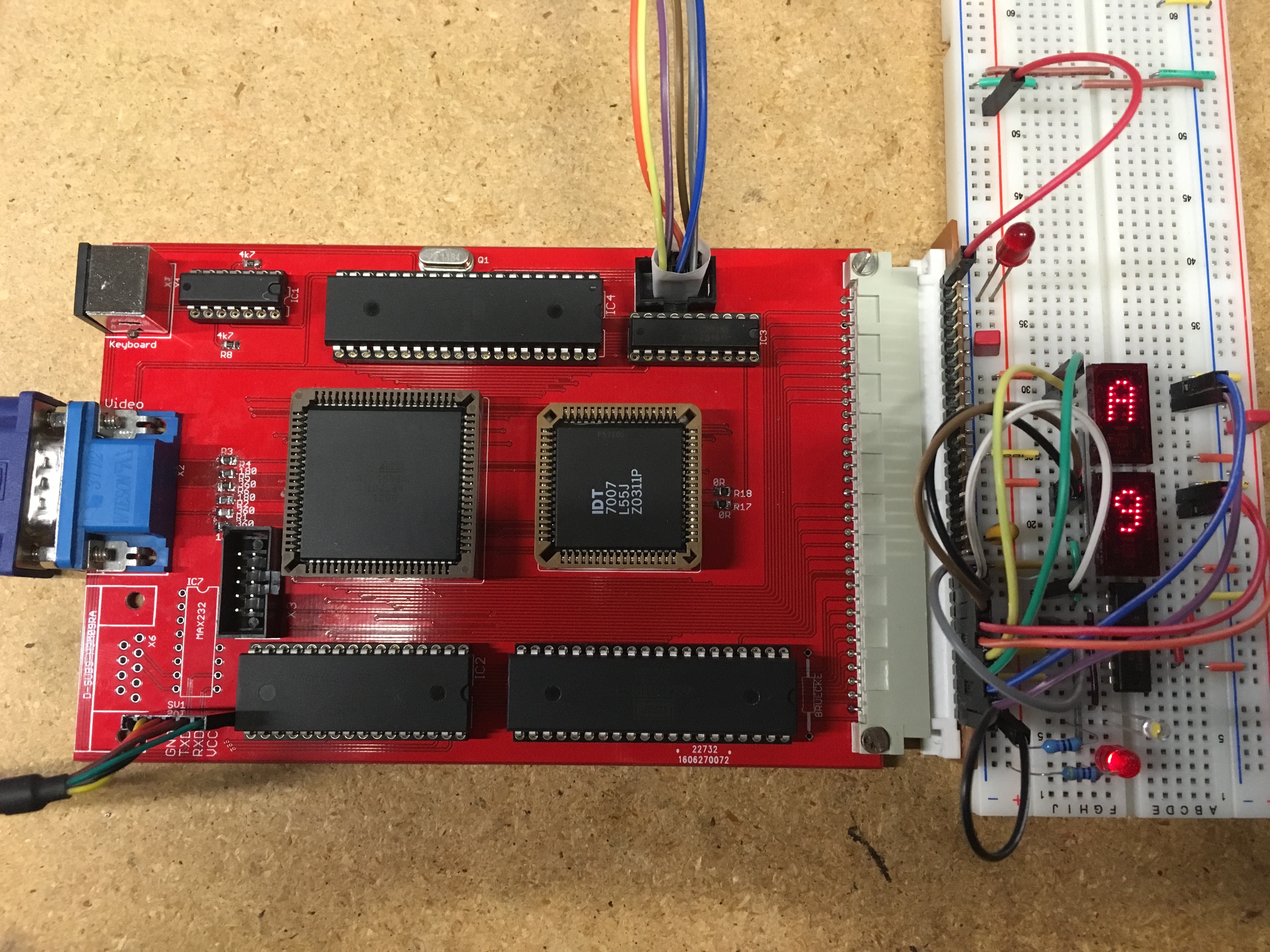

After some more hardware and PCB checks I decided to populate the rest of the essential parts
File comment: Fully populated PCB
The missing MAX232 and the corresponding connector is for the RS-232 of the AVR, but currently I'm using a USB-TTL serial adapter and don't need the level shifter. As always software errors are more common than hardware errors and in this case I have to program the CPLD and the bootcontroller (the ATmega1284P) in parallel that makes it even worse. So I added some decent debugging output (in hardware of course) to the bus interface. Now step by step I eliminate the software errors :roll: Fortunately the AVR and the CPLD support a lot of programming cycles.
