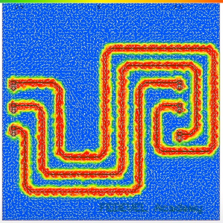

I just found a recent video by Robert Feranec where he simulates some serpentine trace paths over a ground plane and shows the return current paths. The video itself is a bit long and has a few unresolved issues, but a couple of images from it make it fantastically clear how current flows in a ground plane work.
Here's what the return paths through the ground plane of 1 MHz signals look like:

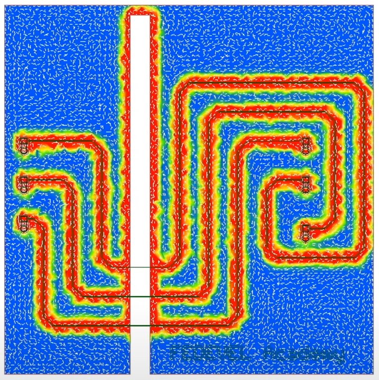

And here's what happens when you have a gap in your ground plane over which the signal traces pass:
