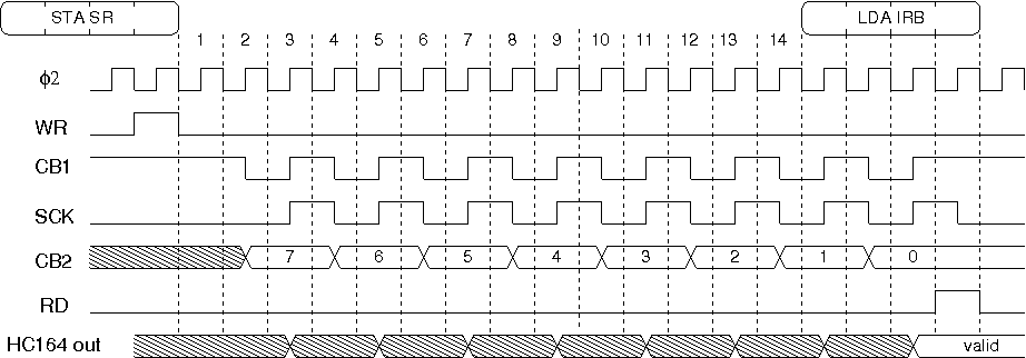

Here are some details related to the code involved. First a timming diagram:
It is clear that a minimum 14 cycles are needed between SR write and IRB read.
And the code involved:
; Single transfer
; 14 cycles between WR and RD
spibyte:
           sta   SR      ; 4 cycles
           jsr   delrts  ; 12 cycles
           nop           ; 2 cycles
           lda   IRB     ; 4 cycles
delrts:    rts
In order to achieve a higher speed with the SD card, I'm using the following routines for block transfers:
; Block transfer (up to 256 bytes), write
; ptr1 ->  data source
; Y: # of bytes (minimum:1, 0=256)
; 19 us/byte (421 Kbit/s)
;------ Not yet tested ------
spiwr:
   sty   tmp1
   ldy   #0
spiwr1:
   lda   (ptr1),y   ; 5 cycles
   sta   SR      ; 4 cycles
   nop         ; 2 cycles
   iny         ; 2 cycles
   cpy   tmp1      ; 3 cycles
   bne   spiwr1      ; 3 cycles
   rts
; Block transfer (up to 256 bytes), read
; ptr1 <- data destination
; Y: # of bytes (minimum: 2 bytes, 0=256)
; 22 us/byte (363 Kbit/s)
spird:
   ldx   #$ff
   stx   SR      ; 4 cycles (dummy write)
   dey         ; 2 cycles
   sty   tmp1      ; 3 cycles
   ldy   #0      ; 2 cycles
   nop         ; 2 cycles
   nop         ; 2 cycles
   beq   spird1      ; 3 cycles
spird1:
   lda   IRB      ; 4 cycles
   sta   (ptr1),y   ; 6 cycles
   iny         ; 2 cycles
   cpy   tmp1      ; 3 cycles
   bne   spird1      ; 3 cycles / 2 cycles if no taken
spird2:
   nop         ; 2 cycles
   lda   IRB      ; 4 cycles
   sta   (ptr1),y
   iny
   rts
The SD sector is 512 bytes long, and, therefore, I'am calling spird twice
