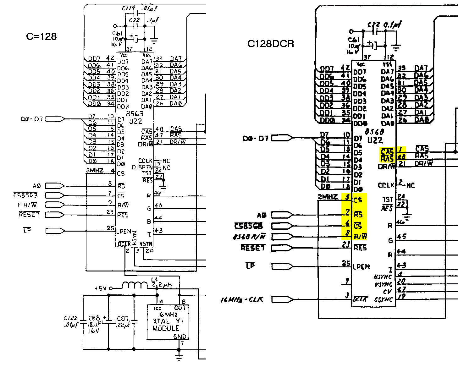

Note there are significant differences in the pinouts of the 8563 used in the early "flat" 128 and 8568 in the later Cost Reduced 128DCR.
There might be others besides the pins I've hi-lighted.
