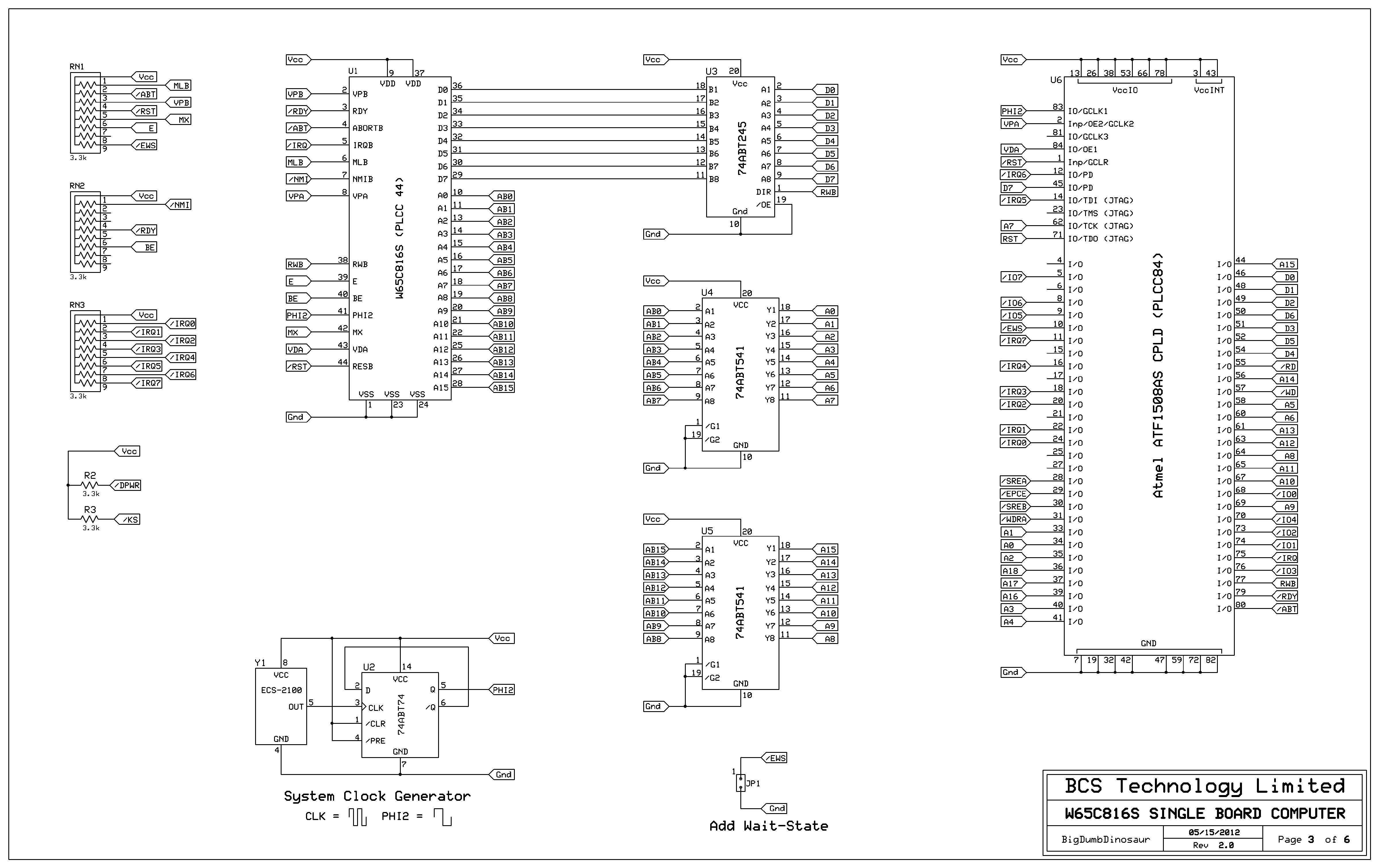

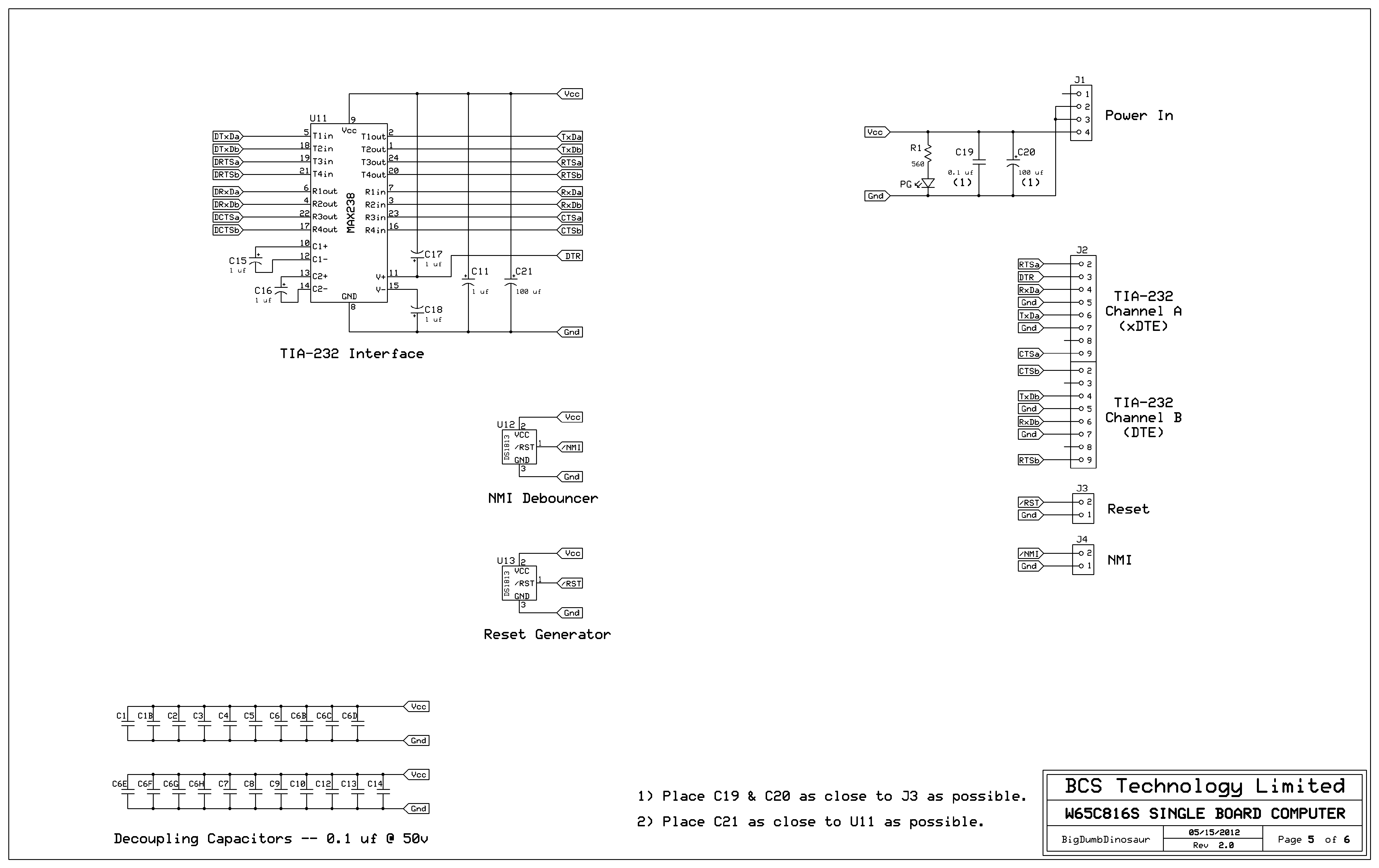

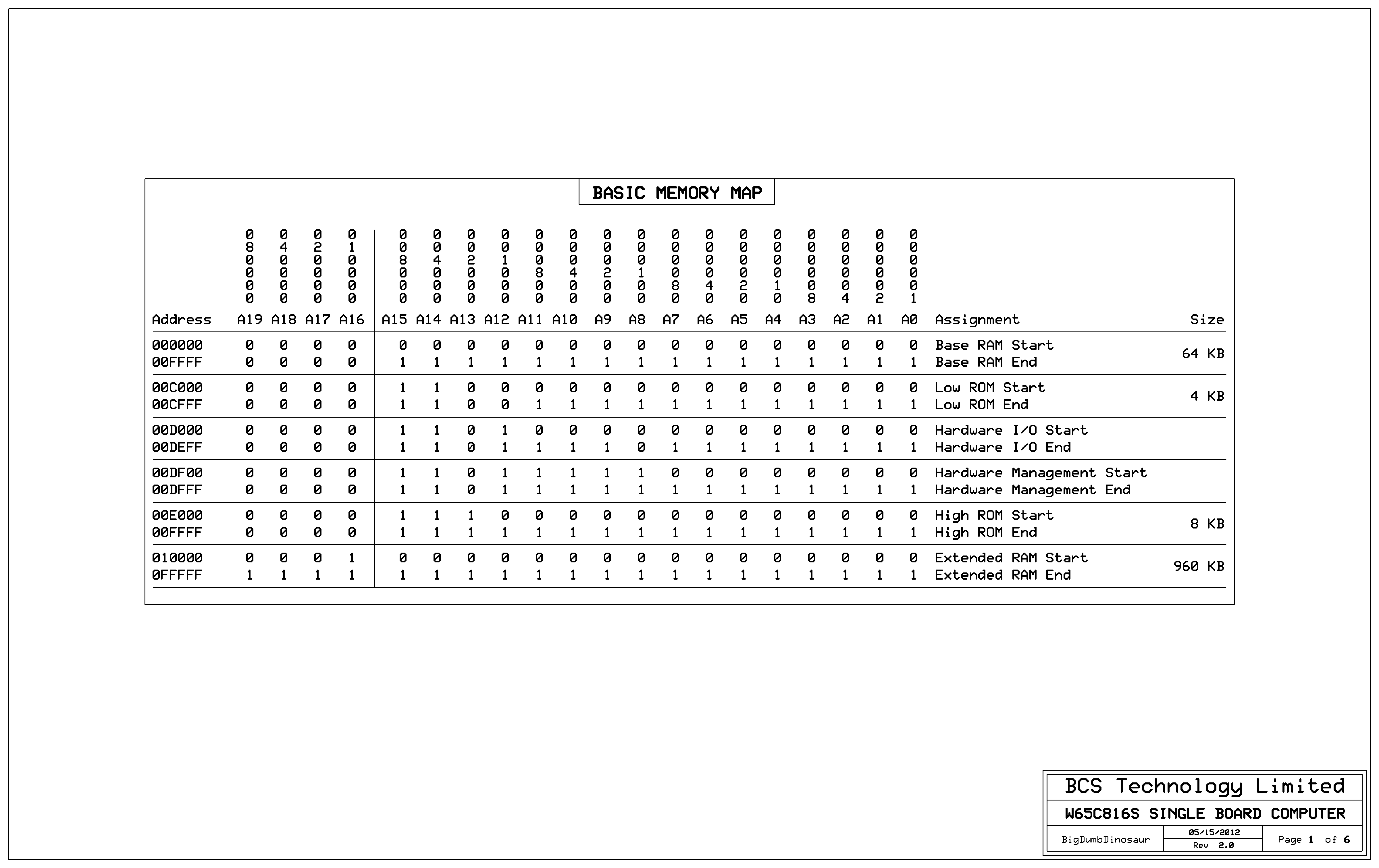

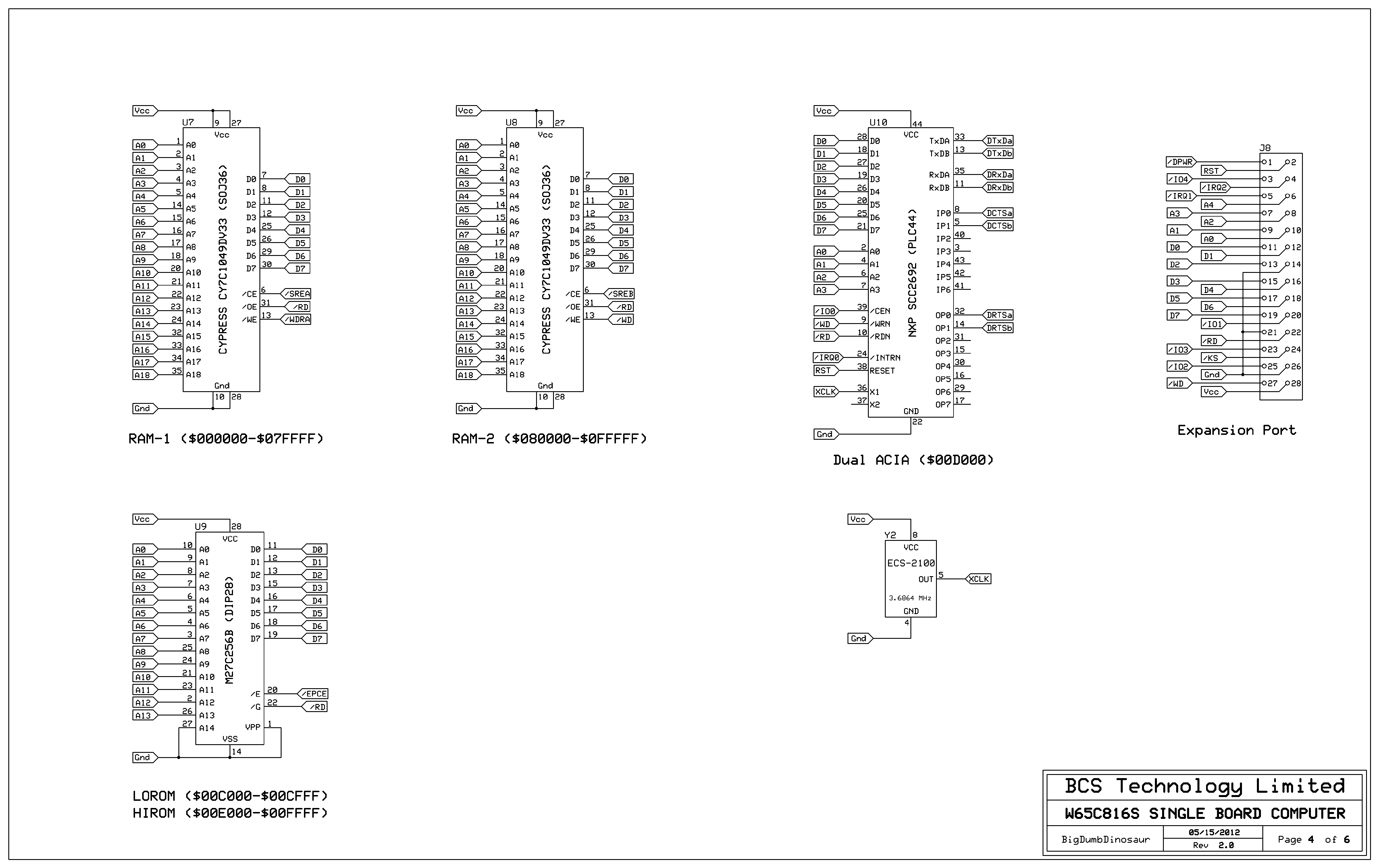

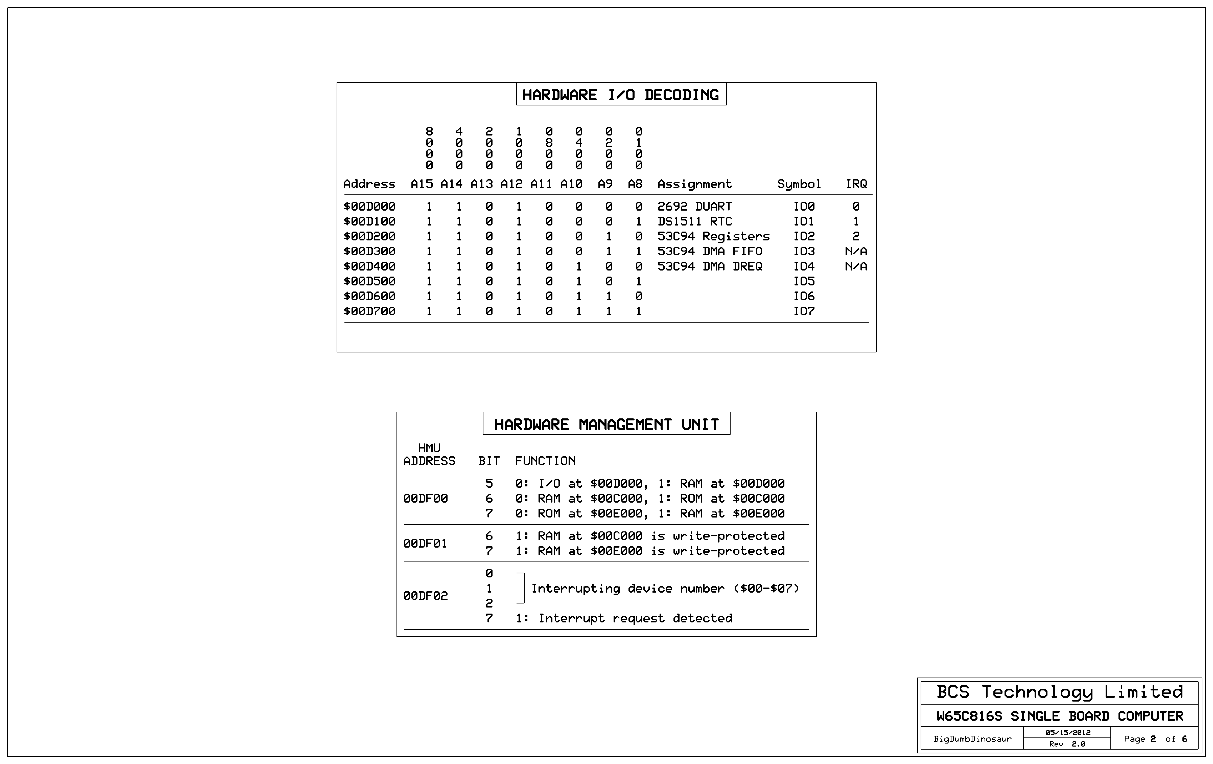

Meanwhile, I went to work on revised POC V2 hardware. The schematics follow:

Due to the forum software's five attachment limit per post, the preliminary printed circuit board layout is in the next post.
Salient features of this design are:
  • 1024 KB of RAM, implemented with two 512 KB SRAMs in a flat memory model. Addressing ranges from $000000 to $0FFFFF. Pages 1 and 2 of the schematic give the details. The first 64 KB of RAM is "base RAM" and everything above is "extended RAM." I used those terms so I could easily refer to these ranges in the CPLD code. Functionally speaking, this design could work with just base RAM, but would then effectively be nothing more than POC V1 with faster logic.
  • Glue logic in an Atmel 1508AS CPLD. The 1508AS is a fairly mature product that can support 3.3 or 5 volt I/O operation. The core itself runs at 5 volts. Currently it appears the 1508AS may be a bit of overkill, but that's better than not having sufficient resources. Incidentally, Atmel makes a test rig for this device (and many of their other 1500 series CPLDs) that doubles as a programmer. I decided to invest in one rather than scratch-design and build a JTAG device.
  • Segmented ROM. The $00E000-$00FFFF ROM range will contain reset code, the BIOS and a basic interrupt handler. The $00C000-$00CFFF range will be the new home of the machine language monitor. Either or both ROM segments can be mapped out to expose the RAM below. A write to any ROM address will automatically bleed through to RAM, so the BIOS segment could copy itself to RAM and then map itself out and continue running from RAM. This would be effectively like "BIOS shadowing" in the PC architecture, with a corresponding performance improvement.
  • I/O at $00D000, with eight device selects available. There will also be RAM under the I/O block that can be exposed if for some as-yet-unknown reason I decide that 4 KB chunk of RAM is good for something. Incidentally, the $00C000 and $00E000 RAM blocks can be write-protected in this scheme. Write-protecting the $00E000 block will be important, as the kernel's interrupt handlers and the MPU vectors will be in this range.
  • Hardware memory protection. Once this hardware is working, I may try to see about policing attempts to execute potentially destructive instructions (e.g., stack pointer changes), assuming there are enough P-terms left in the CPLD when everything else has been handled. If I can do that I may be able to solve the bank $00 dilemma.
  • ROM and I/O wait-stating. At any speed above 12.5 MHz wait-stating will be necessary. As the access times of the ROM and I/O devices are about the same, a one-size-fits-all wait-state period should be okay for initial testing. I did wire an external jumper (EWS) into the circuit which, if shorted, will add an extra wait-state without having to reprogram the CPLD.
  • Priority interrupt controller (PIC), with eight IRQs available. I don't actually need that many, but it's a good programming exercise figuring out how to make it work. The interrupt controller will eliminate the need for polling each device to see if it's interrupting, which will certainly help performance. As with the HMU, the interrupt controller is a virtual device within the CPLD. The controller will present an IRQ number ($00-$07) on the data bus when interrogated. The PIC will ultimately yank on the MPU's IRQB input to produce the interrupt. That CPLD output will be actively driven in both directions so slew time in the IRQ circuit doesn't get in the way of high speed interrupt processing (e.g., when an octart has all eight channels going full blast).
  • Active bus drivers. Although these were not present in POC V1, testing has revealed that they will be required in V2. More on this below.
  • Backward compatibility to POC V1—sort of. The physical layout of POC V2's printed circuit board will allow me to plug in my existing SCSI host adapter (HBA). A small patch will have to be made to the HBA to account for the use of separate IRQs for the SCSI controller and the watchdog timer. Otherwise, it'll work like it does in POC V1.
When I had built the first SCSI HBA I quickly found that I had to slow down the Ø2 clock in order for the unit to work. During 'scope observations of POC V1's buses with the SCSI HBA installed, it was soon clear that the MPU was having some trouble driving the buses hard enough to maintain acceptable slew rates. The problem is that the HBA effectively takes the entire data bus and part of the address bus off the mainboard, which unavoidably adds unwanted reactance to the circuit, mostly a lot of stray capacitance. With that capacitive loading in place, the MPU couldn't generate enough drive to slew the data bus at an acceptable rate once Ø2 got over 10 MHz. If the HBA were removed then error-free operation was possible at 15 MHz, although there were timing violations to the I/O hardware that caused occasional funny behavior with the TIA-232 ports.
After mulling this for a while, and mindful that WDC doesn't actually state in the data sheet what the '816's fanout capability is, I concluded that I needed to do something about bus drive. Otherwise, it was a sure bet that the extra loading of the CPLD and two pieces of SRAM would sabotage any attempt to achieve high speed operation. Although it is generally known that the '816's drive strength is better than might be expected, it wouldn't be safe to design around an assumption. So this new design includes 74ABT541 bus drivers for A0-A15 and a 74ABT245 transceiver for D0-D7. ABT logic is exceptionally fast (3-4 ns prop time) and produces high output drive. The only real negative is that there are a few more parts for which to find space on the PCB. I resolved that issue by using SOIC (50 mil) packages.
Naturally, this design will receive more scrutiny before anything gets produced, as it's likely some little oversight is waiting to get me. :lol:

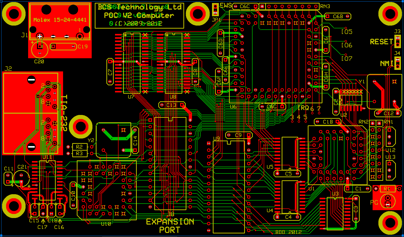

Here is the printed circuit board layout for POC V2.
File comment: POC V2 PCB Layout
Like POC V1, this will be made with EPCB's ProtoPro service. I slightly enlarged the board to make room for extra hardware and to facilitate trace routing. I had to play around with the layout for a while because it kept exceeding the 650 hole limit of the ProtoPro service. Shifting things around allowed me to eliminate unnecessary via. The board is exactly 21 square inches, which is the limit for the ProtoPro service. I will probably play with this some more, since it's likely there's an error somewhere that will need correcting.
Last edited by BigDumbDinosaur on Mon Jun 25, 2012 7:34 am, edited 1 time in total.
