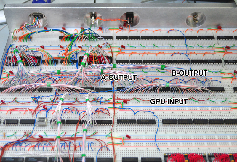

I did layout the GPU based on the messy diagram above, and might have enough time to test the XY counters tonight when the skeeters come out.
If my plan works, then this will be the GPU.
Who's who in the Solderless Zoo.

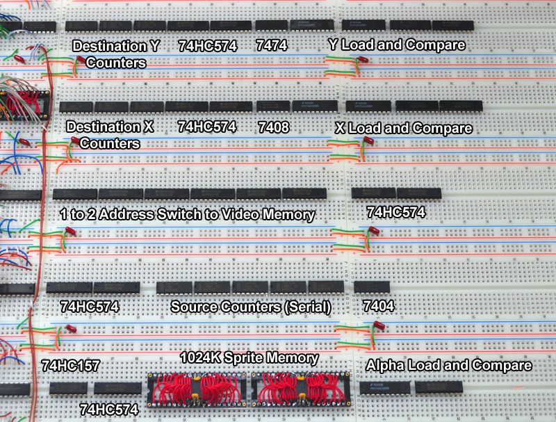

From the description above, this is how the GPU (should) work...
A 10 nanosecond bank of 1024K of memory (Graphics Memory) runs on its own isolated 20 bit address bus, fired by a series of 163 counters clocked at 20Mhz.
This is contiguous memory holding the "sprite data". The CPU can preset set the 163s with 20 bits of "Source Address".
The GMEM is clocked through 3 stages, with a series of 574s that keep propagation below 40ns, and allow switching to the dual buffer Video Memory.
As pixel data is pumped out of the GMEM, it is qualified with a known value set in the 688 comparator by the CPU, which is called "Alpha Color".
Any data NOT equaling Alpha, is sent to the VMEM data port, registered in sequence with the address and WE, controlled by the Alpha logic.
Data equaling the Alpha Value is considered "transparent", and is not drawn. This is how the GPU handles automatic transparent pixels at 20MHz.
On the "Destination" side of the logic, we have a split set of chained 163 counters running the X and Y address counters to the VMEM back buffer.
The CPU presets these values; Destination-X1 and X2, Destination Y1 and Y2. This tells the GPU where on the screen to draw the sprite block.
As you can see, sprites are not limited in any way, and can be as small as a single pixel, or as large as 512x512 due to the 9 bit XY addressing.
A few 688s control the resetting and wrapping of XY counters, and then trigger a "Ready" signal at the end of a sprite transfer.
This next stage in design will be more interesting for me since everything from here is untested.
Having done VGA designs in the past, the video section was not much of a challenge.
No doubt, there will be revisions, so wiring will be messy as I prototype the GPU!
Will try to make a few more posts this weekend.

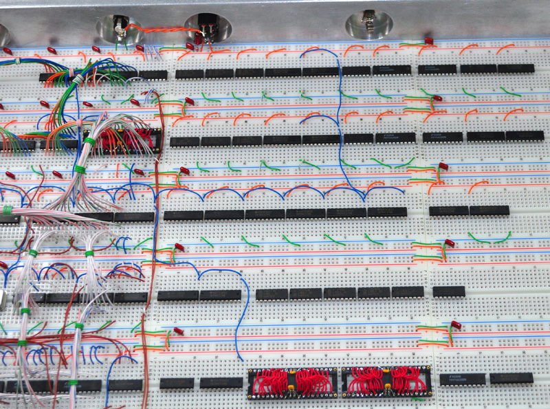

Well, the weekend passed on by, and it only left me with about 30 minutes of time to work on the board.
Managed to connect VCC and GND wires on the top half of new ICs, so at least something was done!
I only connected chips from the 574 Address Switch row and up, as these are the destination counters.
While I was banging nails into trusses (and my thumb), I figured that testing only the XY counters would make debugging easier.
With only the XY (destination) counters working, I would at least be able to draw blank blocks to the screen, simulating sprites.
With no source counter running, there will be no real pixels, but by tying the GMEM data-path to some value, I can move colored blank blocks.
Once I have variable sized blocks flying around the screen at 20 million pixels per second, I will then add the source counter section.
If anything is going to be trouble, it will probably be the alpha pixel control circuit, as it has a 40ns reaction time, leaving 10ns setup time for the next 574 stage.
This is most likely no issue at all since I am working with worst case timings form the datasheets, but it is now my slowest path of any signal.
40 nanoseconds... damn, I could go make fresh coffee and get back before the rising edge, man!

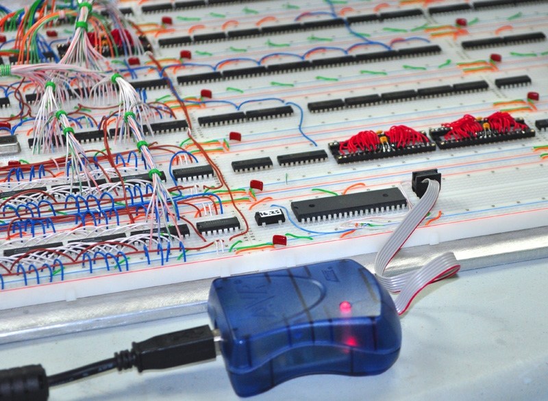

As far as testing the GPU as it is being built, I will be relying on an AVR1284, as it offers 128K of program memory, and 32 IO lines.
With that much program memory, I can stuff the video memory with a full screen bitmap, and make sure there are no missing pixels.
With 32 general IO pins, I can simulate the control of the GPU, which will be the job of the 6502 IO logic later on.

Not much to report yet, but did manage to get some more wiring done.
Power and Clock Lines.
Connected all of the VCC and GND wires to the new chips, and ran the clock lines to all of the 574 registers (blue wires).
Usually, I use blue wires for clock and data, brown wires for control lines, and white for addressing lines.
An ATmega-1284 to be used for graphics tests.
Before I connect the 6502, I need to verify my design. I will be using an ATMega-1284 to test the graphics and GPU.
Since I can code AVR assembly better than I can chew bubblegum, this is the most logical way to debug the hardware.
The AVR will hurl pixles to the back buffer and then swap the memories so that the switching system can be verified.

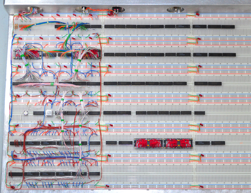

GPU address switching wiring completed.
Much like the dual switched bus of the Video System, the GPU must also have its own switchable dedicated bus.
The GPU to Video side of the bus is a dual 18 bit address bus and dual 8 bit data bus. There are also 2 control lines.. OE and WE.
My next test will be to bolt the AVR to the input side of the GPU switch and simulate pixel data coming from the dedicated Graphics Memory.
Graphics Memory is a 1024K serial stream from a dedicated bus only available to the GPU. Data is sent at 20MHz.
Oddly enough, I have not even tested the video system besides seeing random pixels, but I can't image why it wont work perfectly.
This circuit is a direct copy of the original mess, so it should be 100% functional.
The first test will be a 400x300 image with 256 colors. A single pixel border will be drawn to ensure that no pixels are fat, skinny, or missing.
The border pixels are the most difficult part of a video system, and of all things, this has been the most challenging thing to perfect.
I will be wiring up the AVR for testing tomorrow, and will post again soon!
