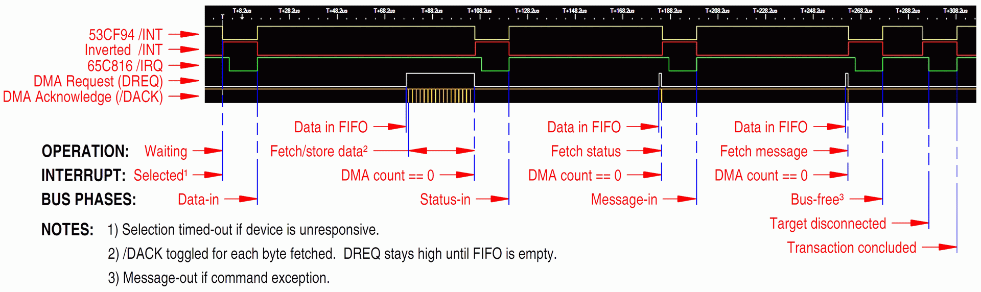

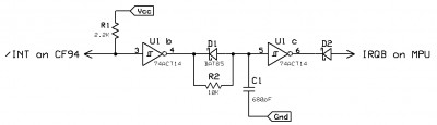

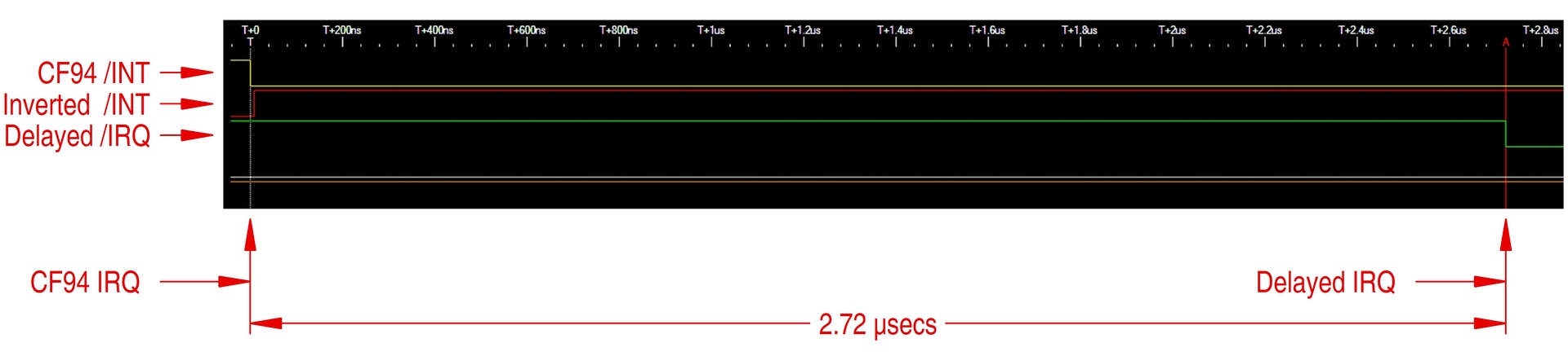

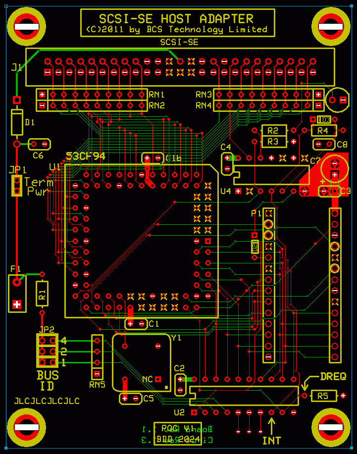

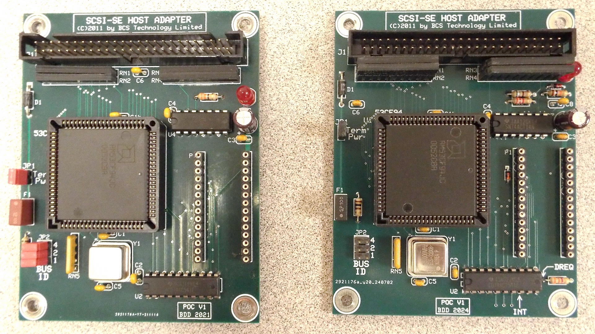

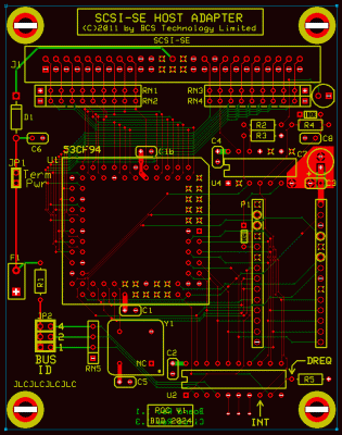

Many pages ago, I described the SCSI host adapter I built to attach mass storage to my POC units.  First a little history...
The core of the original host adapter was the 53C94 “advanced SCSI controller,” an NCR device that was second-sourced by AMD and others, and was used in the host adapters of a number of different systems.  The C94 is a member of a family of NCR SASI/SCSI controllers that dates back to the early 1980s, well before SCSI had been defined as a formal standard.  The C94 has considerable intelligence, offloading virtually all aspects of the bus protocol from the host system.  That intelligence makes it possible to support SCSI without the need for the driver having to know much about the bus protocol.
A project of mine from the early 1990s used the C94’s ancestor, the 53C90A, to implement SCSI on a unit powered by a 65C02 running at 8 MHz.  The C90A supported the then-nascent ANSI SCSI-2 standard (1989), as well as the older ANSI SCSI-1 standard (1986), and the still-older SASI bus developed by Shugart Associates in 1979 and first commercially supported by NCR in 1981.  Using the C90A and some reasonably efficient programming, I was able to achieve a respectable transfer rate of around 350 KB/second with this setup, about 10 percent of the maximum raw, asynchronous SCSI bus speed supported by the C90A.

For some reason, I had a hard time getting my head around the circuit details—a “senior moment,” as it were—and thus sought some suggestions, which primed the pump for me and led to a solution.
File comment: IRQ Delay Circuit
The above circuit delays the propagation of the CF94’s /INT signal by about 5-or-so microseconds (assuming my math was correct in selecting the values for C1 and R2), which gives the 65C816 plenty of time to write the final byte to RAM during a read transaction, even at 1 MHz.  The circuit will rapidly clear once /INT goes high, which should avoid a dreaded spurious IRQ.
I have designed a revised host adapter circuit and PCB layout to implement this change.  The PCBs are on the way.  More on this when I have built the host adapter.

I have received the PCBs for the new host adapter and have commenced the build.  It should be ready to go in a day or two.
PostPosted: Wed Jul 24, 2024 5:35 am
Posts: 8507
SCSI host adapter is built and works.  In the below picture, the previous-design host adapter is on the left and the new-and-improved version is to the right.  As with the previous-design adapter, the new one is clocked at 25 MHz and is theoretically capable of supporting a maximum SCSI bus speed of 5 MB/second in synchronous mode (the 53CF94 can support a synchronous bus speed of 10 MB/second if clocked at 40 MHz).  In my application, the bus is run asynchronously, with a maximum speed of 3.5 MB/second, which is well beyond the speed at which the 65C816 powering POC V1.3 can copy bytes to/from the host adapter.
Next step will be to hook up the logic analyzer and observe the behavior of the host adapter’s delayed-IRQ circuit.  Assuming it is working as designed, the next step will be to modify the SCSI driver code to take advantage of the new-and-improved hardware and, it is hoped, increase the transfer rate.

I finally got around to hooking up the logic analyzer to the new SCSI host adapter to observe the behavior of the latter’s interrupt circuit.  Recall from above that this host adapter is designed to delay its IRQ so as to give the MPU sufficient time to complete the last store instruction during a read operation.  Below is the annotated capture from the logic analyzer showing the behavior of the IRQ delay feature:
File comment: Delayed IRQ Capture
The delay isn’t as long as I had calculated when I was designing the host adapter because I made the assumption that two R-C time-constants would be required to “trip” the Schmitt inverter that drives the host adapter’s /IRQ output.  It appears only one time-constant is needed to do that.  Even so, the 2.72 µsec delay is more than sufficient to accomplish what is needed, even if the Ø2 clock rate is only 1 MHz (which it never is :D).
Incidentally, the measured propagation delay through the Schmitt inverter is 8 ns, roughly about midway in the device’s specs.

What follows are several captures of HBA signals, the first of driver operations as a “request sense” command is executed.
File comment: “Request Sense” Sequence
First, a signal explanation:
  • 53CF94 /INT.  This signal is the open-collector interrupt output of the CF94 bus controller.
  • Inverted /INT.  This is the inversion of 53CF94 /INT.  It appears as bit 6 when the HBA’s status is fetched by the MPU.
  • 65C816 /IRQ.  This is the interrupt signal actually seen by POC V1.3’s hardware.  As described in my previous post, /IRQ is made to lag 53CF94 /INT to avoid a potential timing race condition in the SCSI driver during read operations.
  • DMA Request (DREQ).  The CF94 has a 16-deep FIFO that acts as a bi-directional data path between the SCSI bus and the host system.  When a direct memory access (DMA) read operation is in progress, DREQ will be asserted any time there is at least one datum in the FIFO.  When a DMA write operation is in progress, DREQ will be asserted if there is room in the FIFO for another datum.  DREQ appears as bit 7 when the HBA’s status is fetched by the MPU.
  • DMA Acknowledge (/DACK).  During a DMA read or write operation, /DACK will be asserted when the HBA’s DMA port is accessed by the MPU.  The result is the aforementioned FIFO will be connected to the data bus and the MPU can read or write it as required.  /DACK is toggled for each byte that is to be read or written.  Toggling /DACK will also decrement the DMA transfer counter register in the CF94, which is programmed with the number of bytes to be transferred during a read or write operation.  The coordinated usage of DREQ and /DACK handshakes all DMA activity.
The above logic analyzer capture shows how things progressed during the processing of a “request sense” command.  The capture begins after the target has responded to selection, the bus has entered the command phase, the CDB has been sent and the target has deciphered it.  As the operation specified by the CDB is acceptable to the target, the latter switched the bus to the data phase.  Had the target been unable to decipher the CDB or had the operation specified by the CDB been one not supported by the target, the bus phase would have been switched to status and the target would have reported “check condition” to indicate the error.
The bus phase change IRQ directs the SCSI driver to commence executing its data-in code.  Some configuration is done to the CF94 and then it is commanded to start the data transfer sequence, which will result in a bus handshake with the target to tell the latter to send some bytes.  DREQ will be asserted by the CF94 as bytes arrive from the target and collect in the FIFO.  As long as DREQ remains asserted, the driver will toggle /DACK to fetch a byte from the FIFO.  This process will be repeated until DREQ is deasserted.
As earlier noted, “request sense” returns 18 bytes during data-in, which is apparent in this capture; /DACK was toggled 18 times before DREQ was deasserted.  I should also add that the ANSI SCSI-2 1994 standard says up to 65,535 blocks may be accessed in one transaction when reading or write a disk’s medium.  My driver is not quite that ambitious, as it can only process 127 blocks maximum per transaction.  Either way, a whole bunch of bytes could be transferred during data-in, 65,024 in a 127-block transfer to/from a disk.  In such a case, it is possible DREQ could be deasserted and reasserted several times during data-in, depending on how well the target can keep up.  If DREQ does deassert during a transfer procedure, the SCSI driver will spin in a loop until the CF94 is ready again—theoretically, the driver could get “stuck” if the target goes completely out to lunch by failing to send all requested data and not changing the bus phase to status to indicate a problem.
Eventually, all requested bytes will have been sent and the CF94 will interrupt.  When this happens, the driver will determine the new bus phase, which usually will be status.  Upon receiving the status byte from the target, the CF94 will again interrupt and the bus phase will now be message-in.  After the message has been received, the transaction will terminate and the bus will become free.
