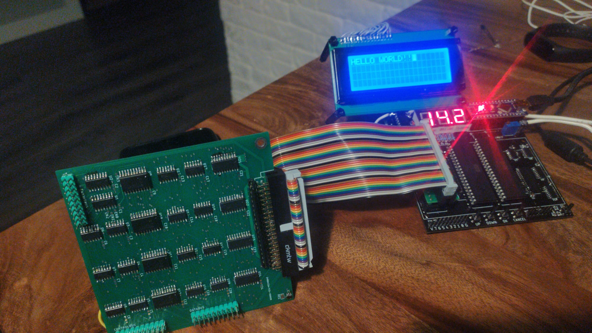

I had no plans for the weekend anyway... so I put my spare time to good use.
I just need a '245 and it's done! If I can't get my hands on one, I may try just bridging it... we'll see.
If anyone is wondering with the LCD stands are out of place on the bottom left corner... the board is so tightly packed up there, that they won't fit. Sames goes for upper left corner. If there's ever a v0.2, that's something to fix.
Time to work on the firmware!

And one last update for the weekend, and probably for the whole next week.
To overcome the lack of the '245 buffer, I just bridged it, as it should be no issue for the 74HCT6526, and indeed, it works.
I now have a very rudimentary java app that uploads a RAM image to my board. I run a test and I can write the upper 16 KB in around 30 seconds, with perfect accuracy, by the way, no lost or flipped bits.
I've gone only as far as having the 6526 blink a led on it's Port B. This also requires the 6522 to work, as the 6526 RESET is controlled by 6522's PA5. And again, it works.
As you can see everything seemed to be working perfectly for me today, so I thought... why not try? And bang, an old NMOS 6526 is also working, without the need of the buffer :) I'll add it anyway, just to be on the safe side.
What a weekend :)

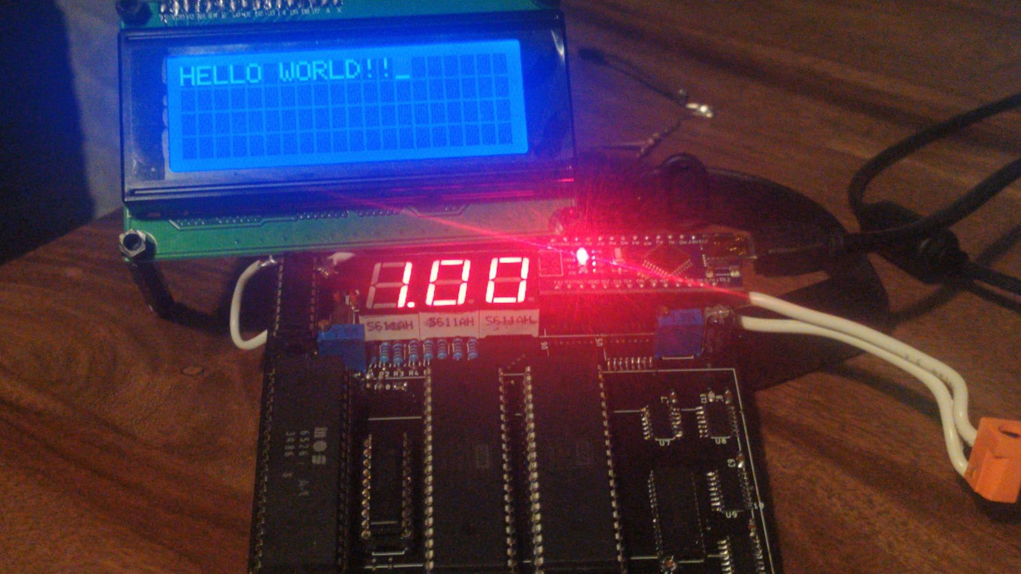

Ain't it beautiful? If that poor old 6526 (Datecode 3486) had some self-conscience, it would be feeling preety akward right now. At least, It's only running at 1 MHz.... I won't come as a surprise to anybody, but I was amazed by the heat the 6526 produces at 1 MHz... while the newer parts are just stone cold, even at higher speeds!

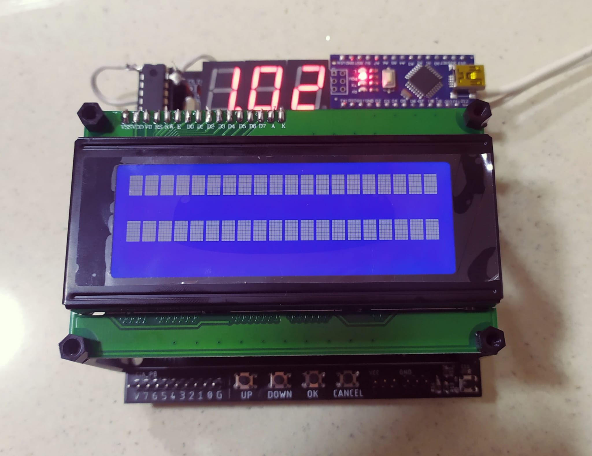

All of them are fulfilled. I even exceeded in the second one, as the computer has minimal input, in the form of 4 push buttons for basic commands. Having PortB of the 6526 exposed it gives me some expansion capabilities if needed.
The firmware, although very basic, is enough for the testing I want to run. About its speed, if my frequency meter is accurate, it goes up to 17-18 Mhz. Beyond that, the display goes south, oscillating between 20 something and almost 40, so probably it's the clock itself degrading. Everything is rock solid at 14 Mhz, so I'll keep that as my limit for now.

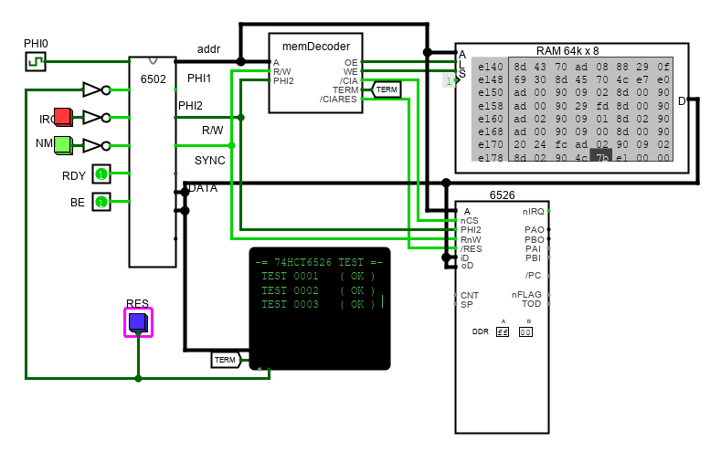

And with just some minor tweaks, to account for the lack of a 6522, here it is, my sbc6526 firmware running on logisim, along a very primitive 6526 with just two registers for now.
Actually, As I had the code splitted in a few libraries (CIA, VIA, LCD, ScreenMemory), there are only changes on my main.asm file, for which I now have to separate versions, one for the Physical SBC, one for the Logisim SBC.
Moving to a virtual lab for now!
