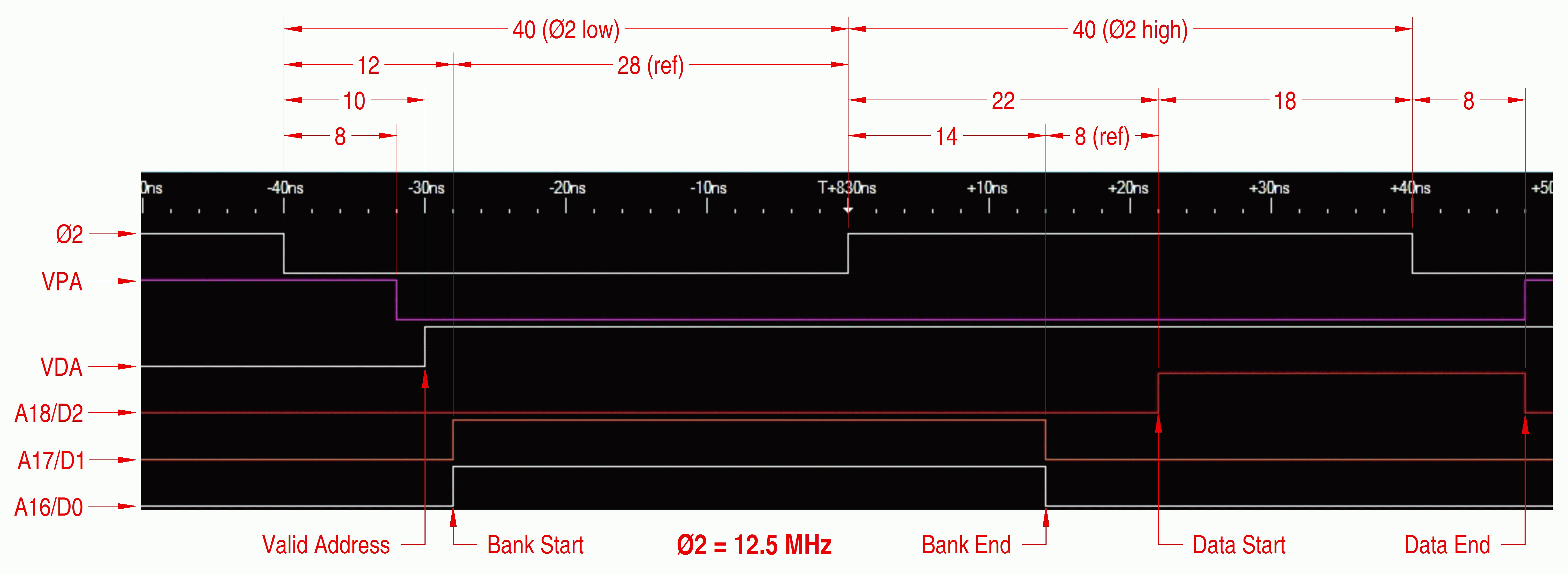

For some time, we've been kicking around various methods of wait-stating when a slow device must be accessed on an otherwise-fast machine...
While I had the logic analyzer (LA) hooked up I captured what the '816 was doing during a read cycle and annotated the result. Operating conditions are room temperature, 5 volts and Ø2 at 12.5 MHz. The transition from logic 0 to logic 1 is assumed to occur at 2.5 volts and is assumed to be symmetric—the LA has no provisions for independently setting the logic 0 and logic 1 levels. Annotated times are in nanoseconds, with a ±2ns accuracy.
File comment: 65C816 Read Cycle — Selected Signals
The code that was being executed during this capture was:
         sep #%00110000        ;8-bit registers
         lda #%00000011        ;read...
         pha                   ;from...
         plb                   ;bank $03
loop     lda $8000             ;effectively LDA $038000
         bra loop
Prior to starting this, I placed $04 at location $8000 so as to produce a data bus pattern that would clearly not be the same as the bank address. The capture occurs at the final cycle of the LDA $8000 instruction, which is when the '816 reads the addressed location. As is always the case with the '816, the Ø2 low phase is when address setup occurs and the bank bits are emitted on the data bus.
Of particular note is the bank address persistence after the rise of Ø2. The measured 14ns is critical because the bank latch must be closed before that period expires, otherwise undefined content may be latched and ultimately result in data corruption due to addressing errors. Assuming the use of a 74AC573, there is only a 3-4ns margin, worst-case, before the data bus turnaround begins. That being the case, the reference circuit shown on page 44 in the 65C816 data sheet would fail if the '573 is at the weak end of its specifications. This would be due to the fact that the inverted Ø2 signal used to control the latch will lag Ø2 by one gate delay, effectively reducing the 14ns window by anywhere from 2ns to 7ns, depending on the inverter being used.
Also, note the 8ns period between when the '816 stops emitting the bank and the addressed device (RAM, in this case) puts data on the bus. In my POC designs, the Ø2-qualified read/write circuit drives /RD low one gate delay after the rise of Ø2, which ranges from 1.9ns to 6.6ns, according to the data sheet. Assuming the gate's performance falls near the middle of the spec, it would mean the RAM is responding with considerable alacrity to /RD.
The 8ns data persistence after the fall of Ø2 can be attributed to a combination of logic latency and bus capacitance.

Hmm - and what if, instead of deriving the bank gate from an inverted Phi2, you derive Phi2 as an inverted Phi1? That would give you more margin for the latch event.
Just to clarify for the benefit of anyone who is not sure what it is we're discussing, it's the tBH parameter in Jeff's drawn-to-scale timing diagram. This is the amount of time the '816 continues to drive the bank bits onto the data bus after the rise of Ø2.
I foresee two problems if Ø1 is made to lead Ø2. The first one is tBH would be improved at the expense of tBAS. As the MPU's timings are independent of Ø2 frequency at any given voltage, the effective shortening of tBAS may violate the latch's setup time before Ø2 goes high if the frequency is ramped up enough.
The second problem is the bank latch will be opened prior to the completion of the data cycle. If that happens soon enough before the fall of Ø2 the data bus' contents will end up in the latch and cause A16-A21 to assume an undefined state. That will assuredly cause data corruption and likely crash the machine.
In a system that generates Ø2 from a flop, the Q and /Q outputs are exactly 180° out of phase. So if Q is Ø2 then /Q would be Ø1, eliminating the need for the inverter. I think as long as the inverter's delay can be eliminated and the latch's performance is 3 to 4ns better than tBH the timing margin will be reliably maintained.
In the case of the clock stretcher circuit describe a few posts back, there is no complement to the counter's output, which means either an inverter must be used to generate Ø1 or the counter's output has to be run through a flop to generate the out-of-phase clocks. Doing the latter would mean the clock oscillator would have to run at four times the frequency of Ø2. Doing the former would put us right back into that potential timing quagmire involving tBH.

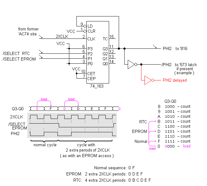

Now will be a good time for a schematic. :) Can you confirm these details, please, BDD? The drawing below is taken from my original post. Details not pertinent to POC (such as the non-stretched VIA clock) have been removed, and I added some notations that do relate to the POC context. Also shown are two inverters, one which theoretically would drive the enable input of '573 latch (for the Bank Address) and another (in red) which I included only for the sake of discussion.
This '163 circuit replaces the 'AC74 in BDD's PDF schematic, included in this post.

PostPosted: Sun Apr 12, 2020 4:44 pm
Correct.
[...] which means either an inverter must be used to generate Ø1 or the counter's output has to be run through a flop to generate the out-of-phase clocks.
There are other options, and they're tolerably easy and satisfactory. I need to make an addendum to my original post, but it probably won't happen today.

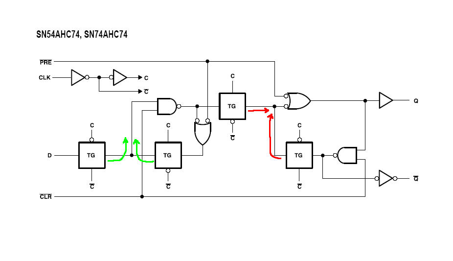

I used to believe this, but it turns out not to be a reliable assumption. Some modern flipflops are implemented using CMOS Transmission Gates rather than a symmetrical arrangement of cross-coupled NAND's as in the old days.
The 'AHC74 accomplishes the "edge triggered" function by using one follow-hold transparent latch that feeds into another (arranged as hold-follow). Each latch has two TG's feeding its input, acting as a SPDT switch to select new data or previously stored data. (diagram below)
In the second stage, notice how the path from the input node to Q is one gate-delay shorter than the path from the input node to /Q. This casts doubt on the theory that transitions on the Q and /Q outputs will be exactly simultaneous.
It's true that data sheets don't always faithfully indicate internal logic. Sometimes a warning to that effect appears. But the assumption about Q and /Q switching exactly simultaneously is clearly out the window, IMO.
The data sheet doesn't support assumptions; all it tells us is the min and max clock-to-output delays. Q's delay will fall within that range and so will /Q's. But nothing says Q's place within the range will exactly match /Q's.
