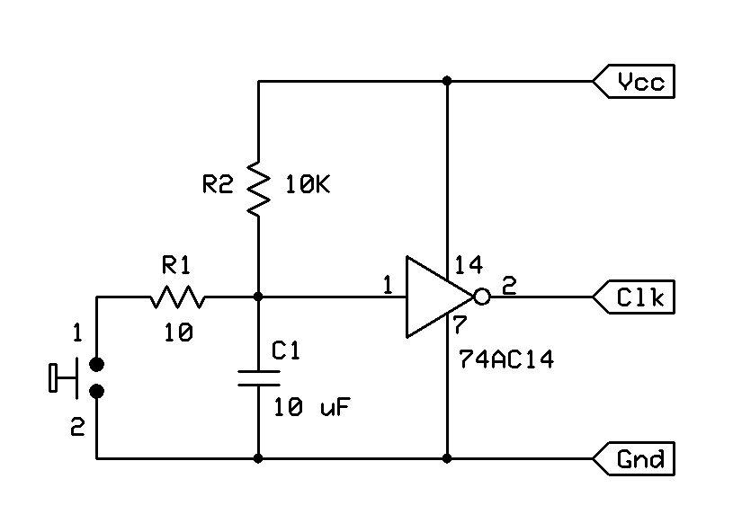

So I decided to dust off an old gadget that anyone debugging 65xx hardware should have: a clock single-stepper. As V1.2 uses a flip-flop to condition the clock oscillator output, a dampened (debounced) push button can be used to toggle Ø2. WDC MPUs can be safely halted by stopping Ø2 in either phase, a feature that can be very helpful in troubleshooting that recalcitrant gadget you just built.
My original design used a Maxim DS1813 to dampen the push button. However, the clock would sometimes double-toggle, which I subsequently determined was due to the DS1813 generating an occasional runt pulse. So I decided to go a different route. Here's the circuit I used.
Clock Single-Stepper
Each push of the button will cause CLK to go high, causing the clock flop on V1.2 to toggle. Hence Ø2 will change state with each push of the button—two successive pushes constitute one Ø2 cycle. The R-C circuit attached to the input of the Schmitt trigger causes a relatively slow voltage rise after the push button has been pressed and released. The circuit's time-constant is sufficient to delay the Schmitt's change-of-state until well after contact bounce has ceased in the push button. I chose a time-constant of 100 milliseconds to avoid accidentally double-clocking.
Incidentally, a 74HC14 can be used here, as operating speed is obviously not critical. I used the 'AC14 because there was one in the junk pile.
Anyhow, after hooking up the above gadget and doing some probing and thinking it became clear why the unit was misbehaving. The ROM's /CS is asserted any time the address is $D000 to $FFFF. That translates to $1000-$3FFF in the ROM, due to decoding starting on an "odd" page ($DO). Where the shoelace tripping came in was when I burned the ROM image to $0000 instead of $1000 to compensate for the "odd" starting page. The MPU vector ($D000) was burned at $2FFC-$2FFD in the ROM, but when the MPU went to read a vector following reset it was reading from $3FFC and $3FFD. Nothing above $2FFF in the ROM had been altered, so the MPU was loading $FFFF as the reset vector. The result was the MPU went to $FFFF for its first instruction, where it found (you guessed it) $FF. :o

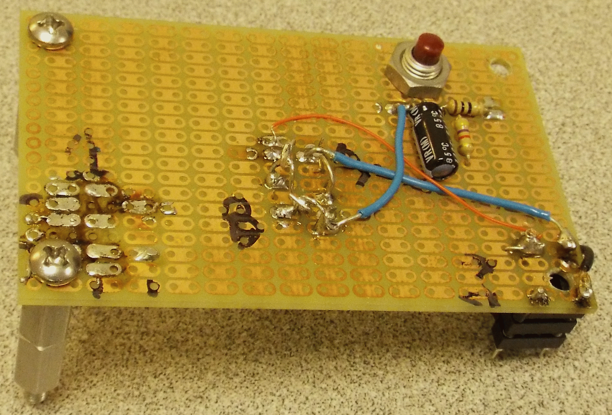

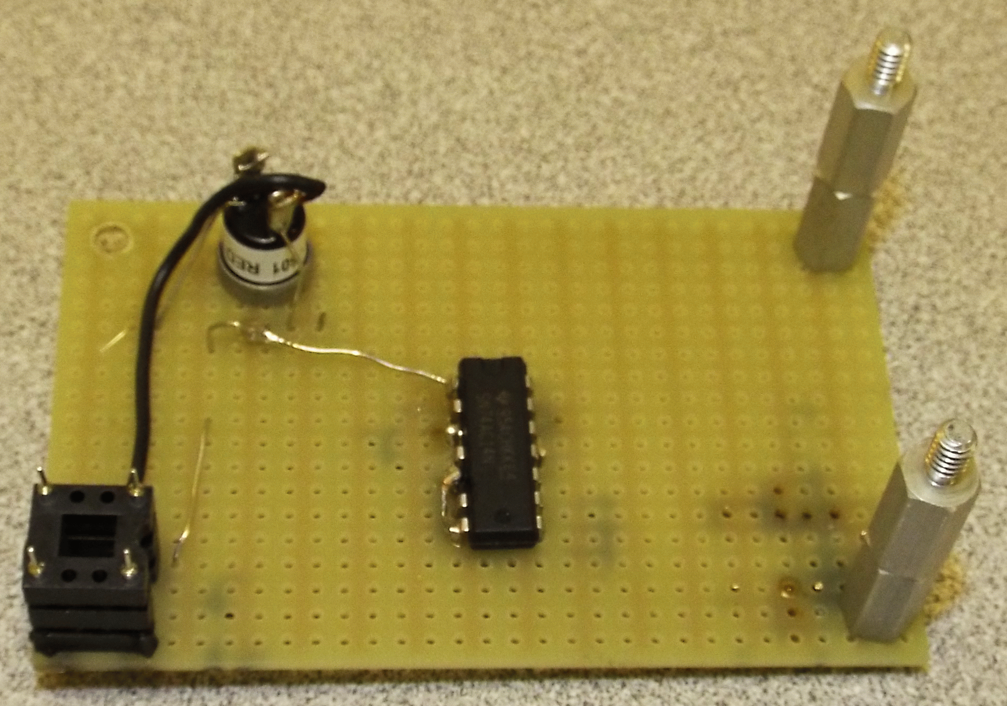

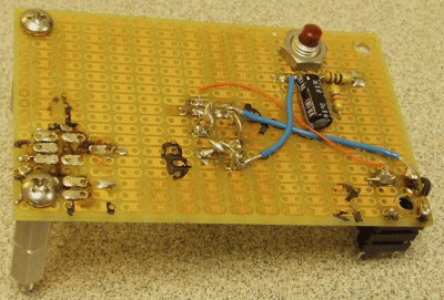

In my previous post, I mentioned how I used a clock single-stepper to figure out why POC V1.2 was stubborn about running. Here are some picture of the single-stepper. Be prepared to see a crude hack-job using odds and ends I had laying around in the shop.
Clock Single-Stepper Top View
Clock Single-Stepper Bottom View
Above are top and bottom views of the clock stepper, which will work in any circuit in which the oscillator drives a C-D flip-flop. I believe I have about $3.00 invested in this gadget. That's what I like: cheap test gear.

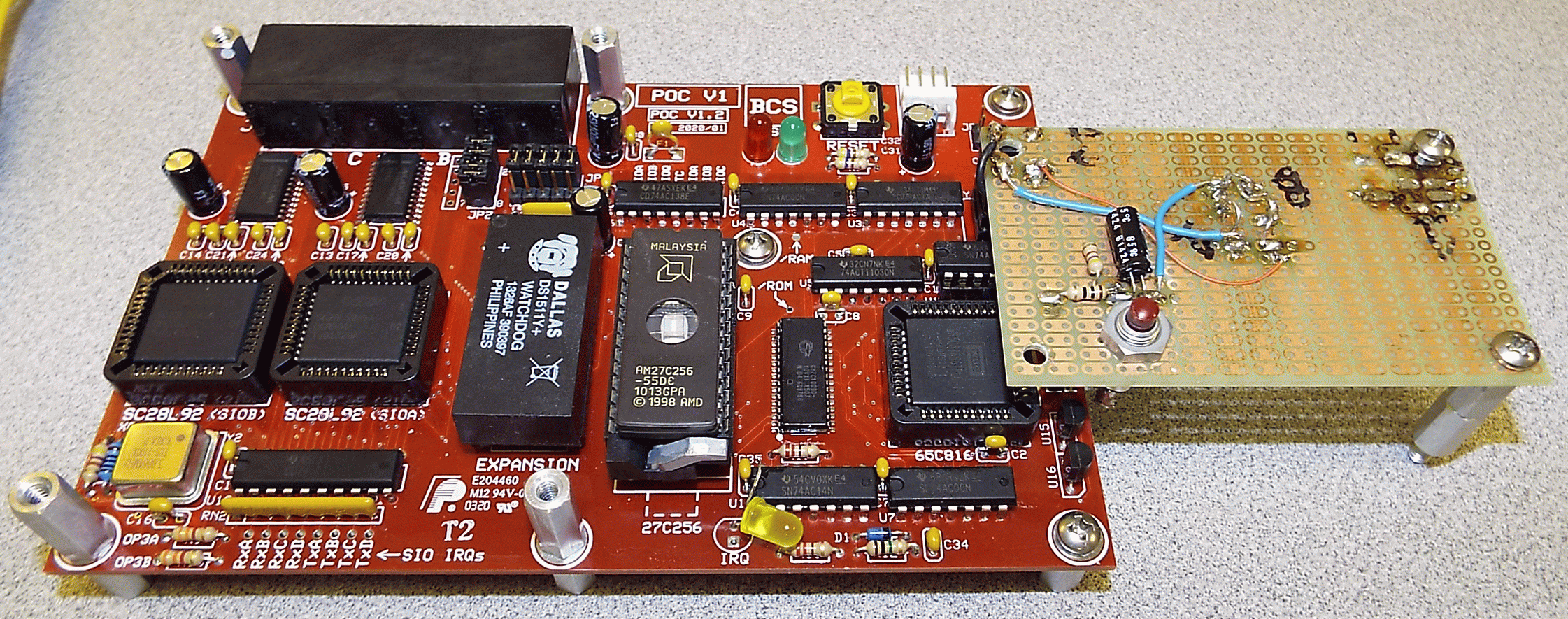

POC V1.2 w/Clock Stepper
Above is the stepper plugged into the clock oscillator socket on the board. Crude but effective. Also, note the hacked-up IRQ "heartbeat" LED to get it correctly situated in the circuit (bottom center of photo). In the schematic, I accidentally connected the LED's anode to ground instead of Vcc. That error, of course, got carried over to the PCB, but fortunately was spotted by an alert reader before I had gotten around to powering the unit and possibly having an electronic train wreck.
Speaking of the IRQ LED, I tinkered with one of the circuit values so the LED is dim when only the 100 Hz jiffy IRQ is present. When any significant IRQ activity occurs the LED brightens up quite a bit. If it goes out...

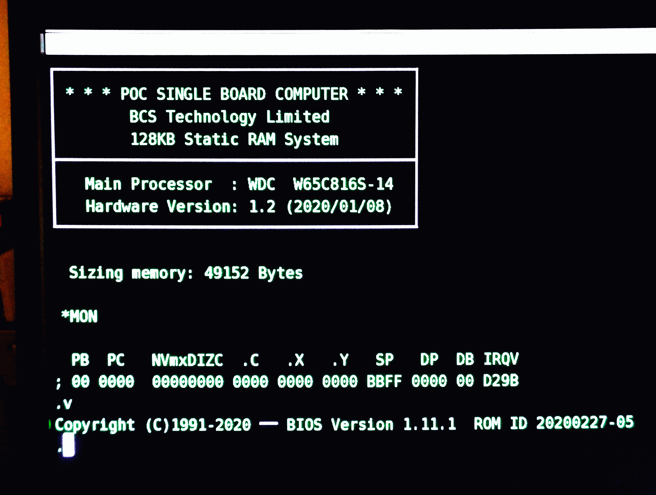

V1.2 is now fully functional, currently running on a 12.5 MHz clock with slightly modified V1.1 firmware. The only significant changes to the code were in the memory map assignments. Those are made in an INCLUDE file, so all that was necessary was to edit that one file, reassemble the code and burn a ROM from the object file. This points out the value of not embedding "magic numbers" such as addresses or constants directly in code, but instead externally defining them. If I had embedded the memory map assignments in code statements I'd still be picking through the source files looking for them and likely missing one or two in the process.

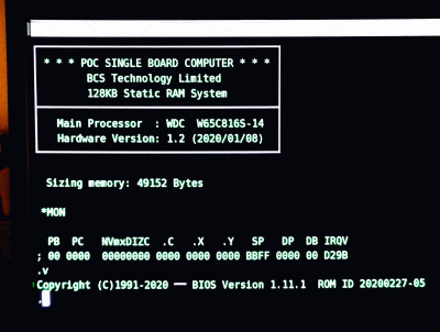

Anyhow, here is a screen shot of V1.2's POST display.
POC V1.2 Power-On, Self-Test (POST) Display

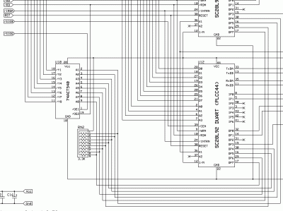

Posts: 9428

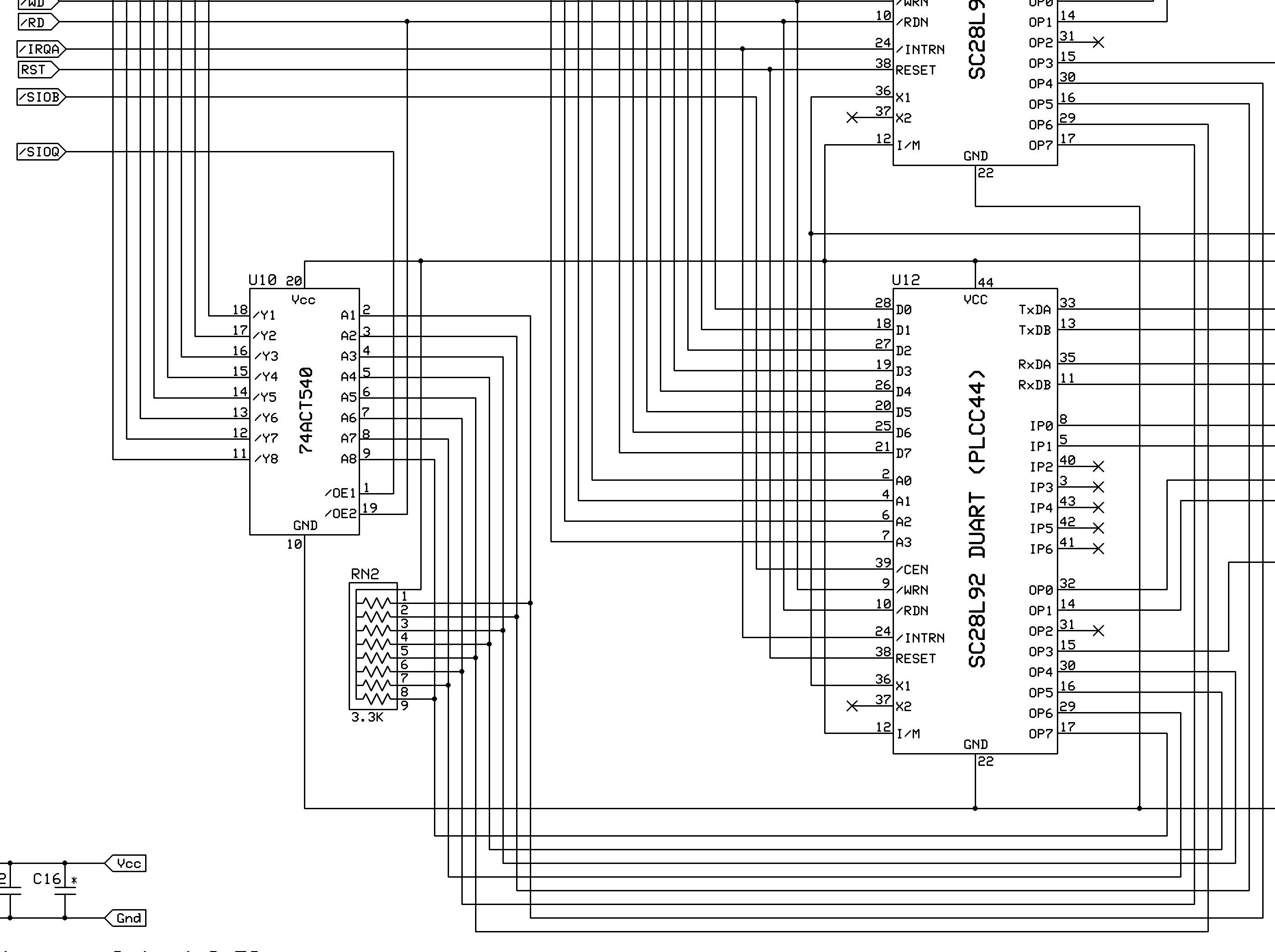

POC Computer Version One Revisited
As earlier stated, the purpose of POC V1.2 is to develop some hardware and programming concepts that can be applied to other hardware later on. Two hardware concepts embodied in V1.2 are the vQUART (virtual QUART) and interrupt "steering."
When I decided to implement the vQUART I realized I was going to have a lot of potential interrupt sources to service. Since there are four communications channels, there are four receivers and four transmitters that can interrupt—possibly all at the same time. Also, the DUARTs each have a timer that could generate an IRQ, which the timer in one of the DUARTs does at 10 millisecond intervals. Hence interrupt steering becomes important when a large number of IRQ sources exist in a system. Otherwise, significant MPU time may be consumed in figuring out which device is interrupting and why.
As the bulk of the IRQs that will be generated will be due to communications activities, I took advantage of a somewhat arcane DUART hardware feature to set up my interrupt steering. In a previous post, I wrote:
Speaking of interrupts, the 28L92 can be configured so general purpose output pins 4, 5, 6 and 7 (OP4-7) act as open-drain IRQ signals. OP4 is wired to the RxD channel 1 IRQ, OP5 is wired to the RxD channel 2 IRQ, and OPs 6 and 7 are wired to the channel 1 and channel 2 transmitters, respectively. When the 28L92 interrupts with its main IRQ output, it will also pull one or more of these pins low if reception and/or transmission activity was the cause of the interrupt.
In order to take advantage of this feature, I have the OPs wired to the inputs of a 74ACT540 bus driver, with bits 0-3 wired to the receiver IRQs and bits 4-7 wired to transmitter IRQs—bits 0 and 4 are channel A, bits 1 and 5 are channel B, and so forth. The bus driver is assigned a location in the I/O map (designated SIOQ) which when read, will return a real-time IRQ status. If %00000000 is read, then no receive or transmit IRQs were generated. Otherwise, bits will be set according to what interrupted. These bits are real-time, meaning they stay set until the cause of the IRQ has been cleared.
This arrangement doesn't report the cause of other vQUART IRQs, such as timer underflow, which must be detected by reading the individual DUART interrupt status registers. However, the interrupt service handler's work will greatly reduced, since no polling of each receiver and transmitter will be required. This reduction becomes important when one considers that if all four channels are simultaneously receiving and transmitting at 115.2Kbps, as many as 46,080 IRQs due to SIO activity could occur in one second, assuming an IRQ occurs with each datum received or sent. In practice, the rate won't be quite as severe, due to the buffering provided by the DUARTs' FIFOs. In the best case, 2880 IRQs would occur each second of continuous bi-directional communication, as an interrupt will only come when a receiver FIFO is full or a transmitter FIFO is empty.
The basic circuit is pretty simple:
Serial I/O IRQ Steering Circuit

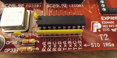

Below is a closeup of the hardware that implements this circuit.
vQUART IRQ Steering Hardware
The 'ACT540 is wired so the individual bits read by the MPU are such that receiver IRQs are reported in the least significant nybble and the transmitter bits are reported in the most significant nybble. Bit 0 is channel A's receiver and bit 4 is channel A's transmitter. This arrangement makes it easy to process active IRQs in a succinct loop. Here's the code for processing receiver activity:

POC V1.2 has been running continuously at 12.5 MHz since March 3 without a hitch. An attempt to run it at 14 MHz was unsuccessful. As all glue logic is 74AC, much of it with sub-10ns prop time, I suspect that the EPROM I have in the unit can't tolerate the resulting 70ns machine cycle. At some point, I may use one of my 45ns OTP ROMs to see if that is the case, although even that part may have trouble.
Otherwise, the unit is working fine and thanks to the downtime caused by COVID-19 and my strong desire to continue breathing, I am deep into redoing the firmware to convert from a jump table API to an API accessed using the COP software interrupt. The new firmware will also support all four serial channels, as well as have some new functions that will be useful when I do something boneheaded with software and semi-crash the machine. :D
Also close to being built will be a clock stretcher on a plug-in module. This thing will be rigged up so it holds Ø2 high for two additional cycles when ROM is accessed and for one additional cycle when I/O is accessed. The two-cycle ROM wait state should make it possible to use 70ns ROMs, which would otherwise be too slow to work reliably above 8 MHz. I hope to soon test out this thing.
