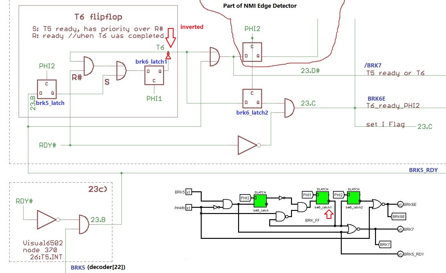

In this post you mentioned that, "BRK has one more step than the rest of the instructions: T6." But isn't it true that the total number of cycles for BRK is the same as that for an interrupt?
BRK is listed as a 7 cycle instruction, and from my point of view it begins with the cycle during which the opcode is fetched. I assume this corresponds to the cycle during which an interrupt sequence begins (by fetching an opcode but discarding it and replacing it internally with $00). Can you clarify, please, regarding "one more step than the rest of the instructions."
True.
We have two sequencers, one generating T0#..T1#, the other generating T2#..T5#, and their outputs go into the PLA.
And we have that T6 flipflop, its output does not go into the PLA.
It goes into some logic gates inside the "random logic area", which also is fed by the PLA outputs.
T6 flipflop _only_ is set when a BRK instruction has finished state T5.
This is done in the PLA by product term "26:T5.INT" (I had not picked that name, them MOS engineers had labeled it like that), which is Visual6502 node 370.
When the interrupt logic kicks in, it forces the instruction register to $00 (that's BRK), and fakes a BRK sequence for the rest of the CPU.
That sequencer thing is a bit tricky: instruction fetch seems to happen during T1, and to me it looks like ALU data operation hypothetically might happen during T0.

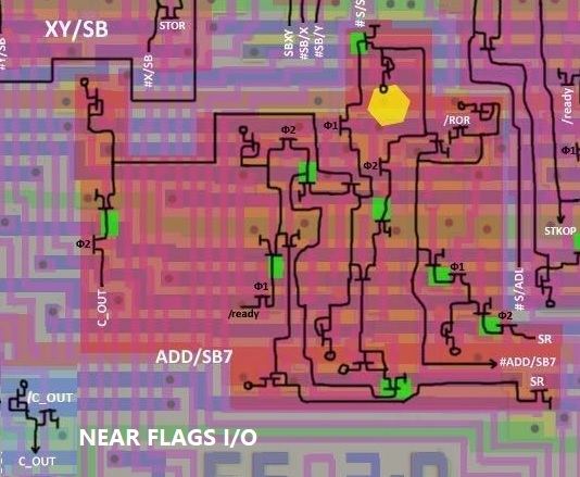

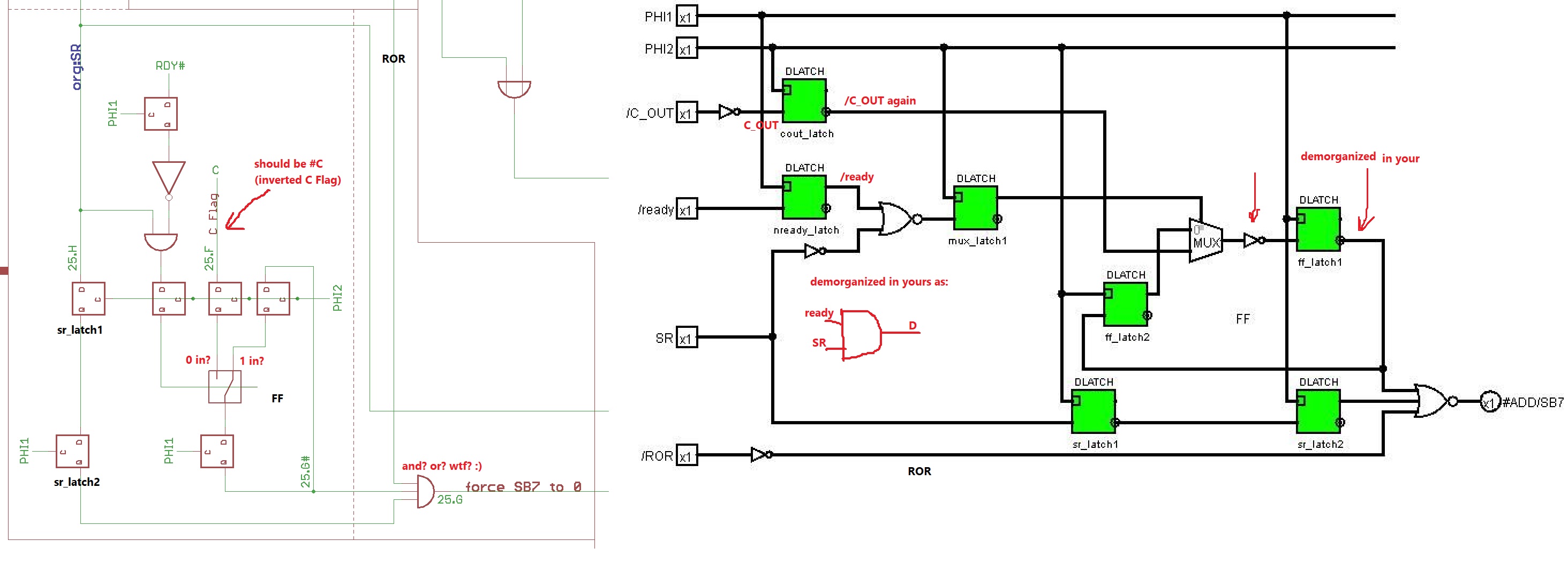

Case_ADDSB7:
It looks like the input value of flag C must be in inverse logic.

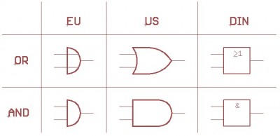

org wrote:
I absolutely do not understand where NOR, NAND, OR and AND are on the schematics. They all look the same to me :)
I'm using logic symbols in EU notation, you are using logic symbols in US notation.
//In the CAD software I'm using, EU notation is default.

Case_ADDSB7:
There is a three_input NOR gate at the output of your circuitry (and in the silicon), generating what I called signal '25.G'.
Output of said NOR gate goes 1 if the three inputs are 0,
means in your circuitry the temporary C flag feeding said NOR gate has to store the C Flag in inverted form.
There is a three_input AND gate at the output of my circuitry, generating signal '25.G'.
Output of said AND gate goes 1 if the three inputs are 1,
means in my circuitry the temporary C flag feeding said AND gate has to store the C Flag in non_inverted form.
Case_ADDSB7: to me, my circuitry looks correct.

Case BRK_T6:
It looks like the inverter for brk6_latch1 is missing.
EDIT: "BRK7" is simply the name of the signal, which was obtained historically in the process of reversing, without any meaningful designations. That is, it does not mean that BRK-sequence in the T7 :)

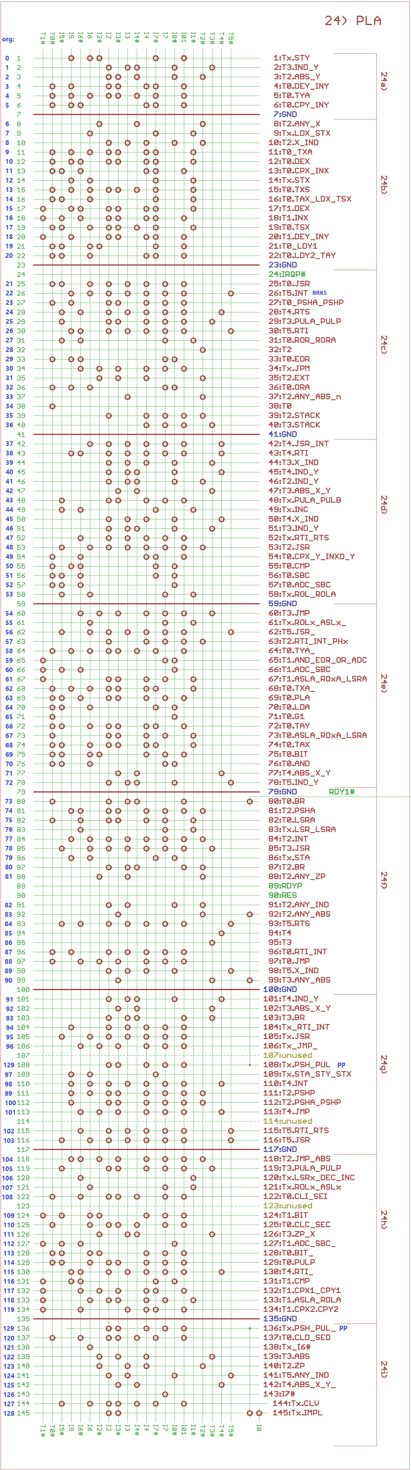

I also attach a mapping of your decoder designations to an adapted version of D.Hanson with 130 decoder outputs, which we also use in our project.
