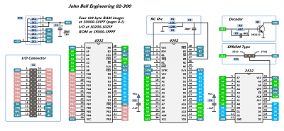

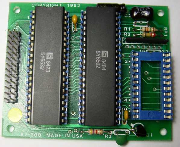

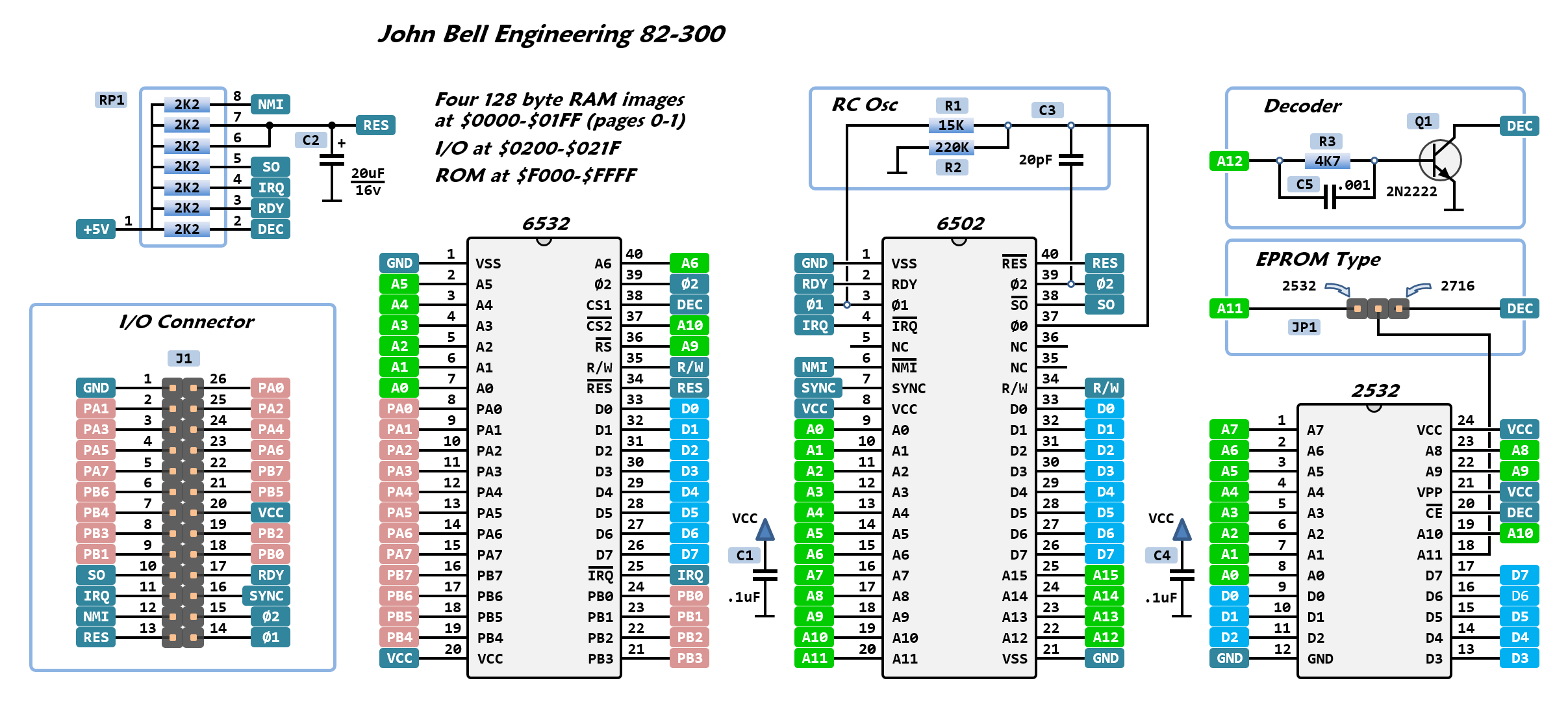

Kinda' reminds me of the John Bell Engineering 82-300 board...
BillO
Posts: 1038
Joined: 12 Dec 2008
Re: Zero glue logic 6502 SBC?
Post by BillO »
That 2N2222 kinda looks like a tiny spot of glue. 3 chips and a transistor ain't bad though.

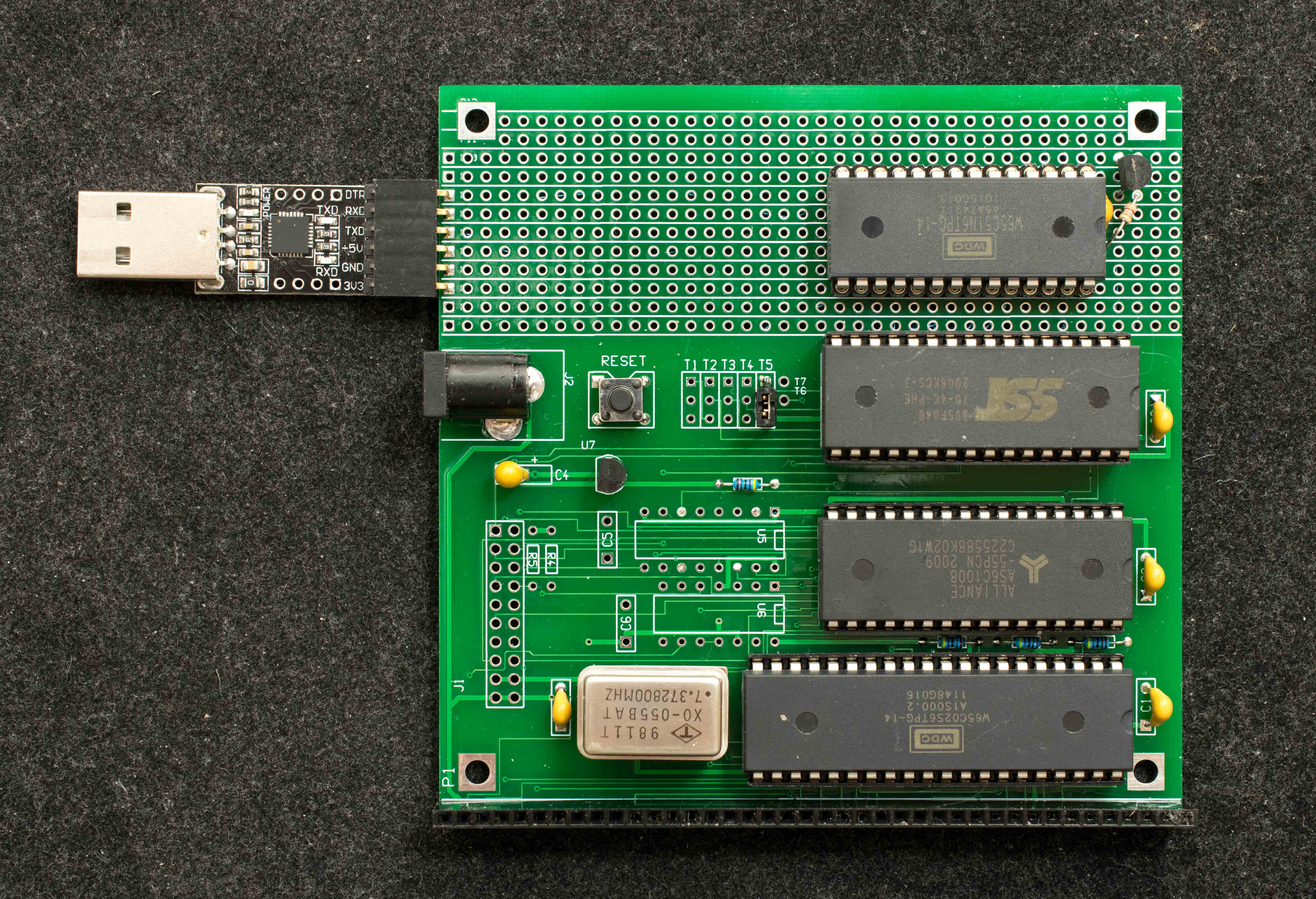

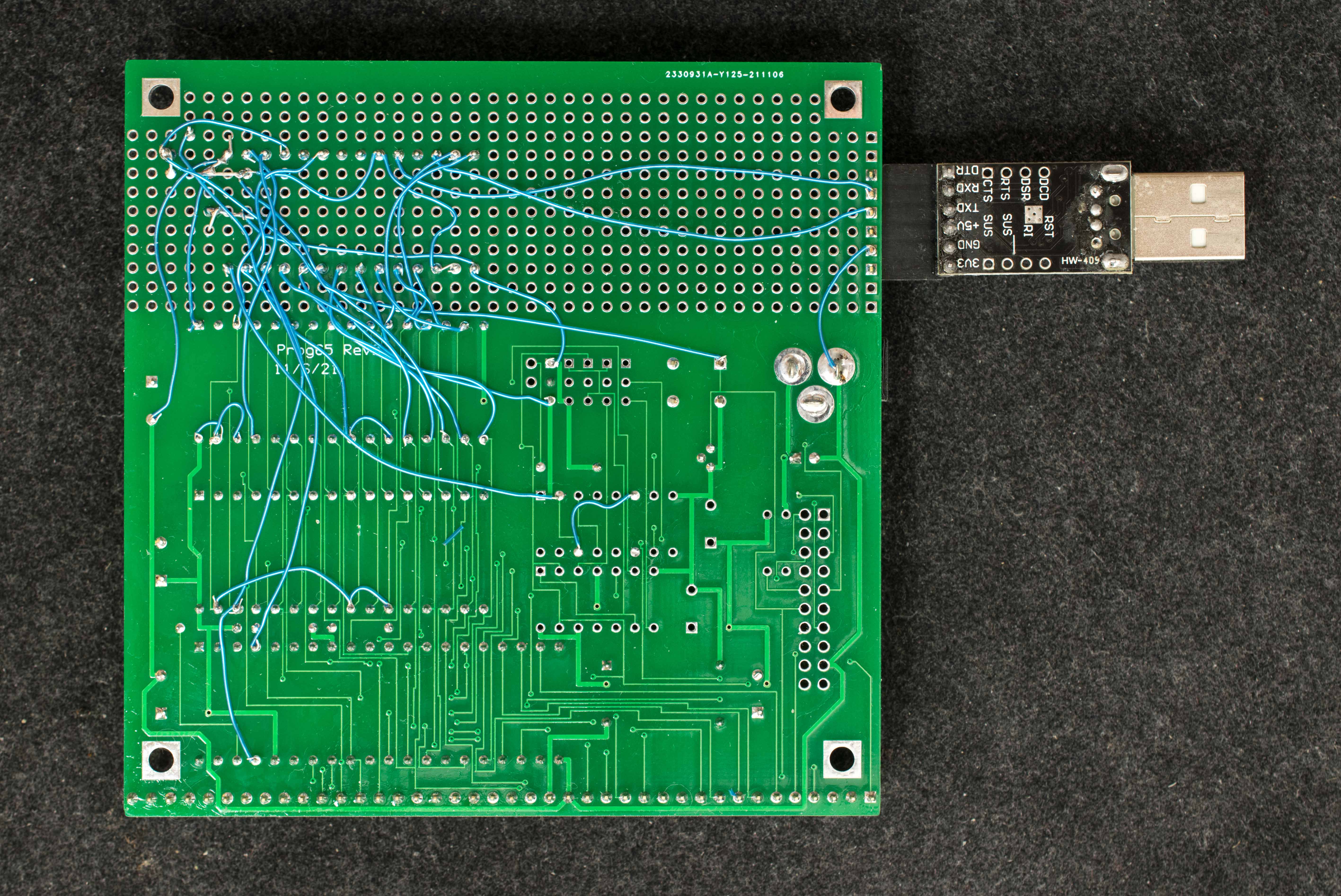

Post by plasmo »
The 6502 ROM-less programmer board turns out to be a good prototype board for other projects. I used it to prototype the zero-glue 6502 SBC by adding a W65C51 and 2nd reset supervisor in the prototype area. The manual wiring is reasonable since most connections between CPU/RAM/ROM are already on the pc board.
I wrote a small boot software that copies a program from EPROM to RAM, spin in RAM until EPROM's chip select is negated by the 2nd reset supervisor (about 350mS), and then write test data out to the serial port. It all works pretty well.
