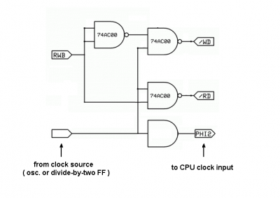

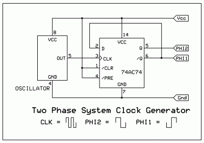

This means it is very necessary to have precisely timed /OE and /WE signals. The CPUs data hold time after write add a little "headroom" so a single gate (a fast one of course) delay would be compensated but not much more.
Knowing this I would recommend to use your clock generator
combined with Dr Jefylls suggestion
(One could use the Phi1 output and the fourth AC00 gate to generate the Phi2.)

PostPosted: Tue Jun 19, 2018 4:32 pm
BillO wrote:
I think your trouble arises from a simple omission -- a design error. You just need to finish implementing the widely used circuit that BDD & I prefer. You've already got half of it -- the part that drives the RAM's /WE pin low only when Phi2 is high and RWB is low. You need to add the part that drives the /OE pin of both memories low only when Phi2 is high and RWB is high.
I had thought of that before Jeff. I had done exactly that, using the inverse of /QW to drive the OE on the RAM and ROM.
The inverse of /QW isn't satisfactory, I'm afraid, or else I'm missing something. During the first half of a write cycle /QW will be high because it's qualified by PHI2 -- isn't that right? So, inverting that, you're putting a low on the /OE -- which leaves us with the scenario I described, or something slightly gnarlier (because /OE does eventually go high, but the damage is already done). What you want is to drive the /OE pins low only when Phi2 is high and RWB is high.
OK ... so you want /QW to be !(phi2 & !RWB) and /QR t be !(Phi2 & RWB) as per the accepted logic. That should be easy to test and I can do it now.
Be right back....
Update:
Ahhh, the sweet feeling of egg on my face. Well, that works just dandy at 14MHz with or without the delay to the CPU (even with a 120ns ROM!!).
Thanks everyone. This has been a good experience.
What is the opinion on the delay to the CPU? The timings look a lot better that way.

If you'd still had trouble then the next step would've been this (or the equivalent):
But it won't be necessary unless the GAL is pretty darn slow. I agree with BDD's remark somewhere upthread. Generally speaking, getting a RAM to work shouldn't require extraordinary measures.
I presume you mean a delay like what's in the diagram above (right?). And I don't have an answer. Looks can be deceiving. What's more credible is an actual test. (Example: max achievable speed. Or, spikiness on the supply rails.) But if there's no demonstrable downside then yeah, go for the nice looking waveforms! :D
