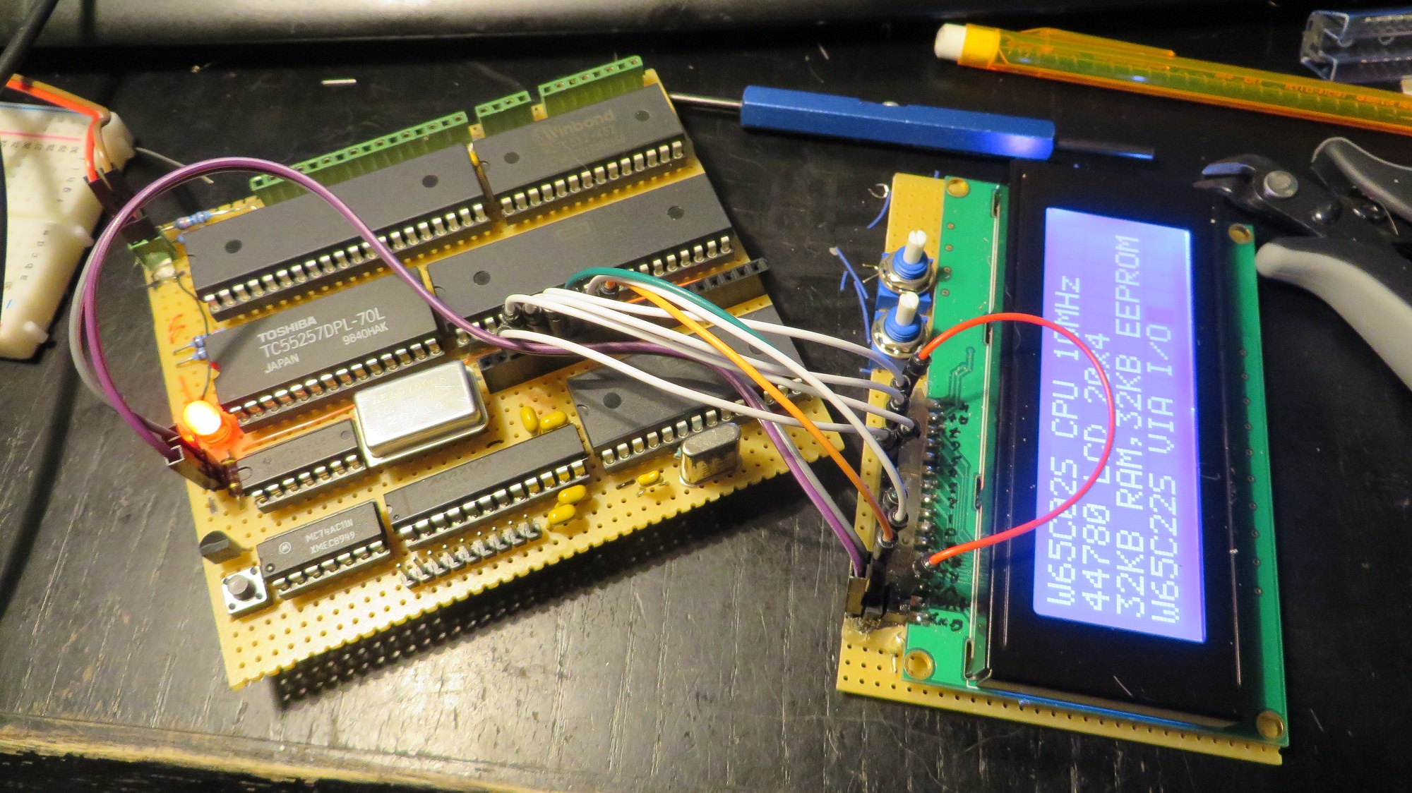

PostPosted: Fri May 29, 2015 7:59 pm
Posts: 740
I've finally gotten around to wiring in the WDC 65C51N and Max238.
I've got to work out how to program it, but I think I'll start off by trying a loop which just keeps sending a character pattern then see if I can pick it up on my PC using PuTTY.
Time to play! :mrgreen:.

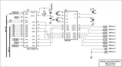

 Post subject: Re: RS232... here goes!
PostPosted: Tue Jun 02, 2015 7:29 pm
Posts: 740
Hi Floobydust
Thanks for the information.
Here's a schematic of how things are wired up. I have the 65C51 mapped to $4020:
The modem cable is a straight through DB9 one and I have it connected to a serial port on my PC and have set PuTTY up to listen on it it (COM3).
PuTTY & COM3 works with the RS232C to RS423 cable I use for xfering info from my PC to my BBC Micro B+ at 9600 baud - so the port seems ok.
I've set PuTTY up to run at 150 baud, 8 data bits, 1 stop bit, no parity, no flow control.

Are you saying you aren't getting anything? It sounds like you don't have an oscilloscope, but there are things you can try with a cheap piezoelectric beeper element like I show at http://wilsonminesco.com/6502primer/debug.html . Put one from the RxC pin to ground. You should be able to hear the baud rate generator. Then put it from TxD to ground. You should be able to hear the characters coming out. Same for pin 3 of the DB9. If you do hear it and the PC isn't picking up the character, you might have a mismatch in bit rate, use of parity, etc..
PostPosted: Tue Jun 02, 2015 8:27 pm
Posts: 740
I am using a 'scope, but the signals were solid.
BTW do I need to use a null modem cable? Mine is straight through...
[edit] just retested with with Floobydusts code and I'm still seeing:
Pin 1 (DCD) : -10v
Pin 2 (RXD) : -10v
Pin 3 (TXD) : -10v
Pin 4 (DTR) : +10v
Pin 5 (0V) : 0v
Pin 6 (DSR) : 0v
Pin 7 (RTS) : +10v
Pin 8 (CTS): 0v
Pin 9 (Ring) : 0v
[edit] Just found a wiring issue. Fixing that now and will retest.
PostPosted: Tue Jun 02, 2015 9:16 pm
Posts: 8510
banedon wrote:
Pin 8 (CTS): 0v
The transmitter is disabled if CTS is not true. It needs to be near ground at the '51 and positive voltage at the DB9.
