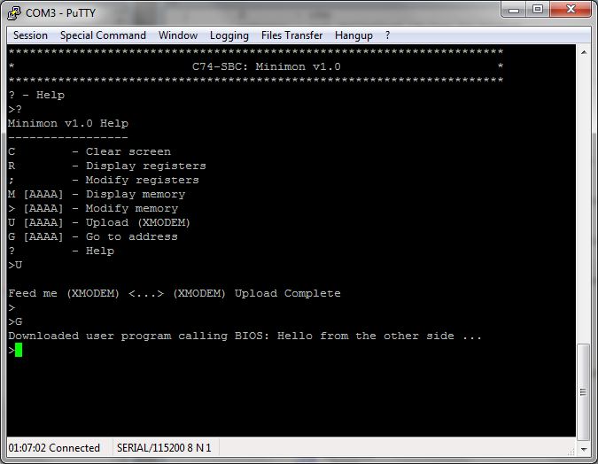

During the momentary period when the address bus is in a state of flux the wrong UART register might be selected, followed by selection of the correct register.
Having had some time to ponder it, I believe you're right. The address lines may indeed stabilize at the same time, but there is no telling what intermediary values might appear on the bus prior to that. For the UART, a read of the MR register is as destructive as a write (in the sense that a change is made to the device) and so it stands to reason we should qualify reads with PHI2 exactly as we do with the writes. Unfortunately, it's not really feasible to patch the current board, so it will have to go on the list of board revisions. I may in fact order rev 2 of the SBC along with the other CPU boards if I can manage to figure out how to panelize the design. (And thank you for taking the time to look at the SBC schematics BDD!)
Now, having said all that, I have done more testing with the SBC as it is and it seems stable using absolute addressing. I can also duplicate the problem at will by reverting to indexed addressing. Stepping through the code, I can see the UART MR register address $8000 on the bus in the dead cycle prior to the write of the STA $8000,Y operation. Running the test several times to confirm produced the same result. I tried Jeff's suggestion of reducing the base address by one and incrementing the index (STA $7FFF, Y with Y=1) and the problem went away, exactly as expected. Finally, I tried also indirect addressing, both with and without a page crossing, and did NOT see any partial addresses on the bus with either of these operations. So far as I can tell, the issue only arises with absolute indexed addressing.
My hypothesis is that momentary values on the address bus are not in fact the culprit in this case, but rather that it is a partial address generated during the dead cycle, despite what the datasheet says. Still, I may be botching up the tests and reading the bus values incorrectly, so I don't think I can know definitvely until I make the required mod to qualify reads on the SBC and see if the problem with indexed addressing persists. In the meantime, I'm happy to report the SBC is performing well despite these uncertainties and XMODEM file transfers are now working. Here is a pic of a program that has been uploaded from my PC to the SBC making a BIOS call to print some text on the screen (in the example shown, the Minimon commands "U" and "G" default to address $0400, which is the start of USER RAM on the SBC) ...

Now, having said all that, I have done more testing with the SBC as it is and it seems stable using absolute addressing...So far as I can tell, the issue only arises with absolute indexed addressing.
Interesting. It seems as though the behavior is similar to what I was encountering with POC V1.0 before I patched it to qualify addresses with VDA and VPA. It has to make you wonder how "safe" <addr>,X and <addr>,Y addressing is with read-sensitive hardware.
My hypothesis is that momentary values on the address bus are not in fact the culprit in this case, but rather that it is a partial address generated during the dead cycle, despite what the datasheet says. Still, I may be botching up the tests and reading the bus values incorrectly, so I don't think I can know definitvely until I make the required mod to qualify writes on the SBC and see if the problem with indexed addressing persists.
You mean qualify reads, eh?
The ability to successfully complete a data transfer is telling, in that it indicates you have a clean-running serial connection. How fast are you running the connection?
I'm almost sure that's the issue here, although I do agree that the unqualified /OE signal is also a problem. I'll be making the correction on the Rev2 board.
Yes, thanks. I'll edit the post to clear it up.
115.2K Baud rate and 16MHz system clock with wait-states enabled. The wait-state logic fails after that. I'm going to see if I can fix it for rev2 also. I sure would like the UART to work when the machine is clocked at 20MHz! Not sure if that's possible in the current design. We'll see.
Beyond that, I'd love to pause here and have some fun writing software but I best press on. I do want to have the CPU built during my lifetime! :)

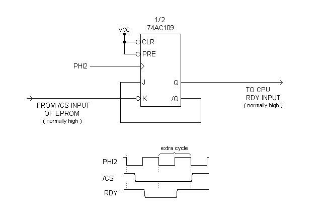

I was thinking about using RDY to implement the wait-state circuit for Rev 2 of the SBC. Since I have Rev 1 to use for debugging the TTL CPU, Rev 2 can dispense with a lot of complexities and just focus on speed - no need for single-cycle or step clocks. That should make for a faster wait circuit to handle a 20MHz clock.
Clocking a "divide by two" flip-flop wth PHI2 seems to be enough to generate the right timing for RDY. But for touchy peripheral ICs, it seems /WE and /OE must also be kept low throughout the wait-cycle even as PHI2 rises and falls. Otherwise, the peripheral will "see" two short read/write operations rather than one long one. It seems that if /OE and /WR are left qualified only by PHI2, either the minimum pulse width requirements would be violated or spurious reads and writes would be made. Either way, the wait-state would fail.
I'm thinking the solution is to derive /OE and /WE from PHI2', where PHI2' = (PHI2 OR /RDY). That should keep the read and write enable signals low for the extra cycle and give peripherals enough time to respond.
Do I have this right?
PostPosted: Mon Jul 31, 2017 3:42 am
Posts: 8507
Almost.
RDY is it is a bi-directional signal. If the MPU executes a WAI instruction it will also pull RDY low until the interrupt comes. Hence your logic has to know whether RDY is low because of a wait-state or because of a WAI instruction.
Hey, wait a minute! Recently you said you were resisting the urge to develop new software because it would distract you from the main project -- the TTL 6502. But now you're getting distracted with new hardware!? :wink:
I like the PHI2' idea but I'd generate it differently. If I understand correctly your method gives OE and WE pulses which endure for 1.5 cycles -- they begin very soon during the 2-cycle period devoted to the access. It'd be better to increase the address setup time seen by the peripheral by having the OE and WE pulses endure for only half of the 2-cycle period.
Posted below are the original wait-state circuit discussed elsewhere and a revised version with added logic to generate PHI2'. Extra sets of eyes welcome -- I'm up past my bedtime!
Darn! -- I overlooked that. But after blinking my eyes for a while I concluded you must be getting sleepy, too, BDD. The logic we're talking about is in charge of generating OE and WE for the slow peripheral. And WAI doesn't address the slow peripheral. WAI's bus activity only involves code memory.
However, you're right about RDY being bidirectional, which means a resistor as shown may be desirable to limit current flow. Details of this are hashed over in the post I linked to. :)

I'd recommend putting a 22pF capacitor across that resistor to get rid of that pole that would otherwise cause some delay.

Yeah, definitely worth mentioning, Dwight -- that approach may require less logic than using RDY. There are downsides as well as upsides. Suspending the entire system distorts the timekeeping of devices which use PHI2 as a timebase, such as the timers in a 6522 VIA. But of course not all systems include such devices.
Another consideration: using RDY means the extra access time can only be an integer number of cycles. So if you needed 1.5 extra cycles, for example, you'd be forced to round that up to 2 cycles. By contrast, if you suspend the entire system you can do whatever you want. And here's another example where a fractional delay would've been desirable.
The circuit I posted allows, after the bus is stable, extra time before the peripheral's OE and WE go true, and it allows extra time for the actual period during which they are true. But I'd be happier if it also allowed extra time after OE and WE go false. Dunno if Drass's UART requires this extra time, but other vintage chips might (you need to consult the datasheet). Regarding OE it's plausible that the vintage peripheral won't let go of the data bus promptly when OE goes false. If the delay is large enough there'll be bus contention during the cycle *following* the peripheral access. And -- more critically -- the peripheral has a minimum spec regarding how long the data bus and the address bus must remain valid after WE goes false.
I didn't address this issue of delay after WE and WE go false. With many chips it won't matter, and finding out for certain requires some datasheet diving. Otherwise, seat-of-the-pants rules! :) If there's any issue then probably a fractional-cycle delay would be perfect. Just stick in an extra half-cycle after OE and WE go false. Of course an entire extra cycle would do the trick, but that's more of a performance hit.
