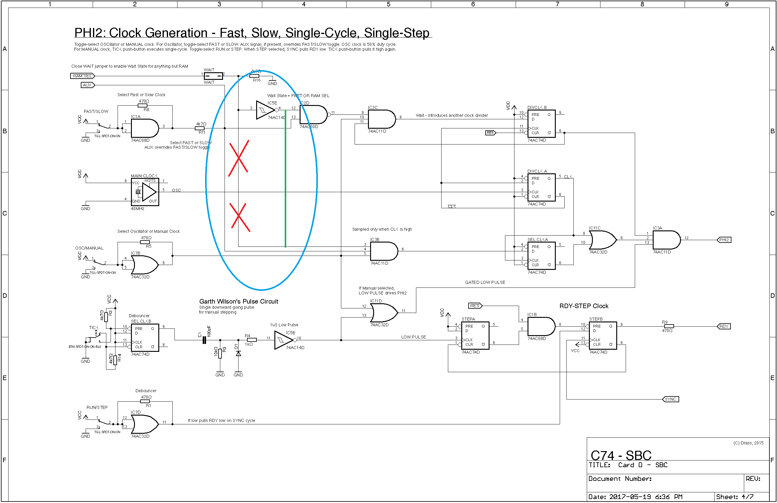

Yes, the blinkenlights were definitely a magic moment. And thank you Dieter for reviewing the CPU schematics once again. It will be a bit still before I move on to the CPU itself. I still have some issues to track down here. For instance:

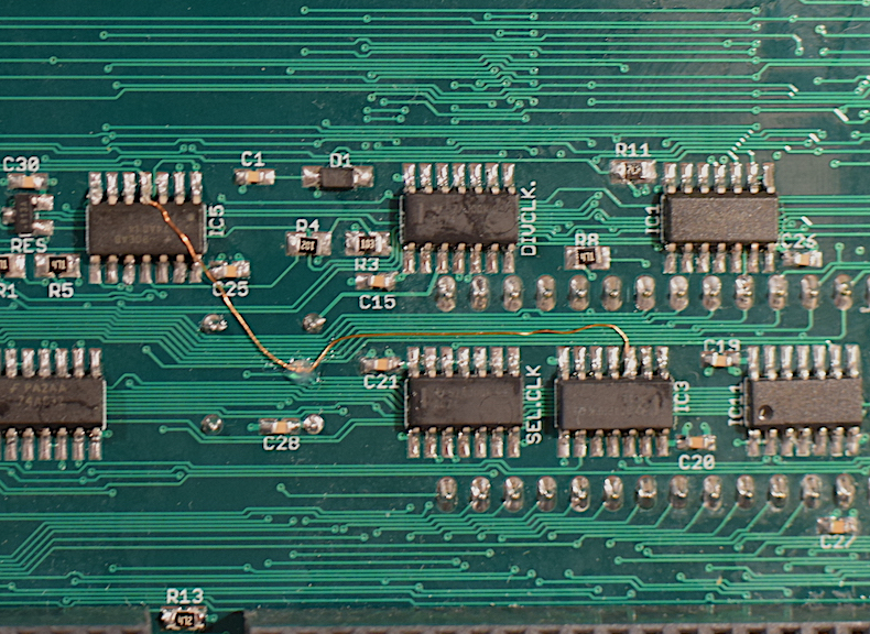

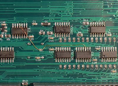

1) After running the SBC a little longer, I began to see the data bus change - not good. Probing around, I saw that the Chip Select for the ROM was not behaving and some reads were therefore happening on a floating bus. A quick look at the address decoder confirmed the issue: the 816BNKH signal from the absent K24 Card was intermittent. Re-soldering the associated pull-up solved the problem, and the data bus is now rock solid while reading.
2) The FAST clock was indeed broken due to a miss-wired inverter. Here is the change needed:
To fix the problem, I had to lift IC3-pin 3 off its pad and jumper it to IC5-pin 4:
I removed solder from the pin with a soldering braid, and gently bent the pin up with tweezers. It was then possible to solder a pre-tinned jumper on to the pin while leaving the pad below isolated. The wire I'm using is from a wiring pencil (something I acquired back when I thought this was going to be a through-hole protoboard build). The wire is insulated but makes a nice connection when soldered - perfect for a jumper! I then just soldered to the other pin and tacked the wire down to tidy things up.
And now it works perfectly! :) I'm able to switch from the SLOW clock to the FAST and then to MANUAL mode. I need more testing to validate that no runt cycles are generated in the process, but it's certainly coming along. Incidentally, MANUAL mode has proved valuable already, which is not something I had expected quite so soon. Nice bonus.
I'm not at all discouraged ... quite the contrary, I'm finding the debugging (and the patching!) to be very interesting and fun - and it seems required training for the next-level challenge ahead!

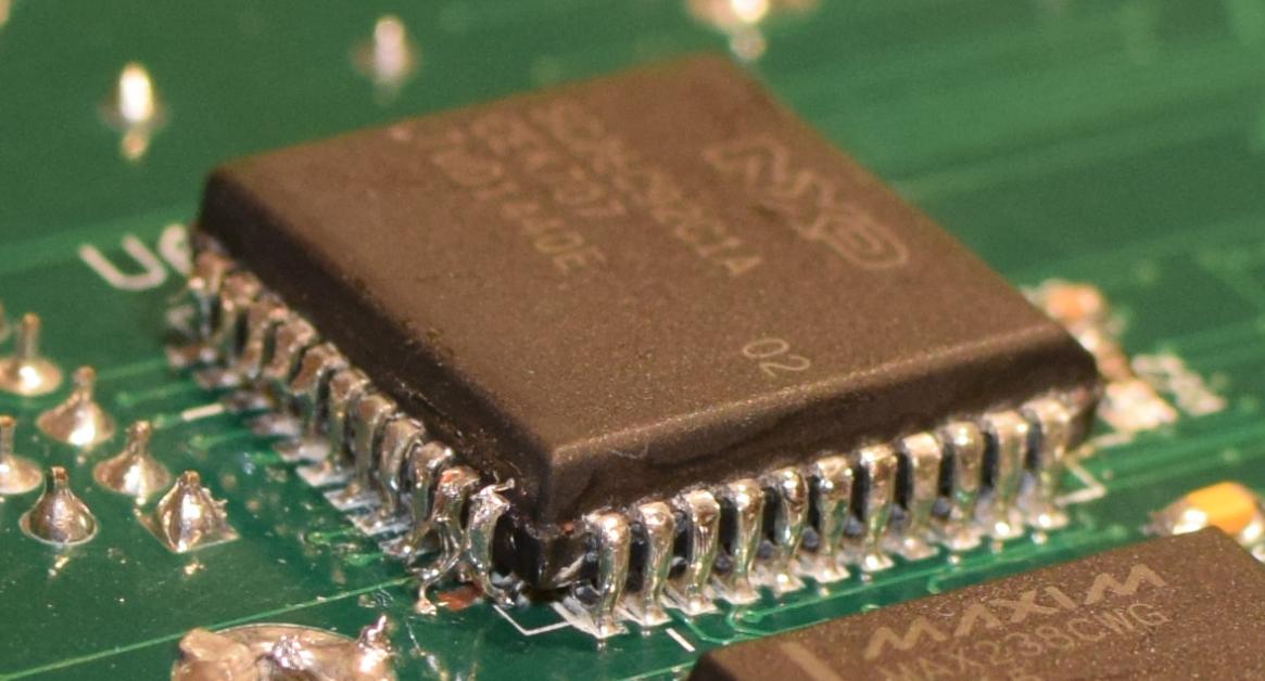

The Good: I set up a quick test to exercise the VIA, and SUCCESS! :D Writing a fixed value to the ports produced the correct results on the I/O headers, and connecting the two ports together confirmed that a value written into one could be read from the other. I also set up the shortest possible IRQ service routine to increment an I/O port register on rollover of the T1 16-bit timer. I gotta say, it was pretty rewarding to see the port pins blinking at different rates! In passing, I could verify that the FAST and SLOW clocks correctly speed up and slow down the blink rate, and, so far at least, no glitches switching clock rates on the fly - even with a regular IRQ in the mix. I can't confirm the frequency of the signals, but at least I can see things get faster and slower! It seems the wait-state logic is also slowing things down for ROM and I/O operations correctly, but with no RAM installed, I can't be sure it's all working quite yet.
Now The Bad: I'm having one heck of a time soldering the J-Lead components :evil: (RAM & UART). My suspicion is I need a smaller tip on the iron. I just can't get in close enough to heat the pads, and all I manage to do is bridge the pins with barely any solder making it to the pads. The result is a right mess. Unfortunately, I've had to take a heat gun to the poor RAM chip to pry it loose after a couple of botched attempts (gotta wonder whether the IC is damaged by now, ugh!) I'm using a pretty beefy chisel tip I purchased for through-hole soldering, so ... definitely time to sort that out now. With the successful test on the VIA, I have to believe the RAM should work without too much trouble - if only I could get it soldered in place! :roll:

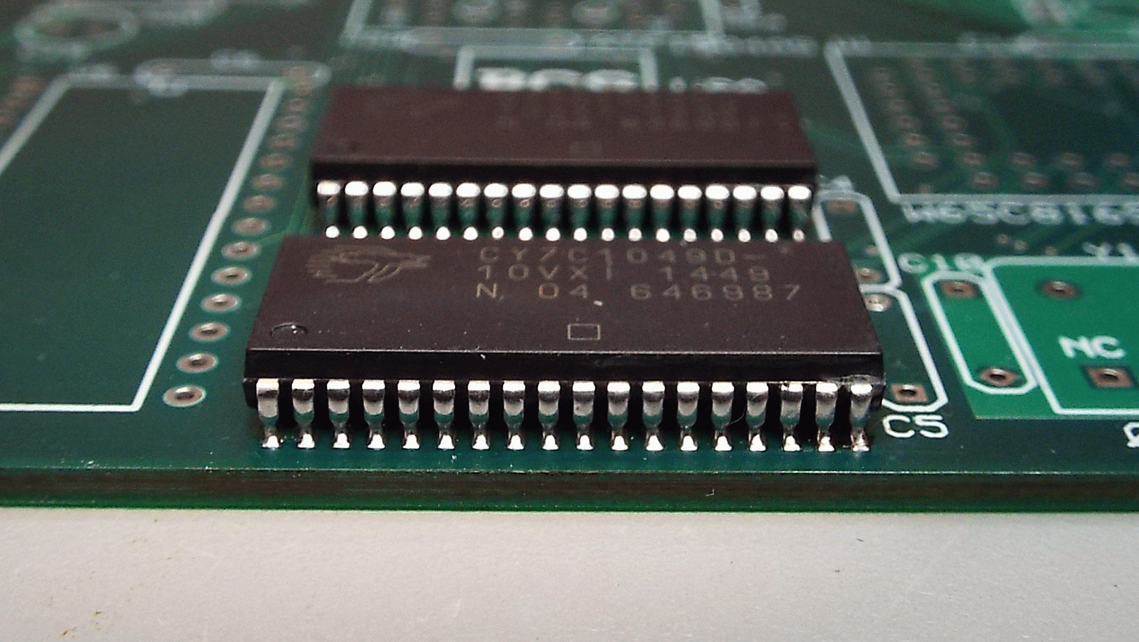

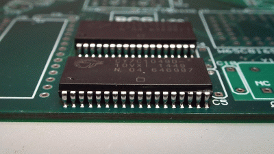

The chance that you've damaged the IC with heat is just about zero. With the heat gun, you're probably more likely to damage the board than the IC. In a job I worked in 1984-85, I sometimes used an infrared microscope to thermal scan power transistors' uncovered dice (ie, the actual chips) operating under extreme loads, and I've seen them actually operating (not just in storage or in soldering, but operating) at over 350°C. I don't know how far over, because I wasn't allowed to get calibration data up that high. Granted, they would not have lasted long, but it didn't cause catastrophic failure.
Soldering the SOJ's is easy; but first you might have to forget all the conventional "wisdom" about soldering. I describe how to do the soldering with no special equipment, at viewtopic.php?p=48875#p48875 . That's how I soldered the SRAMs on the module you bought. I use a 1/8" chisel tip on the iron. BDD posted a close-up photo of another SRAM done this way. Maybe someday I'll be advanced enough to make a video.
Posts: 9425
Re: TTL 6502 Here I come
There are a couple of ways to go about it. Both Garth and I (when I was able to see well enough) use a drag technique that doesn't try to avoid bridges. You can clean them up afterward—I used desoldering braid, Garth does it with heat and gravity.
The soldering iron tip shouldn't be very large (I used a 3/32" tip, which is actually a 1/8" tip I ground down slightly) and you want it good and hot so it will maintain temperature while in contact with the pins. I applied some liquid flux to the pads prior to placing the part, but that isn't essential—it mostly helps to keep the part from moving around. I also clamp the PCB down to the bench so it's not wiggling around and making things difficult. Just keep the tip clean and well tinned as you work so you get good wetting and flow.
Here's the close-up picture to which Garth is referring.
J-Lead SRAM
J-Lead SRAM

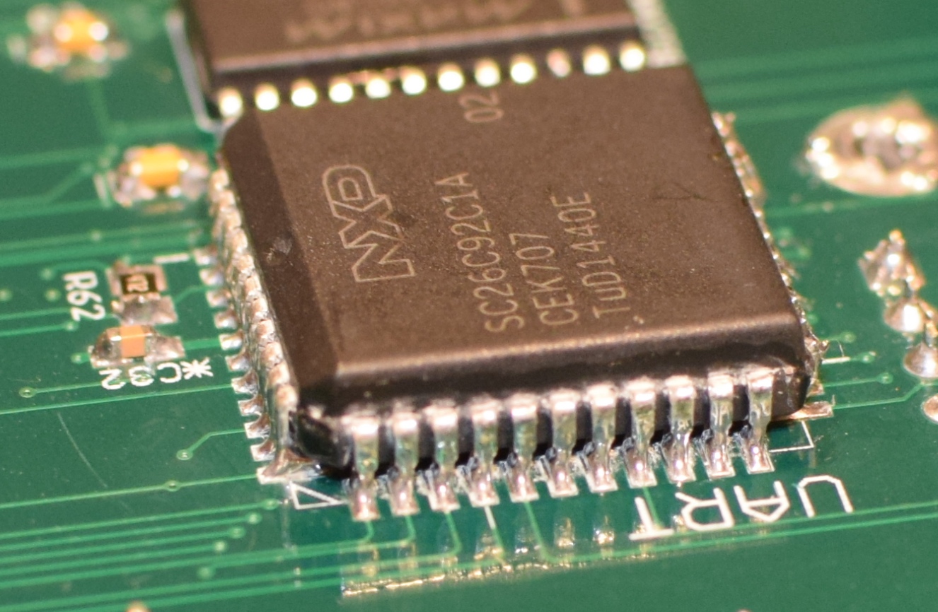

I re-read your instructions Garth, and made several attempts, but somehow it didn't work out. I can't seem to get reliable wetting of the pads with the bigger tip not matter how much solder I apply. :(
My local electronics store had only a 1/16" tip, which seemed close enough, so I thought I would pick it up and try it. I wondered whether there would be enough thermal mass there to transfer heat from the iron, but it seemed to be fine. I had no trouble heating the pads with it, and managed to get the solder to flow nicely. Dragging worked very well with some flux added, and hardly any bridges were created. I found I could just reflow any one pad to tidy things up most of the time. A braid was only required once or twice. In the end, I was quite pleased with the result:
Yup, exactly what I did. Wouldn't you know it ... I tore out a corner pad on the UART footprint when trying to remove the IC off the board after a failed attempt. I also lifted a second pad right next to the first but found it was still attached to the trace, barely. Yikes! It looked very nasty and I was a little despondent thinking the board might be ruined. But I decided to try a rescue mission instead ...
Some googling revealed a video on PCB repair, which seemed promising. I soldered the UART in place despite the damaged pads, and then used an sharp blade to scrape off the solder mask from a via next to the corner pin. I then ran a jumper to connect the pin directly to the via. The lifted pad was also a problem, so a jumper was required there as well. The missing corner pad is just visible (as a brown spot next to the pin) in the pic below, as is the jumper going from the pin to the via right next to it. The jumper on the second pin is harder to see, but I'm happy to report that both connections are solid and seem to have no shorts. :shock:
And that's the last of the components on the SBC in place now. Happily the RAM seems to work properly (the IC was not in fact damaged, just as Garth had predicted). The next step is to get the UART working (I'll be referring to BDD's several helpful posts on the subject for that) and perhaps write a little basic monitor - the objective being merely to enable the SBC as a test harness for the TTL CPU. Looking forward to that!

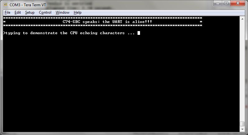

There's not much there in terms of software at this stage, and the whole thing seemed a bit flaky for some reason. But as usual, I'm just amazed at how many things had to go right in order to get even this simple test going. I ran the serial ports at 1200 Baud just to make sure the hardware flow control is working, and it certainly appears to be. I managed also to get the UART's internal timer to trigger a regular 60Hz IRQ. As luck would have it, the UART's independent clock means that the frequency of the IRQ is constant and immune to the wait states afflicting PHI2 on this SBC. Currently, the IRQ simply increments one of the VIA output ports just so I can see the pins blinking correctly.

After tinkering with the thing this weekend - yowza! Got something going ...
"Houston, we have lift-off."
You've leaped a major hurdle by getting your machine to scribble on the screen. As you noted, seeing that display tells you you've got functional hardware and a lot of the things that could go wrong didn't.
