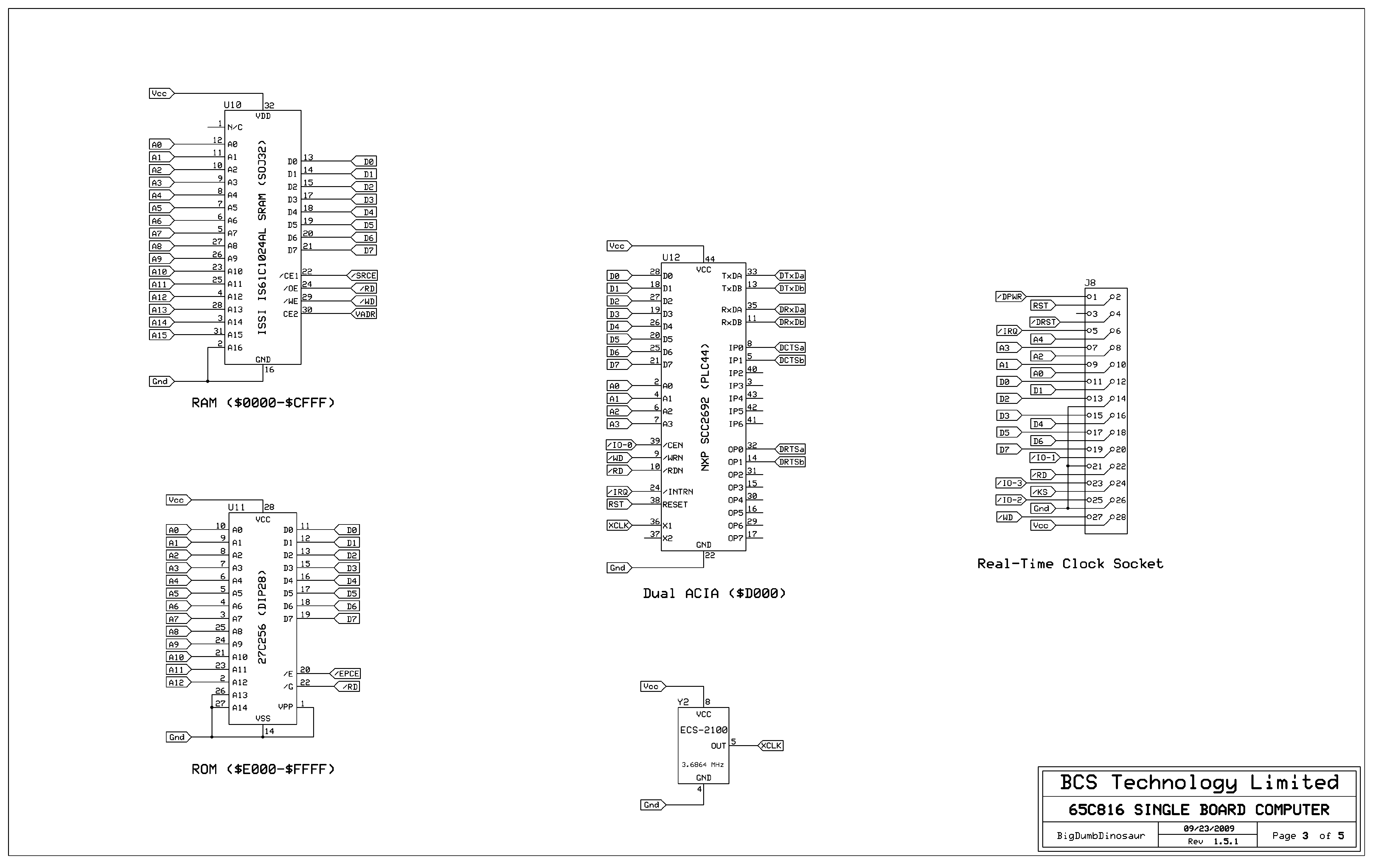

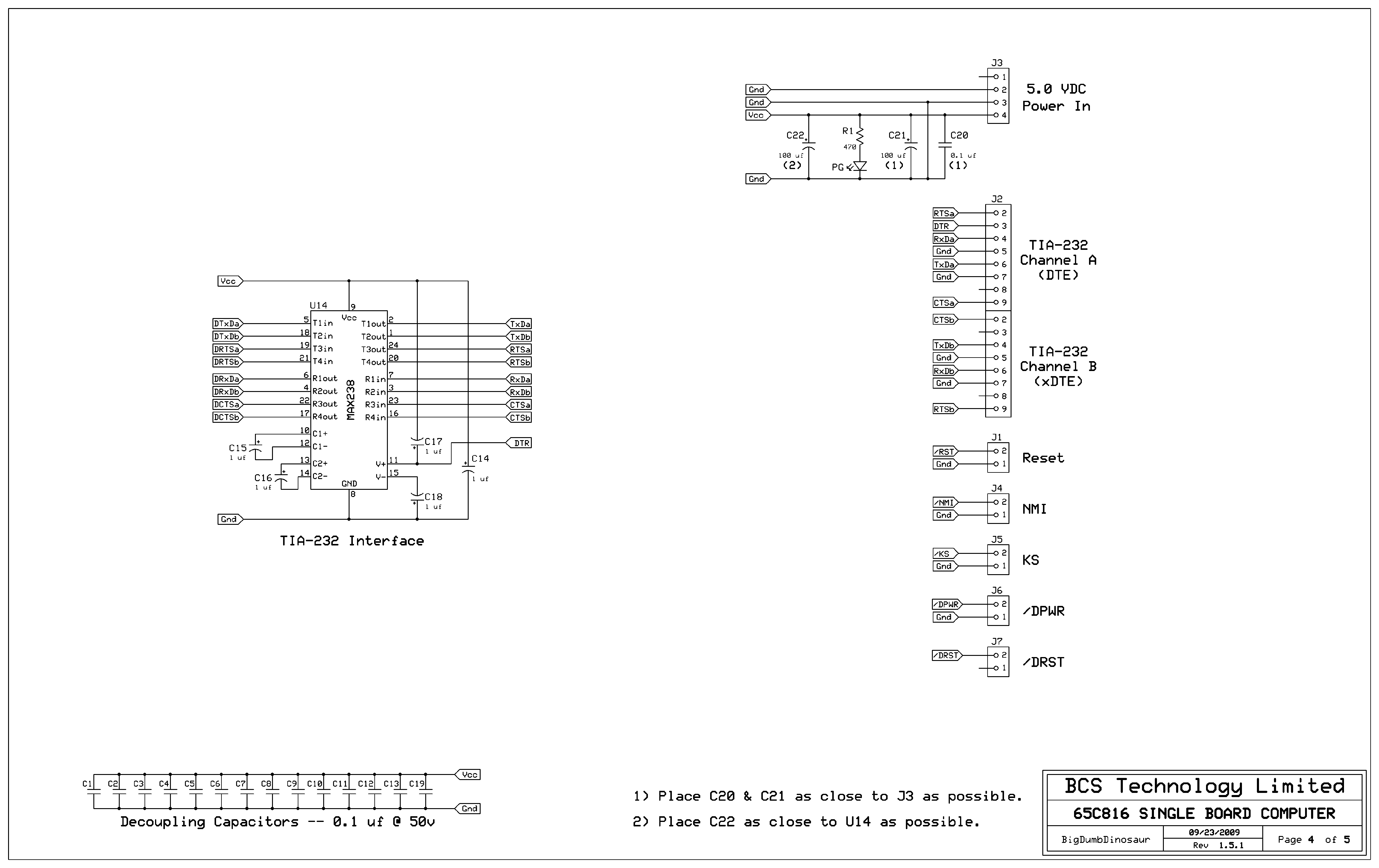

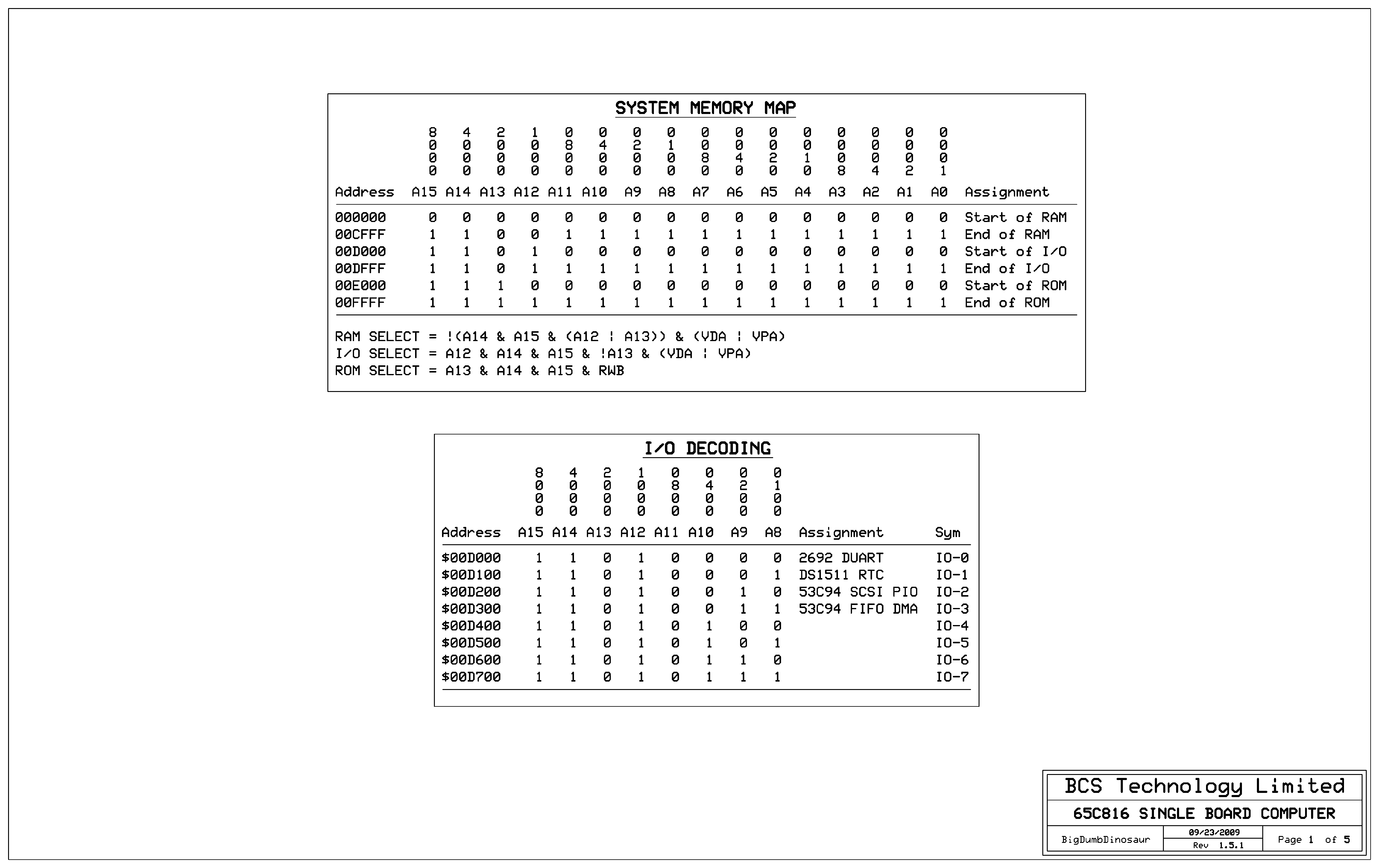

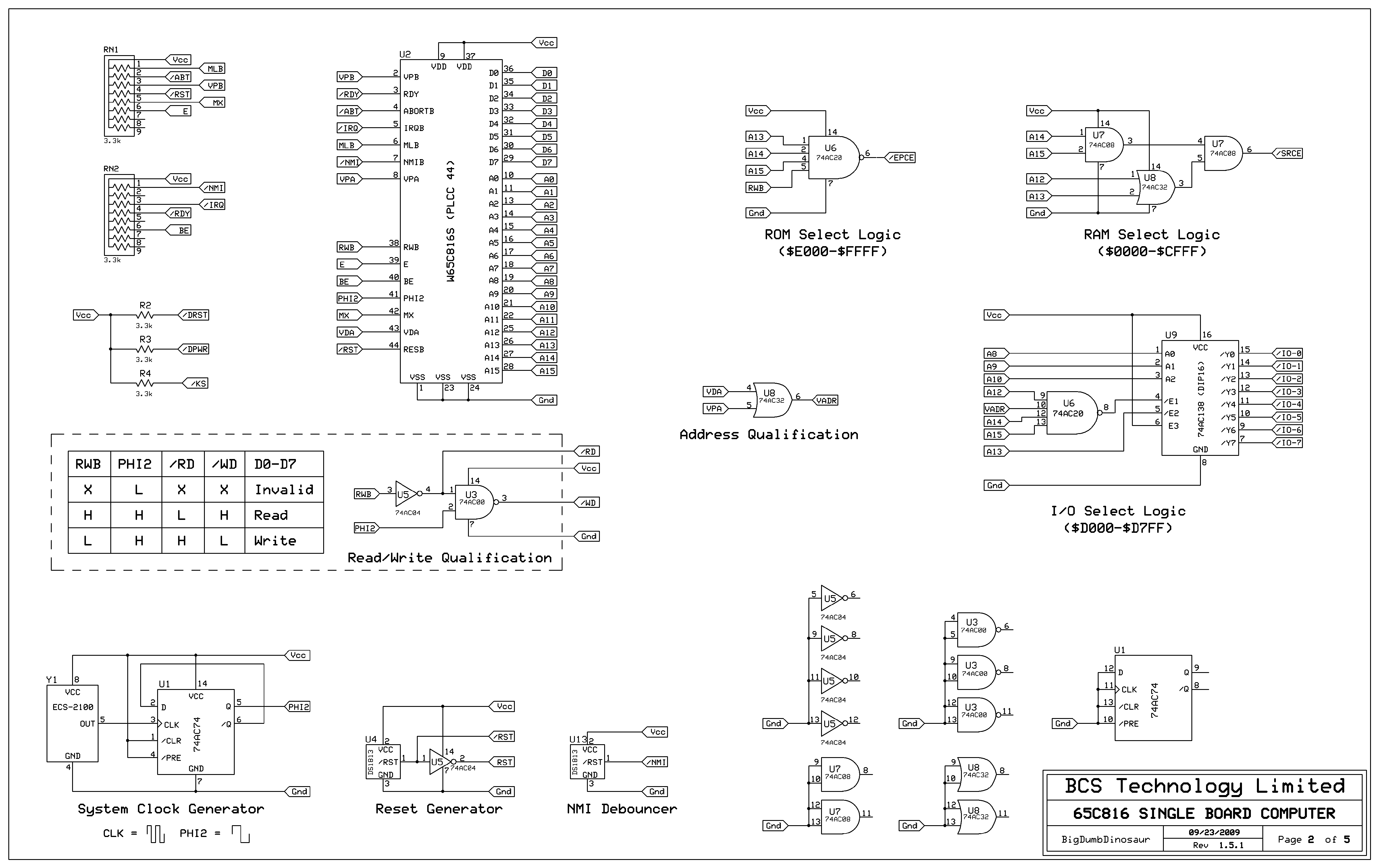

Here are the schematics and printed circuit board layout for the POC upgrade.
File comment: POC schematic, page 1, memory map
File comment: POC schematic, page 2, MPU interface
File comment: POC schematic, page 3, RAM, ROM & I/O
File comment: POC schematic, page 4, external interface
File comment: POC printed circuit board layout

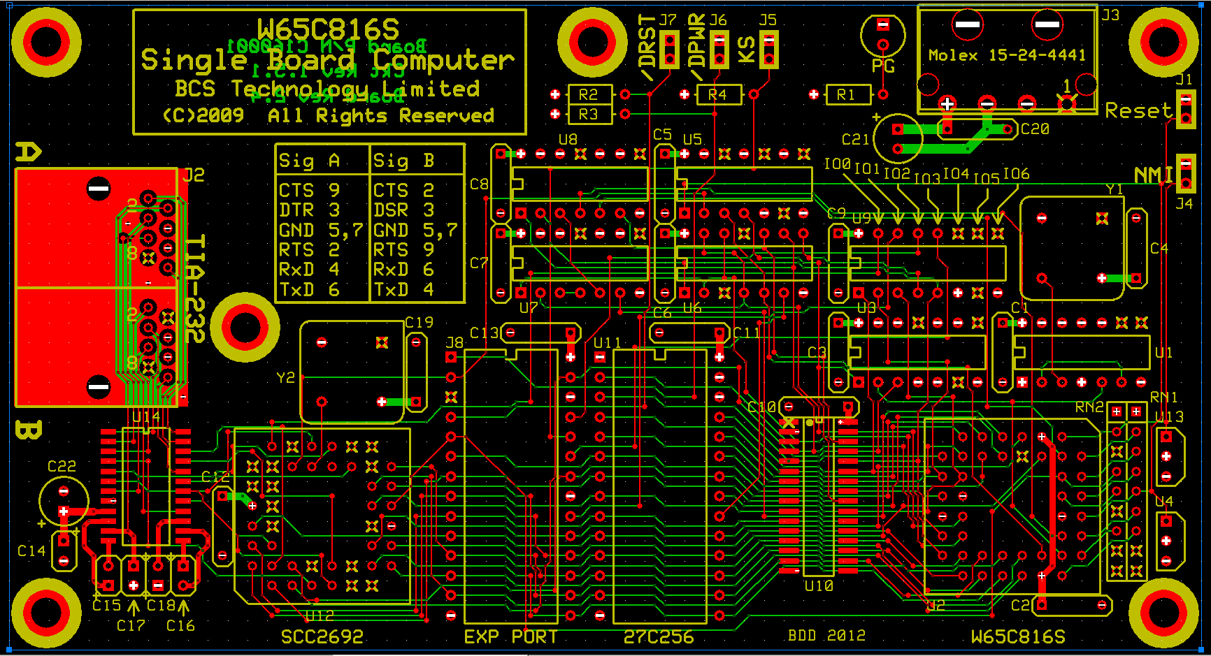

A significant change is that the watchdog timer socket (J8 on page 3, which is now designated as the "expansion port" on the printed circuit board layout) is wired so the SCSI host adapter can plug into it, or the watchdog can be plugged in and the POC run without the host adapter. I also connected the IO-3 output ($D300-$D3FF) from the 74AC138 decoder to an unused pin on J8, which allows me to access the 53C94's FIFO through the DMA port. FIFO DMA access, even without the benefit of a real DMA controller, substantially improves performance and was a goal from the onset when I designed the host adapter.
Other changes include more stringent address qualification using the MPU's VDA and VPA outputs, and an experimental NMI debouncing circuit using a Dallas 1813 reset generator. I have the BIOS arranged so an NMI breaks the currently running program and enters the M/L monitor via its BRK entry point, giving me a way to regain control if a program error puts the MPU into an endless loop. A push button on the NMI input will ground NMI and the DS1813 will release NMI about 250 milliseconds later to debounce the circuit. That's the theory anyhow. :lol:
On the PCB, all patches have been incorporated into the new layout and the PDIP24 version of the MAX238 transceiver has been replaced with the SOIC-24 version (bottom left corner of the layout). I did this to allow me to shift the position of the TIA-232 dual jack assembly to get it away from a couple of protruding pins on the underside of the host adapter. There was a little trace rerouting in areas where some length reduction was possible, and I relocated the /RESET and /NMI inputs to the right hand side of the board for easier access. Board dimensions remain at 6 inches by 3.25 inches. Boards will be made using Express PCB's four-layer Proto-Pro service.
Edit: Replaced schematic page 2. Previous version had a typo in the read/write qualification truth table.

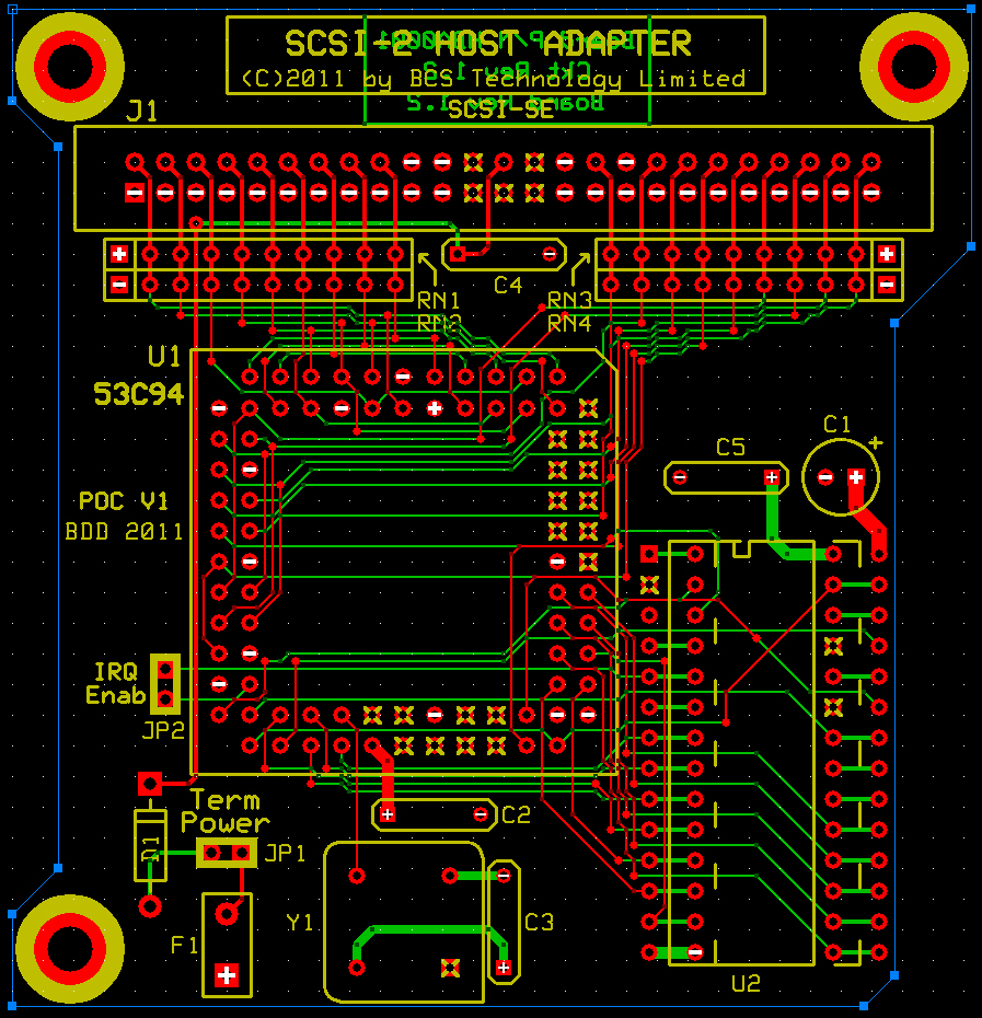

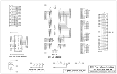

Here also are the schematic and printed circuit board layout for the SCSI host adapter (HBA). The HBA piggy-backs on the POC and plugs in to socket J8, and the Dallas watchdog timer plugs into U2 on the HBA. This PCB version incorporates the patches I made to extend the /DACK input of the 53C94 to the POC for DMA port access.
File comment: SCSI host adapter schematic
File comment: SCSI host adapter printed circuit board layout
Last edited by BigDumbDinosaur on Sat May 26, 2012 4:41 am, edited 1 time in total.

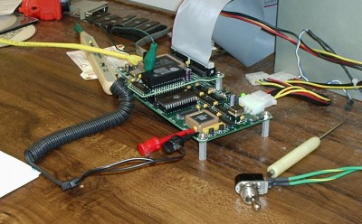

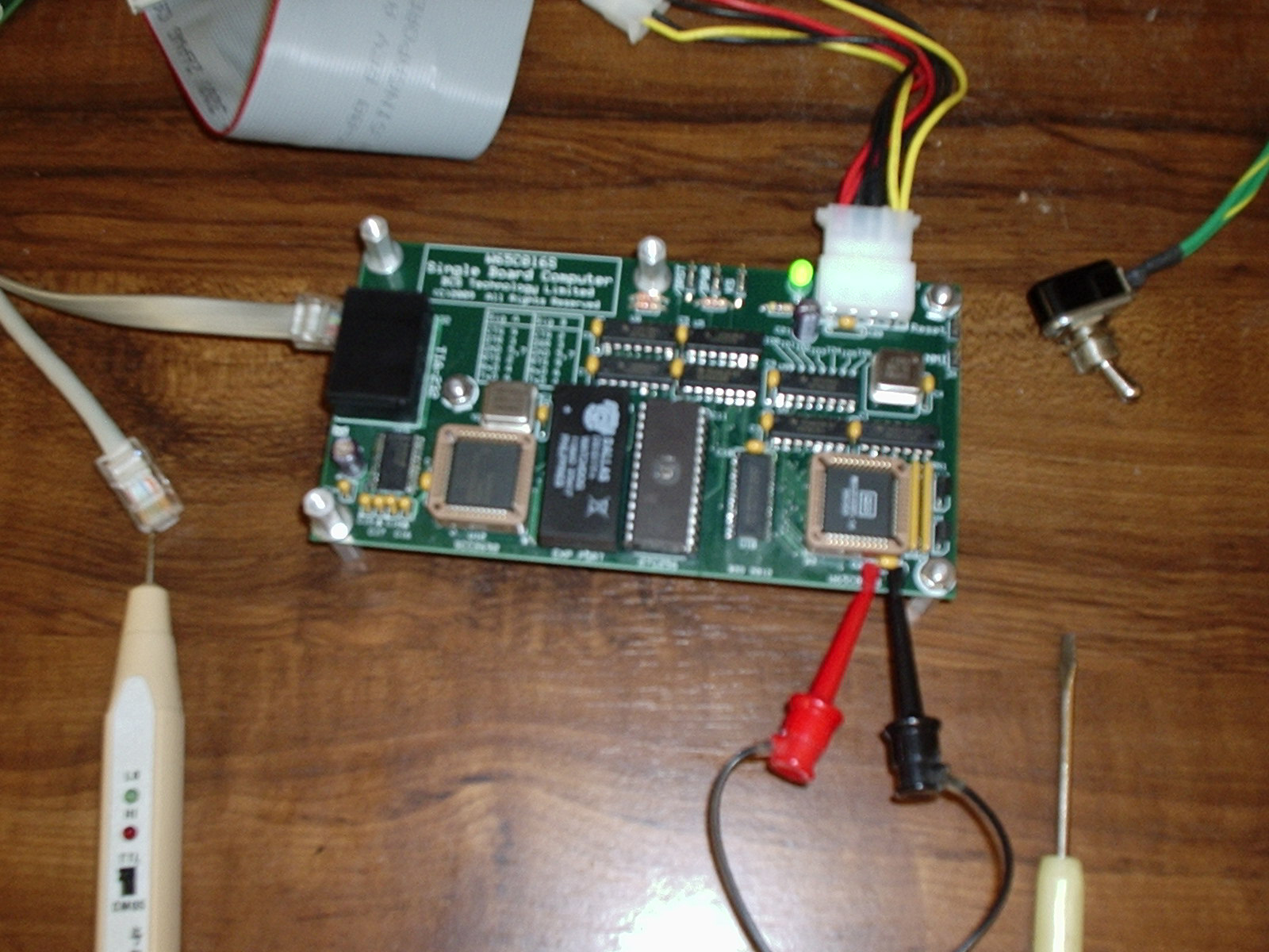

POC V1.1 has been built and fired up on the first try. It is running in a stable fashion on a 12.5 MHz Ø2 clock.
File comment: New POC Test Setup
Other changes include...an experimental NMI debouncing circuit using a Dallas 1813 reset generator...A push button on the NMI input will ground NMI and the DS1813 will release NMI about 250 milliseconds later to debounce the circuit. That's the theory anyhow. :lol:
The theory works!
I actually used a small screw driver to short the NMI header pins, since I haven't rigged up a push button as yet. Despite that crude method of grounding NMI, it worked and halted a running loop I had started. The theory is based on the fact that when the I/O pin on the DS1813 is grounded it will take about 250 milliseconds to go high again. I tied NMI to the 1813's I/O pin, so when I short NMI to ground it stays down for 250 msecs, effectively debouncing the circuit. Since NMI is edge sensitive, the duration of the low state is unimportant—repeated NMIs won't occur. Who needs a Schmidt trigger? :D The NMI causes a response like hitting a BRK instruction: the M/L monitor is started and the registers are dumped. The interrupted program can be restarted without any problem.
I also connected the IO-3 output ($00D300-$00D3FF) from the 74AC138 decoder to an unused pin on J8, which allows me to access the 53C94's FIFO through the DMA port. FIFO DMA access, even without the benefit of a real DMA controller, substantially improves performance and was a goal from the onset when I designed the host adapter.

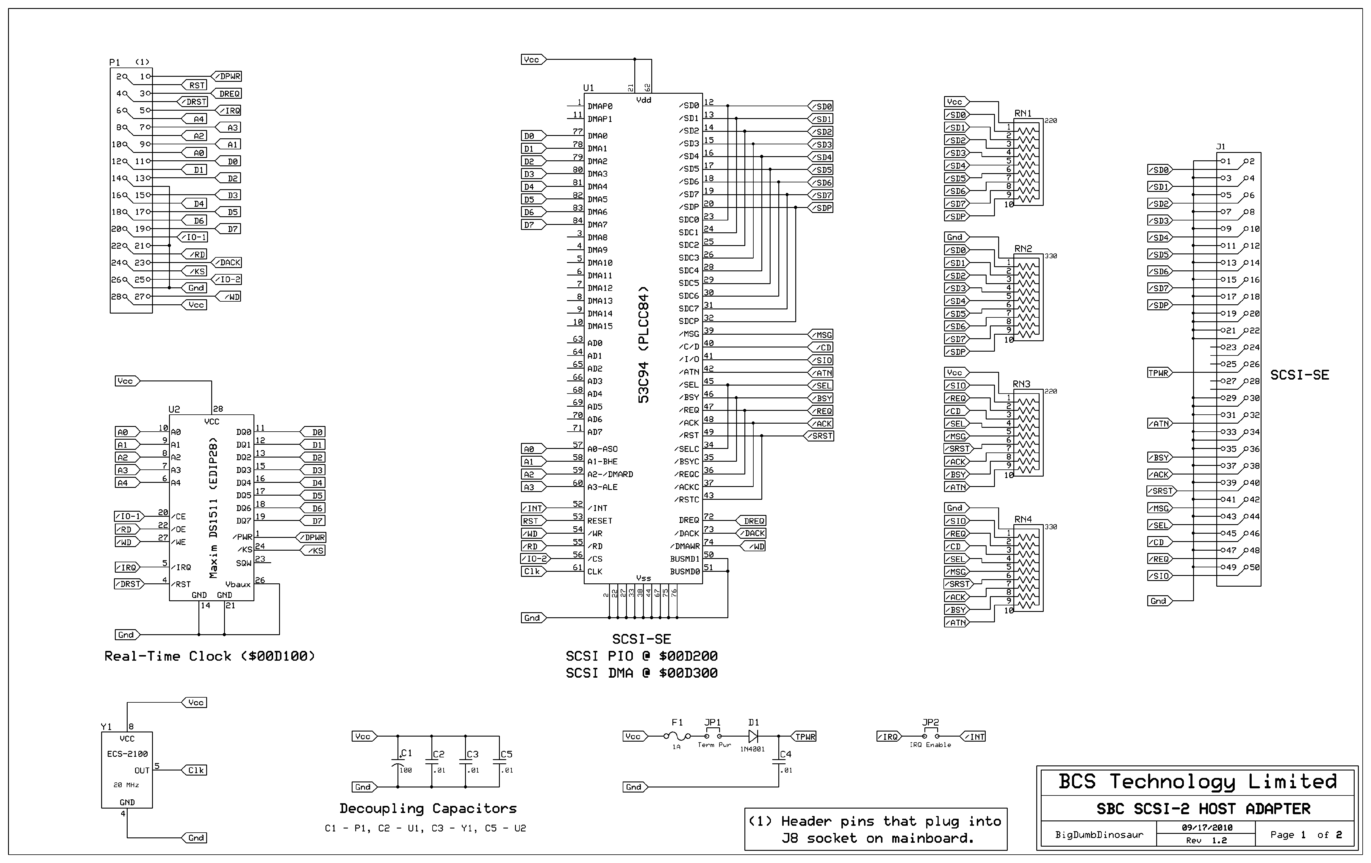

In my first host adapter (HBA) design, I had ignored a 'C94 DMA handshaking signal called DREQ because I didn't expect the data overrun problem—I figured the instant that last byte was read from the FIFO the 'C94 would interrupt. DREQ is used along with the 'C94's /DACK input to control DMA access to the chip's FIFO during the SCSI data-in and data-out bus phases, which is when protracted data flow would be expected. During a read operation, DREQ is asserted by the 'C94 any time it has data waiting in the FIFO. During a write operation, DREQ is asserted as long as the 'C94's FIFO has room for a byte (it's a 16 deep FIFO). When used with a real DMA controller, a tight handshaking relationship exists and there's no problem. My circuit didn't produce that relationship, opening the door to the data overrun problem.
It is now clear that I need to use DREQ to qualify FIFO accesses. With that settled, the question was how to arrange the HBA so the MPU can poll DREQ. If I were using a W65C02S I could connect DREQ to the MPU's SOB input and test the status register V flag to see if DREQ was asserted (a trick used in some Commodore floppy disk drives). However, the W65C816S doesn't have an SOB input and, in fact, doesn't have any input that can be used for the purpose.

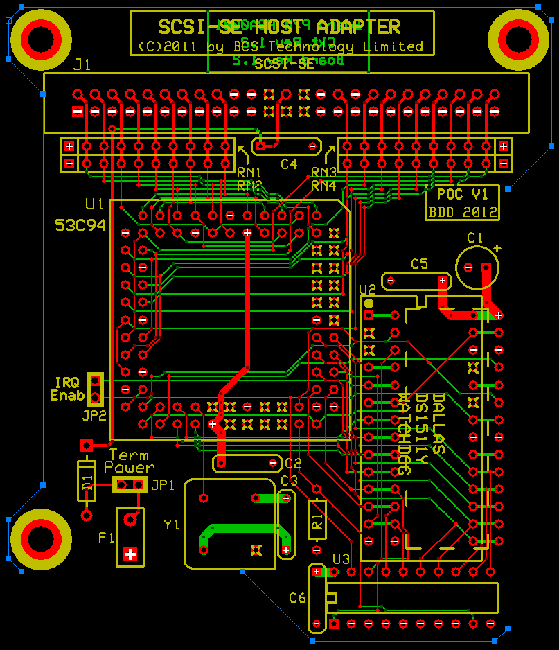

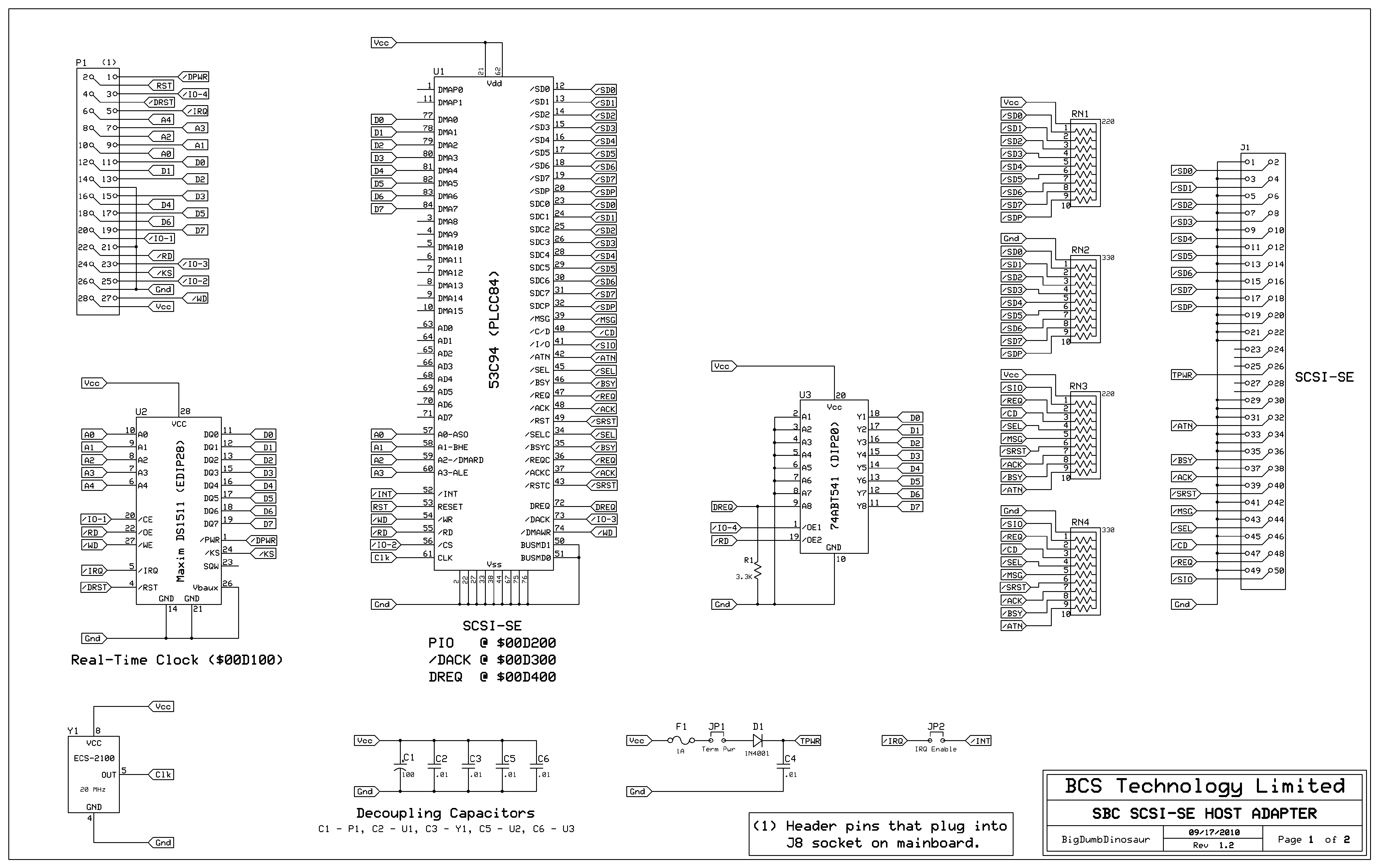

So, after giving it some thought, I decided to add a 74ABT541 bus driver chip to the HBA to put the state of DREQ on the data bus (see schematic; the '541 is in the middle of the drawing).
File comment: SCSI-SE HBA Schematic
The A8 input on the '541 is connected to the 'C94's DREQ output and the '541 Y outputs are connected to the MPU's data bus. Access to the '541 is via /IO-4, which is $00D400 in the memory map. To gate the '541, I connected the /OE1 (output enable) input to /IO-4, and to make the '541 read-only, connected /RD (read data) to the '541's /OE2 input—both /OE1 and /OE2 have to be low to enable the '541, otherwise it stays in a high-Z state. Hence a read on any address in the $00D400 page will cause the '541 to drive the data bus, with the state of DREQ appearing as bit 7 for convenient testing.
I needed to mount the '541 on the HBA but was hesitant to do it via the cut 'n patch method, especially since I also needed to add /IO-4 to the circuit. As the HBA effectively takes the MPU's buses off the mainboard, reactive effects become a concern, and blue wire running all over the place certainly doesn't help in that regard. Complicating matters, the one remaining available expansion port pin, through which /IO-4 would be connected, is underneath the watchdog socket and thus is only accessible by wrapping a piece of wire around the edge of the board, certainly not an elegant technique.
So I decided to make a new host adapter (see PCB illustration below).
File comment: SCSI-SE HBA PCB Layout
I extended one end of the PCB enough to mount the '541 and its decoupling capacitor. Previous patches are incorporated into the new design, so there won't be any blue wire (for now, at least :lol:). However, a patch is needed on the POC mainboard to bring /IO-4 to the expansion socket. Fortunately, that's an easy one involving about 2-1/2 inches of wire.
The new HBA PCBs have been ordered and should be in-hand early next week. I'll post results and pictures when the new HBA is ready to go to work.

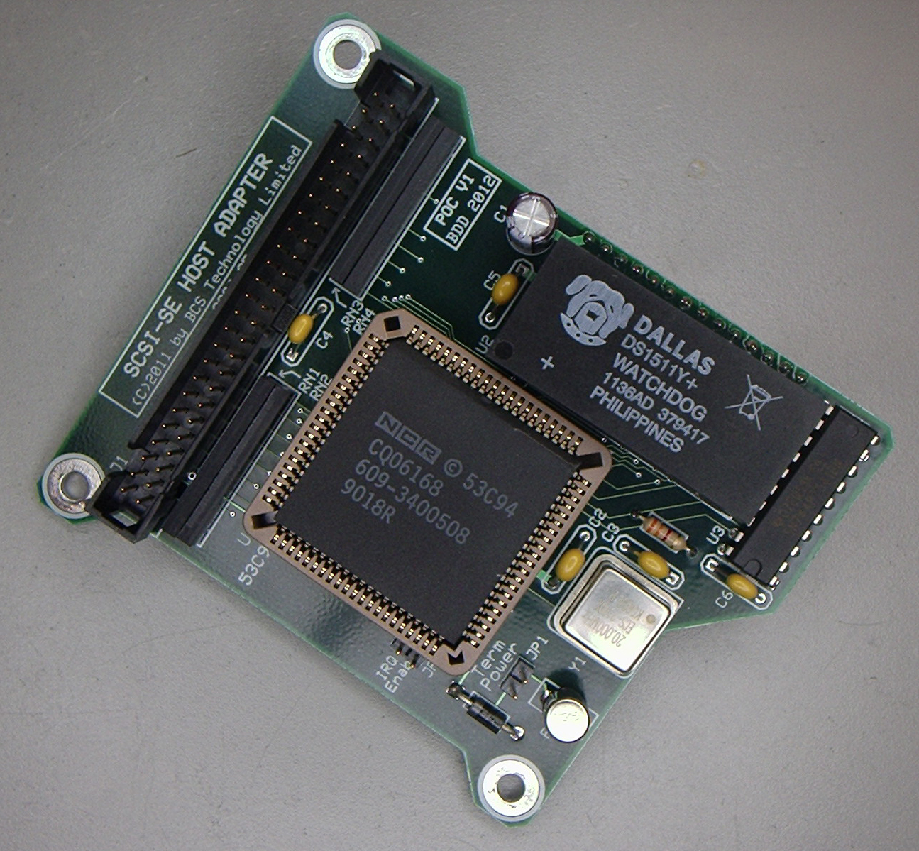

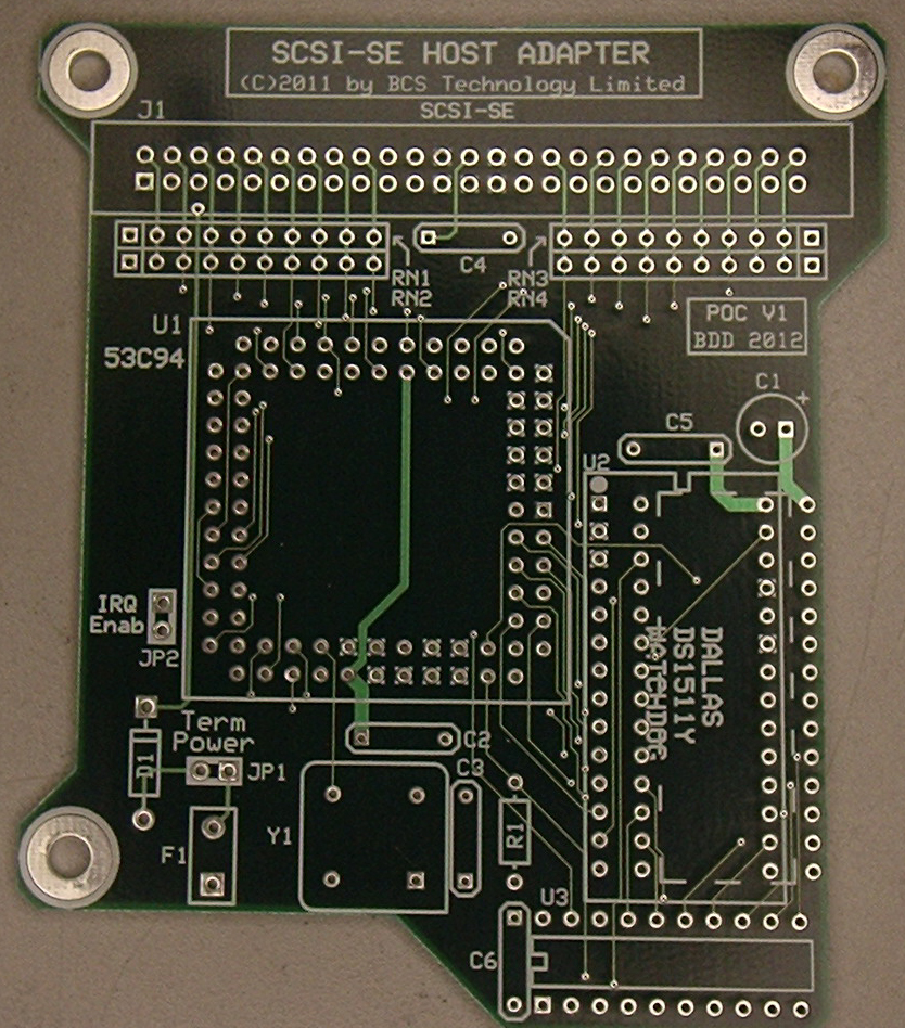

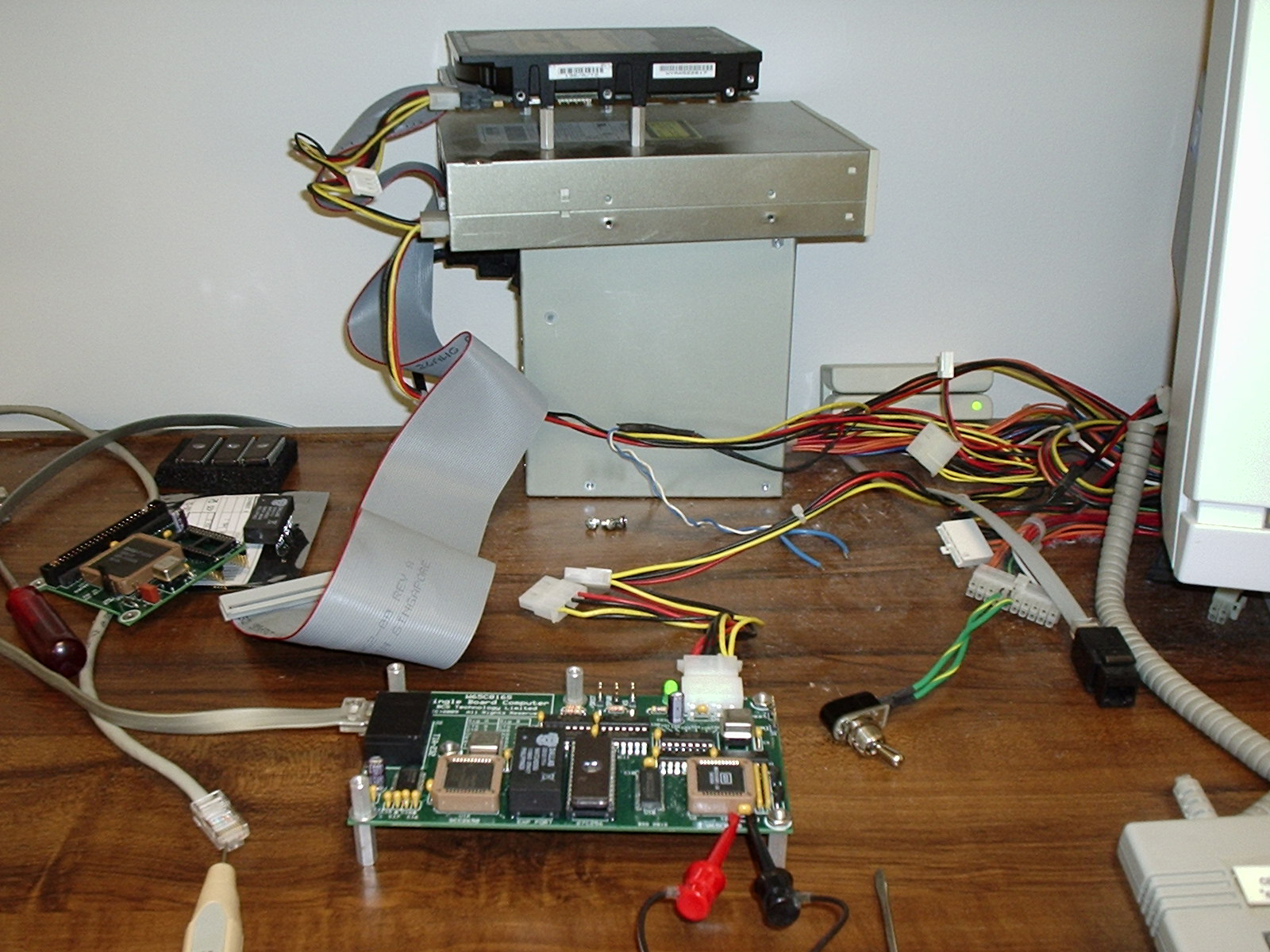

The new SCSI host adapter (HBA) has been assembled and functioned right out of the gate. Here are some pictures:
File comment: SCSI-SE Host Adapter Bare PCB
File comment: SCSI-SE Host Adapter Assembly
File comment: SCSI-SE Host Adaptor Attached to POC V1.1. In this picture, I have my logic probe monitoring the DREQ DMA handshake signal.
The DREQ add-on circuit works as expected and now gives me the ability to make the W65C816S mimic the functions of a real DMA controller. The key word is "mimic." I'll have some more thoughts on how I might go about this in another post.

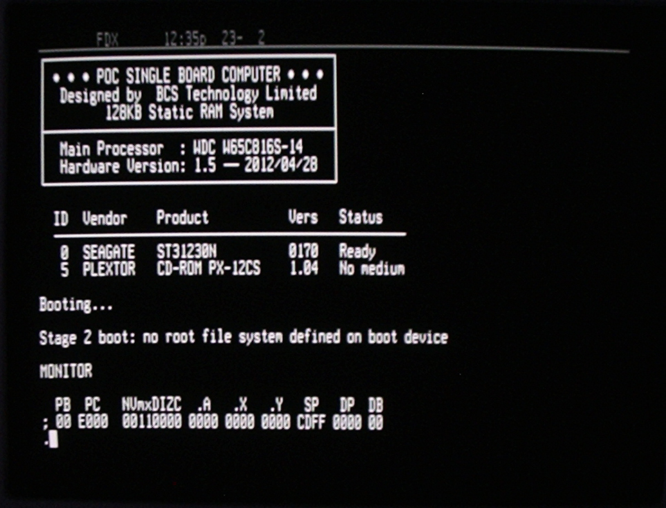

File comment: POC V1.1 POST screen.
In this last picture, the POC has POSTed and attempted to perform an ISL from disk. The boot block has been read from the hard drive, but boot can't continue because there is no root filesystem on the disk. At this point, I'm still using the old PIO SCSI driver.
The purpose of fabricating a new host adapter was to make it possible to use the 53C94's DMA access functions. Programmed input/output (PIO) operation of the 'C94 is impractical during protracted data transfers, as the controller will interrupt for each byte moved. Reading a single hard disk block would entail 512 IRQs in rapid succession, plus other IRQs generated as the SCSI controller is sequenced. Throughput using PIO would be severely limited due to all the code the MPU would have to execute. Hence the focus on DMA.
When used with DMA, the 'C94 only interrupts when the last byte has been transferred (or an error occurs), which means that DMA transfer can be very efficient compared to PIO operation. I estimate the performance difference between PIO and DMA operation in the POC could be at least 10 to 1, maybe better—depending on how efficiently I write the driver. As I don't have the luxury of a real DMA controller I have to make the 65C816 pretend to be one. This is more complicated than it might appear at first blush. A real DMA controller can function independently of the MPU once the latter has programmed it. In the context of the 53C94, all a DMA controller has to do is handshake and move bytes. It doesn't have to worry about IRQs or what to do about them. Not so with the '816 and hence the greater programming complexity. In order to understand what is needed, detailed understanding of the behavior of the 53C94 is necessary.
The 'C94 is intended to automate the SCSI bus protocol and thus has been given a fair amount of intelligence. Ergo the chip has a number of registers that have to be programmed at boot time, while others have to be programmed before or during a SCSI transaction. The key registers are:

In order to prove some of my ideas about driving the SCSI host adapter DMA style, I cobbled together a driver that uses the DREQ and /DACK handshake, but doesn't actually generate IRQs. The host adapter has a jumper block that allows me to either isolate or connect the low-true interrupt output of the 53C94 from or to /IRQ on the mainboard. Since writing a crash-proof IRQ driver for a chip like the 'C94 is not a trivial matter, I decided that in order to test the behavior and performance of the DMA style access, as well as prove that the DREQ and /DACK handshake works right, I would isolate the 'C94 from /IRQ and "manually" test for an IRQ after each handshake. That way, if something got hung up I could recover control with an NMI and thus preserve the conditions that led to the problem.
Like just about any I/O chip that uses interrupts, the 'C94 has a status register bit (bit 7) that goes true when the device is interrupting. So my read data code goes like this:
;PROCESS DATA IN PHASE
phdatin  jsr dmaxfrsu          ;do DMA transfer setup steps
.0000010 bit dreq_srd          ;FIFO have data?
         bpl .0000020          ;no
         lda fifo_srd          ;yes, get &...
         sta mm_ram,x          ;store data (16 bit .X)
         inx                   ;next buffer location
         bra .0000010          ;get more
.0000020 lda stat_sr           ;did 'C94 interrupt?
         bpl .0000010          ;no, so get more data
;   DMA transfer completed...execute next step
The 'C94 will interrupt as soon as the last byte is read from the data FIFO and the IRQ will be cleared when the interrupt status register (separate from the status register) is read. Actually, there may be a small lag between the time when the last byte is read and the IRQ arrives, which means the MPU may loop a number of times testing DREQ. However, the IRQ will eventually arrive and signal (we hope) that a bus phase change has occurred, usually to the status phase. However, an IRQ could also signal trouble, so some testing is required to ascertain what the IRQ is all about. As the 'C94 maintains a count of how many bytes were transferred via DMA, it is also important to look at that count to verify that a full transfer occurred. Fortunately, the 'C94's status register has a bit that is set when the full count has been processed, so it's a simple test.
The above loop is pretty efficient, and during testing with the POC running a 10 MHz clock and reading 32 KB from the disk, it achieved a bit over 400 KB/second transfer rate, with no errors. That's about nine times faster than my present PIO driver can go. This testing, in addition to demonstrating how much faster DMA is than PIO, also proved that the DREQ and /DACK handshake is reliable. There were no data overruns like I was getting before I got the handshake into the picture.
The next step is to get the POC's interrupt handler to process 'C94 interrupts. Doing so would cut the execution time of the loop by six clock cycles, since the code needed to test the 'C94's status register would be eliminated—nothing would need to look at the 'C94's status register until it actually interrupted. Those six cycles are a not-insignificant improvement when one considers that over the time required to perform that 32 KB read from the disk, a savings of 196,608 clock cycles would be realized, which is 19.6 milliseconds at 10 MHz. That may cut the total processing time by 25 percent, which could increase performance to over 500 KB/seconds.
Incidentally, 10 MHz is as fast as I can run the system with the host adapter installed.
