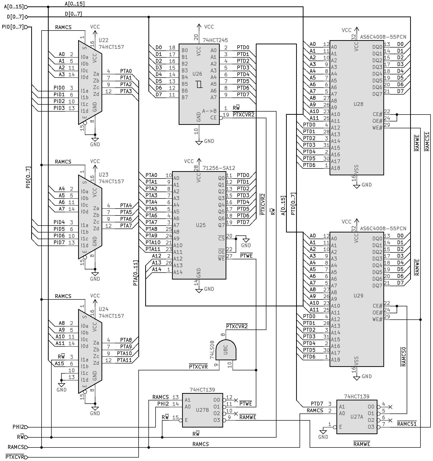

This will also require multiplexing between e.g. A12 and RWB, to drive the pagetable with A12 when reading/writing the pagetable itself, and RWB otherwise. It means I could cheaply also multiplex two more inputs into the pagetable, but I'm not sure what would be useful except perhaps SYNC to support non-executable pages - but then, I don't really know why I'd want to support that in this sort of system.
Finally I'm also thinking about making a breadboard prototype, but with narrower buses to avoid having to route so many wires, which is quite tedious. However it feels like unless I cut it all the way back to only routing the bottom four and top four address bus lines from the CPU to the RAM, I won't really be saving much in complexity, so I might as well bite the bullet and wire up the whole thing. I may experiment with the layout in KiCad first and then decide. Normally I'd just have gone ahead and done this, but at the moment for personal reasons I have a lot more time for thinking than doing, so I'm probably overdoing the thinking!
Re: Fairly complete multiprocess computer design

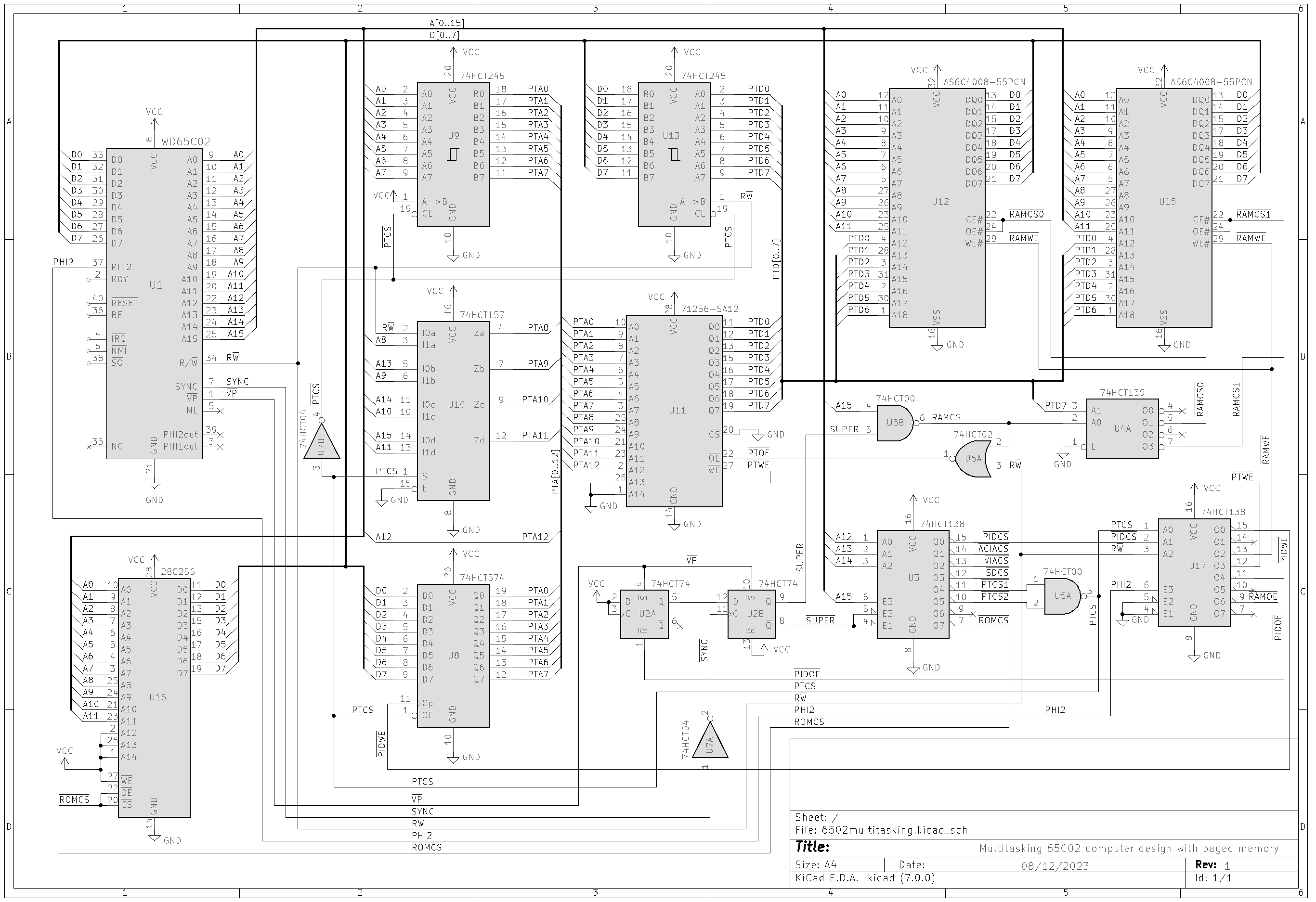

I've applied some of the above changes, resulting in this updated partial schematic (still missing a couple of trivial things that don't fit on the page):
I didn't try as hard this time to reduce the logic, I feel some of the separate gates may be unnecessary and half of the '139 is sitting unused. I stopped though because I'm planning to make some big changes that I'll discuss in a moment, so it's not worth honing this down as it stands.
The main changes here are:PG3..0 represents the logical page number - as you can see, the addresses the kernel uses to read and write the pagetable have these bits in a funny order. This only affects kernel code that accesses the pagetable, and is easy to work around in software.
There's also quite a long gate delay to the PTWE signal that enables writes to the pagetable RAM. However I think this is OK because it's gated by PHI2 and there's only a single '138 on that path. I did ensure that PTOE would be set up promptly as having that active as early as possible in phase 1 allows time for the pagetable lookup to take place before any writing to RAM happens during phase 2.
However I think I'm going to simplify this design a lot more by making it require a "system VIA" and moving a lot of the functionality onto that. I can use the VIA timer to drive prempting, through IRQ; I can use port A as the PID register instead of having a separate IC for that; and I can use CA2 as the signal to queue up transitions out of supervisor mode. This means all the address decoding for PIDWE and PIDOE is no longer required. Port B is then still available for I/O - I can easily bitbang SPI for SD support, or use the shift register for that, which will be slightly slower than using a dedicated circuit but removes the need for more I/O decoding.
Using Port A as the PID register has a drawback compared to the external register (U8), because it would require extra multiplexing. However I realised that it may be possible to just have the PID always drive those low bits of the PTA bus, and not allow the CPU to override them during direct pagetable access. This would require the CPU to load the right value into the PID before performing any pagetable operations. That might be just about possible - it would page out all the kernel's RAM, but routines in ROM could perform the reads and writes before putting the PID back:It's not too bad. It requires the page number and RWB to be mapped through the low bits of the CPU's address bus, so that indexing can be used to set them from a register. I think overall this could simplify the hardware a fair amount.
Focusing back on the VIA-based approach itself, it could lead to kernel a memory map like this:That's just an example but shows how much simpler it can be, and means a lot of the existing glue logic would be unneeded. VIAs and ACIAs can be lazily decoding in the manner Garth uses in his example computer design, using their dual CS pins without requiring extra glue logic. In this memory map the pagetable also has twice as much space again (14 bits rather than 13), so could support more pages perhaps (lowering the overall system memory supported, but making it more granular).
Another interesting possibility here is using the pagetable RAM in place of the ROM at the top of the address map. The system could boot from ROM, populate the RAM, then swap the ROM out permanently; or use a ROMless booting method. This allows something BDD suggested - changing the reset vector after the initial boot, so that later resets can jump straight to the process-killing code. So I might see about doing that - it would however require multiplexing the whole address bus into the PTA bus for pagetable accesses, as the CPU would be using the spare portions of the pagetable RAM module as general purpose RAM.
- RWB is fed through to the pagetable on PTA8, meaning read and write mappings are stored separately
- The pagetable needs an extra bit of address space as a result, so A12 is mapped through during reads or writes of the pagetable. It's also required for normal operation, though, so it doesn't need multiplexing.
- PTCS gets twice as much space in the address decoding on U3+U5A
- All the write-enables, and also PIDOE, are generated by a second '138 (U17) reducing the amount of separate logic gates in the design.

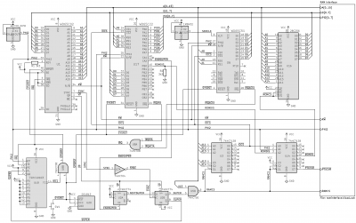

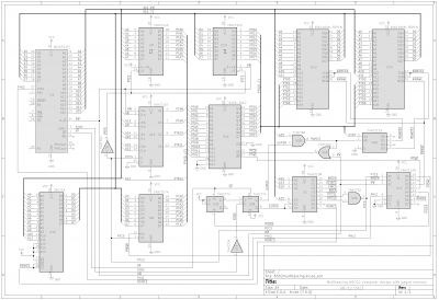

I've made a lot of updates to the design, which simplify it in some ways but also add more features. This should finally be a complete schematic for the whole system, unless I've missed something!
I originally squeezed it onto one page, but it was very cramped so I broke it out into two. I'll attach them here and then call out the changes and points of interest.
First the RAM interface: This contains all the RAM and the paging system. Its inputs are the CPU's address and data buses, an 8-bit process ID, the CPU's PHI2 and RWB signals, an active-high RAMCS signal that indicates whether the current cycle is accessing paged memory, and an active-low PTXCVR signal that indicates whether the transceiver connecting the CPU's data bus to the pagetable's data bus should be enabled (it is only enabled when the CPU is reading or writing the pagetable).
Then the rest of the computer - 6502, 6522, 6551, etc: There shouldn't be too many surprises here but I'll talk through some differences from the past revisions below.
Key changes
Using the VIA like this reduces complexity elsewhere, though obviously there are less free pins on it for other things. I can easily add another VIA if there's a need for more I/O than it has remaining. Its timers will also be used to control scheduling, and I will probably hook up an SD card interface and/or PS/2 keyboard through it as well.
Key changes
- The PID register is now located in the "system" VIA (U17), on Port A
- The VIA's CA2 is used to queue up a switch to user mode (like reading the PID was before) - so accessing Port A via register 0 will cause this, and accessing it via register 15 will not. This gives the kernel more control over these mode switches.
- The boot ROM (U16) can be mapped out using the VIA's PB0 pin, leaving pagetable RAM in its place
- The pagetable RAM (U25) is then almost fully-addressable, meaning that parts that are not used by the 8K pagetable and the 1K I/O space can be used for other things
- A 65C51 ACIA (U6) is included in the circuit, in case VIA bitbanged serial doesn't work well enough
- A watchdog timer (U18) is included to trigger killing of rogue processes where necessary

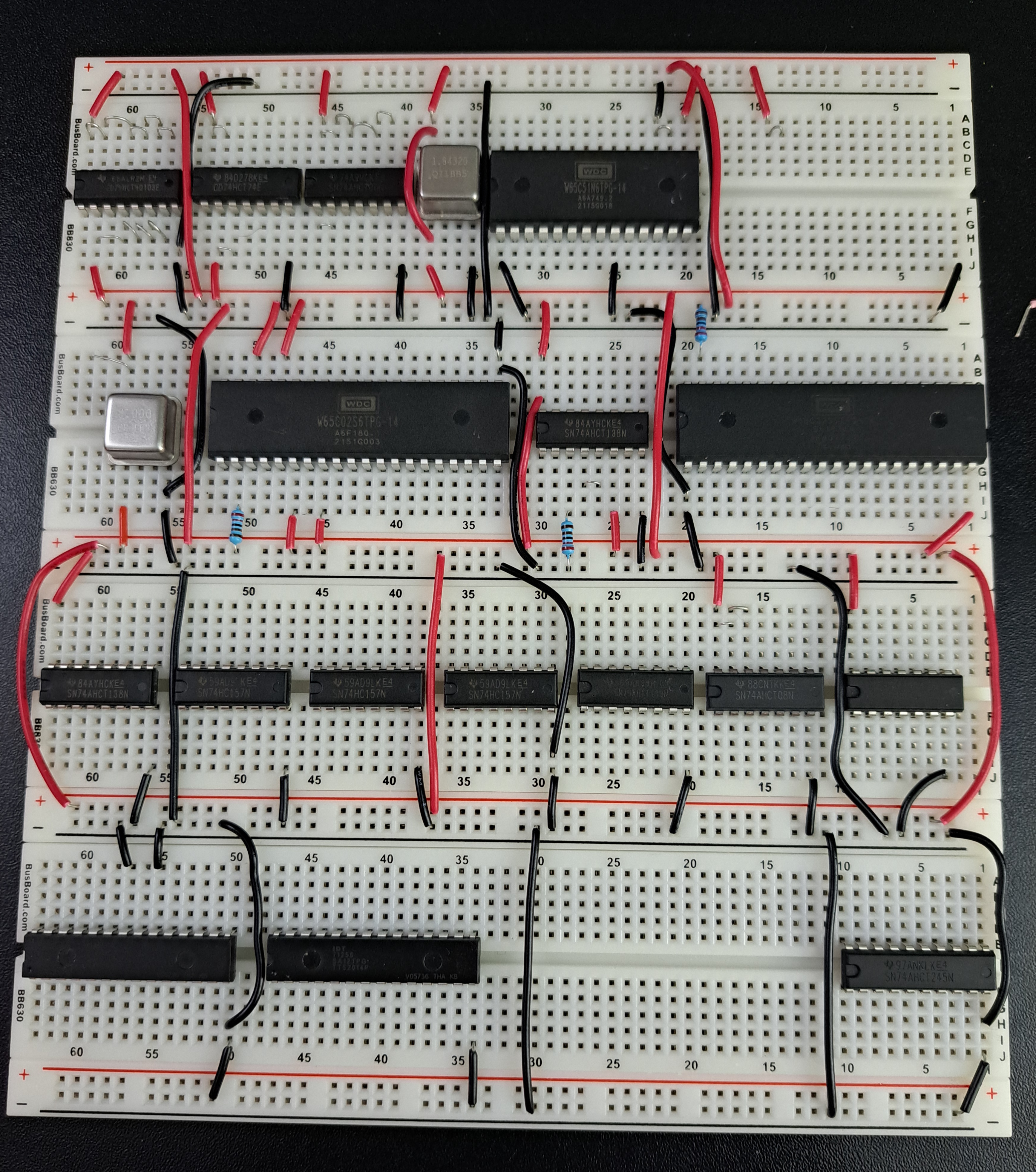

There were a couple of errors in that schematic - the WDC 65C51N part has an open-drain IRQB so it needs a pull-up resistor, and some of the other signals like ROMDIS and /ENDSUPER also need pulling one way or the other to ensure they default to sensible states before the VIA pins are in output mode.

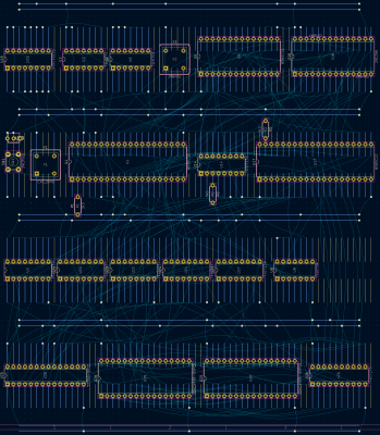

I wasn't sure whether to just do a PCB layout for this, or whether to prototype it first. I decided to prototype it, so yesterday I went ahead with that. I tend to plan the layout in KiCad, even for solderless breadboards - the rats' nest is very helpful for this. My priority is generally to redure the length of wiring, rather than signal integrity, as the signal integrity is going to be bad either way, and long wires are hard to manage on breadboards. Here's the planned layout: The top row contains the watchdog timer, the pair of flipflops that manage the SUPER state, some glue NANDs, an oscillator for the ACIA, the ACIA, and the ROM.
The second row contains the reset switch, main oscillator, CPU, a '138 decoder, and the sytem VIA.
The third row contains another '138 decoder, the multiplexers for the pagetable RAM address bus, a '139 decoder pair, and some AND gates.
The fourth row contains the pagetable RAM, the system RAM in two ICs, and the transceiver to connect the pagetable data bus to the CPU data bus during pagetable read or write operations.

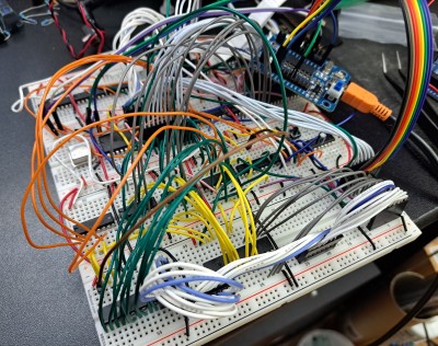

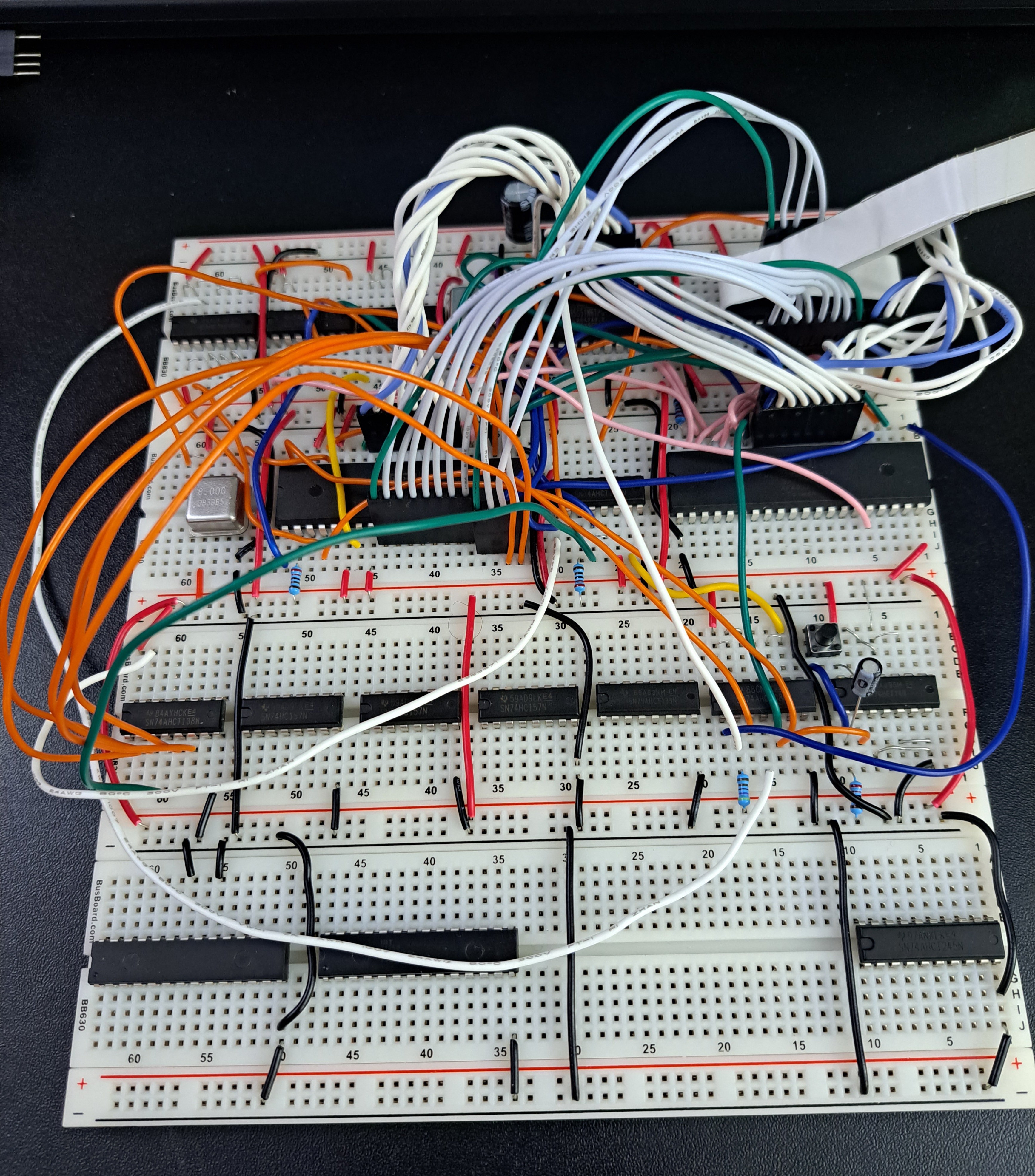

I laid these out on the breadboard according to this plan, but I squeezed the top row to the left to make more space around the EEPROM so that it would be easier to access, and I also made room for some schmitt inverters on the third row for and RC reset circuit as I can't find my DS1813s. I've also only put one system RAM IC in, and it's a small one - I'll test it like this first, and if it works then I'll steal larger RAM ICs from one of my video circuits.
Next I laid out a ground grid, and less importantly, a power grid, and I routed ground to all the ICs, and power to the subset I'm going to test first - essentially everything except the RAM interface: Next I wired up all the connections: I was not feeling very patient, so I reused long premade Dupont cables for most of the buses. Some of these I made in the past by crimping my own connectors onto the wires, others using pre-cut, pre-crimped wires. Having lots of these wires in one housing makes it very easy to plug and unplug them - the data bus is 8 wires in one connector, the address bus is one 8-way connector, one 4-way, and loose wires for the rest. I have a special splitter for the data bus going to the ROM which is a 1x8 socket on one end and two sockets on the other end, one a 1x3 and one a 1x5. I also use a special cable for A8-A11 from the CPU to the ROM which has four wires but goes into a 1x5 socket at the ROM end, with pins in the order: A8 A9 A11 NC A10. This makes it very easy to hook these up without needing to remember how they go.
Other than that, I just used extra-long wires for long connections. This was partly because I do the routing methodically, starting with power and ground, and then working through each IC in turn connecting it to others. Being methodical is important because it's very easy to miss a connection otherwise, especially in busy areas. Long distance connections don't play well with that because if you try to route them tidily they end up trapped under a lot of shorter connections later on - so I chose to just make these extra long, so that at least the connection was there, and consider going back to optimise them after all the short connections were in.
With that all in place I made a quick test program to initialise the VIA and write increasing values to port A (the PID). It didn't work very well - diagnosis revealed issues with the data coming from the ROM. This was due to my ROMCS signal being gated by PHI2, meaning the ROM has only half a clock cycle to present its data - it was doing so around the falling edge of PHI2, so not quite early enough. This was with an 8MHz CPU clock, so ROMCS was only asserted for about 60ns, meaning that as far as the ROM was concerned it looked more like a 16MHz clock, which is too fast. I downgraded the clock to 4MHz (120ns high period) and it worked. This tallies with my past experiences - it's equivalent to 8MHz with an ungated ROMCS, which is generally fine although the EEPROM is specified to want 150ns; but clock speeds any higher than that are more risky.
Next I took some code from Garth's RS232 and 6502 primers to set up the 65C51 as I've never used one before, and got it to send and receive data, with a view to having it load code that way for faster iteration, when the system has RAM to load it into!
So the CPU, ROM, VIA, and ACIA were working fine. Before moving on to add RAM, I wanted to test the more bespoke features of my circuit - even with just this subset it should be possible to test the transitions between user and supervisor modes, and the ability to page out the ROM. In both cases the system is going to try to run code from RAM, and there is no RAM, but at least we should see that happening.

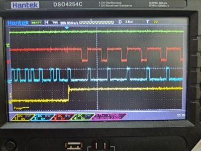

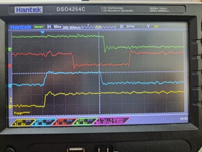

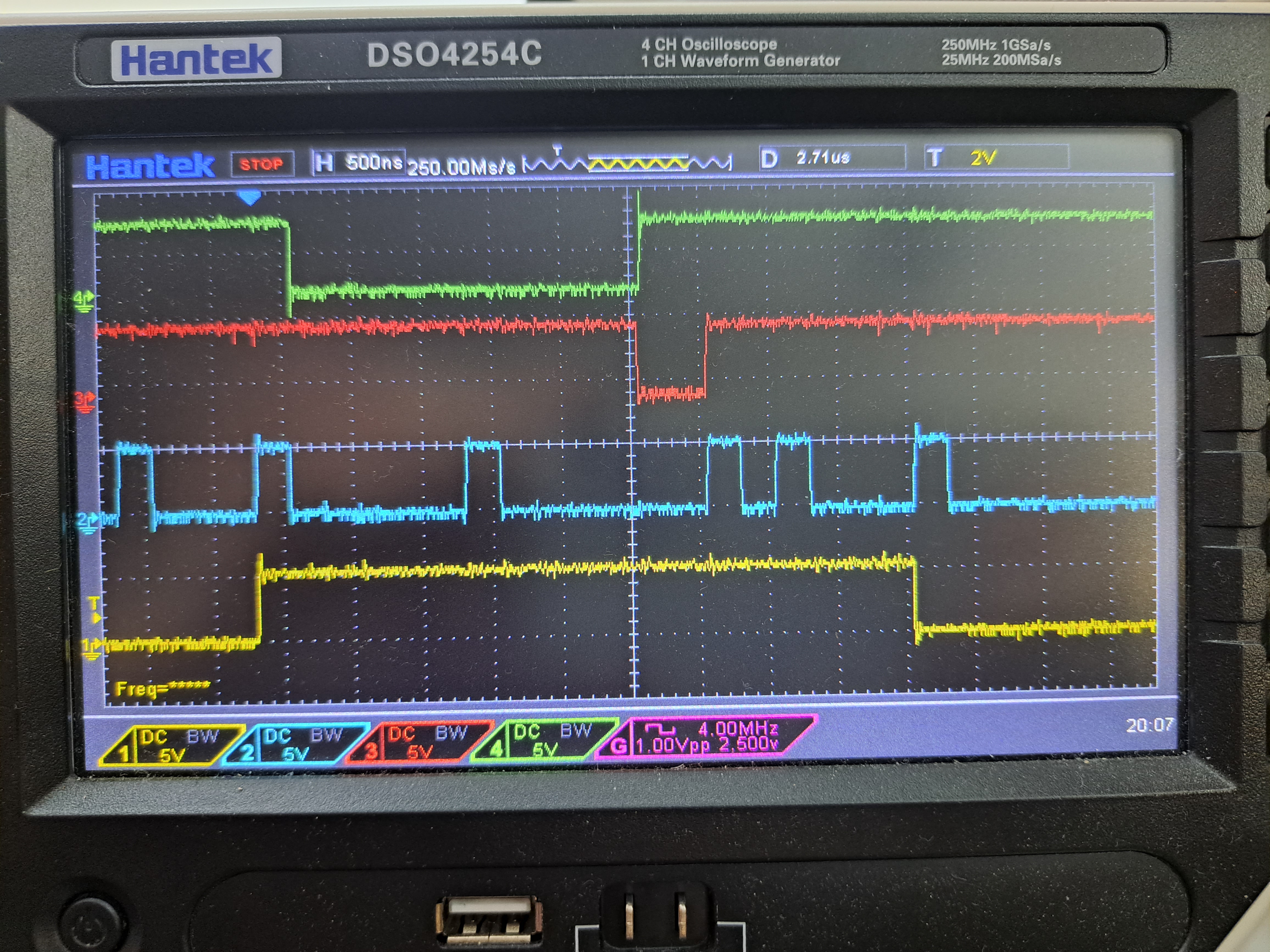

Here's an oscilloscope trace showing the transition from supervisor mode to user mode: The bottom, yellow trace is a VIA pin that's changing state during the CPU operation that triggers user mode (writing to VIA_PORTA, with pulse output on CA2 enabled). The blue trace is the CPU's SYNC pin, showing when instructions start and how long the clock cycle is. The red trace is CA2, the asynchronous reset input to the first D flipflop, which holds the pending mode change until the end of the next SYNC. The green trace on the top is the second D flipflop that outputs the user/supervisor state, and this is the signal that changes all the address decoding.
It's interesting to note that the handshake pulse from the VIA is maintained over the falling edge of SYNC. This means that I could probably have not used the first D flipflop here - I could probably have just used an AND gate to make the second D flipflop blend its current state with the CA2 state, so that it would stay high only if CA2 was not low, and after going low, it would stay low until forced high again.
In the traces above we can see that the system is going into user mode, and then executing a series of 6-cycle instructions. I am not sure what these were exactly, nothing was driving the bus but evidently it floated to, or persisted at, a level that corresponded with a stable state. To check this better, I added a pull-down resistor network to the data bus, so that it would give a BRK opcode if no device was driving it, and this made it easier to confirm things were working as they should: I moved the red probe (second from top) to the CPU's VPB pin this time. Now we can see the user mode state starting at the falling edge of the SYNC for the RTI instruction, and then another instruction starting which will be a BRK due to the pull-down resistor, and then VPB goes low for two cycles, forcing the system back into supervisor mode. After that a couple of instructions execute - this is my IRQ handler which just loads X with a specific value, writes it to port A, and issues a STP instruction. The write to port A brought the yellow line low again and STP meant no more sync cycles occured after that point.
So clearly the address decoding has responded to the transition to user mode, and the ROM is no longer mapped; but also, on VPB, we do return correctly to supervisor mode in time for the IRQ vector to be read from the ROM.
Finally I wanted to test the ROMDIS signal, which is used to disable the ROM and have high-bit-set operations read from the pagetable/private supervisor RAM instead. Again that RAM is not present, but my pull-down resistor network will cause BRKs in its place: The yellow line at the bottom is now the ROMDIS signal, which is just an output pin on the VIA - when high, ROM is disabled. It's transitioning right at the end of an instruction, in time for the instruction fetch during the next SYNC to occur from pagetable RAM instead. We get a BRK, and see VPB (red trace, second from top) go low as expected a few cycles later. The system stays in supervisor mode (green trace, top) as intended.
So I think everything in this part of the circuit is working well. This evening if I get time I will wire up the RAM and the transceivers, and hopefully be able to bootstrap a minimal kernel. The strategy for that is probably to have the boot ROM run some system tests and then stream the kernel code from the ACIA into the private RAM, then disable the ROM.
Lotta chips! Reminds me of the Basic Four minis I worked with in the previous millennium.
The waveforms don’t look too atrocious for being on breadboard. Usually, square waves on a breadboard are so rounded you can hardly tell where logic zero ends and logic one starts.
I have wired up the RAM as well, at least as a first pass, and it appears to work so far - the only bug was in my test code (thanks to hoglet's decoder it was very easy to pinpoint) so now I can try to develop a bit more software.

Thanks for sharing the traces and the explanations - we usually see traces of things which are misbehaving!
Should be interesting to see how well this mess works once you have a suitable kernel running.

That you are using (IIRC) HCT logic helps—HCT has relatively sedate edges (and relatively slow timing compared to AC & AHC). When you add ROM, that’s probably when the fun will start. ROM tends to generate large transients on the power and ground buses as /CS and /OE are switched. I have a white paper somewhere in the vast refuse pile on one of my servers that goes into some detail on noise problems caused ROMs, especially the 45ns OTP ROMs sold by Atmel (Microchip).
Regarding logic series, I am using a mixture, in practice - I think it would be mostly fine with HCT but I have quite a lot of AHCT parts that I got for high resolution video circuits, so I've used a lot of those as well.

The memory map at that point is roughly that the bottom 4K of address space is mapped to physical RAM page 0 (out of 8 in this cut-down system), and the top half of the address space maps reads to come from ROM, and writes to go to the private/pagetable RAM. The bits in-between ($1000-$7FFF) are more paged RAM, but the pagetable hasn't been initialised yet so they could point anywhere.
To speed up development, I pasted into the ROM my load-from-serial code from my last system, with minor changes, and was able to get some code loaded into the page of RAM that way. The interface allows the PC-side server software to choose which code gets loaded, to what address, and where execution begins, so this means no more changes are needed to the ROM for now - I can load code or data anywhere I like, with the caveat that it has to be done 256 bytes at a time.
Loading a short "hello world" program to the valid page of RAM worked fine (loading at $0200). The main missing piece then was getting code loaded into the private RAM that's masked by the ROM at boot time. In the long term it might make sense for the ROM to just copy itself into the private RAM and then disable itself, with execution flowing on seamlessly from the private RAM instead. But to avoid having to iterate on the ROM itself, I used the serial server to tell the ROM to load code into the private RAM, at $8800, and then made it load and execute a stub in paged RAM at $0200 that can itself disable the ROM then chain to the loaded code in private RAM. The ROM should be able to do this through the same hack that allows pagetable writes to work even when the ROM is enabled.
This didn't work very well though, and was hard to diagnose. My main tools were the logic analyser, hoglet's decoder, and an oscilloscope, setting VIA output pins at key moments to trigger the oscilloscope. I found quite a few issues this way, the main one being that the hack to let the ROM write-through to the pagetable RAM doesn't seem to be working very well. It does seem to be good enough to let it write that initial pagetable entry, it seems, but I don't know why, and it is certainly not reliable at all later on. I need to do a lot more diagnosis on this, but it will involve iterating on ROM content, so I'm going to defer it for later - I do want to fix it though before getting any PCBs made.
I did find that the way I am switching the buses back and forth in these writes is putting a lot of stress on things - I am seeing evidence of bus contention, such as downward spikes in the power rail, and noise on the pagetable data bus. I think the bus transceiver between the CPU's data bus and the pagetable RAM's data bus is having a particularly hard time.
As above though, I won't investigate this in detail yet, because it seems to work very well so long as I disable the ROM before loading data into the private RAM. This is why I think the issue is something to do with my hacky AND gate that is meant to open the transceiver during writes to ROM address space. So I wrote a program that runs in paged RAM (at $0200) which disables the ROM, and writes a distinctive pattern into private RAM at $8800, then reads the pattern back. This worked well to highlight that I had misconnected one of the address lines to the private RAM, which was easily fixed.
I wrote a more thorough test of the private RAM, which would fill all 32K of it with a distinctive pattern and check it could be read back properly - skipping, of course, the two bytes that are defining the page mapping for the RAM where the code is running from! And as that passed, I pasted the bootloader code in again, so that this code running in paged RAM can query the serial server again for more commands, and load some proper code into the private RAM area from $8000-$FFFF. It sends a different query string to the serial server, so that it knows to supply stage 2 rather than stage 1 this time.
This in turn allows running code located in the private RAM, which is where the kernel code is meant to be - this is always visible when in supervisor mode, and provides the NMI, reset, and IRQ vectors, so that's important too. The code I put there at the moment is just a more thorough test of the functionality of the paged RAM. It first checks the paging system by using a combination of mappings of logical pages 1 and 2 to check that different physical pages can be mapped, that two logical pages can be mapped to the same physical page, and that asymmetric read/write mappings work (which are required for read-only pages to work).
After checking the paging system, it measures the amount of physical RAM it can see by setting location $FFF in physical page zero to a non-zero value, then looping through the other physical pages, mapping them in and writing location $FFF in each, until it finds one that either can't retain data, or causes $FFF in physical page zero to get overwritten (wrapping). Either way, that's the amount of physical RAM in the system.
Then it performs a more thorough test of this RAM, filling all of it with a pattern and making sure it all reads back and that writes to one page haven't corrupted another. It's an important test, as it is sometimes not obvious when writing to one bit of RAM is corrupting another - a bit like those phony USB drives that are sold with one capacity but actually have a much smaller capacity, and the user doesn't notice until it's been used for a while!
Anyway that all seems good, the memory is working fine. I can do more tests of user mode now, which is dependent on the pagetable and paged RAM working correctly because that's all it's got access to. If that works then I will swap in the larger memory modules, as with only 32K of paged RAM the system only has room for 8x4K pages, which is not a lot.

...When you add ROM, that’s probably when the fun will start. ROM tends to generate large transients on the power and ground buses as /CS and /OE are switched. I have a white paper somewhere in the vast refuse pile on one of my servers that goes into some detail on noise problems caused by ROMs, especially the 45ns OTP ROMs sold by Atmel (Microchip).
3. System considerations
Switching between active and standby conditions via the chip enable pin may produce transient voltage excursions. Unless accommodated by the system design, these transients may exceed datasheet limits, resulting in device nonconformance. At a minimum, a 0.1μF, high-frequency, low inherent inductance, ceramic capacitor should be utilized for each device. This capacitor should be connected between the VCC and ground terminals of the device, as close to the device as possible. Additionally, to stabilize the supply voltage level on printed circuit boards with large EPROM arrays, a 4.7μF bulk electrolytic capacitor should be utilized, again connected between the VCC and ground terminals. This capacitor should be positioned as close as possible to the point where the power supply is connected to the array.
2.4 System considerations
The power switching characteristics of Advance CMOS EPROMs require careful decoupling of the devices. The supply current, ICC, has three segments that are of interest to the system designer: the standby current level, the active current level, and transient current peaks that are produced by the falling and rising edges of E. The magnitude of this transient current peaks is dependent on the capacitive and inductive loading of the device at the output. The associated transient voltage peaks can be suppressed by complying with the two line output control and by properly selected decoupling capacitors. It is recommended that a 0.1μF ceramic capacitor be used on every device between VCC and Vss. This should be a high frequency capacitor of low inherent inductance and should be placed as close to the device as possible. In addition, a 4.7μF bulk electrolytic capacitor should be used between VCC and Vss for every eight devices. The bulk capacitor should be located near the power supply connection point. The purpose of the bulk capacitor is to overcome the voltage drop caused by the inductive effects of PCB traces.
It could be an EEPROM, being a relatively slow device, doesn’t have this issue, but I’m sure it, like all CMOS devices, does kick some garbage into VCC when enabled.
As I have a specific signal for disabling ROM access, I could wire that directly to /CE so that at least when the ROM is permanently disabled, it does go into the low-power mode. Right now I'm blending that signal with the address decoding and driving both /CE and /OE together.
