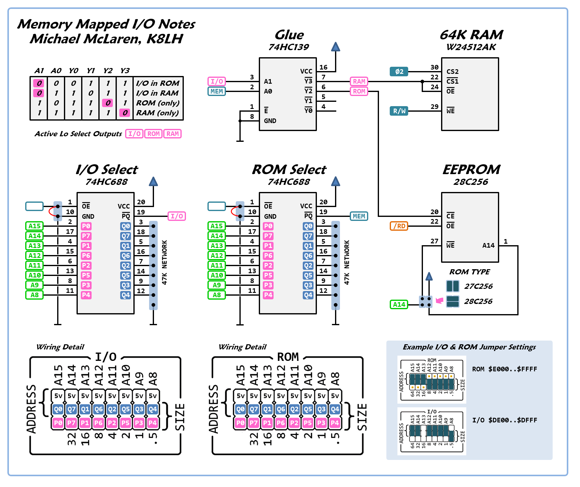

I wonder if a decoder method using a 'magnitude comparator' IC might be of use? Here's an untested method that comes close to your memory map and I/O requirements. While the method is meant to use a 64K or 128K RAM IC to provide much more than 32K of RAM, you could use a 32K RAM IC for your memory map along with one of those spare inverter gates for the active low chip select.
Stay safe. Have fun. Cheerful regards, Mike, K8LH
Interesting! Simply comparing the address high byte with the intended page is certainly a good one chip solution to do what I wanted :) But yeah, the single quantity 5€ price tag is pretty aggressive for a budget build like mine.

AndersNielsen wrote:
I'm also on a limited budget and the 74HC682 price shocked me, too, but I bought a handful of chips from a vendor on AliExpress for about $1.19 each (including shipping) back in September 2021. I also have a cache of skinny 64K RAM chips and wide 128K RAM chips from AliExpress vendors which cost less than $1 each (including shipping)...
The 74HC688 is quite capable and more reasonably priced and might be worth a look.
Cheerful regards...

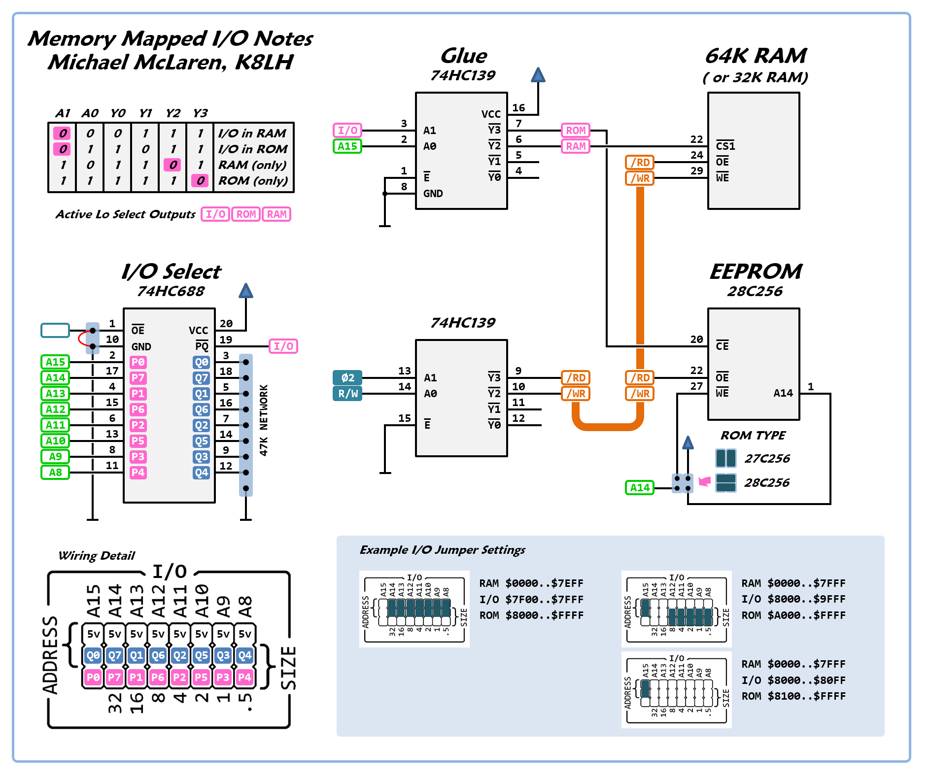

Another untested 2-chip decoder method inserts a single page of I/O and four strobes into the 32K RAM address space (within pages $02..$7F) using the less expensive 74HC688 'magnitude comparator' IC but it does require a 64K or 128K SRAM chip. You could also use your 74HC30 + Invertor gate in place of the 74HC688 for a fixed page of I/O at $7F00..$7FFF.

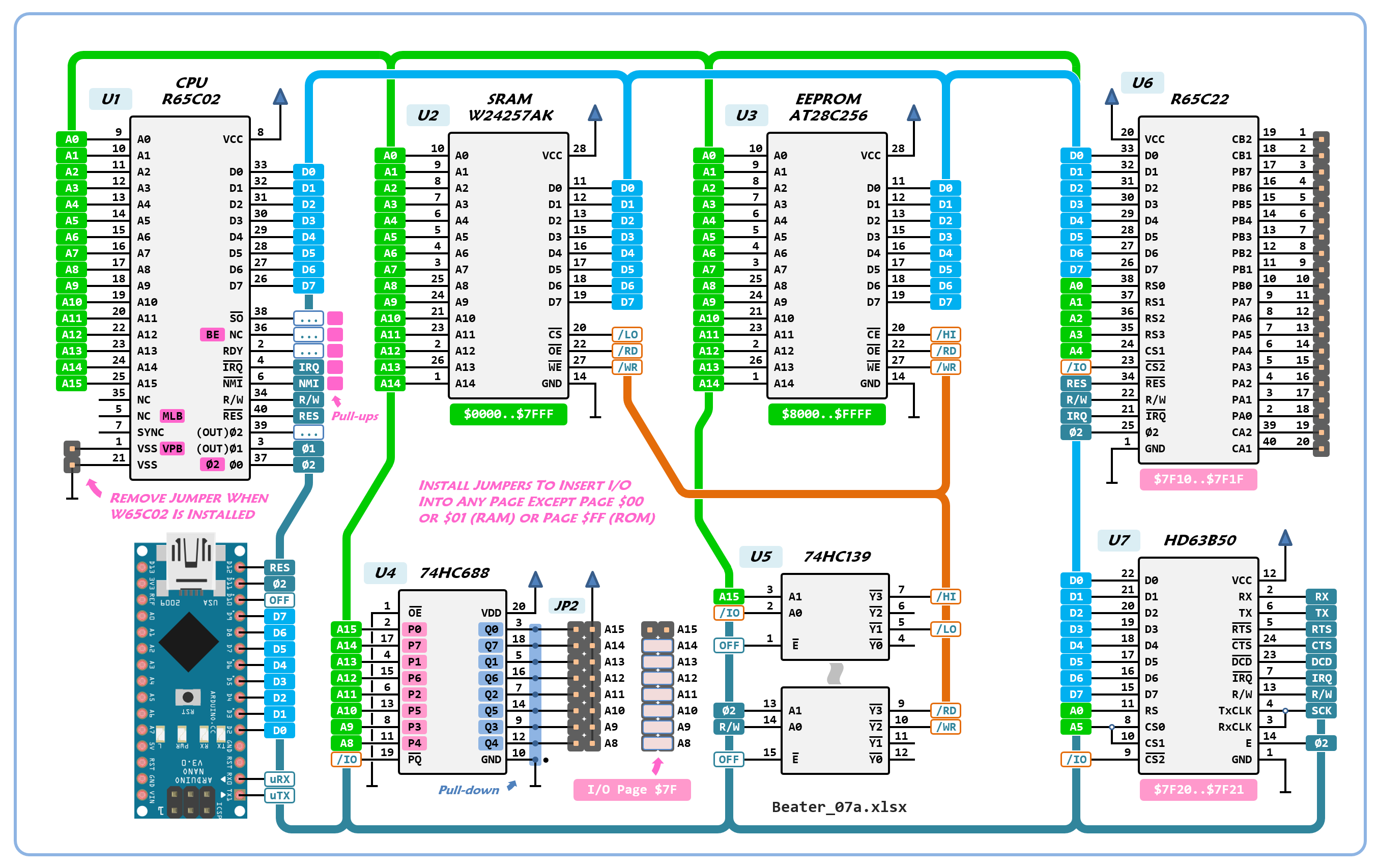

One last idea, if I may? If you're simply trying to reduce the chip count and you don't mind dedicating an 8K block for I/O, how about a single 74xx139 decoder/glue IC and borrow Daryl Rictor's trick from the "6502 Badge" and use the ROM write strobe to write to the '273? Drawing below (yes, it still requires a 64K or 128K SRAM IC)...
Regards...
