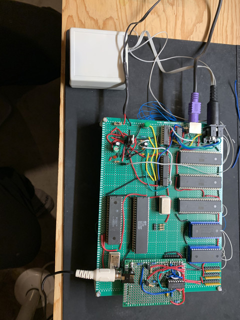

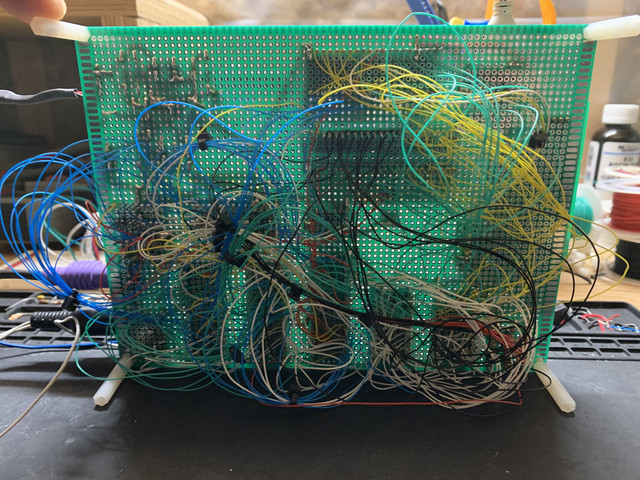

Thank you! It's been a fun journey for sure! My first attempt at a single board computer was on a perf board and I soldered all the wires. It was a mess but it worked! After that I switched to wire wrapping, investing in specialty sockets and a wrap tool. My current project has 2 - 65c22, 32kb SRAM, 2kb dual port ram for video, EEPROM mapped to $9000-$FFFF. Address decoding is done with a ATF16v8b PLD. I use a PIC 16f88 to handle the PS/2 keyboard, it strobes CA1 on one of the VIA's to trigger an interrupt on the 65c02 and sends the keycode over PORTA. I'm using a MC6847 for video, the computer runs on a 1mhz oscillator and the video is on a seperate 3.58mhz. The dual port ram makes it possible to have the video run at a different speed than the rest of the system.

Nice work, thegoat !
Allow me to remind you, BTW, that on this forum you can attach images with your post. There's no need to use a third-party site for images.
