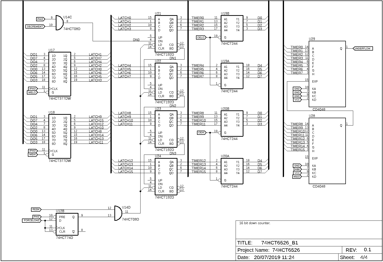

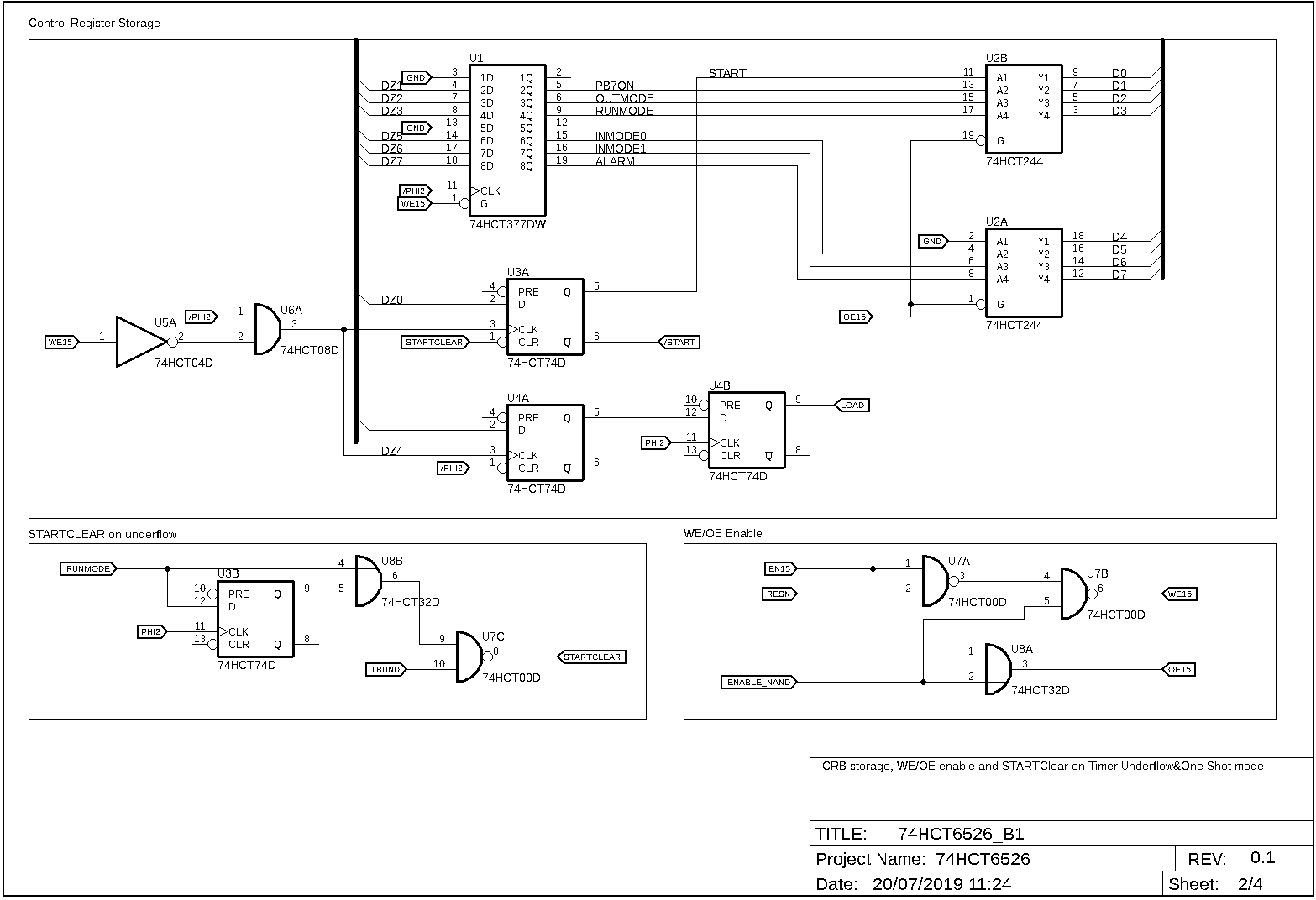

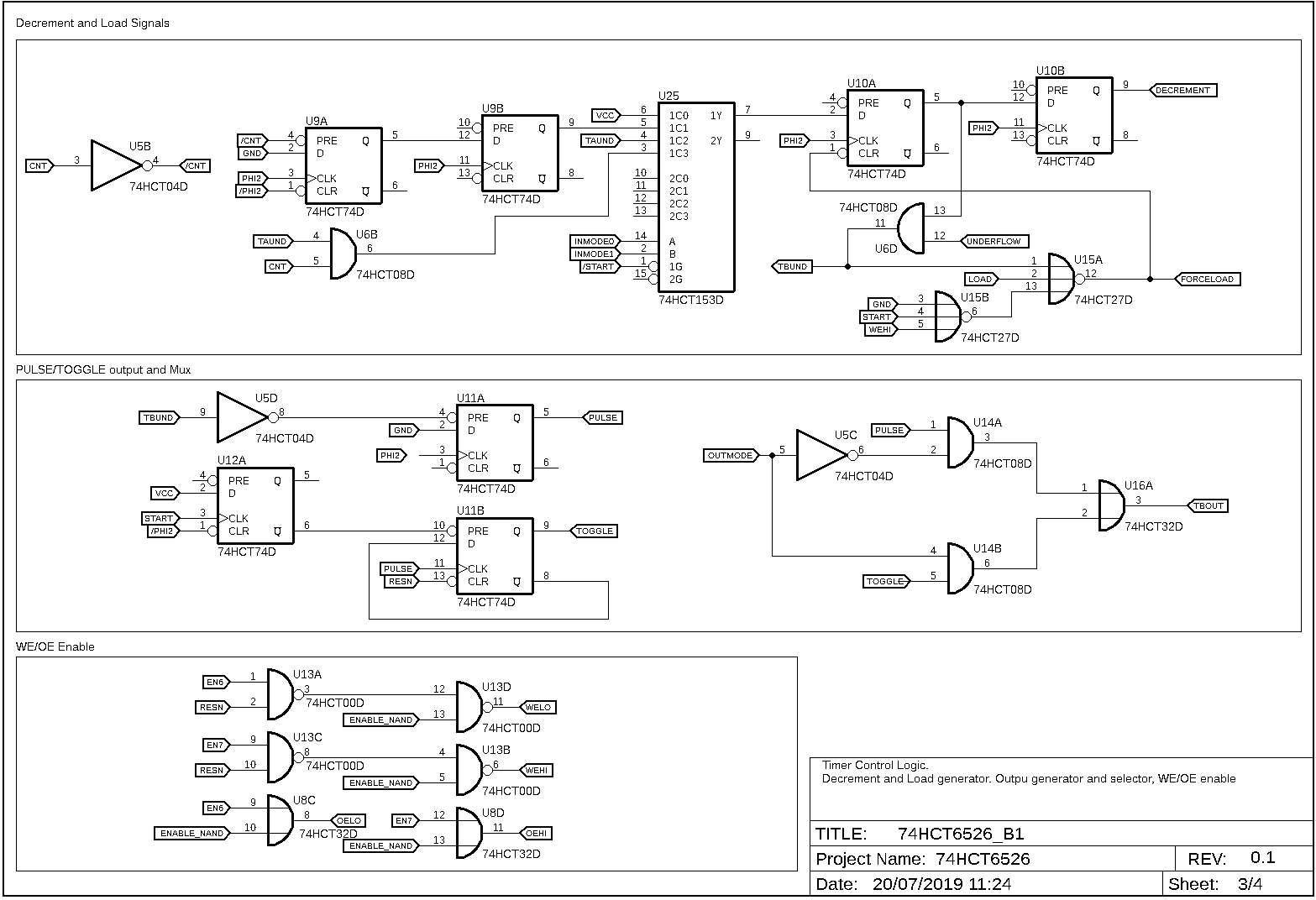

The first iteration of hardware implementation for CREG and TIMERS is ready. With a very busy board (29 ICs in the end), I'll have to make one board for CRA and TIMERA, another for CRB and TIMERB.
As I didn't create a backplane from the beginning, and my buses are already fixed, I can't use the same design for both timers. The differences will be small, but they will be two different designs in the end.
I have started with TIMERB as it is slightly more complex. to make TIMERB I just need to cut down some functions.
Control Register
Timer Control
Down Counter

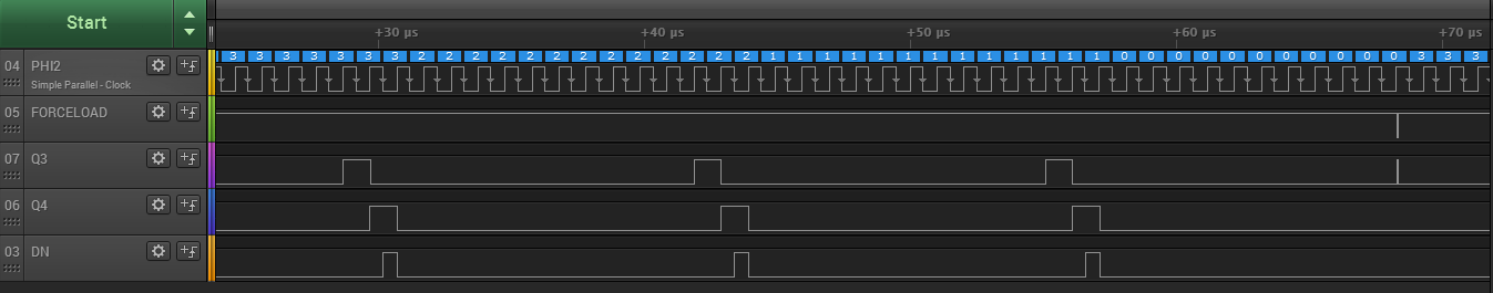

After spending the weekend working on the schematics, today I've built a small prototype. Just a 4 bit timer, and with a lot of stuff missing. It's just the timer, the input section (CNT, PHI2, all the delays) and the Forceload logic. Time to use my logic analyzer!
Counting CNT pulses (They were actually /IO2 pulses... but.... pulses anyway) As you can see, each time a pulse is sent, four cycles later the counter is decremented. When it reaches 0, then it's reloaded and goes back to the latched value (0011) in this case.
Q3, Q4 and DN are internal values... CNT pulses happens actually 2 cycles before Q3, but I just realized I missed it in the capture! :oops:

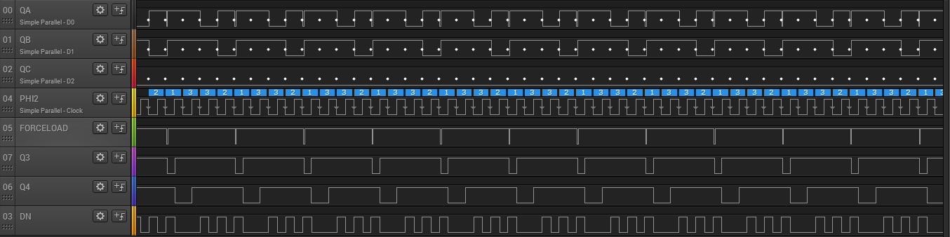

Counting PHI2 pulses, the counter is reloaded immediately when it reaches 0 (So we don't actually see the 0) and then, skips one cycle, repeating the first value.

Noticed, that pin 5 of U21..U24 (74HCT192 UP count) are not connected in your schematic.
You really should tie those pins to VCC to prevent timer B from acting strange by accident.
That's because 74HCT inputs have a high impedance, and they may see some "dirt" when left floating.
Switching a neon light in the same room most certainly would do for triggering a floating UP count pin.
IMHO CD4048 isn't a good choice for detecting timer underflow:
CD4048 propagation delay inputs to output at VCC=5V: 300ns typ., 600ns max.
CD4048 propagation delay expand input to outputs at VCC=5V: 190ns typ., 380ns max.
The UNDERFLOW signal generated by the two CD4048 goes through a 74HCT08 (17ns max.) and a 74HCT04 (17ns max.),
So the worst case propagation delay from counter B outputs to U11A 74HCT74 PULSE flipflop input is:
600ns + 380ns + 17ns + 17ns = 1014ns.
1MHz PHI2 means a 1000ns cycle time.
Would suggest to replace the two CD4048 by two 74HCT688 comparators:
74HCT688 propagation delay A,B to output at VCC=4.5V, CL=50pF, 25°C: 34ns max.
74HCT688 propagation delay /E to output at VCC=4.5V, CL=50pF, 25°C: 24ns max.
