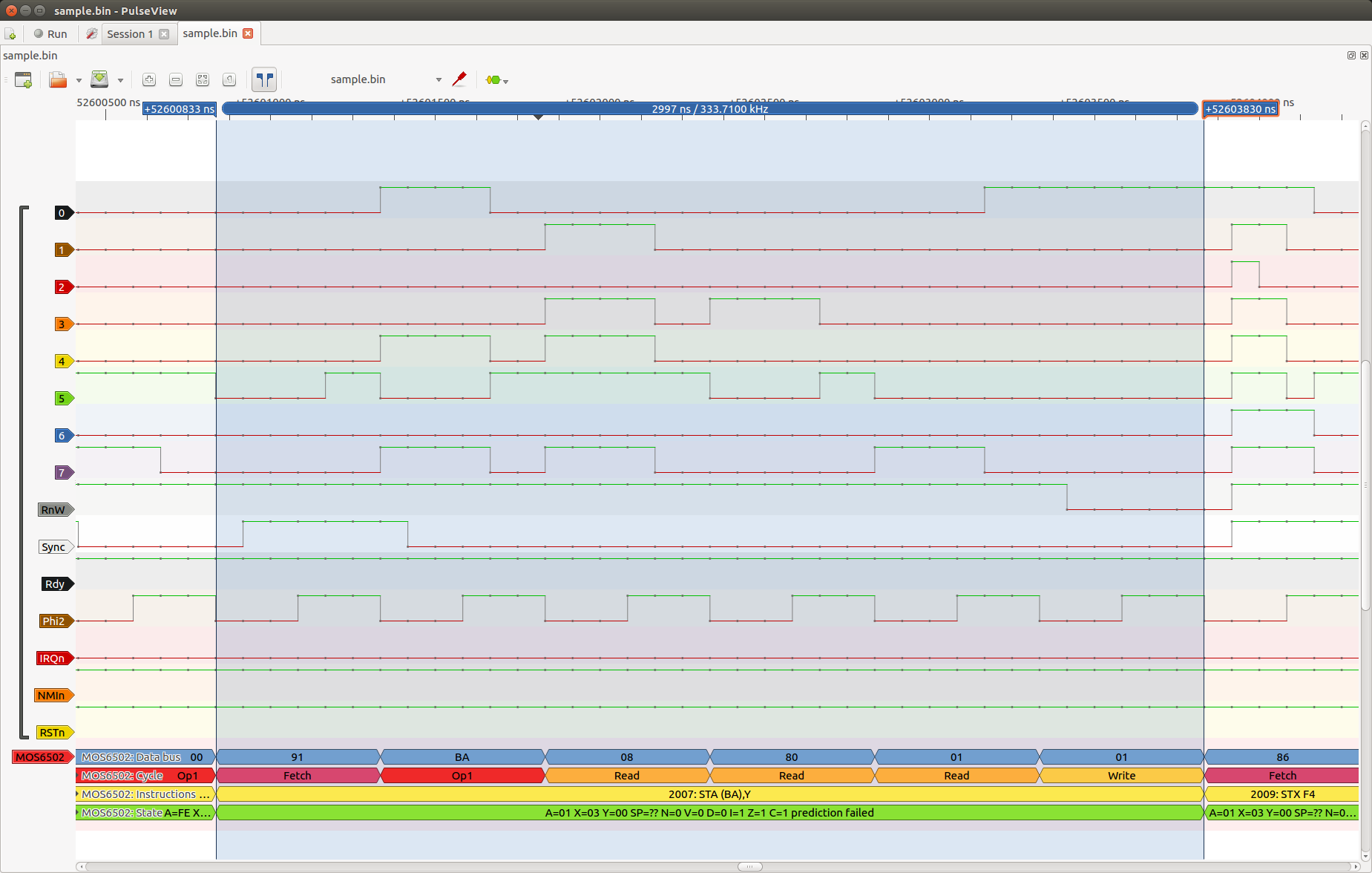

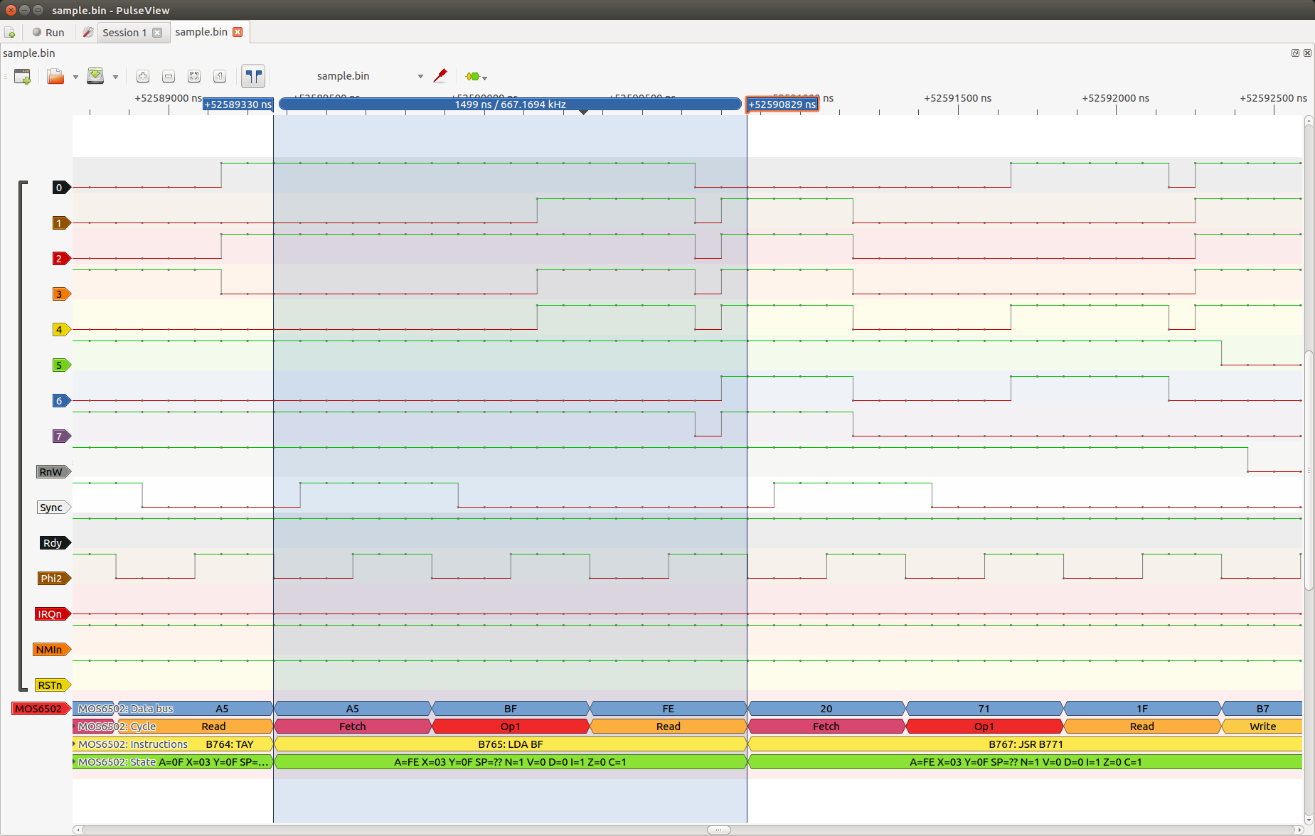

On the beeb (in all 4 captures), I'm seeing just one consistency check failure, trace is below.
This is actually very peculiar. It's the DFS code testing whether a particular ROM (Basic II in this case) is writable. It's read/inverting/writing/testing the byte at &8008 which is 01. The consistency check failure is when the STA tried to store &FE, what is actually seen in the write cycle on the bus is &01. All I can think of is there is a bus conflict happening here (maybe a bug in my modern sideways ROM board).
Here's the actual waveform of that STA:
And here's the preceding LDA:
Just to double check, I set a breakpoint use ICE-T65 and verified that A=&FE at this point (so it's just the store that is seemingly incorrect).
The other interesting thing is that sampling the Master at 8MHz is not 100% reliable, and you see good number of consistency check errors.

 DC0B: LDX F4        A=80 X=03 Y=0F SP=F1 N=0 V=0 D=0 I=1 Z=0 C=1
 DC0D: STY F4        A=80 X=03 Y=0F SP=F1 N=0 V=0 D=0 I=1 Z=0 C=1
 DC0F: STY FE30      A=80 X=03 Y=0F SP=F1 N=0 V=0 D=0 I=1 Z=0 C=1
 DC12: LDY #00       A=80 X=03 Y=00 SP=F1 N=0 V=0 D=0 I=1 Z=1 C=1
 DC14: LDA (F6),Y    A=01 X=03 Y=00 SP=F1 N=0 V=0 D=0 I=1 Z=0 C=1
 DC16: STX F4        A=01 X=03 Y=00 SP=F1 N=0 V=0 D=0 I=1 Z=0 C=1
 DC18: STX FE30      A=01 X=03 Y=00 SP=F1 N=0 V=0 D=0 I=1 Z=0 C=1
 DC1B: RTS           A=01 X=03 Y=00 SP=F3 N=0 V=0 D=0 I=1 Z=0 C=1
 B8AE: STA BD        A=01 X=03 Y=00 SP=F3 N=0 V=0 D=0 I=1 Z=0 C=1
 B8B0: PLA           A=0F X=03 Y=00 SP=F4 N=0 V=0 D=0 I=1 Z=0 C=1
 B8B1: PHA           A=0F X=03 Y=00 SP=F3 N=0 V=0 D=0 I=1 Z=0 C=1
 B8B2: TAY           A=0F X=03 Y=0F SP=F3 N=0 V=0 D=0 I=1 Z=0 C=1
 B8B3: LDA BD        A=01 X=03 Y=0F SP=F3 N=0 V=0 D=0 I=1 Z=0 C=1
 B8B5: EOR #FF       A=FE X=03 Y=0F SP=F3 N=1 V=0 D=0 I=1 Z=0 C=1
 B8B7: JSR B745      A=FE X=03 Y=0F SP=F1 N=1 V=0 D=0 I=1 Z=0 C=1
 B745: STA BF        A=FE X=03 Y=0F SP=F1 N=1 V=0 D=0 I=1 Z=0 C=1
irrelevant stuff deleted
 B765: LDA BF        A=FE X=03 Y=0F SP=EF N=1 V=0 D=0 I=1 Z=0 C=1
 B767: JSR B771      A=FE X=03 Y=0F SP=ED N=1 V=0 D=0 I=1 Z=0 C=1
 B771: JMP (00B0)    A=FE X=03 Y=0F SP=ED N=1 V=0 D=0 I=1 Z=0 C=1
 2000: STY F4        A=FE X=03 Y=0F SP=ED N=1 V=0 D=0 I=1 Z=0 C=1
 2002: STY FE30      A=FE X=03 Y=0F SP=ED N=1 V=0 D=0 I=1 Z=0 C=1
 2005: LDY #00       A=FE X=03 Y=00 SP=ED N=0 V=0 D=0 I=1 Z=1 C=1
 2007: STA (BA),Y    A=01 X=03 Y=00 SP=ED N=0 V=0 D=0 I=1 Z=1 C=1 prediction failed
PostPosted: Thu Nov 09, 2017 5:54 pm
Hmm - interesting! If you try to write to a ROM, is the ROM also driving the bus?
PostPosted: Thu Nov 09, 2017 6:32 pm
Posts: 352
I've just had a quick look at the Model B schematic and I don't see R/W being used in the generation of the ROM nOE or nCS signals. Oops....
PostPosted: Thu Nov 09, 2017 6:46 pm
