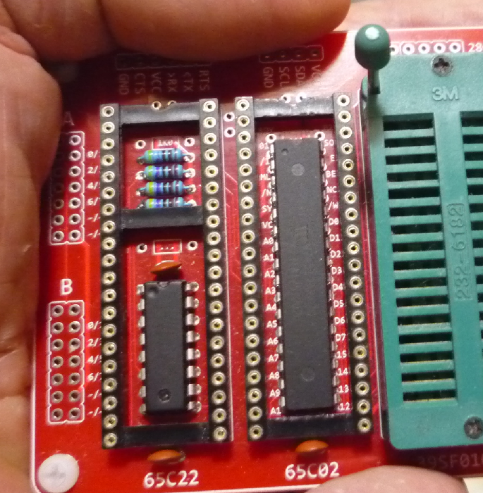

Prog65 is based on DIP 6502 using TTL logic so I'm curious whether it can be overclocked into mid-20MHz, specifically 25.175MHz which leads to the "locked room challenge" because at 25.175MHz 6502 can beam race VGA display with the help of a parallel-load 8-bit shift register, 74166, thus serves as a VGA monitor. Prog65 can bootstrap itself through the parallel interface to program a new flash so it may be possible to create dual-6502 standalone computer from scratch as stipulated in the "locked room challenge".
To run at 25.175MHz, I need fast RAM. My existing DIP RAM is 55nS and I need 20nS RAM which I do have but it is in 32pin SOJ package. First modification is to wire in the SOJ32 RAM instead of the DIP RAM. This is done at the back of the board using point-to-point wiring to minimize wire length. Pictures of the modified Prog65.
It works at the nominal 7.37MHz but intermittently crashed at 10MHz, so no hope of getting it to run at 25MHz without logic modifications. Prog65 has nice breadboard area for adding logic so the idea is to add one wait state for flash and I/O at $8000-$FFFF but keep RAM access ($0-$7FFF) at zero wait. Prog65 is an auto-routed 2-layer PC board so it is not clear how fast I can overclock it.

I was hoping to preserve the programmer mode of operation while adding a wait state to $8000-$FFFF, but it didn't work out with the limited TTL logic available on the original Prog65 board. I'm reluctant to add too many gates because it'll only slow down the overall operation. So I only bodge a 74ACT74 to add one wait state for accessing $8000-$FFFF where FT245 console I/O and flash memory are located. This is the old-fashion delay-RDY-by-one-clock approach, not the clock-stretch approach. Flash (SST39SF010) is rated at 70nS so with one wait state, the calculated max clock is 20MHz. With small mods, the flash socket can also accommodate 45nS W27C512 which is good to 33MHz.
My test program is the simple four-function monitor that loads file, execute file, display memory and modify memory. The monitor resides in flash from $F000 to $FFFF.
Good thing about FT245 is its communication is independence of CPU clock, so I can change 6502 clock arbitrarily without worrying about its effect on console communication.
Below is the modified Prog65 and associated schematic. I want to minimize the cut/jumper to existing design so the modification is not as efficient as starting with a brand new design.
The bottom line is the modified Prog65 can run to 24MHz with 70nS SST39SF010. This is because SST39SF040's access time is conservative allowing it to work at about 55nS. In fact, SST39SF010 partly worked at 25MHz, successfully display/modify memory and execute program at specified location, but the file load operation failed checksum check. Further investigation showed flash was not the bottle neck; using faster W27C512 I can run to 28.8MHz as verified by scope but I/O communication were gibberish. The bottle neck turned out to be FT245. The FT245 interface has several cascaded gates thus introducing significant timing skew. Perhaps 74AS27 may help; or perhaps I should have 2 wait states for flash and I/O.
At this point 25.175MHz operation is tantalizingly close. DIP 6502 and 2-layer PCB have not being limiting factors.
