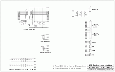

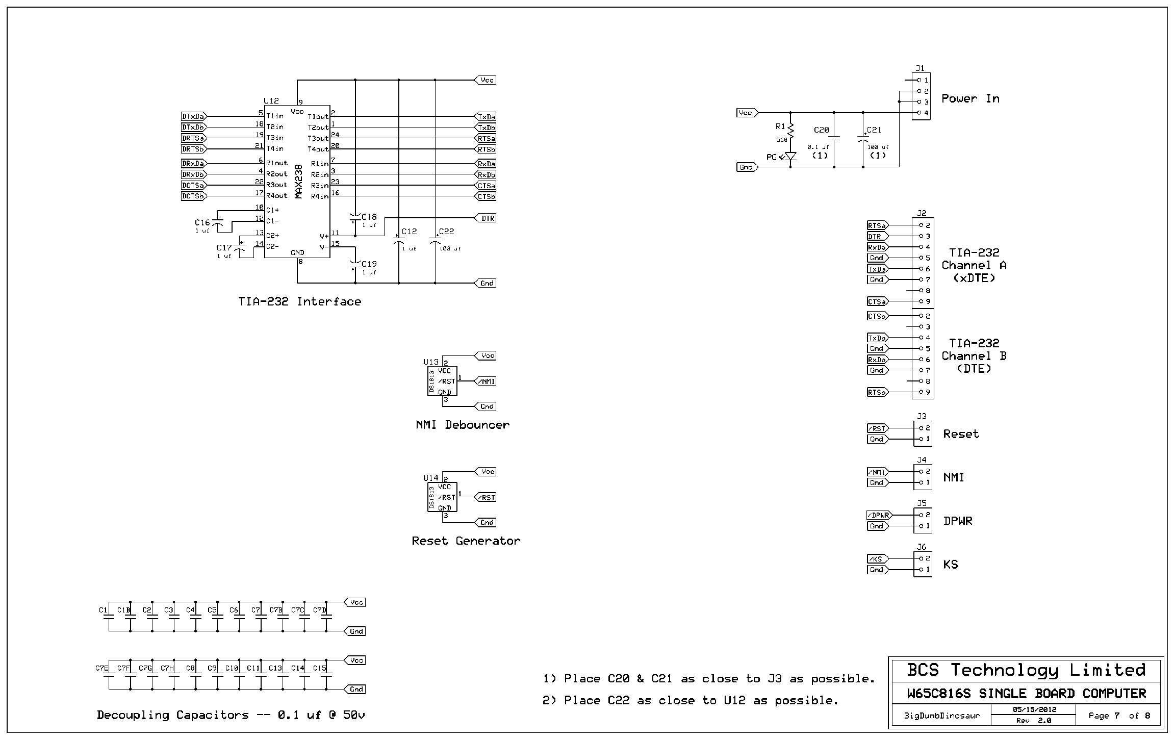

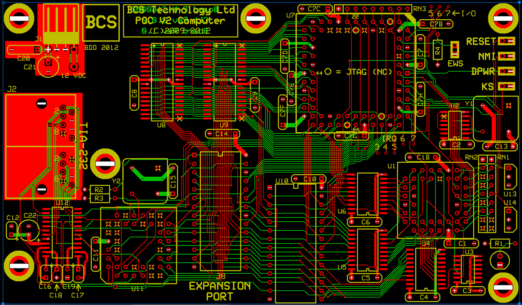

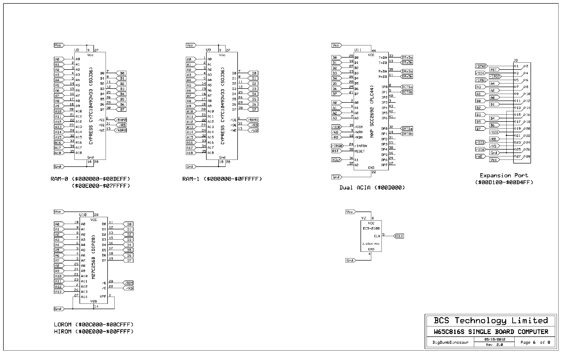

Balance of illustrations attached.
File comment: POC V2 Schematic Page 6 — RAM, ROM & I/O
File comment: POC V2 Schematic Page 7 — External Interface
File comment: POC V2 Printed Circuit Board Layout

 Post subject: Re: POC Version 2
PostPosted: Thu Jul 19, 2012 7:54 pm
Did you use export the image using 300 pixels per inch? Nice detail!

"...squinting at the schematics?" Are they too small? I can upload larger versions if you think it would help.

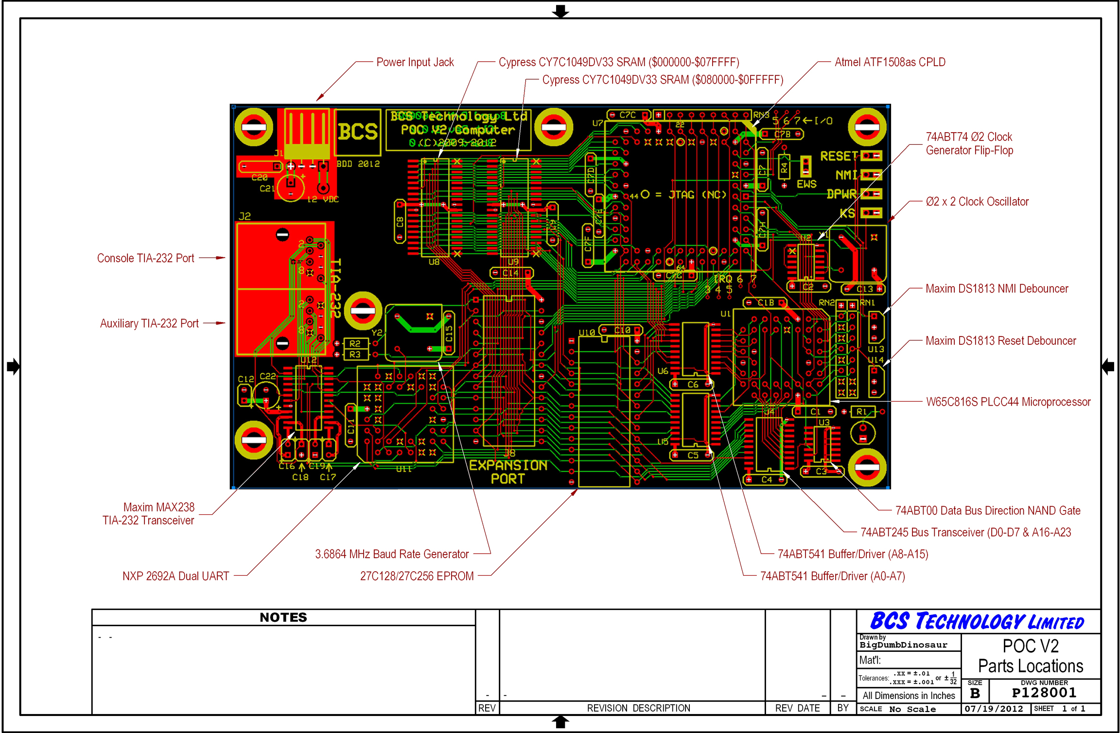

Anyhow, attached is an illustration of the PCB with ICs and some other parts called out. Eventually I will finish the BOM and add it to the schematic pages.
Thanks! I used 300 to generate the raw JPEG and then reduced it to 144 with progressive scan to make the file smaller and appear to load faster.

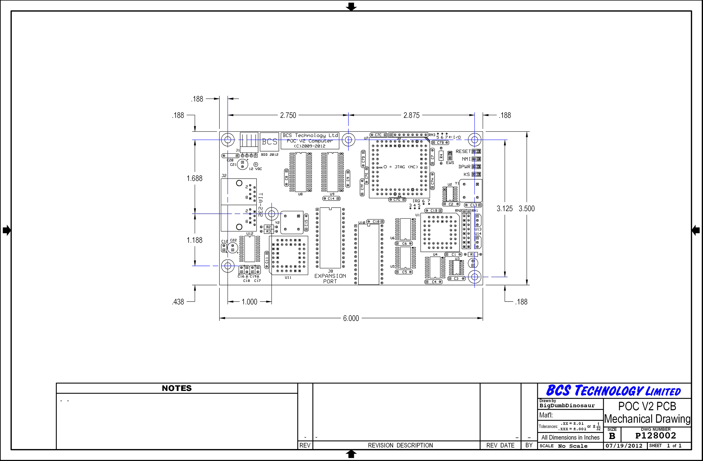

EDIT: Added a second illustration of the PCB with mechanical dimensions.
File comment: POC V2 PCB w/Major Parts Locations
File comment: POC V2 PCB Mechanical Dimensions
PostPosted: Thu Jul 19, 2012 9:14 pm
Posts: 10938
Thanks - that's very nice, even more informative than a BOM in some respects.
Can you say something about the 28-pin DIP expansion port?
PostPosted: Thu Jul 19, 2012 11:47 pm
Posts: 8389
The "expansion port" is actually the socket that the watchdog timer (WDT) plugged into in POC V1. When I decided to cobble together a SCSI host adapter, I patched POC V1 to bring the additional signals needed to the WDT socket so I could piggyback the host adapter to the existing board. Later on, I added more signals to take care of the 53C94 SCSI controller's DMA functions, necessitating that I build an updated version of POC V1 with all patches incorporated into the unit. This led to me deciding to change the WDT's socket to "expansion port," although it doesn't have enough pins to carry all needed signals to act as a true expansion port.
POC V2 is going to have IRQ priority capabilities, so each device capable of interrupting the MPU will do so on its own line, and the CPLD will, in turn, pull the MPU's IRQB input if the interrupting source has been enabled. Hence the expansion port has been augmented to provide the WDT and 53C94 with independent IRQ lines. The expansion port signals are as follows:
A0-A4   Buffered address bus.
D0-D7   Buffered data bus.
/DPWR   WDT power supply control output (currently unused).
/IO1    WDT chip select ($00D100).
/IO2    53C94 SCSI PIO chip select ($00D200).
/IO3    53C94 SCSI DMA FIFO enable ($00D300).
/IO4    53C94 SCSI DMA acknowledge ($00D400).
/IRQ1   WDT IRQ output.
/IRQ2   53C94 IRQ output.
/KS     WDT power supply control input (currently unused).
/RD     Read data, inverted MPU RWB output qualified by Ø2.
RST     Active high reset to 53C94.
/WD     Write data, MPU RWB output qualified by Ø2 & HMU write-protect logic.
With the above signals, plus Vcc and ground, all 28 socket pins are spoken for. I've toyed with the idea of using a 32 pin socket, but think I'm pushing things as it is. :lol: The host adapter effectively takes the buses off-board, and while the 74ABT buffers can drive pretty hard, I'm not sure just what I'm faced with at this point with distributed capacitance.
