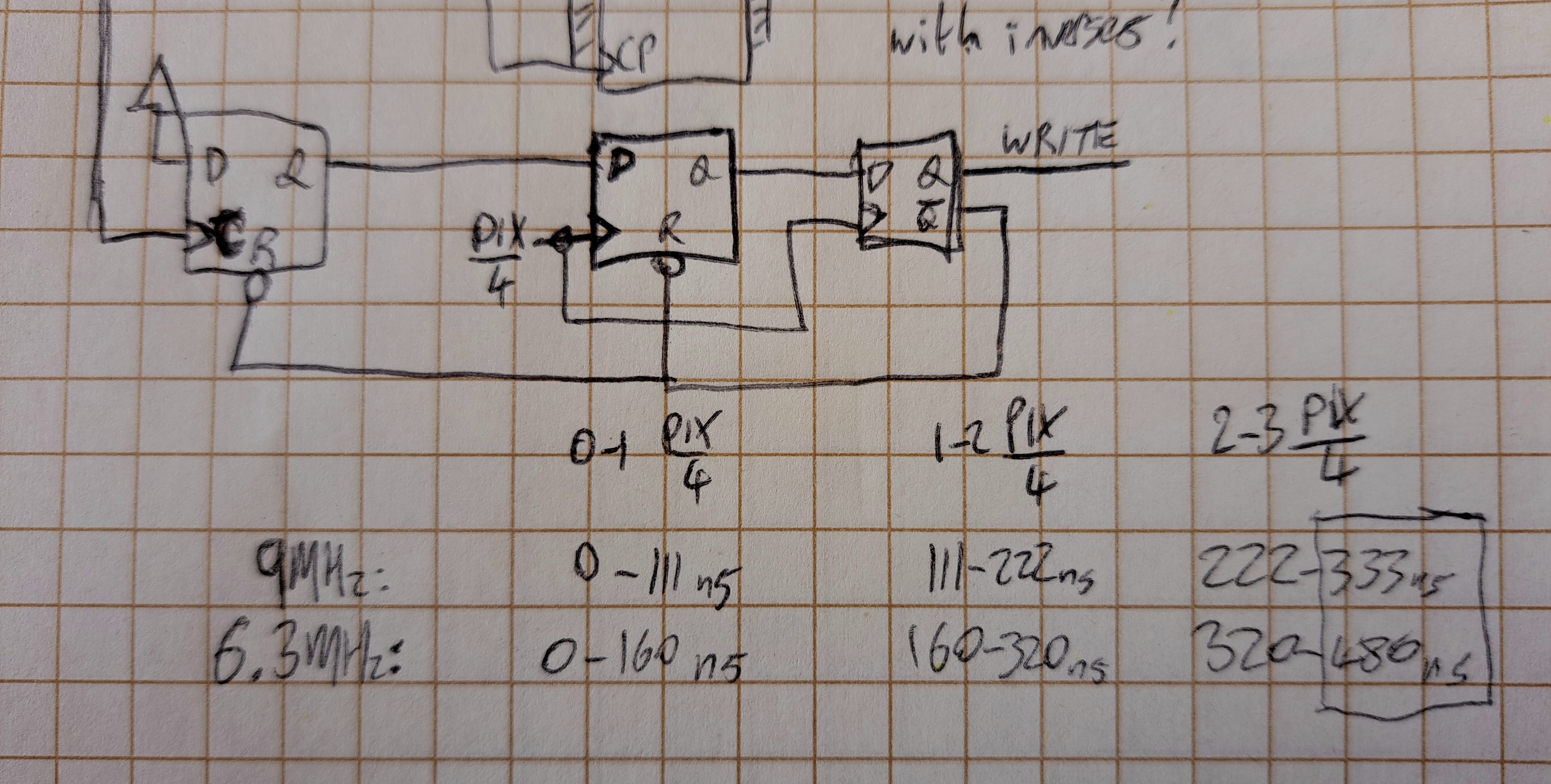

My first sketch for how this could work was disappointing. I envisaged the CPU latching data into an 8-bit D flipflop register, and setting a flag in another D flipflop to say that data was available. That's all synchronous to the CPU's clock. Then the video circuit needs to notice this has happened, and consume the data at the right time during its own clock cycle. It could use another D flipflop to sample the state of the first one, but in time with its own clock. Then if it's set, there is data pending. However, there is a chance of metastability in this flipflop, and it would be prudent to add a second similar flipflop to protect against that. The inverted output of the second flipflop can then be used to reset both of the other two, so that its own output is asserted for just one cycle of the video clock:
In this diagram the signal on the left has a rising edge when PHI2 falls with the right address on the bus - it's also used to clock the data flipflop. WRITE indicates to the video circuit that a write operation is pending. PIX/4 represents the pixel clock divided by 4 - this is just how this worked in the last video circuit I made, you can just think of it as being the video clock.
The trouble with this is the amount of latency, leading to poor throughput. I put some numbers under the diagram based on PIX/4 being 9MHz (SVGA resolution) or 6.3MHz (VGA resolution). The centre flipflop will trigger 0-1 video clocks after the left flipflop gets set, and the rightmost flipflop will trigger 1 video clock later than that. The video circuit itself then likely needs another video clock cycle before it has completely finished with the data that was latched. In all we need 2-3 video clock cycles to consume the data, which could be nearly half a microsecond.
During this time, the CPU can't send any more data. Worse, when this time expires, it will take the same amount of time again for the next byte of data to arrive. So the throughput is limited to around 2MHz, whereas a 6MHz or 9MHz video system ought to be able to receive data at three or four times that rate. I would prefer it if the video system was the limiting factor.
It is possible to reduce the time by cutting some corners - the centre flipflop could be clocked on the inverse of PIX/4, for example, so that half a cycle is saved between it and the rightmost flipflop. I feel like the more you cut this time, though, the higher the risk of metastability in the rightmost flipflop. It'd also be possible for the video circuit to latch the data byte, perhaps in parallel with the flag, but that would again need two layers of latching to avoid metastability issues, leading to a lot of ICs.

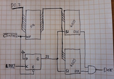

I believe the fastest rate that a 6502 can reasonably write data to an I/O port is once per three clock cycles, if the port is in page zero - any such write operation requires at least an instruction opcode, a target address, and the data byte itself. So if it were to exceed the capability of the 40105 (15MHz write rate) it would need a clock speed of 45MHz or more - and that's almost certainly beyond the CPU's capabilities. Overall I think this means that the 40105 is indeed fast enough for this purpose.

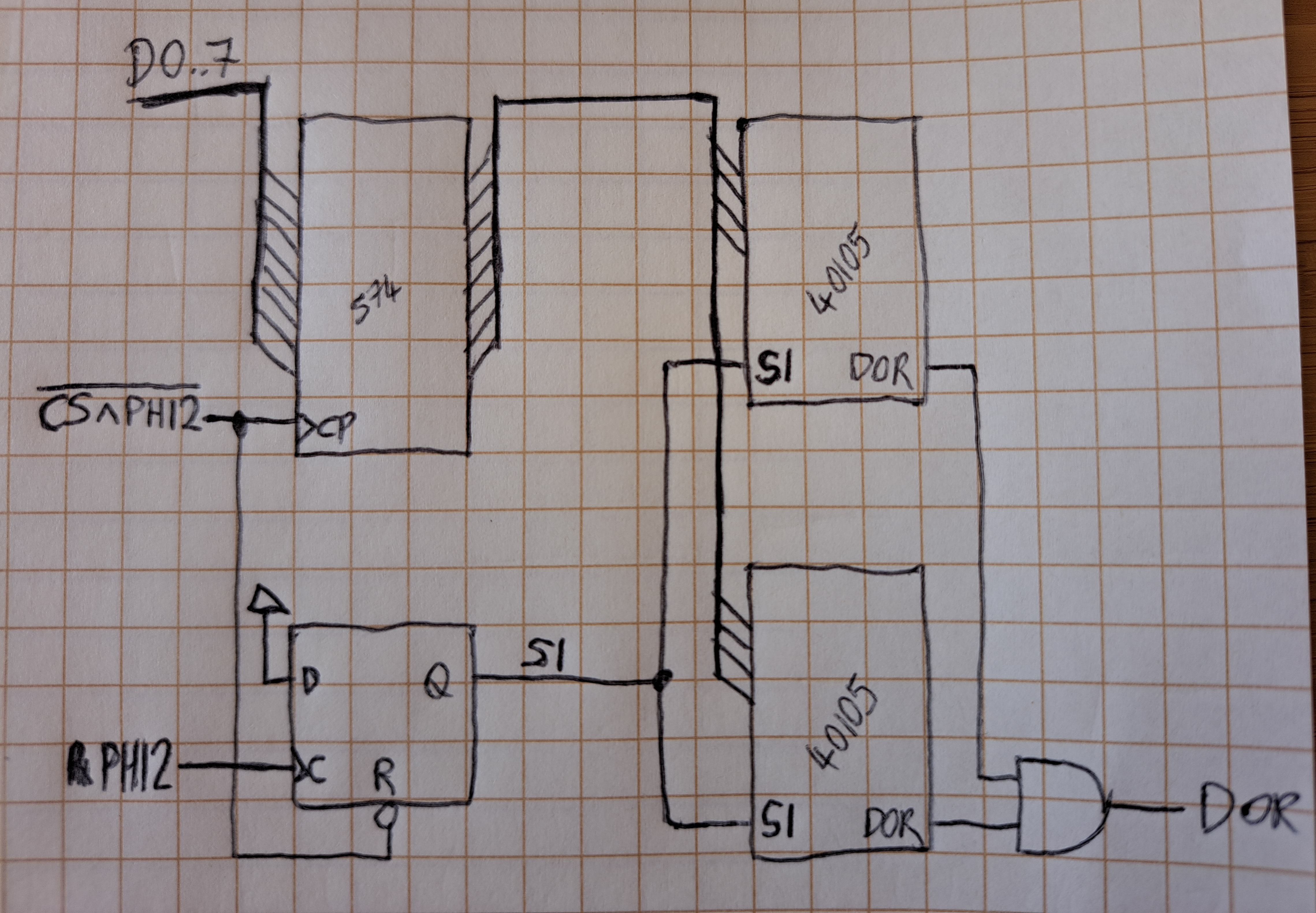

The circuit would look something like this:
The flipflop is asynchronously reset by the qualified write signal ("CS^PHI2") and then is set again by the rising edge of PHI2. Its output forms the SI signal, stretched out to the next clock cycle. The data register is either latched during CS^PHI2 or synchronously clocked in on the rising edge of that signal, it doesn't matter which.
I showed 8 bits of data there, it is possible I'd add another 4 or 8 bits from the address bus though to provide more context to the operation, for example control lines to select a type of operation to perform, or some form of address offset within the video memory. I would like to keep the interface relatively narrow though, I'm tired of wiring 20-bit address buses to video circuits!

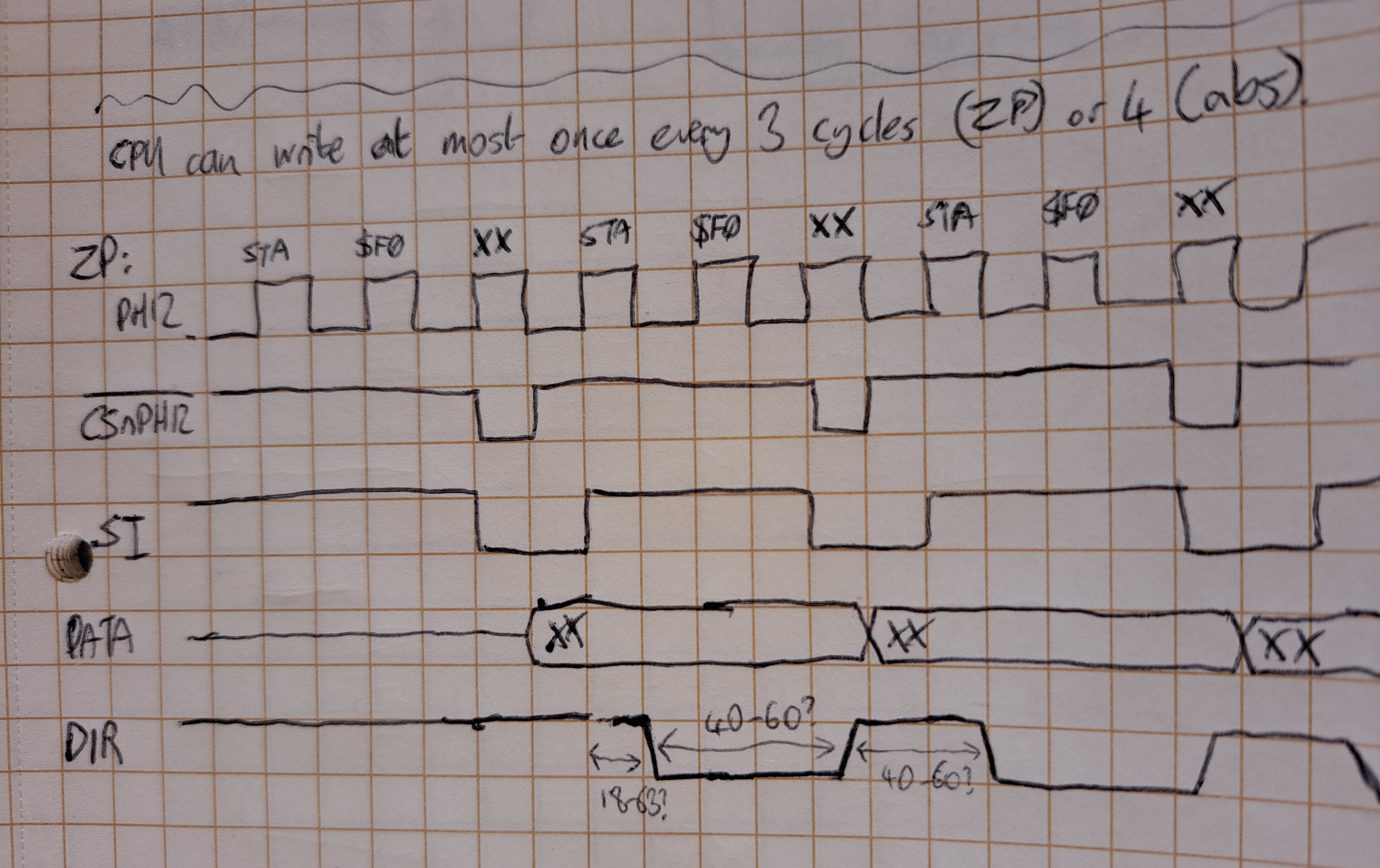

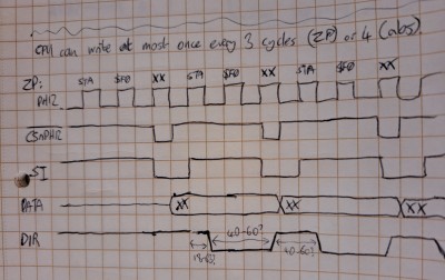

And here's a timing diagram I drew, based on the unlikely case that the I/O port is indeed in page zero and we're writing a continuous stream of constant data with an unrolled loop:
Note that SI won't rise until half a clock cycle after the data is latched, plenty of time for the data register to be stable, and the data register will hold this value for at least two clock cycles, meeting the required 38ns hold time. The gap between rising edges on SI is at least three clock cycles, and SI's pulse width is at least one clock cycle.
The only thing I didn't really consider here is the output end of the device. It has similar characteristics to the input end, as far as I can see, and as such I suspect it would be able to support around 15MHz read rate - which is plenty for my existing video circuits, which would only be able to process data once every four pixels. So I'm not to worried there. Of course if the video circuit is slow to read the data then the CPU would also need to slow down sending the data, either through knowledge of the video circuit's ability, or by having a means to tell when the FIFO is full - or maybe through CPU clock stretching to automatically rate-limit it, but I'd like to avoid that. In practice I think this is unlikely to be a major problem, and it's not caused by the FIFO itself, it's just the limit of the video circuit's speed.

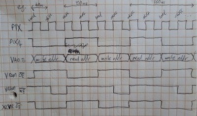

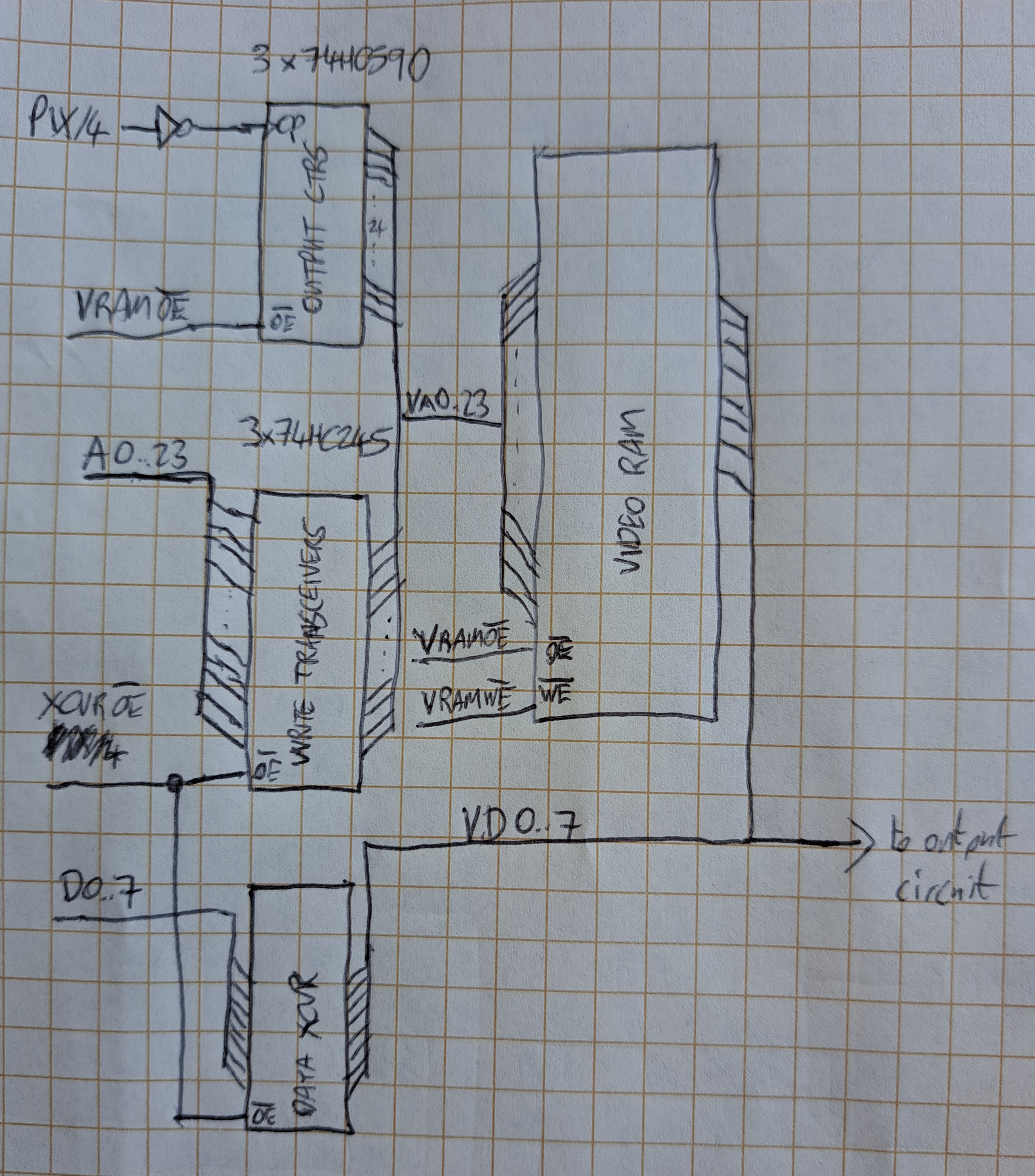

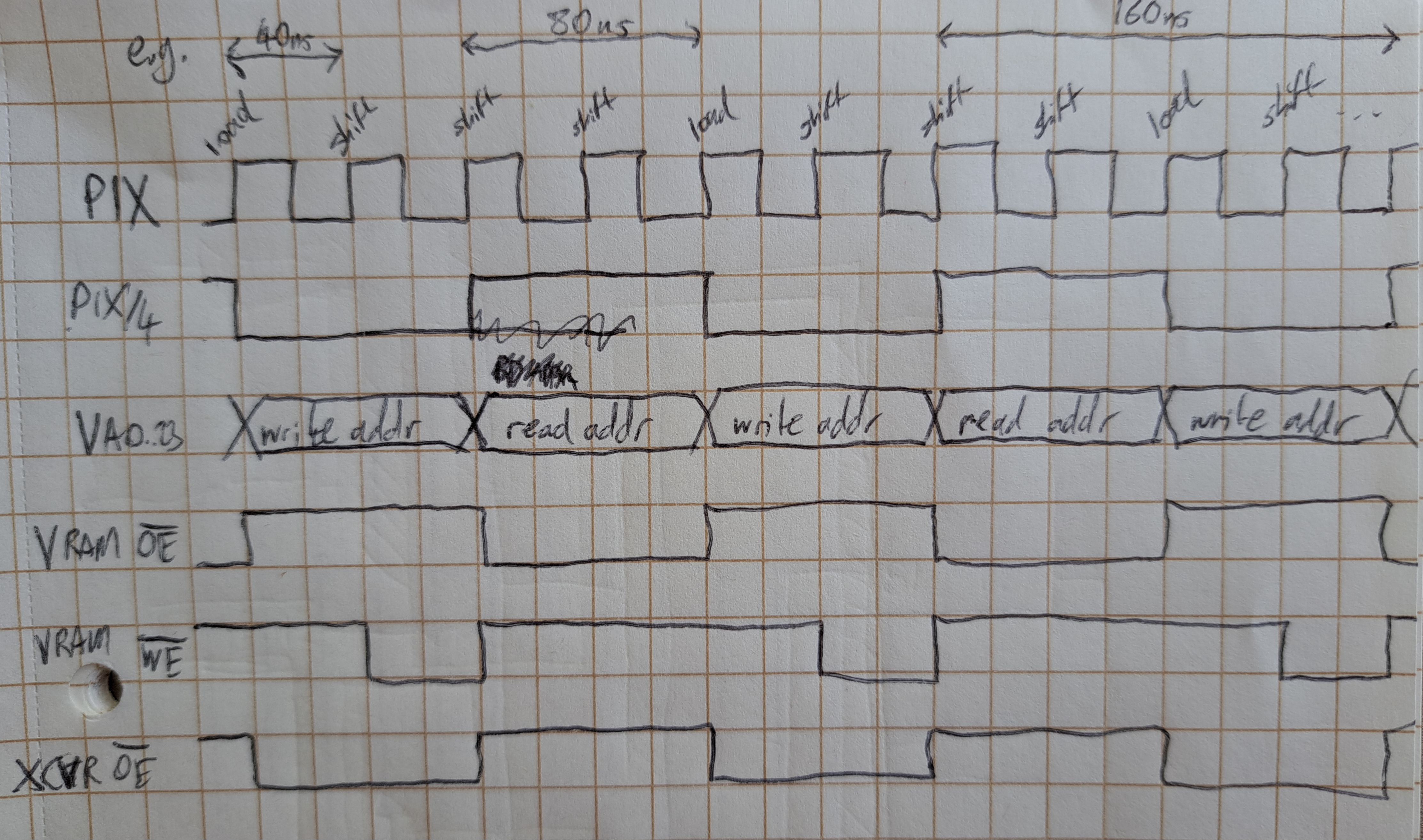

My video circuits typically look something like this - this is based on my most recent one, but may not exactly match the schematics as I drew it from memory:
At the top left is an array of tristate counters that scan through the video memory to generate the output signal. The video address bus that they feed is also driven by an array of bus transceivers, passing addresses through from the CPU. There's another bus transceiver to pass the CPU's data bus through to the video data bus during write operations, and the video address and data buses also of course go to some video RAM, with the video data bus also going out to some output circuitry that separates pixels from the bytes of data, decodes colours, etc. I tend to output four pixels per byte, and put multiple RAM chips in parallel to get more width on the video data bus to increase the number of colours.
The video RAM has /VRAMOE and /VRAMWE signals, the counters have a /OE signal that's linked to the VRAM's, and the transceivers also have a /XCVROE signal. These used to be generated by separate logic parts, but I moved them to a simple PLD when upgrading to SVGA resolution.
The timings of the signals work like this:
PIX is the pixel clock (e.g. 25.175MHz, or 36MHz for SVGA) and PIX/4 is that clock divided by four, as my system mostly processes four pixels at a time. As shown the video address bus is driven with read addresses half of the time, and the other half of the time it may contain write addresses - I didn't show it, but this only happens if a write is actually in progress. /VRAMOE allows the counters to output their address to the video address bus, and during write operations /XCVROE allows the transceivers to drive the video buses.
/VRAMOE also allows the video RAM to output to the video data bus for the output circuitry to latch and process over the course of this cycle, and /VRAMWE is activated for a small portion of the cycle during write operations, after a period to allow the video address bus to stabilise with the write address.
These signals are mostly just inverted or shifted versions of the PIX/4 clock signal, and they tend to require a bit of fine tuning to make the circuit stable, given propagation delays etc. The signals that are only active during write operations are also gated with some address decoding from the CPU side, and this decision is made in this diagram on the falling edge of PIX/4, just in time for the write cycle - this corresponds with PHI2 rising in my existing system.

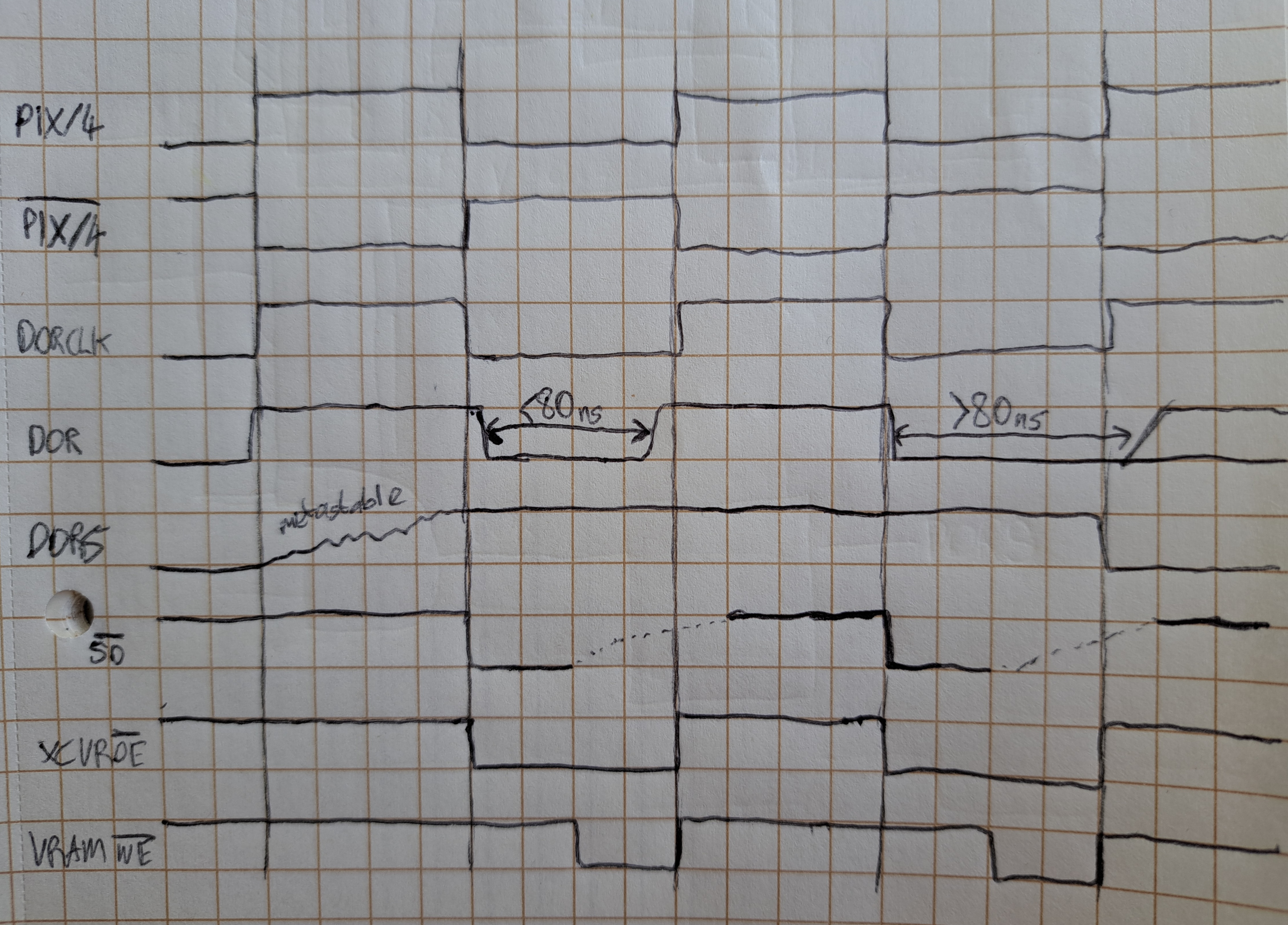

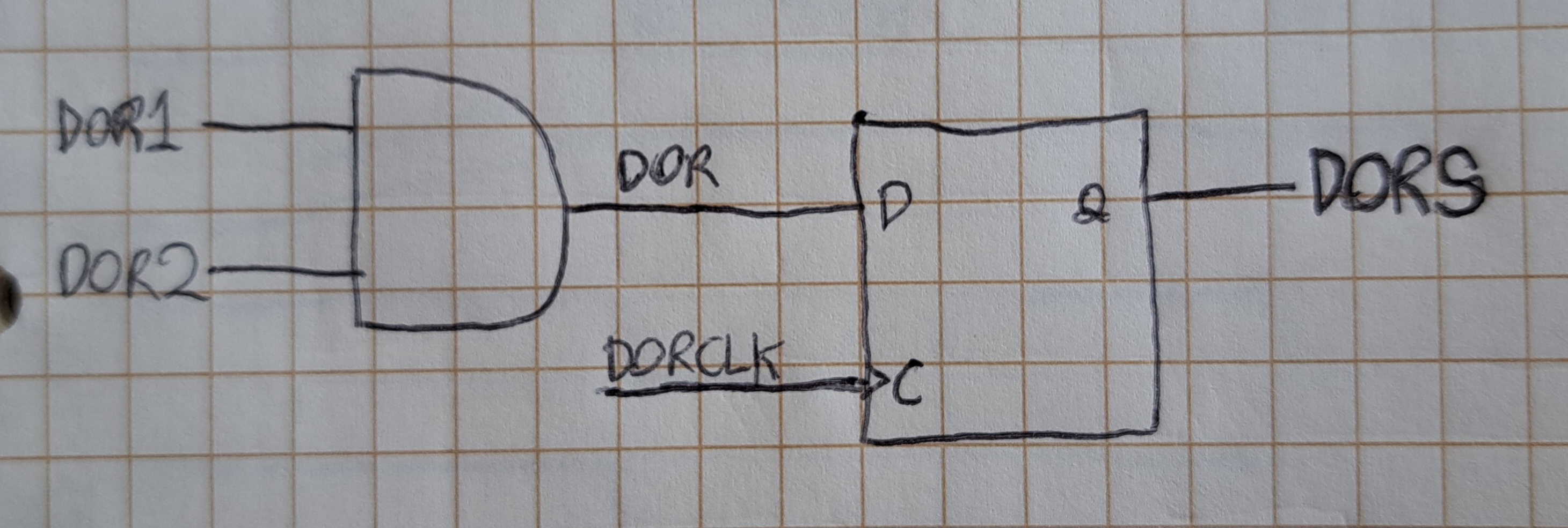

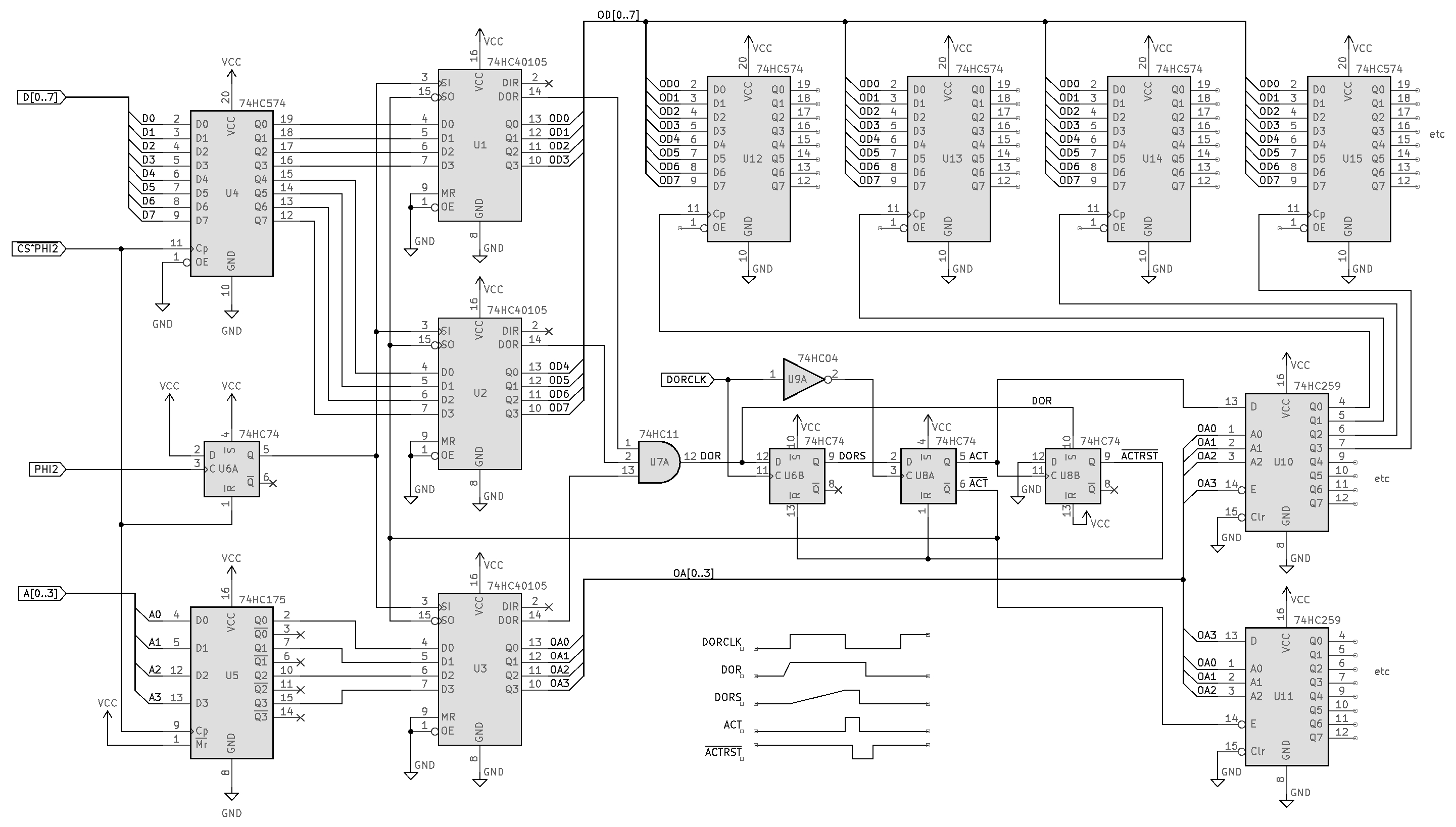

For the asynchronous version, that decision needs to be based on whether the FIFO has data or not. The 40105 provides DOR ("data-out ready") that is driven high when data is available, and /SO ("shift-out") that causes the data to be removed from the FIFO on its falling edge. But I can't just use DOR directly to drive whether the write signals are active on a particular cycle, because its changes are not synchronised to the video clock - it could change at around the same time as the video clock and violate the setup or hold requirements of the filpflops. So it will be necessary to buffer it through a flipflop to guard a bit against metastability:
Here we AND together the DOR signals from two 4-bit FIFOs, so that we only react when both are ready, and gate it with a clock signal that needs to rise at an appropriate time. DORS is a "synchronised" version of DOR that can drive the rest of the circuit.
DORCLK could be driven by the rising edge of PIX/4, giving two pixels' worth of time for any metastability to sort itself out before the DORS output is used - that's about 80ns at VGA resolution, or 55ns at SVGA resolution. Here's what that might look like, including the rest of the derived signals:
/SO needs to go low as soon as we decide we're consuming the data, as it's on the critical timing path - it causes DOR to then go low, and if there's another word of data waiting it could take DOR 60ns to go high again according to the worst case figures in the datasheet. We should hold /SO low for at least 30ns, but the exact timing of when it rises again isn't important and I didn't show it.
So long as DOR does turn itself around within two pixels' time, then if there's data in the FIFO, the video circuit can process another write operation on the very next cycle. This is much better than the best case in my current system, due to the increased possible CPU speed with this new system. The typical stats in the datasheet are easily good enough to do this in SVGA resolution, though the worst case stats are not; in that case, the next word just wouldn't be processed until the cycle afterwards.
As we are asserting /SO right at the start of the write cycle, we need to latch the data from the FIFO at that point, as it's going to change it - so a further 8-bit (or more) register is needed for that. This is adding back some of the complexity I thought the FIFO would save, but I think it's still efficient and beneficial to use the FIFO here.

As far as a generic system goes, here is a fairly complete (but untested) overall circuit design, supporting asynchronous writes to up to 16 8-bit registers (four of which are shown) which are then guaranteed to change in sync with a remote clock signal:
In practise for video I probably won't use as many registers, and will probably have some non-register things driven by it instead; the requirements are going to be similar enough to the registers' requirements, though, that they're a good stand-in for now.
The address decoding for CS^PHI2 on the left hand side could be anything based on A15-A4. It doesn't matter if it overlaps with something else, so long as that other thing doesn't mind being written to - I will probably overlap it with RAM, either losing 16 bytes of page zero, or somewhere else in the memory map.
U4, U5, U6 are used to latch the data bus for a while due to the 40105's fairly long setup requirements. SI would rise around the falling edge of PHI2, and the 6502 will change the address bus well before the hold time is satisfied. You could perhaps find some other way to generate SI earlier and avoid needing to latch the data and address.
The purpose of the three flipflops to the right of the centre of the diagram is to resynchronize the asynchronous DOR signal with the local clock (DORCLK), generating a short pulse on ACT that's in sync with DORCLK. This then drives two 74HC259s acting as active-high decoders, and their outputs provide clock pulses to the various registers to store the data that was sent. The timing diagram shows an example of DOR changing at an awkward moment leading to metastability in DORS, but which is resolved by the time ACT is triggered. Longer periods of metastability would still cause problems of course.
ACTRST is used to end the ACT pulse fairly quickly; it also stays asserted until DOR finally goes low again, which could take a while (e.g. 60ns? I still don't understand what the datasheet is saying). This may prevent ACT triggering a second time, but really DORCLK needs to be slow enough that DOR will reset in time (e.g. <10MHz).
It would be possible to AND together the DIR signals and feed that back to the CPU to allow it to poll ahead of writing data, or use it to cause clock stretching if a write is performed when there's no space, but I don't think I'm going to need this functionality.

Was studying your diagram for a bit now George, I think I'm understanding it now. Those 74HC40105's are the FIFO's, which capture both data and address data. Didn't know what even existed!

I'm wondering why you couldn't just directly connect those '40105s to the RAM, with some glue logic of course. You can only shove 8-bits at this thing at a time, so perhaps something like: Write Low Addr, Write High Addr, Write Color Data which could tell the RAM to finally actually look at the FIFO's. This would require a lot of those FIFO chips, but it would not require those 8-bit registers anymore. Just thinking out loud.
Another factor is the width of data I'd need to pass - let's say about 20 address lines and 8 data lines are needed to write a byte into video memory. We can put enough FIFOs in parallel to hold all of that, but then we also need to feed that breadth of data at the input end, and the 6502 can't supply it all at once - so we'd still need some registers at the 6502 end to hold some of the data, and I thought we might as well just put them at the output end instead.
For a first pass I'm going to just use this to set up a video address in registers, then pass some data, and have that written to the selected address. One option is to pass all these bytes in sequence - e.g. three address bytes followed by a data byte - and have the receiving circuit read each in turn; but most of the bytes don't need to change between write operations, as you're usually writing to a similar location to the last one that was written, so it makes more sense to use the address bits to select what the data represents. Maybe the code then looks like this:
