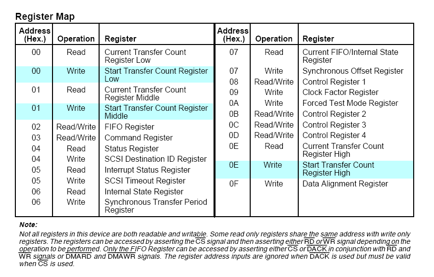

[...] The count is set in two contiguous registers that are in big-endian order.
My plan was to load the (16 bit) accumulator with the 16-bit byte count, do an XBA to reverse endianess and then write the result to the CF94. The MSB would be written to the MSB register and on the next Ø2 cycle, the LSB would be written to the LSB register. Seems foolproof, eh?
BDD, I understand this is a low-priority problem, one which you rightly back-burnered in favor of more important issues. But are those "two contiguous registers" indeed in Big-Endian order?
I gather the Count register is actually 24 bit, with the 3 bytes appearing at (in order of increasing significance) Addresses $00, $01 and $0E. Would I be correct in concluding it's $00 and $01 to which you're writing with a single instruction? I'd say the relation between those two is Little-Endian, given that the less-significant byte is stored at the lower address.
Am I missing something? I tend to suspect your XBA is what created the problem. (I know, I know... premature optimization is tough to resist! :oops: )

BDD, I understand this is a low-priority problem, one which you rightly back-burnered in favor of more important issues. But are those "two contiguous registers" indeed in Big-Endian order?...
Reading your reply had me go digging back through the code I was testing way back when (in 2012, to be more precise). My recollection was imperfect, but then that is why you put comments in your source files. :P
My code was treating those registers as being in little-endian order and my mention of the XBA instruction was erroneous. So the 16-bit write to registers $00 and $01 should have worked. I left a terse comment in the SCSI driver source code about the problem to remind me why the count setup was being done a byte at a time.
Correct on all counts (sorry—couldn't resist that). Register $0E was reserved in the older 53C90 and 53C94 controllers, which could only do 64KB transfers. That register defaults to $00 in the 53CF94 to maintain compatibility if not touched. I don't use it because I can never transfer more than 64KB with the present POC hardware. When I finally build a unit with extended RAM...who knows?
