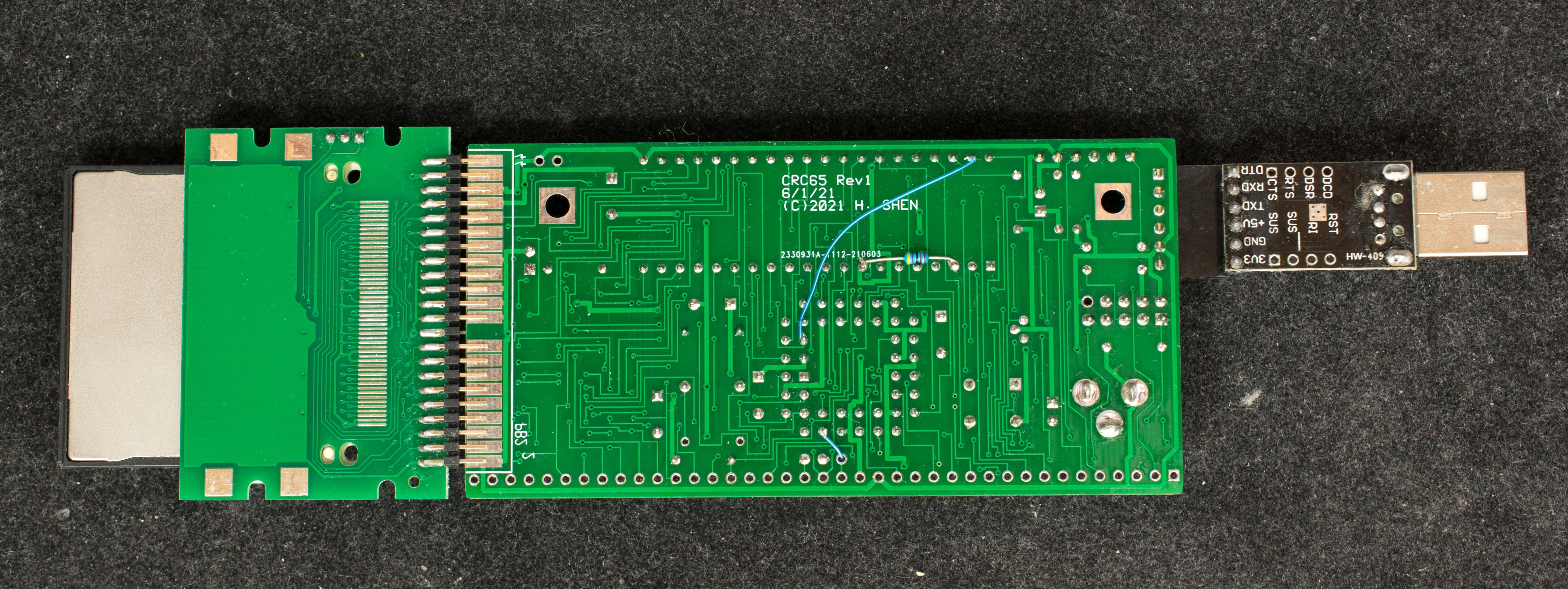

Now I've had a little experience with W65C816, it occurred to me that the existing CRC65 can be modified slightly to host a W65C816:
1. CRC65 has 128K RAM, but only 64K is used. A16 is currently tied to VCC. I can cut the trace to VCC and connect the latched data 0 to A16 resulting in 128K of RAM.
2. I remember the discussion about VDA & VPA where access to I/O needs to be qualified with VDA. So 65816's VDA output needs to be a part of the serial port decoding logic.
3. CRC65 CPLD has two pins that currently are allocated to I2C's SDA and SCL signals. I'll reassign these two pins as VDA and A16.
4. Pin 3 of CPU is unconnected currently. In W65C816 it is ABORT input, so it needs to be pulled up with a resistor.
I think that's all I need to change. Have I missed anything else?

The pin that used to be SOB (an input) will, on '816, become MX (an output). But I see you're driving SOB with nothing stronger than a pullup, so you're in the clear there.
Hmmm, would you prefer to avoid reassigning CPLD pins? I don't have an easy answer for A16, but VDA is a signal you can consider simply ignoring. VDA does make for a nice, care-free coding environment, and for some folks that's that's a valuable consideration. But if, for you, conserving CPLD pins is more important, then fine -- adopting a few simple coding precautions will be sufficient protect you from the 816's dead-cycle behavior (which, after all, is no worse than that of the NMOS 6502). Both choices* are valid, IMO (I mean using VDA as opposed to exercising caution with your coding).

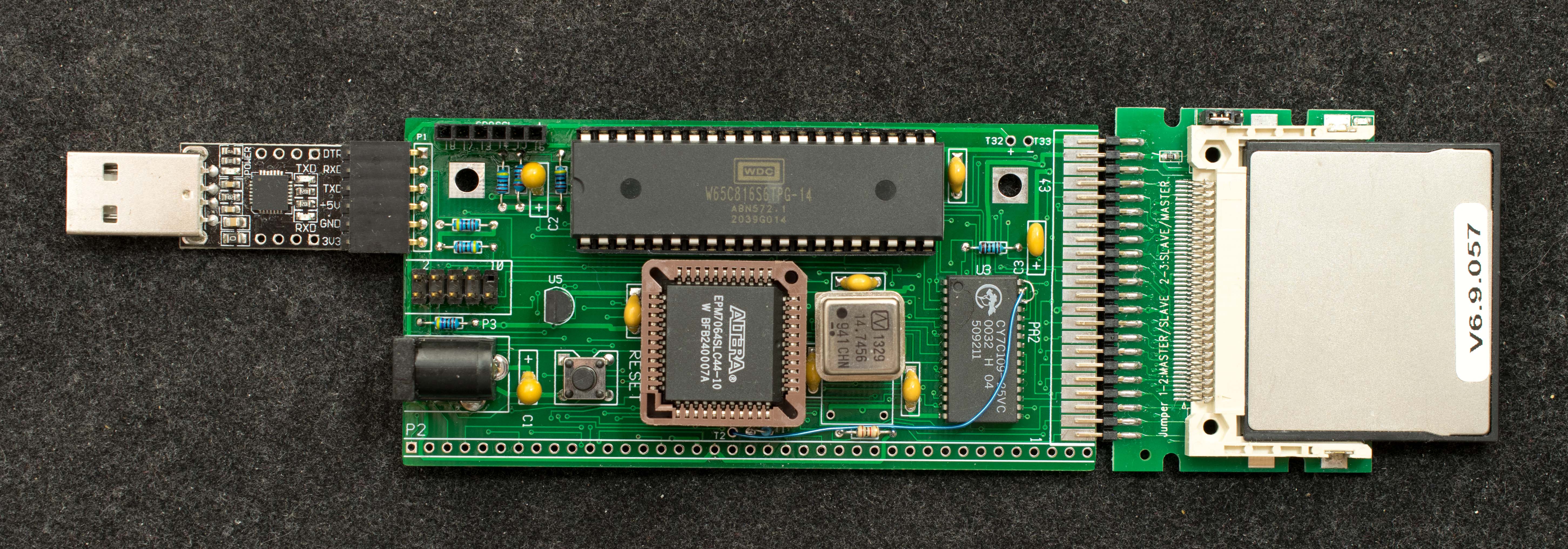

Because I need to cut traces underneath SMT RAM, I built up a new board for CRC816. The required modifications are minor and I'm able to run W65C816 in emulation mode passing memory diagnostic and run mandelbrot benchmark in EHBasic.
This will be a good platform for me to learn W65C816 in native mode.

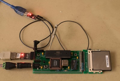

The discussion about "strange W65C816 outputs" give me an opportunity to explore 65816 using CRC816. While in 65816's native mode, the instruction REP #$30 will drive MX output low and the instruction SEP #$30 will drive MX output high. So MX output can be bit banged with these two instructions. An application where timing is not too critical is bit banging the serial transmitter. Since CRC816 is running at 14.7MHz it is easy to bit bang serial transmit at 115200 baud. The program is already described in this posting. Below is a photograph of 2nd serial port transmit hooking up to pin 38 (MX) of W65C816.
Coming up next is bit banging WS2812 which is more challenging because of the tight sub-microsecond timings.

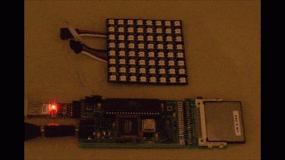

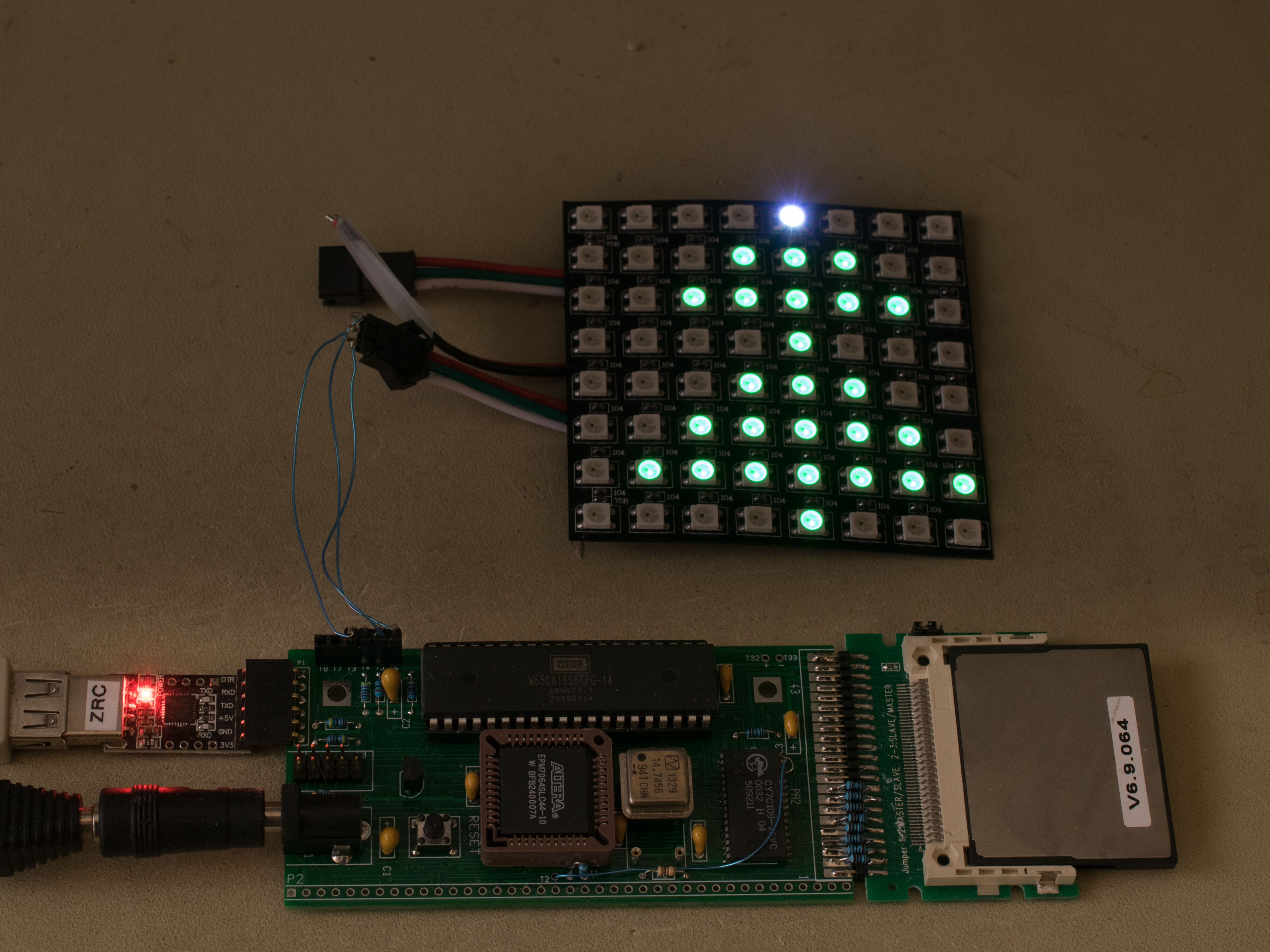

In this posting Sheep64 talked about using 65816's MX or E output pins to drive WS2812. I've had previous experience bit bang WS2812 with Z80, but only recently became familiar with few extended 65816 instructions that dealt with MX and E. In previous post I was successful bit bang serial transmit with MX. In this post I'll describe how to bit bang the WS2812 with MX output.
Each WS2812 needs 24 pulses where first 8 pulses represent the intensity of the green LED; next 8 pulses represents red LED; and last 8 pulses represents the blue LED. When multiple WS2812 are cascaded (1st WS2812's Dout connects to 2nd WS2812's Din, or in general, n's Dout connects to n+1's Din), each WS2812 consumes 24 pulses and passes remaining pulses to the next WS2812.
Each of the 24 pulses is nominally 1200nS long where '0' is represented by 400nS high and 800nS low pulse and '1' is represented by 800nS high and 400nS low pulse. Another word, "0" is 33% duty cycle while "1" is 67% duty cycle of 800KHz pulse train. The pulse duration is not too critical, the datasheet calls for +/150nS over nominal values.
CRC816's system clock is 14.7MHz, so each clock is 68nS. 400nS equals 6 clocks so there are not much time to decide whether to turn on or turn off pulses. Fortunately the pulse duration is not too critical so this sequence of code generates "0" pulse of 340nS high duration and "1" of 800nS high duration.
   ROL A      ;MSB first
   SEP #$30   ;first 6 clocks is always high
   BCS bit7Hi
   REP #$30
   NOP
   NOP
   NOP
   BRA showBit6
bit7Hi:
   NOP
   NOP
   NOP
   REP #$30
   NOP
showBit6:
   REPEAT THE ABOVE CODE 7 MORE TIMES
Attached is the test program that drives the cascaded WS2812 8x8 matrix in the picture.
