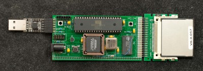

Because I need to cut traces underneath SMT RAM, I built up a new board for CRC816. The required modifications are minor and I'm able to run W65C816 in emulation mode passing memory diagnostic and run mandelbrot benchmark in EHBasic.
This will be a good platform for me to learn W65C816 in native mode.

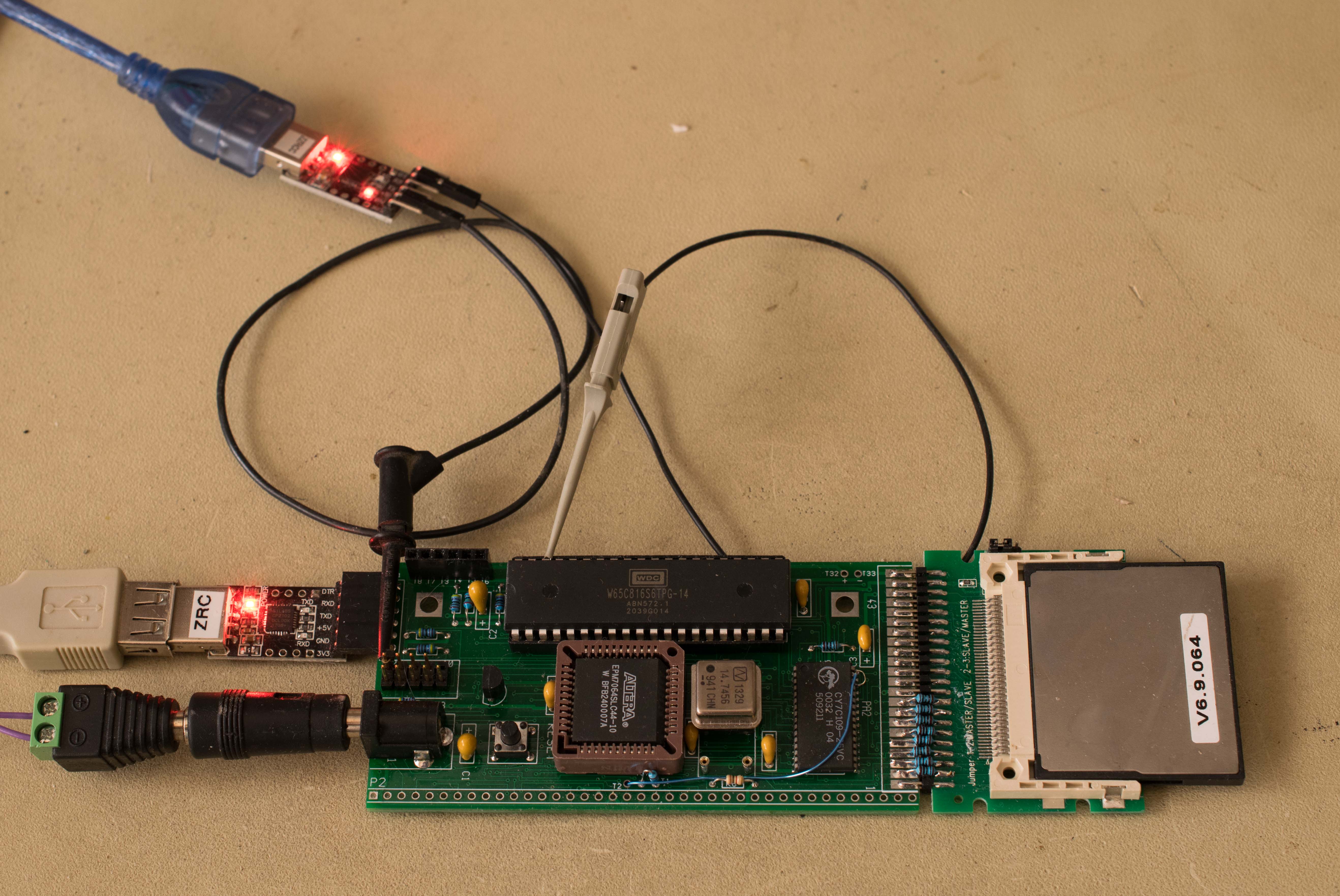

The discussion about "strange W65C816 outputs" give me an opportunity to explore 65816 using CRC816. While in 65816's native mode, the instruction REP #$30 will drive MX output low and the instruction SEP #$30 will drive MX output high. So MX output can be bit banged with these two instructions. An application where timing is not too critical is bit banging the serial transmitter. Since CRC816 is running at 14.7MHz it is easy to bit bang serial transmit at 115200 baud. The program is already described in this posting. Below is a photograph of 2nd serial port transmit hooking up to pin 38 (MX) of W65C816.
Coming up next is bit banging WS2812 which is more challenging because of the tight sub-microsecond timings.

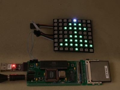

In this posting Sheep64 talked about using 65816's MX or E output pins to drive WS2812. I've had previous experience bit bang WS2812 with Z80, but only recently became familiar with few extended 65816 instructions that dealt with MX and E. In previous post I was successful bit bang serial transmit with MX. In this post I'll describe how to bit bang the WS2812 with MX output.
Each WS2812 needs 24 pulses where first 8 pulses represent the intensity of the green LED; next 8 pulses represents red LED; and last 8 pulses represents the blue LED. When multiple WS2812 are cascaded (1st WS2812's Dout connects to 2nd WS2812's Din, or in general, n's Dout connects to n+1's Din), each WS2812 consumes 24 pulses and passes remaining pulses to the next WS2812.
Each of the 24 pulses is nominally 1200nS long where '0' is represented by 400nS high and 800nS low pulse and '1' is represented by 800nS high and 400nS low pulse. Another word, "0" is 33% duty cycle while "1" is 67% duty cycle of 800KHz pulse train. The pulse duration is not too critical, the datasheet calls for +/150nS over nominal values.
CRC816's system clock is 14.7MHz, so each clock is 68nS. 400nS equals 6 clocks so there are not much time to decide whether to turn on or turn off pulses. Fortunately the pulse duration is not too critical so this sequence of code generates "0" pulse of 340nS high duration and "1" of 800nS high duration.
   ROL A      ;MSB first
   SEP #$30   ;first 6 clocks is always high
   BCS bit7Hi
   REP #$30
   NOP
   NOP
   NOP
   BRA showBit6
bit7Hi:
   NOP
   NOP
   NOP
   REP #$30
   NOP
showBit6:
   REPEAT THE ABOVE CODE 7 MORE TIMES
Attached is the test program that drives the cascaded WS2812 8x8 matrix in the picture.

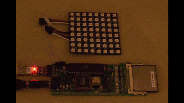

PostPosted: Sat Dec 25, 2021 7:33 am
Merry Christmas! A nice use of an RGB panel!
