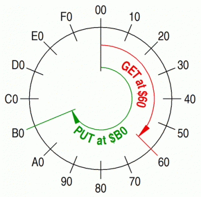

TxQ, which I briefly mentioned above as a circular queue, bears some explanation (also, see Garth's website page on which he explains RS-232 reception using a circular queue—it works on the same principle as transmission). The serial I/O (SIO) primitives consist of foreground and background code subsections. "Background" refers to the DUART's ISR and "foreground" refers to code that acts as an interface between user programs and the SIO driver itself. Only the foreground is accessible to the user.
When a user program wants to transmit, it loads a datum into the accumulator and calls the transmit foreground function:

Within the foreground, the datum will be stored in TxQ, the circular queue, which is illustrated below.
File comment: 256 Byte Circular Queue
Following the queuing of the datum, the transmitter will be checked to see if it is running. If the transmitter is not running it will be enabled, which will cause an immediate TxEMT interrupt, and background processing will commence. If the transmitter is already running background processing will likewise be running. Note that the foreground's interaction with the UART is limited to enabling the transmitter if it has been disabled—the foreground does not otherwise "touch" hardware.
