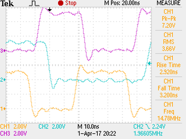

Well, the Flash Eproms (SST39SF010A-55-4C-NHE) arrived and one of them is socketed now.
With my simple loop (lda along, xor #$FF, sta along, bra) running out of the flash, I have tested 11,0592MHz and 14,7456MHz (3x / 4x regular speed). I couldn't see anything that alerts me. MEMOEB is about 8ns lagging PHI2, this should be OK.
So the next big problem I now have is to choose running the board with 11 or 14MHz
