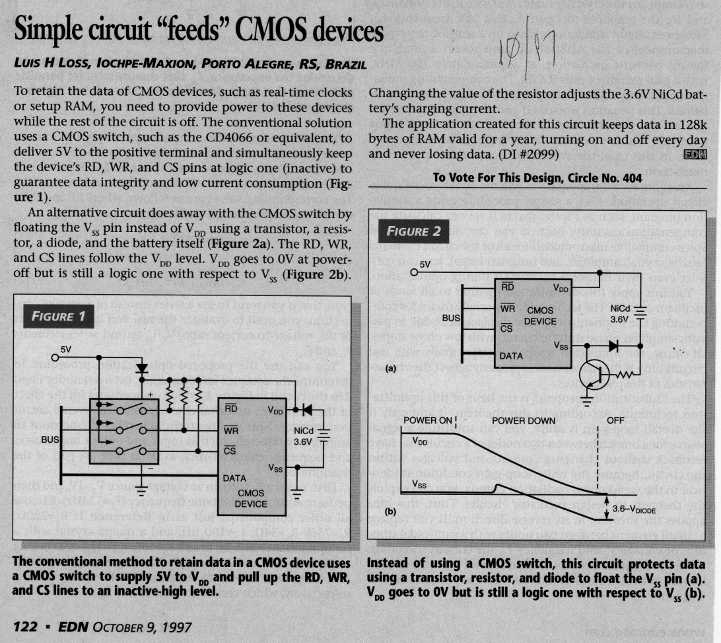

On a side note isn't there a simple circuit that can be used to make a battery backup for normal SRAM?
I'm sure you could find something from Maxim http://www.maxim-ic.com .  I did a design 16-18 years ago with cheap parts, but there were quite a few parts involved.  It was less than ideal from that standpoint, although it worked fine.  I also have an extremely simple design here that appeared on page 122 of EDN, 10/9/97.  [Edit: See viewtopic.php?f=4&t=573&p=32004#p32004 for the diagram.]  It uses a 3.6V NiCad battery, a resistor, an NPN small-signal transistor, and a diode.  When the power is on, the SRAM gets the full 5V, and there is nothing to delay any of the digital signals.  I don't have any way to E-mail it to you, but I could either photocopy it and mail it to you (I'd need an address) or just describe it in text if you prefer.  Ideally the SRAM would get locked out just before the processor's power starts dropping, to protect the SRAM from possible flaky operation when the processor's power supply voltage has dropped into a range of unreliable µP operation.  This simple design from EDN unfortunately does not appear to offer any protection for that part-- only for protecting the data after the power is already down.  But if your reset circuit has brown-out reset, then this simple back-up circuit will do fine.

Hi Garth, now that we have attachments, would you be so good as to scan that article?
I found the text, but not the diagrams:
http://www.edn.com/design/other/4341478 ... OS-devices
"sprow" reckons a couple of diodes are enough: http://www.sprow.co.uk/bbc/hardware/epromemu.txt
Here it is.  I didn't have a scanner when I wrote the post above nearly ten years ago.

Someone asked me about a resistor value and transistor identifier.  A common 2N4401 transistor should be fine.  For the resistor: 5V-3.6V-.6V=0.8V across the resistor.  10mA would be an appropriate current for charging a NiCd battery of 100mAH or a little more (I'm guessing at the AH rating of the little ones I've seen); so 0.8V/10mA=80Ω.  82Ω is a close standard value.  10mA for the transistor base current is way more than you need, but won't hurt anything.  These numbers can be modified depending on the SRAM, the transistor, and the battery.
Darn.  I just looked at Mouser, and found they no longer carry any of the NiCd batteries that used to be mounted on PC boards for memory back-up.  Jameco shows one, but it's no longer available.  There are other sizes, so if you want to use one of them, I'm sure we can help you find appropriate parts values for this circuit.  Otherwise, it'll be a different chemistry, so we may need to modify the circuit, depending on the battery's data sheet.  We can probably do that, too.  I suppose it's mostly lithium-ion now, which doesn't have the memory effect that NiCd had, and probably also has a lower self-discharge rate.
